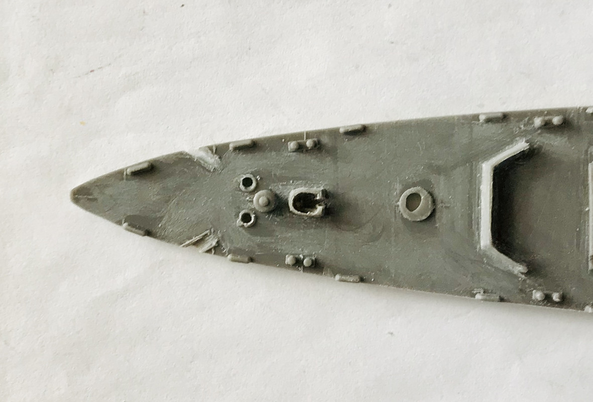

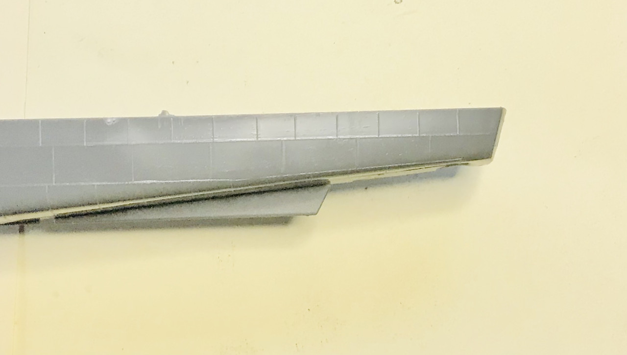

The hull had some very pronounced weld lines, as do the decks and bulkheads.
So I sanded them down a bit. In photos of Butler Class DEs, the weld lines are visible, so I just toned them down a bit by sanding

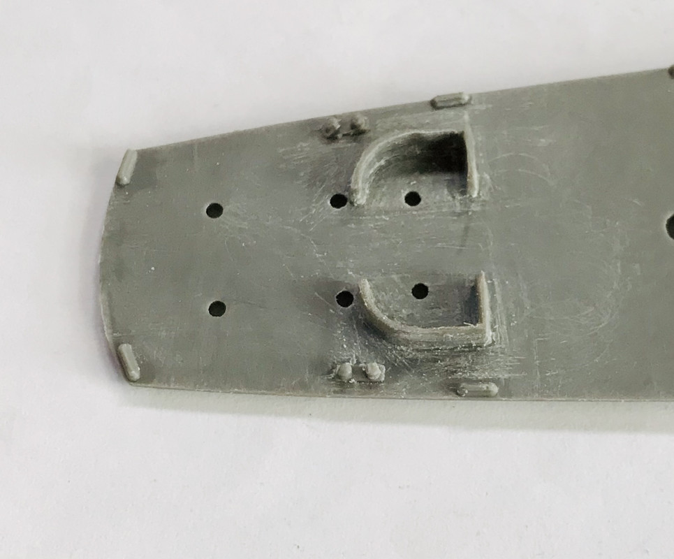

And again after examining every photo on Navsource of Butler and Rudderow Class DEs, and finding none visible, I decided to sand off the deck weld seam lines, and thin down the thickness on some of the deck fittings. I also sanded off the anchor chains, drilled out their openings, and filed the slots where the anchors sit on the deck. All your Navy types please forgive me for not knowing the proper terms.
It looks a bit rough now, but I’m sure that it will look better after primer and paint later on...
