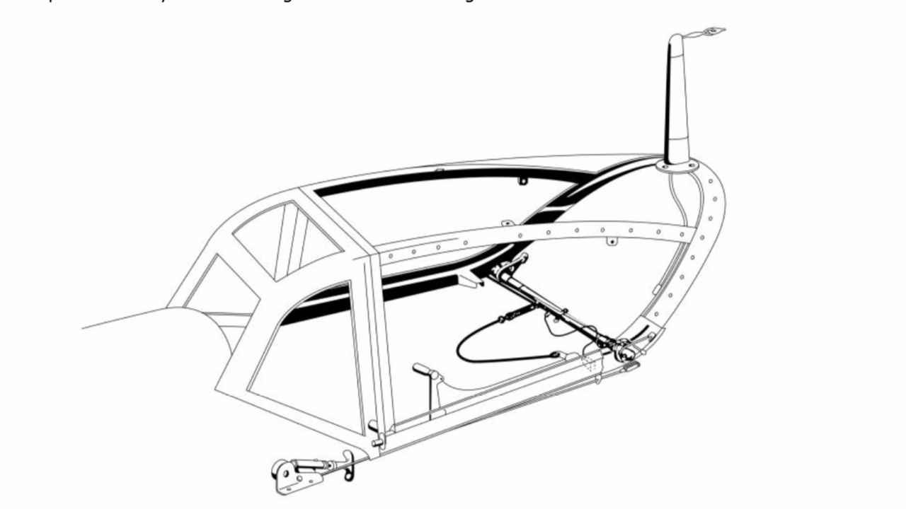

The roll bar behind the pilot which attaches to the canopy mechanism looks a little too beefy to me, but that is definitely being picayune on my part. To me visually the diameter is a little over half the height of the canopy frame, as it sits in a recess to serve as the canopy opening-closing mechanism.
Here is a drawing that shows the mechanism and attachment points as well:

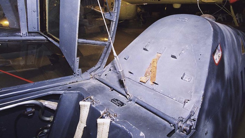

That photo is GREAT... VERY helpful,but tell me, do you know if that is a K-4? The shape of the hatch cover behind the pilot is the exact same shape that the kit provides. However, the photos of K-4's that I've seen show a different shaped hatch. The proximity of the loop antenna and the aerial mast on top of the canopy indicates that it might not be a K-4?

Thanks so much for the input Bruce! Blue 16 is an interesting bird and I think I have some information on it that I can share with you when the time comes. The fuselage issue can be handled a couple of ways. My ideal route is to use the RB Productions brass-framed canopy, which should have the correct profile on top. The instructions for the canopy mention the erroneous flatness of the Hasegawa fuselage and include a cross-section to help you correct it. The canopy is also meant to be movable using simple pin/hole joints but I'm skeptical on how well this will work, especially with the wire restraint system that is shown in your photos. I don't mind the bar part being a little overscale and I'm not planning on shaving it down significantly at this point.speedgraflex wrote:I have a 1/72 BF 109K4 of 12./JG27 (Blue 16 + I) unbuilt from Fine Molds and my research that I will reference here—and if I see anything that is pertinent I will add here.
I will follow along with you. You already addressed the fuse shape issue. I think overall Hasegawa’s fuse is quite good with the exception of its canopy flatness—you already have a plan to redo this, I think—or is it a detail worth the fix itself?

And looking at this photo again, I can see that the bar in my photo was place upside down. It will be corrected when I install it permanently!

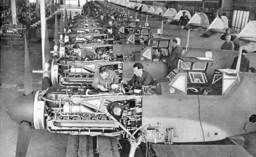

K-4 production line:

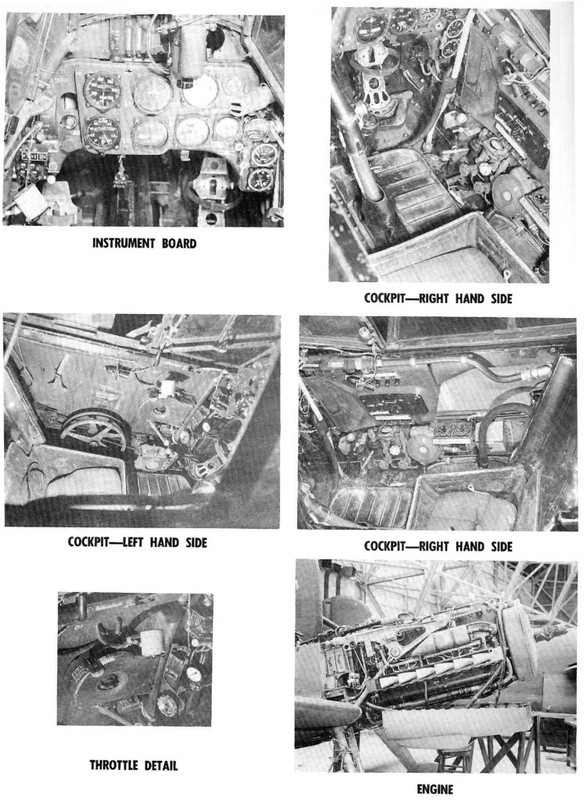

I also have what I believe are K-4 cockpit photos:

Thanks Bruce! That's a neat production line photo! But I don't think those are K's. Can't be a K because of the middle opening canopies. Not E-series or prior because of the spinner. So either F's or G's. Absence of circular fuel hatch under the cockpit points to a G.
And also... I'm not sure those are K-4 cockpits. The starboard side of the K-4 pit was dominated by a larger circuit breaker panel. You can see it on the resin sidewall and the photo below.
I believe the K-4 came with a bomb control panel hanging from the center bottom (#51).
But those photos are still helpful. The throttle lever is missing from my resin side panel so your photos will help me replace it.

Apologies, John! You are correct, and that was a great assessment of the canopy type on your part. That is greatly appreciated, as well as the sidewall photo with the O2 system! Wow, that looks like it was a photo for the manual. What great details you found!
