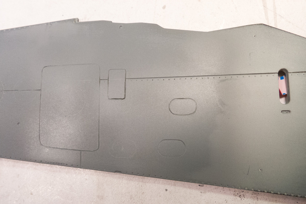

A light coat of grey to check the filled panel lines. So far so good.

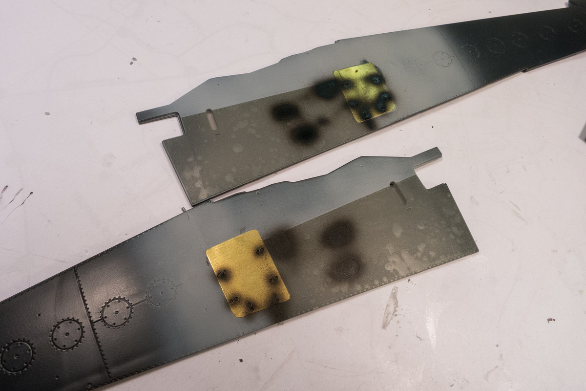

Using masks cut with a Silhouette Portrait cutter, I can mark the locations of the new hatches and ports. The brass template for the large 4-sided access panel are temporarily glued into place with CA glue. Black paint is used to mark the locations for the smaller ports upon which I can use a standard scribing template.

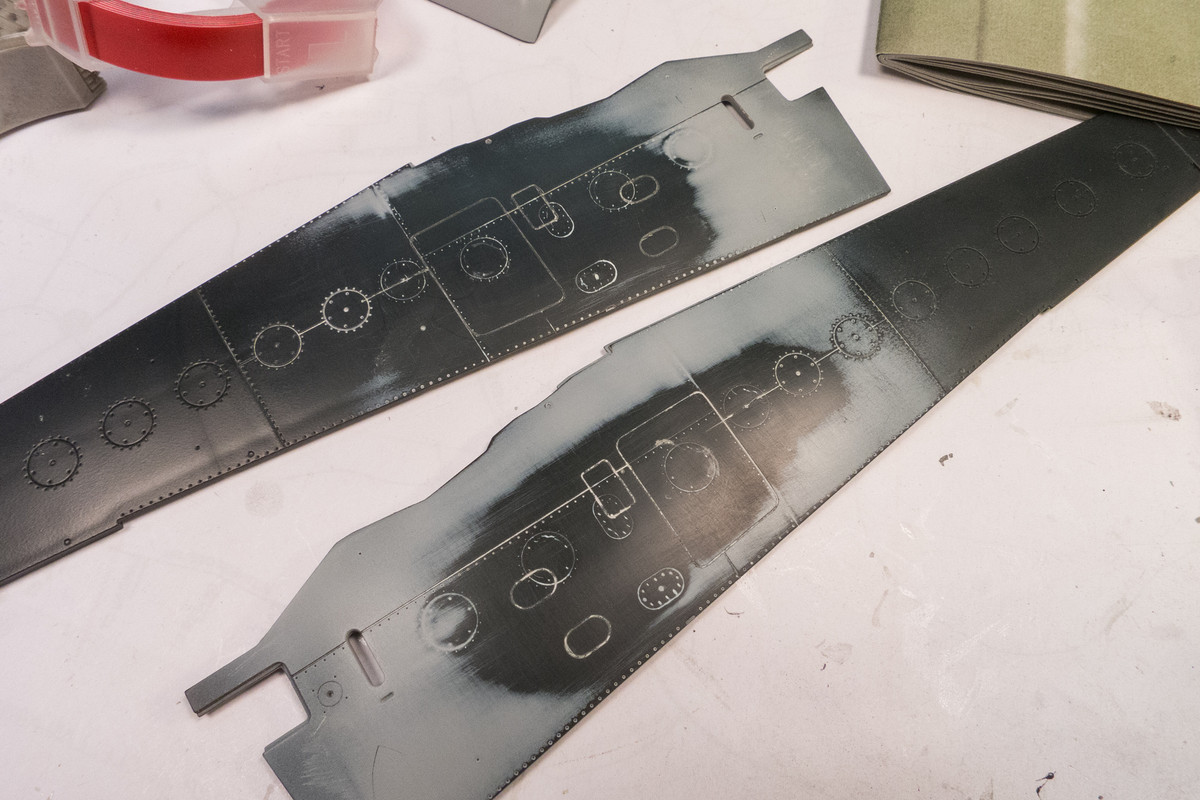

This is where I started running into trouble. I had hoped that the panel lines that I had filled with sprue goo would give me a consistent material over which I could run a scriber but this was not the case. The filled areas were much softer than the plastic and it was difficult to track a consistently straight light through any area that had been filled. The filled areas, being softer, clung to any excess pushed up by the scriber, making it more difficult to clean up the lines that had been scribed. And white putty on black putty is not the easiest color combination to worth with since it is hard to distinguish between the putty and sanding dust.
Another shot of grey paint removes the visual clutter of the filled lines. But it also reveals the imperfections from the scriber getting bogged down by the softer sprue goo. So frustrating... I was really disappointed at this stage and was compelled to put down my work and go do something else.
When I came back, I didn't think the results were THAT bad. Most of the shapes seemed workable. Re-tracing the shapes using the templates cleaned up some of the slop. The worst spots were filled with Black CA and re-scribed. So now I am in micro-cleanup mode, using dabs of Mr Surfacer to repair scratches and make the lines more uniform. Getting there...

I saw you were cooking up sprue goo, but I did not make an immediate connection to the way you were going to employ it. What I do recall was reading a detailed review of various methods used to create scribed lines in styrene, utilizing putties, pastes, compounds such as sprue goo, and the reviewer conclusion was to use CA in much the same way you are doing. Since you introduced me to Milliput my preferred solution is Milliput smoothed to 2K grit, polished then filled with brushed CA, which in turn is sanded and polished all the way to beyond superfine. I did “hear” a warning bell when I saw your bottle, just because a sprue goo join is to my experience the softest join, which is useful for soft seals and edges. CA/Milliput are harder edged and it is possible to make fine precise cuts through their surfaces.

I was thinking of sprue goo as a magical "plastic in a bottle" solution thinking it would solidify into hard styrene plastic. I've used CA glue as a filler but it has the opposite characteristic...it is significantly harder than the surrounding plastic. But harder is better than softer and I think using CA glue from the start would have led to a better result. But... I think I can make this work with a few more corrections and adjustments. And once I put the riveting on, I think the small imperfections will be masked even further. That's my hope anyway!
