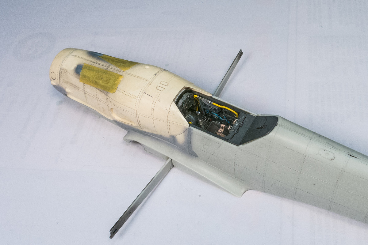

After the Milliput dries, I've dabbed on some Mr Surfacer 1000 and began the sanding process. So far so good as a preliminary shot of primer shows.
The chin intake was glued in. There are some gaps that will need to be addressed with Milliput.
The control surfaces for the wings have been finished and are awaiting the completion of the cowling cleanup for attachment.
I've dabbed on some more Mr Surfacer 1000 on the cowling joints and I'm going to let it cure for TWO WEEKS to ensure no shrinkage.

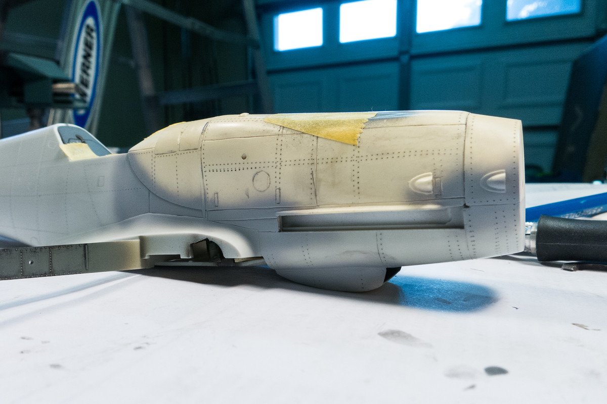

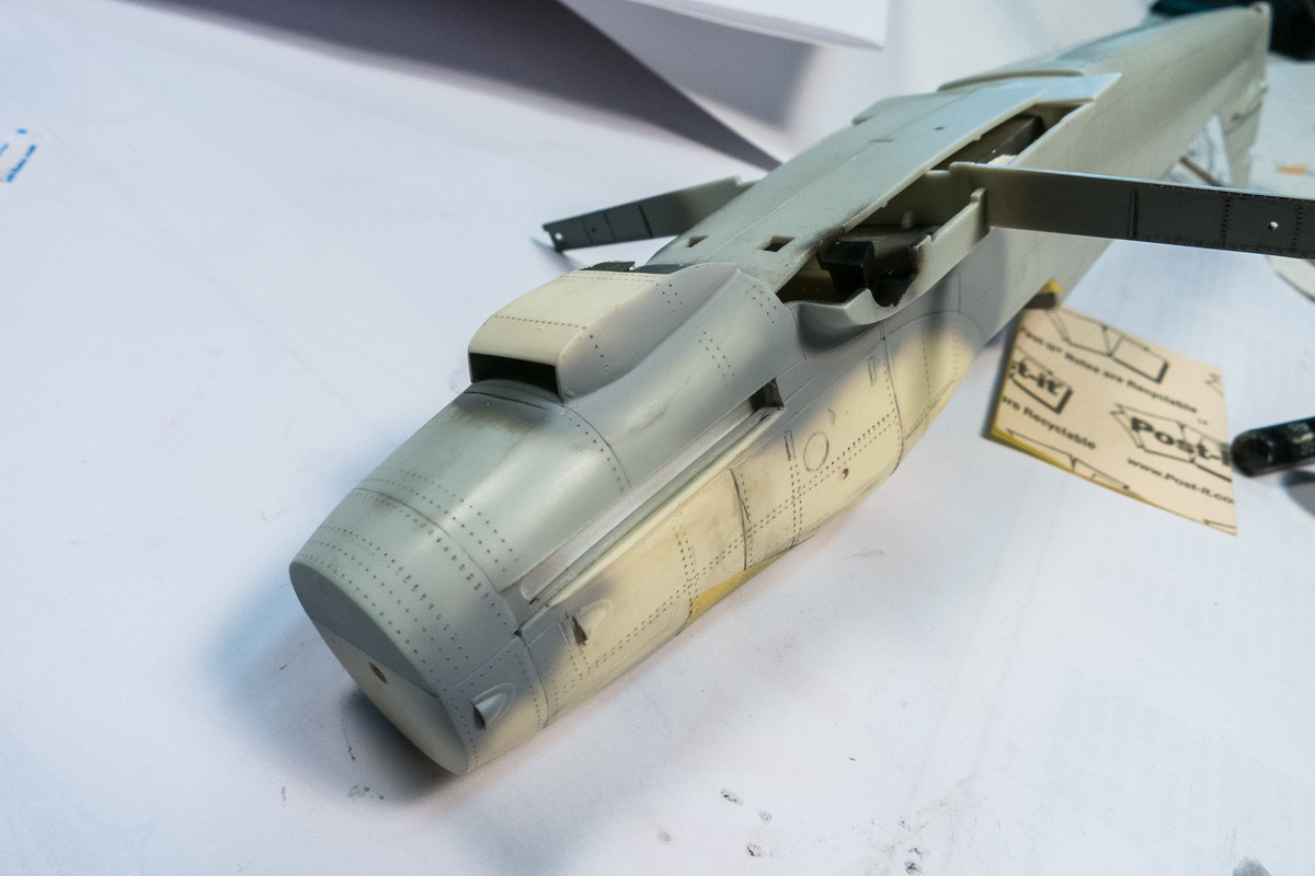

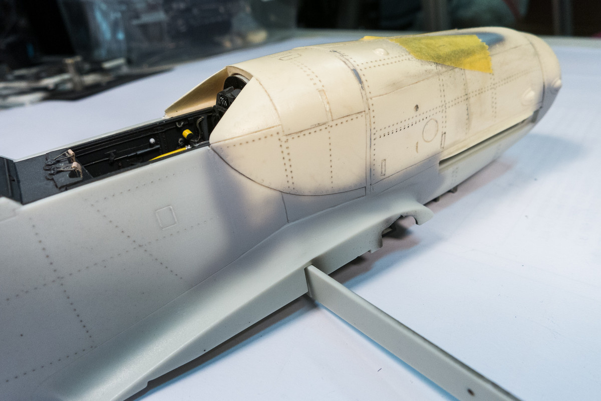

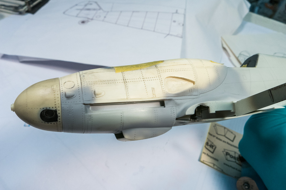

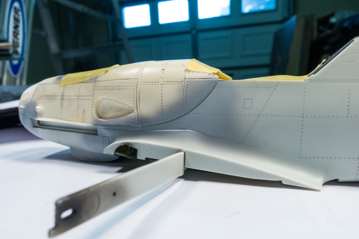

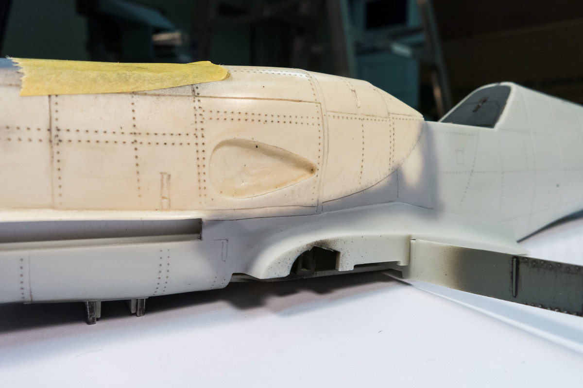

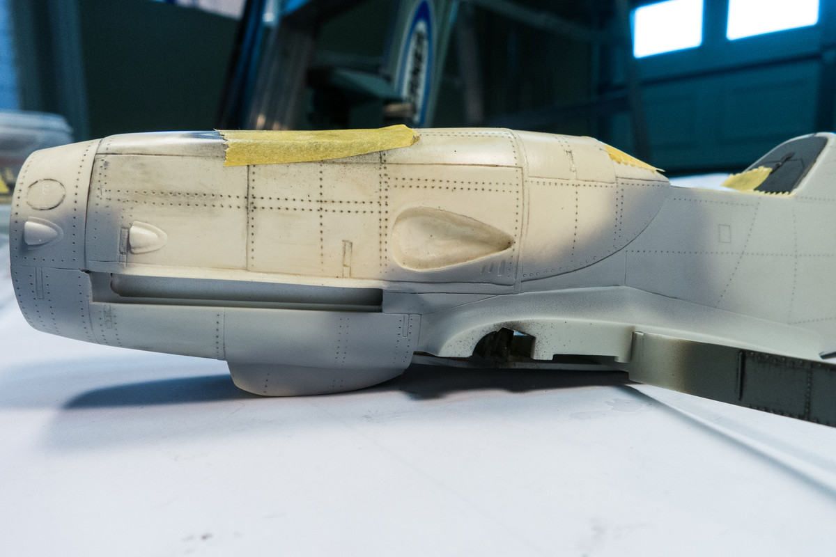

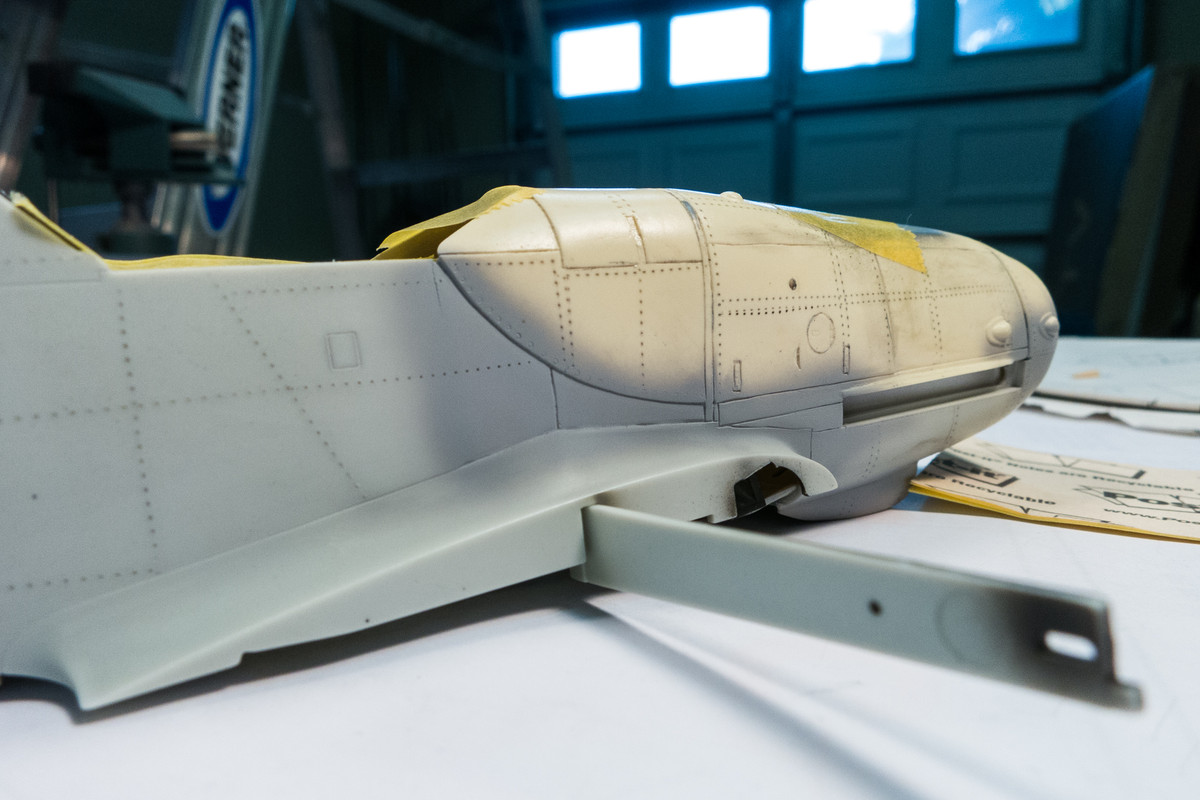

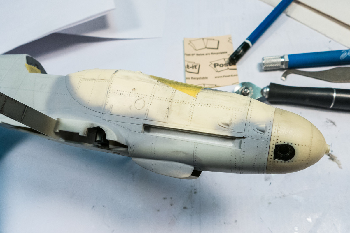

So despite the coziness of self-quarantine, I've been busy doing this and that. When I last left the G-6, I had slapped on some Mr Surfacer putty along the main join between the AMUR Reaver engine cowling and the fuselage. That's been sanded, touched up with more putty and sanded again. I've worked on all of the joints and have re-scribed and riveted where necessary. I just shot the joints with Mr Surfacer 1200 through the airbrush to review the work so far.
The joint on the starboard side at the cockpit came apart during riveting and will need to re-secured before moving forward.
Popped the spinner into place and took a few more pics. There is some minor clean-up to do still but it looks good enough to move forward on this build.
