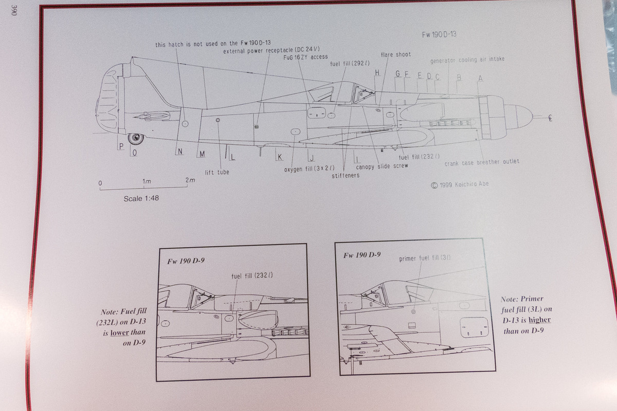

The ideal plan is to use as little of the resin parts as possible. And... I have another resin D-13 conversion coming in from the Czech Republic (don't you love how international modeling is?) but I'm guessing it will be even less useful than this set because it ignores the bulges altogether. I'm trying to gather my references to map out a game plan for the modification to the Hasegawa kit parts. Volume 2 of Crandall's Dora Series has some scale drawings of the D-13 including some useful cross sections.
All combined, the photos, the drawings and the Grey Matter fuselage, are starting to give me a more definitive picture of what the bulges look like and where they are located.

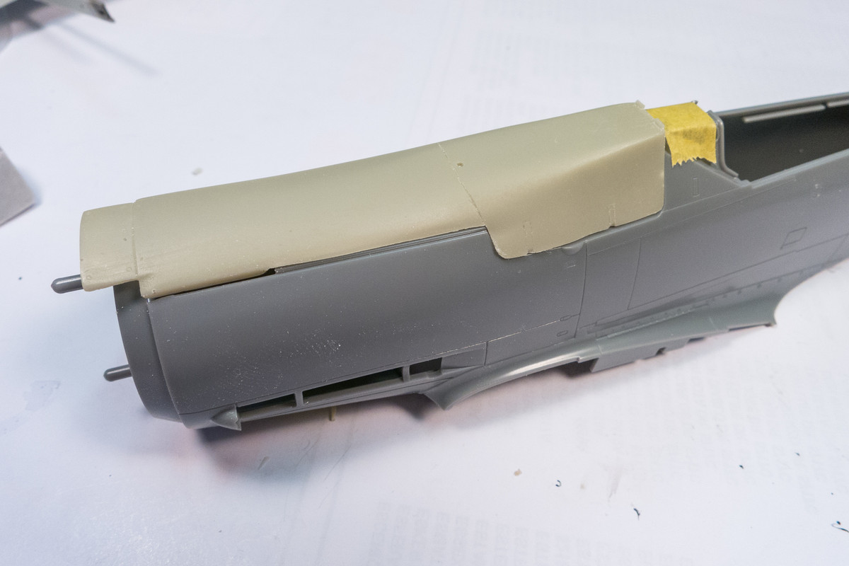

I sawed off the RM cowling from its casting block, cleaned it up and mounted it on the Hasegawa D-9 fuselage. It took some extra trimming on the cowling ends to get it to fit, length-wise. It appears that the bottom rear edge of the cowling is narrower than the fuselage, resulting in a noticeable step that would need to be corrected.
The GM cowling, although not perfect, fits much better than the RM cowling. Dimensions seem to correspond more accurately to the Hasegawa fuselage which will require less remedial work.
The two supercharger intakes are slightly different in shape. The RM intake has a leaner look with a thinner lip around the intake opening. It also has some recessed panel line details missing from the GM intake. I would say that the RM intake looks more appealing but I'll have to compare with photos to see which one is more accurate.
