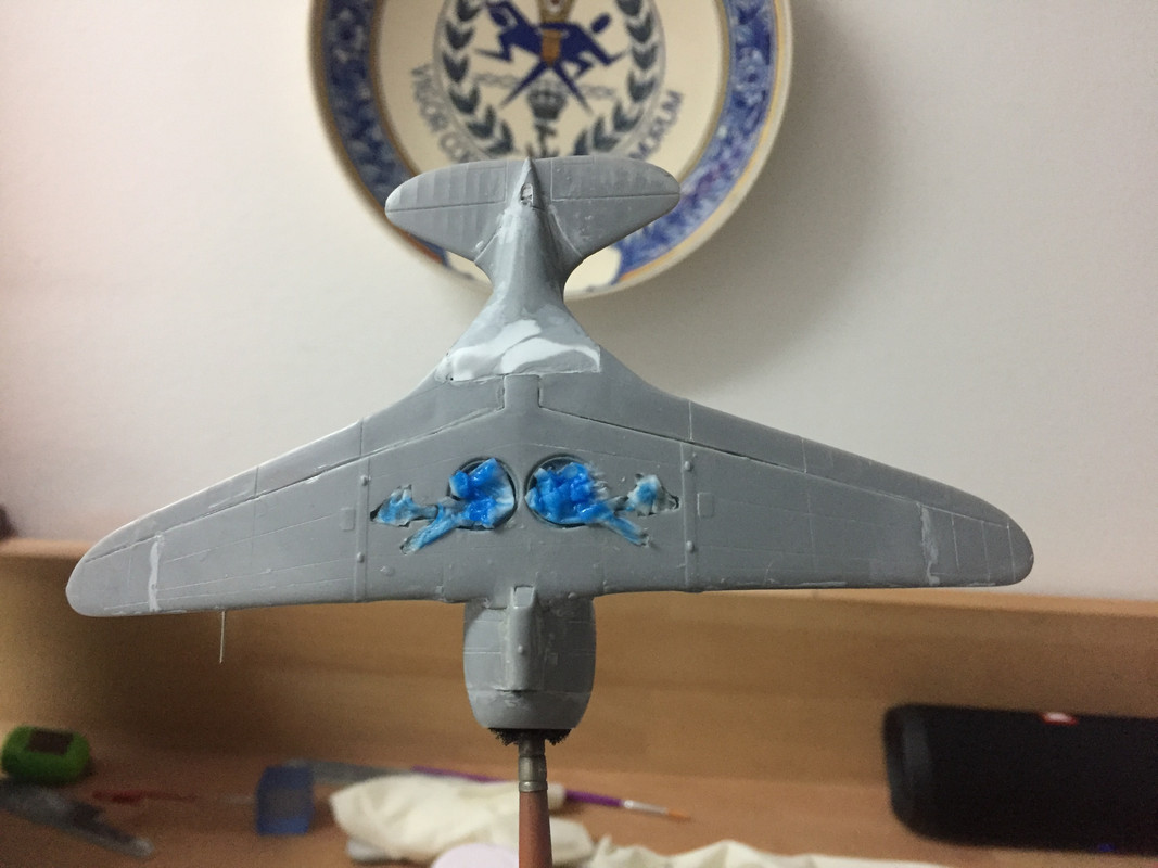

At this point, with tired, old eyes, I will hit it with a light coat of silver or black, then sand the filled areas... imperfections show quite well.

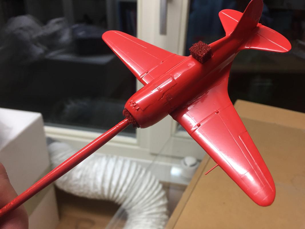

I found the finish good enough to continue. Or that is to say,I am afraid the tweaking it any more will not make it better. I masked the engine and cockpit with some packaging sponge. Gear bay was masked with wet tissue and Micro Mask.

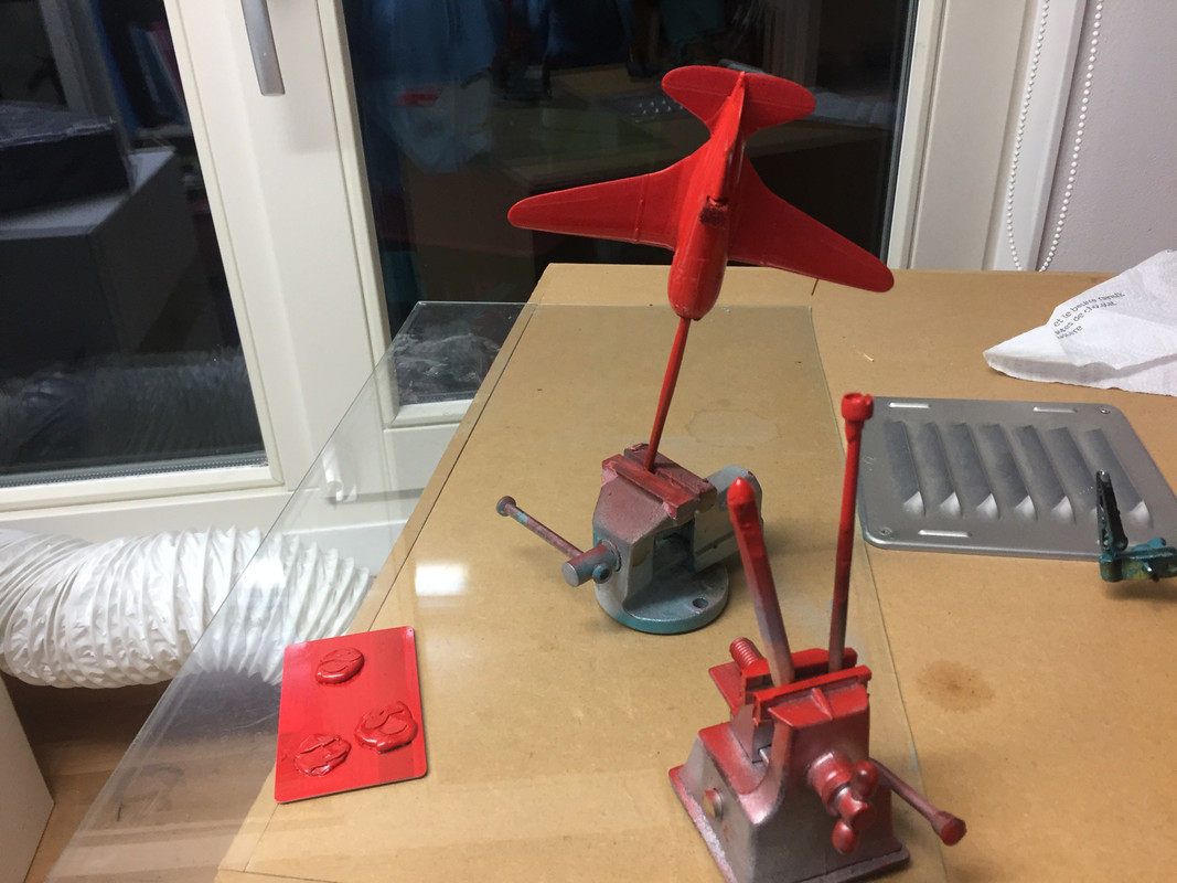

And the painting is done! Four layers of red. Done with a Duplicolor spraycan. I warmed the can in hot tap water before spraying for a higher pressure and better atomisation.

Very nice! The paint looks really smooth!
Re: A Model Polikarpov I-180 1/72
That red is lovely! I’d like to have a Chevy Chevelle SS that exact color, it’s sexy. Very nice!
