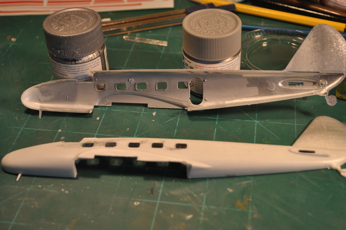

Any way, I've started the 247. With some dread I might add. So far, nothing to earth shattering, just a misplaced cabin window. I've seen it, held it and put it somewhere safe...Filled that opening with Micro Krystal Klear. Here we go. Love the instructions!
Small stuff. I chose to do the Roscoe Turner Racer. Rather than seats, his had fuel tanks. The one on the far left, top has been wrapped in BMF and had lead foil tape straps put on. The next one to the right is simply painted a Krylon Silver Foil Metallic and then added the lead foil straps. Most of the bottom row has simply been painted. Brain finally said, "You won't see it." So, I see no reason to add more of the lead foil straps.

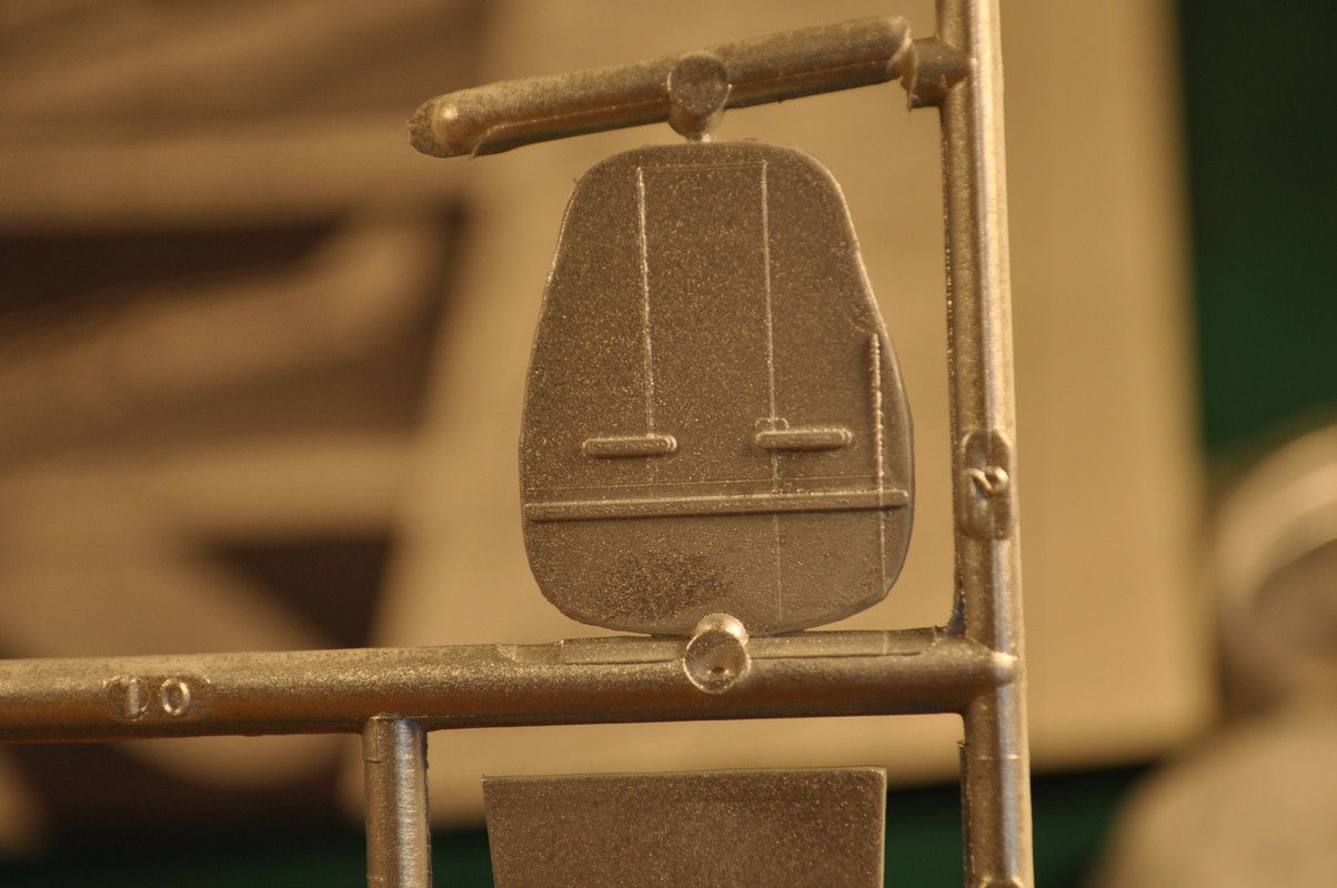

The cockpit is about as basic as it gets. A decal was provided for the instruments and thank you Williams Bros. for the flat surface to place it. Again, you won't see it. Love this sprue attachment.

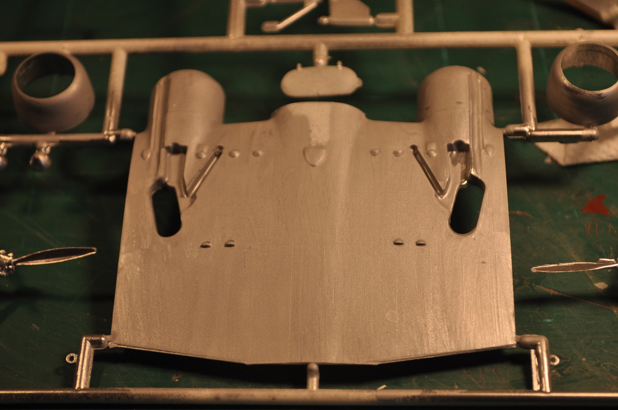

Anodized aluminum or not? What do you think. I mixed up some Sky Gray (XF-19) with some Flat Aluminum (XF-16). Close to 50/50. Just brushed it on the bottom wing center section. I did get a gracious and helpful response from Greg Bale, too. He made up thin, gray stripes and printed decals to use as panel lines. Thought that was interesting. I'll put a picture up later. Also, got more info on the "glazing". Seems it was more of a straight up dry brush.

Humbrol’s flat aluminum, 56, is a nice dark dull shade of that color. Far more so then Tamiya or Testors, and great for a weathered or anodized look.
