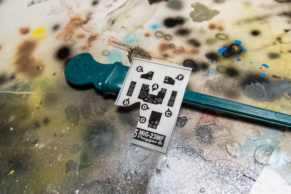

Meanwhile in Hamburg, Germany ... Aires cockpit, feel my pain between my legs.
Instrument panel with small parts. Unfortunately, the instruments can hardly be recognized. Even though I painted it with white paint. Unfortunately too small to recognize anything. Next time I'll probably use a look part from Eduard
Testfit, not glued yet.
The Eduard Wheel wells are glued in with super glue and fixed with green stuff. My epoxy glue was to old for use. I hobe it will works. The fit of the parts was not so outstandig, which didn't make gluing easier.

That's interesting... I got a different result using a similar Aires cockpit set. I sprayed the white onto the back of the clear acetate sheet. Maybe the ML cockpit instruments are different than the MF?
