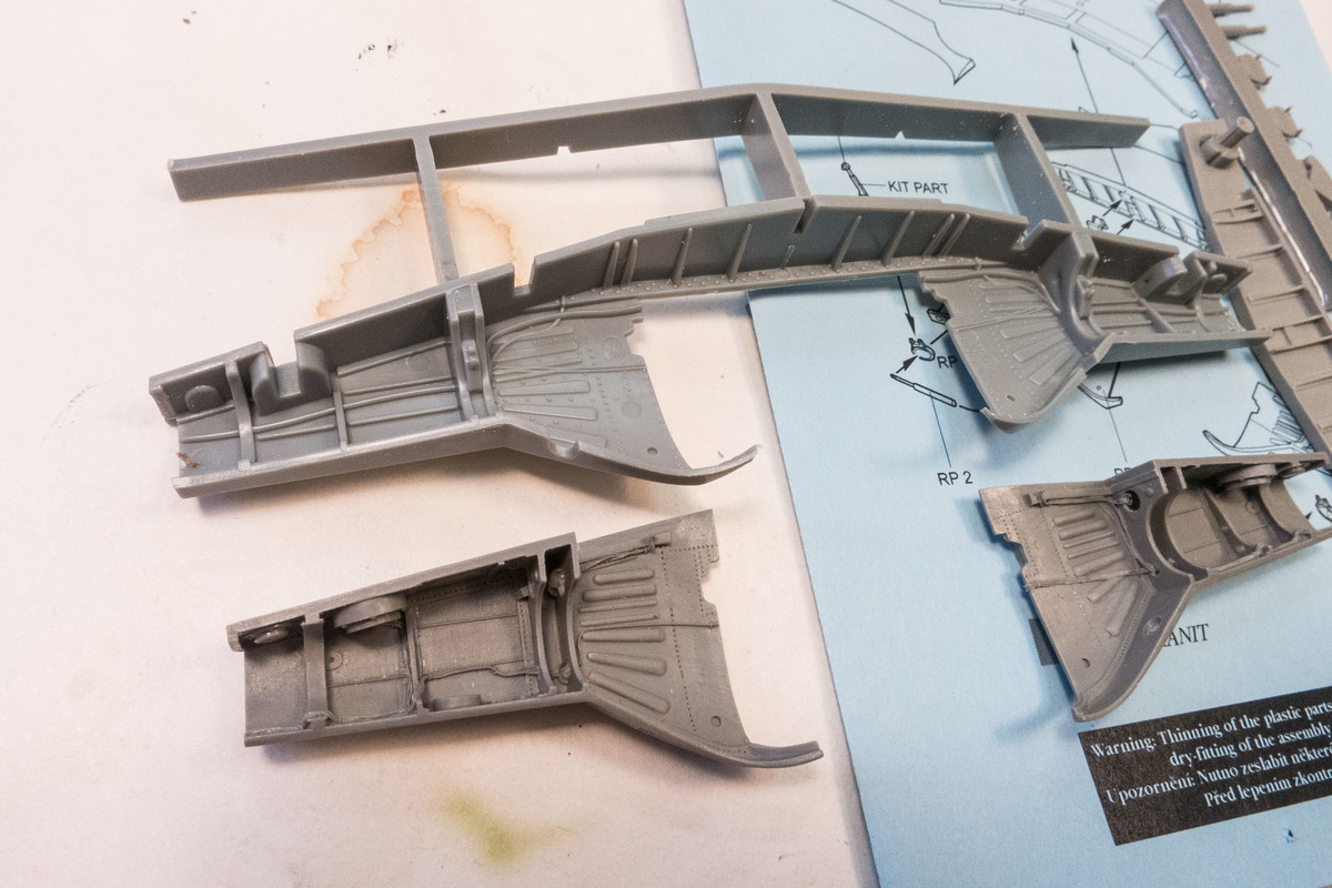

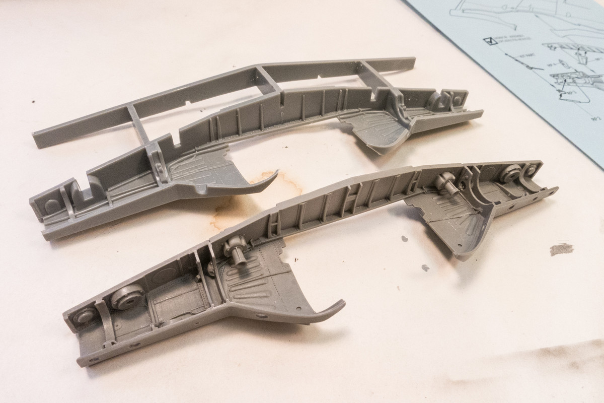

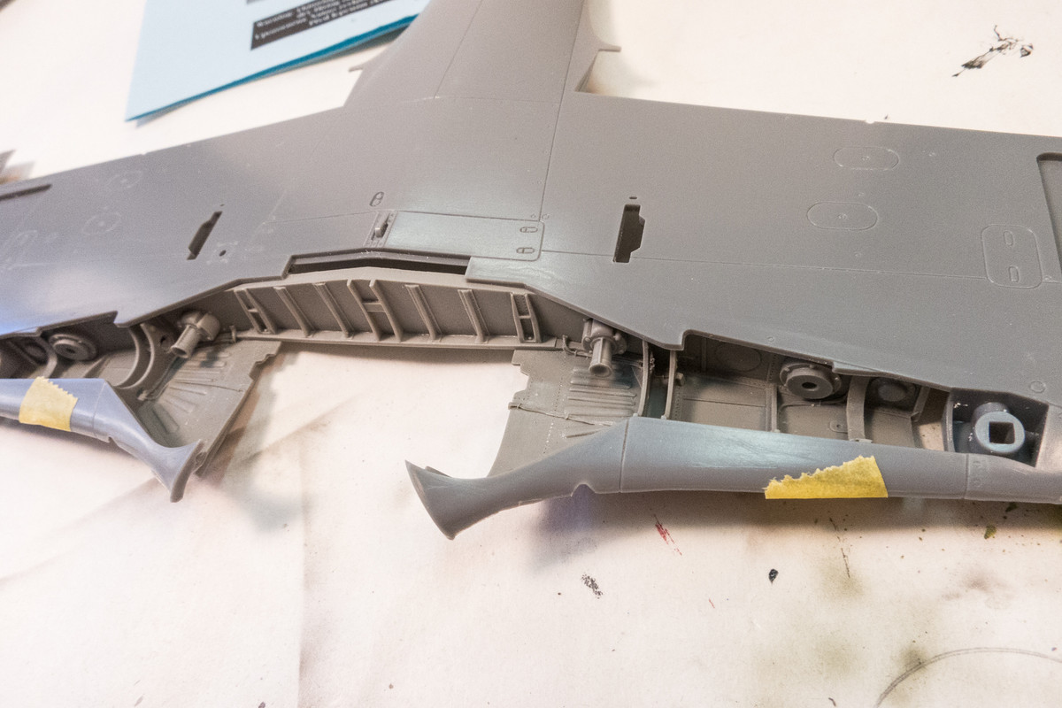

Time to inspect a new aftermarket item. This is the Aires Wheel Well set for the 190D. Aires casts some of the most intricate resin bits that I've run across and this one is no exception. The wiring detail is almost TOO fine.
Since the Hasegawa wheel wells are separate inserts, it should be a plug-n-play replacement and there shouldn't be any messy removals to deal with besides removing some hefty casting bases. Note that the Hasegawa wheel wells has almost all of the details as the Aires parts but they are not as finely rendered. So the deficiency is not one of omission but execution, which may be relevant.
The kit wheel well insert is integral to a spar that helps maintain the correct spacing between the upper and lower wing parts. Grafting the spar into place with the Aires wheel well parts should not be an issue.
When I place one of the Aires wheel wells into place, I start to notice some issues. With the skinny end of the Aires part butted up directly against the landing gear base, the holes for the wing guns do not line up correctly. And the wide end of the part doesn't reach the end of the wing part like the kit piece does. As if the Aires part is undersized.
The three major components of the Aires set fit positively with one another so I temporarily glued them together using CA glue.

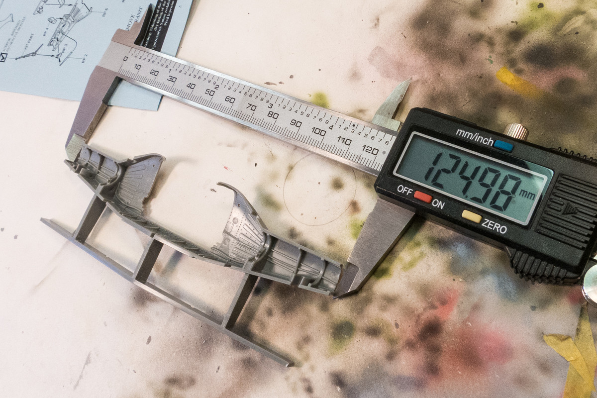

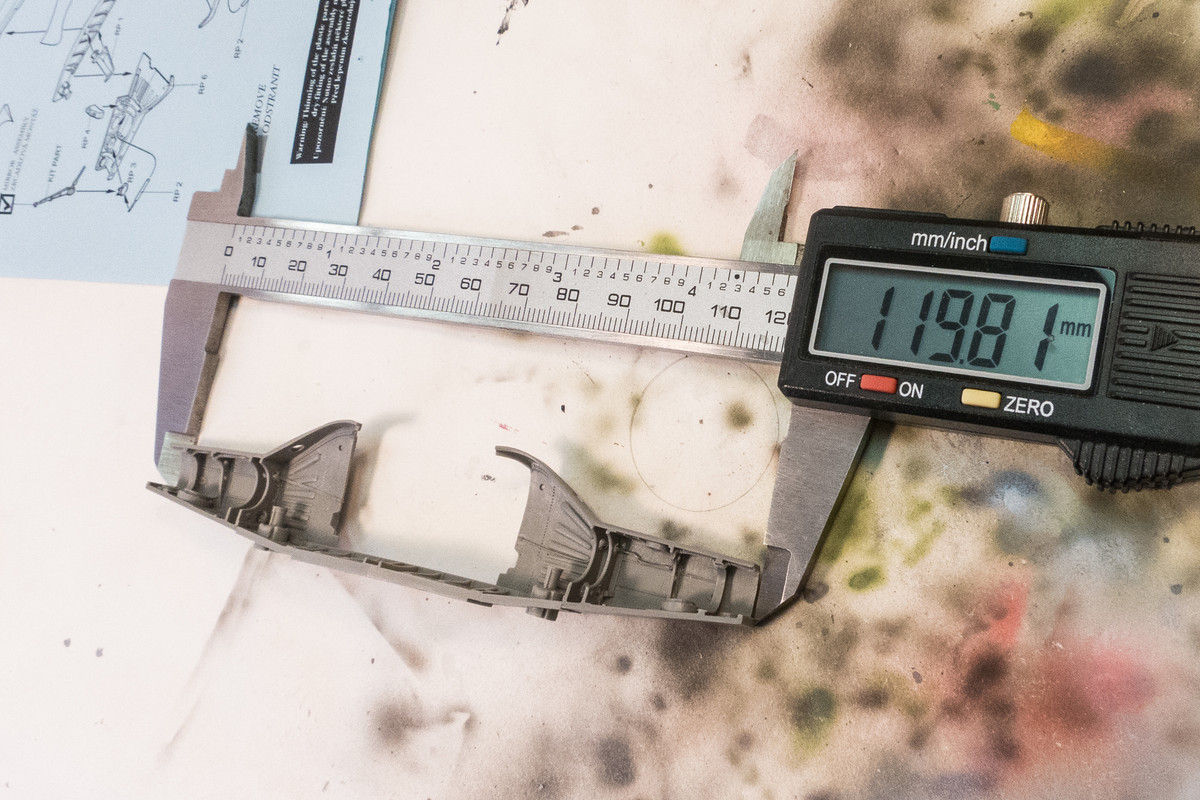

And then took measurements using a Micrometer.
Centering the Aires wheel well onto the wing bottom reveals the gap caused by the undersized wheel well, which is actually not a huge issue in my book. I'm more worried about the alignment of the wing gun holes.
The Aires wheel well parts are definitely undersized. I COULD get them to work, if I wanted to. But I'm thinking that the enhancement in detail is not worth the effort. I also have this...
which could be used to spice up the Hasegawa wheel well a little. I'll think about it.

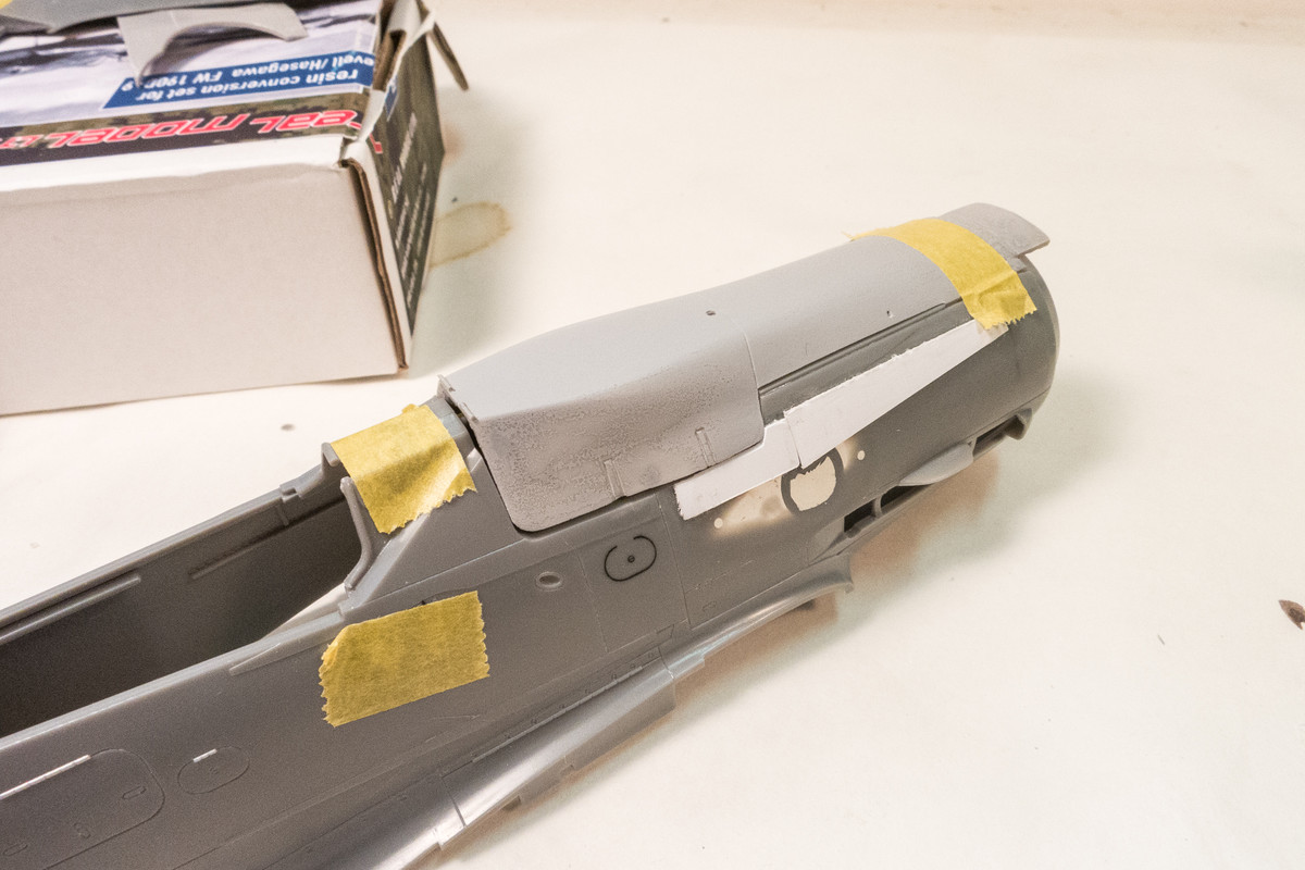

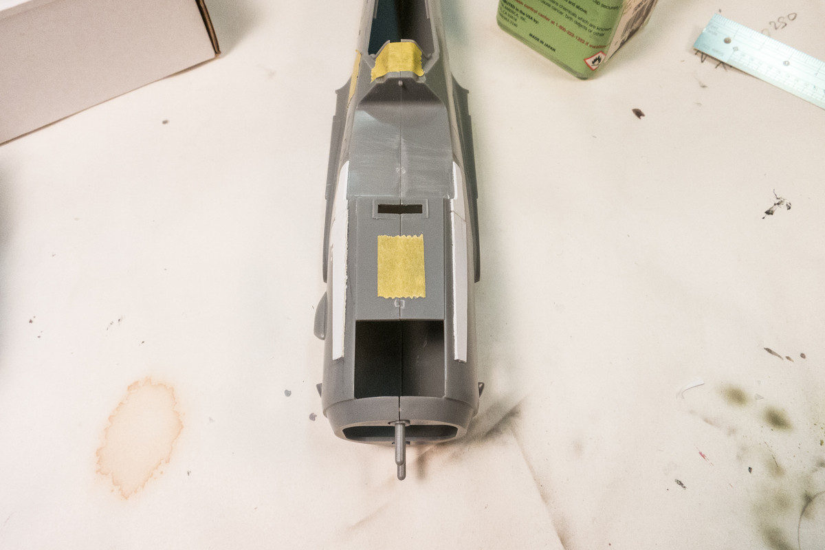

The first step to establish the fuselage bulge has been taken. Instead of randomly slathering some putty, I want to use sheet styrene as a form to help establish some consistency.

Additional forms to establish the base of the bulges have been added.
After this dries, I'll start sculpting with Milliput.

I took another look at the Aires wheel wells. Some people over at LSP threw out some options that I could consider and I thought I should give one of them a try. For me, keeping the long bulkhead in correct relation to the wheel well was important so that the cannon mount on the bulkhead lined up with the hole for the gun barrel in the wheel well. So keep that a constant, the only other way to effectively increase the width of the wheel assembly was to cut it. I chose to cut it in half. The kit gun barrels are standing in for what will ultimately be brass tubing.
The wheel wells are then placed into the lower wing using the gun barrel as the datum. This results in three small gaps but they really shouldn't be noticeable. The biggest effort about going in this direction was removing the wide casting block on the wheel wells... whatta pain.
With the Blue Tack holding the wheel wells in place, I tape the upper wing halves into place. The gun barrels are correctly positioned.
The gap in the center is the most noticeable but remember... there is a central exterior piece yet to be added.
The Grey Matter part, with the single ammo chute fits very nicely (surprise!) and blocks the view into the wheel well. Now the gap is hardly noticeable.
I think this is a good compromise to get the Aires wheel well to work. My only concern is the landing gear actuating arm. Since the distance between the landing gear mounting location and the wheel well has been increased, there is a good chance that the actuator will be too short. But that shouldn't be too hard to correct.
Oh... and the sculpting process has started.

Skip to slightly over the 3 minute mark, I believe. I keep wondering about the styrene pieces you are using — are those more as a guide to keep the edges level? I have this photo of a “Kangaroo” with what I think of as a fitted cowling similar to what you are making, a very smooth finish, maybe two panels...
