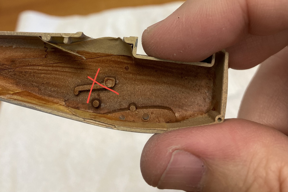

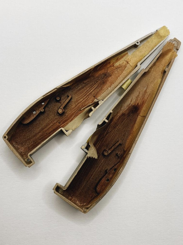

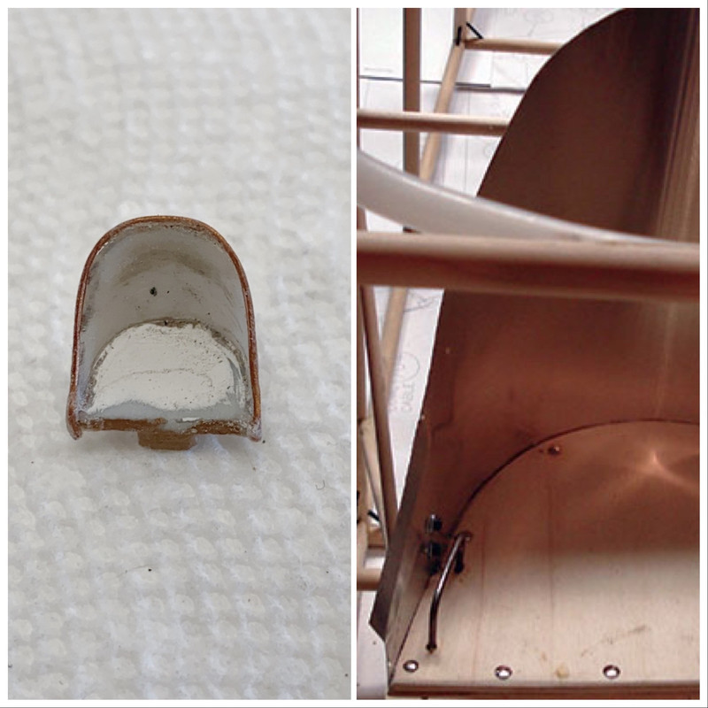

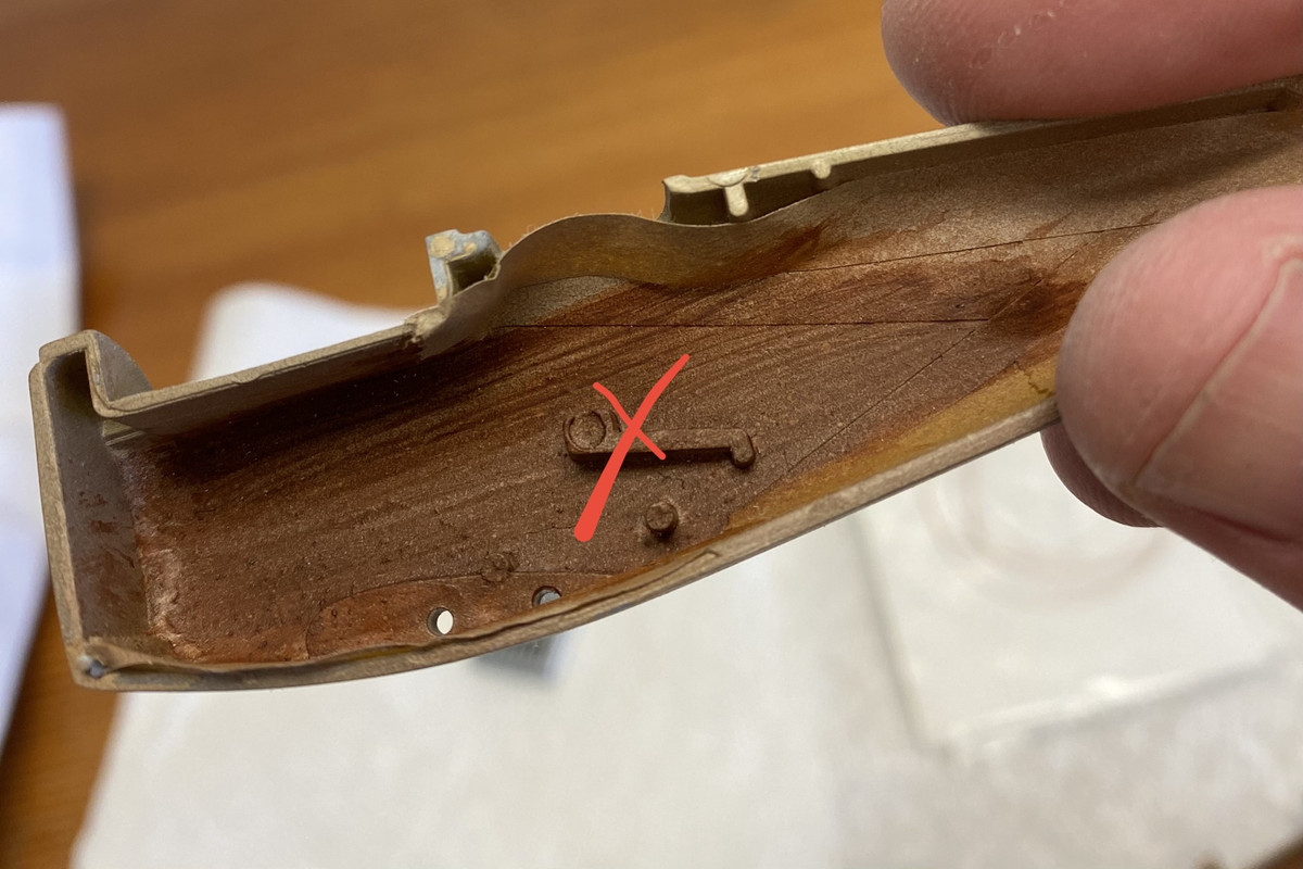

To follow Carlos, here are my cleanup and detailing work steps for the Triplane’s seat. First, I reduced the overall thickness of all edges, using 180 to 320 grit papers. Sandpaper of choice are sheets by Tamiya and sanding sticks by Mr Hobby. Then I filled the injection molded hole, despite knowing that a seat cushion would cover it. Not sure why I did that, but I did. The final touch was to add a bent and formed copper wire edge.

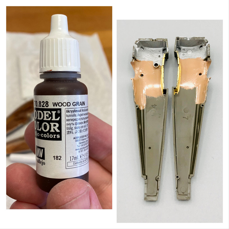

With each project I want to try something new, so I chose Vallejo Wood Grain to brush over either a tan or brown base coat. I masked the sections to accord with the triangular sheets of wood used to form the actual cockpit.
It was only later that I realized that the two “armrests” used to grip the sides of the seat prevented me from locating the seat properly and would need to be removed. Yes. I should have fitted the cockpit seat and floor first.

I would be excited to see your results on the interior (right). Is that Humbrol tan?
If you do, I think this not only works for any interior paneling, it will make the tricky layers of the propeller possible. I think. Or perhaps, I hope! This goes on smooth. Work in layers. Slowly. Full strength on a good sable round point. I used a piece of paper to remove the excess, and to keep too much paint from building up on the brush. Then I diffused the layers with water, a few drops. I let that color tonality flow smoothly in the grain direction.
