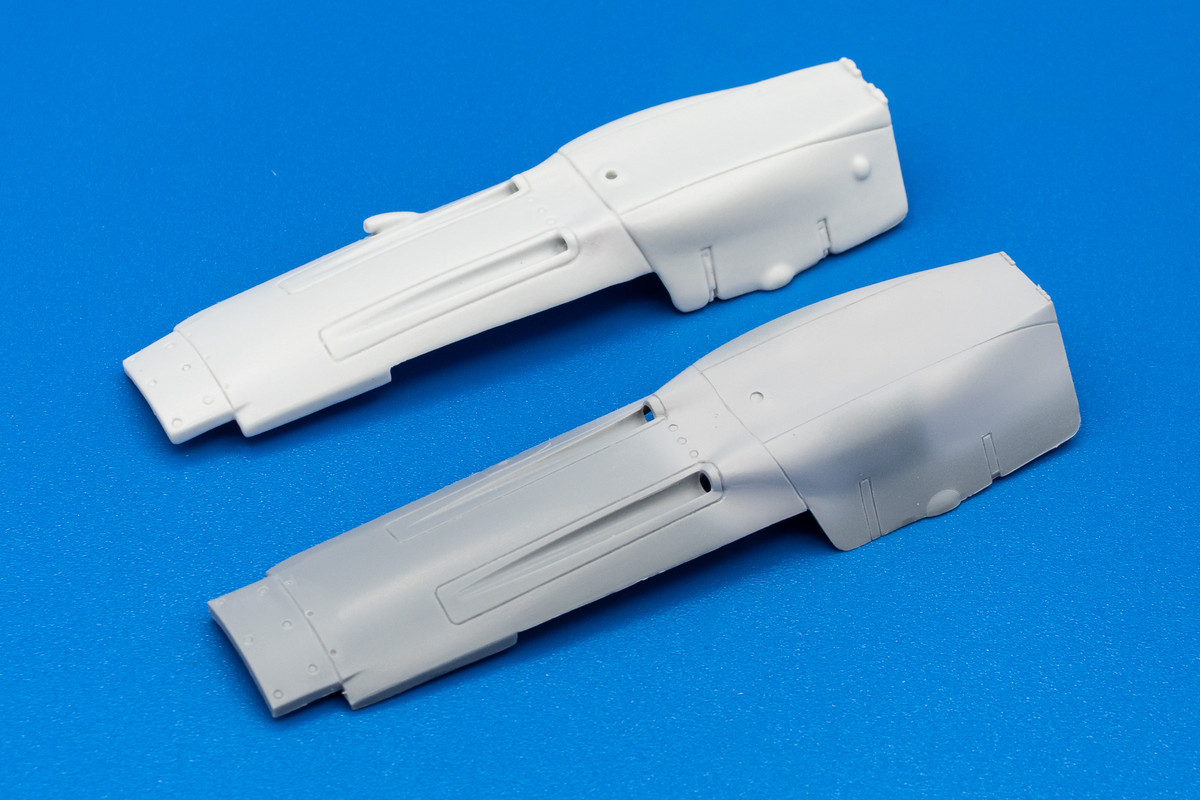

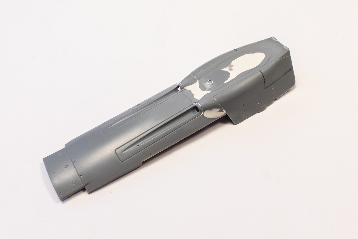

Here is the gun cowling after puttying around the starter hole crank.
After the sanding, I put a coat of Mr Primer Surfacer on the cowling to check my work.
It needs a bit more refinement to get rid of some barely perceptible edges but I think it is a big improvement from the original kit part.

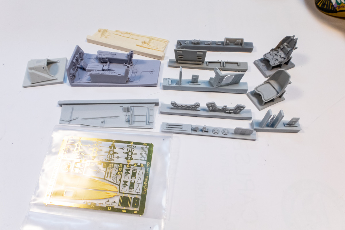

Let's take a look at the Eagle Editions resin cockpit for the 190D. I think it is the best cockpit upgrade on the market but it is not without its faults. It's a comprehensive set of resin and brass components. Note the difference in the resin colors. There is inconsistency in the casting quality and from conversations with Judy Crandall, I think they stem from different people doing the castings, hence the different colors.
The cockpit tub is cast in a bluish grey color and casting quality if great on this piece. Nice and crisp with no visible warping or air bubbles.
In the past, I've requested replacement of broken or shortcast resin parts from Eagle Editions and Judy has always been very responsive. Because of that, I have multiple copies of certain components such as the sidewalls. None of them are perfect. The grey sidewall below has some warping and the yellow one, while much straighter, has very prevalent cracking in its surface texture. I elected to use the grey part, which is easily straightened following a dip in hot water.
Two seats are provided, one with seatbelts and one without. I'd be tempted to use the seatbelted version if it were cast better. The details are just too soft for my tastes. Also the thickness of the seat itself is bothersome.
I gave the seat backs a good scraping and sanding to get at least the edges sharper.
The Revi 16B reflector sight is nicely molded.

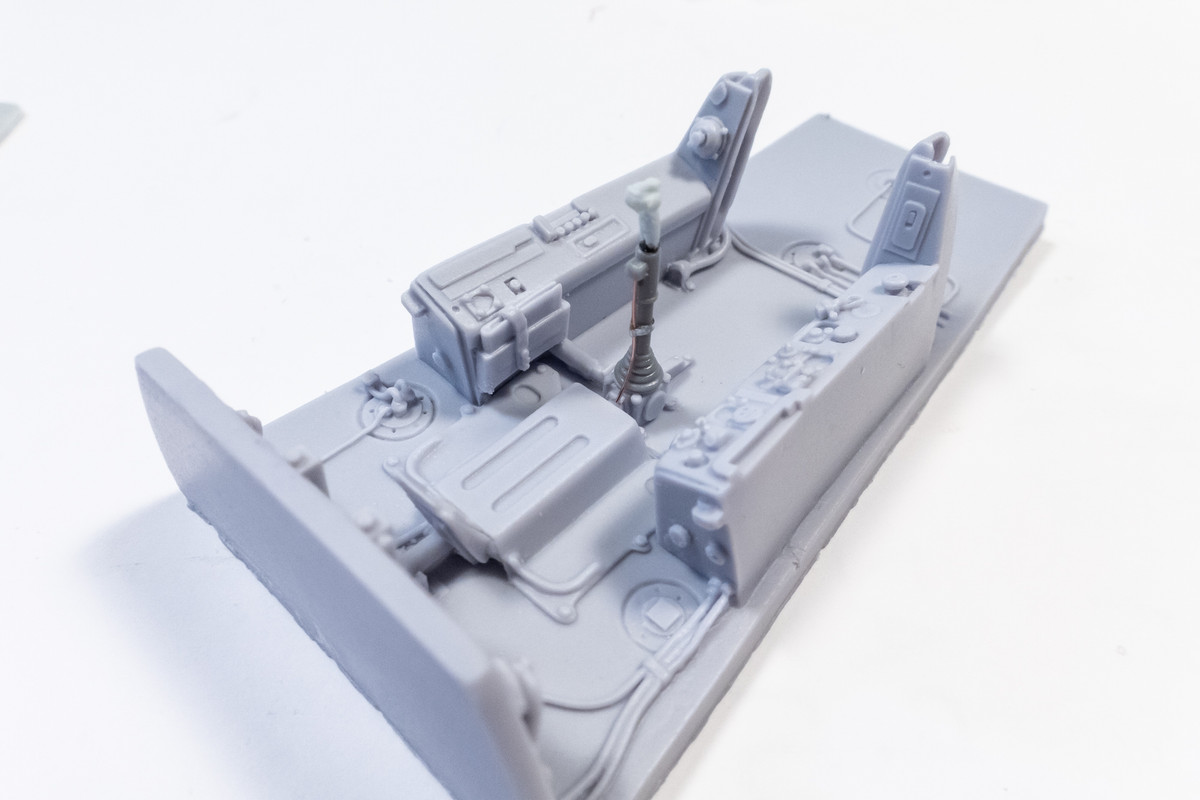

But the control stick is not. It looks lumpy and to top it off, the grip is skewed to one side.
The rear decking had multiple issues. First of all, it must've shrunk because it was way undersized and would not catch on the rails on the inside of the fuselage, even with a thin section of casting block still attached to one side. There was also a congregation of bubbles in the front of the deck resulting in a jagged hole. The hole was plugged with black CA glue and I added width to the sides using strips of sheet plastic.
Now it fits the way it is supposed to.
All of the parts have been detached from their casting blocks. This is not a plug-n-play set and I'll need to perform some surgery on the fuselage to make this cockpit fit.

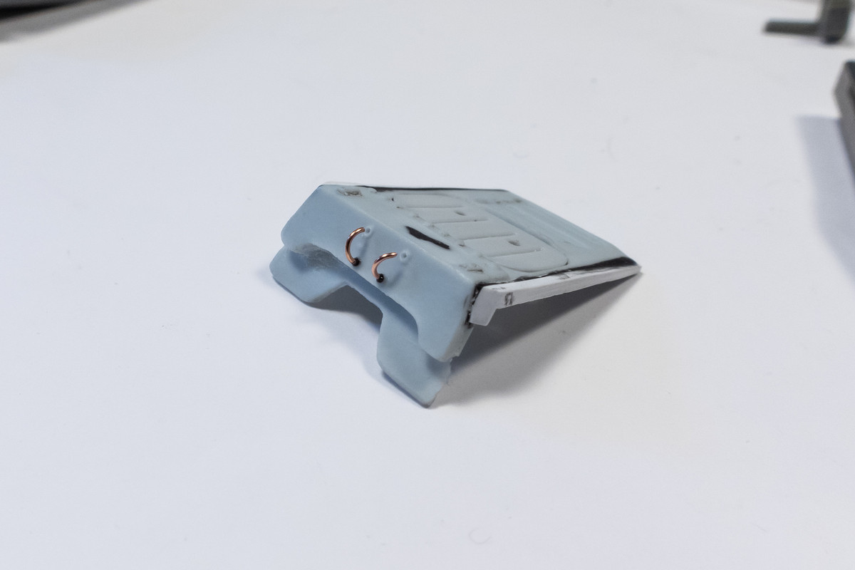

I frankensteined the control stick by gluing the resin hand grip to the kit control stalk. I added a wire and a strap of aluminum tape to finish it off.
Small holes were drilled into the back deck.
Semi-circles of copper wire were glued into the bottom holes. After the seat is painted, I can hang the HGW shoulder harnesses into the into the open end and then close the loop.

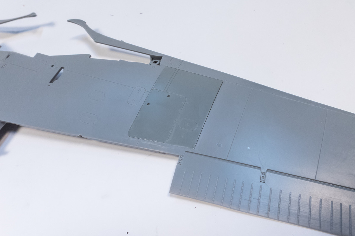

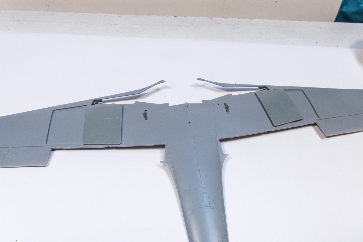

The inserts for the bottom of the wings are glued into place at this point. The outline of the inserts do not correspond to panel lines so some filling and sanding will need to be done before I start the riveting process.

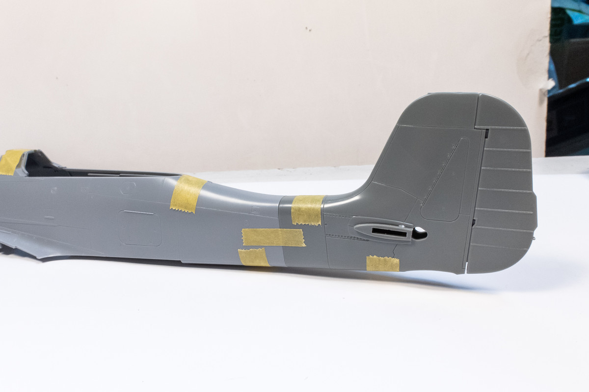

A check of the tail wheel placed into the tail unit. Based on photos, I think this is overextended for an operational aircraft and I'd like to have it poking out less. But with two connection points, I can't get my head around the math to do this without weakening the connection. I think I'll just order the Eagle Editions 190D tail wheel. Height is easier to adjust and since the wheel is separate, it will be easier to paint and orient the flat spot.

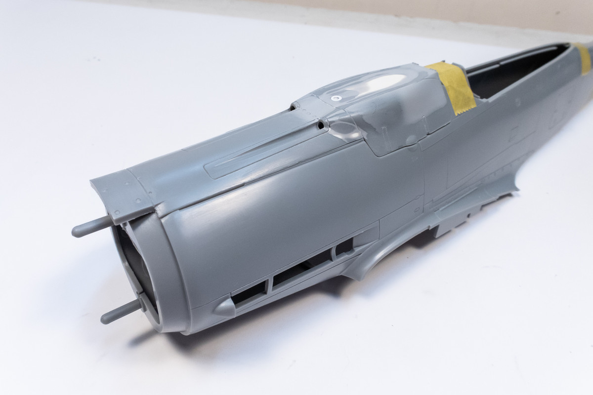

The tail unit fits pretty well into the fuselage. Like my other Dora builds, I am going to glue the fuselage and tail together before joining the halves. This will ensure better fit and simplify the riveting process.
The gun cowling re-sculpting is finished and the it fits perfectly.

The underwing insert joints have been dealt with using a combination of black CA glue on the non-panel lines and white Milliput on the panel lines.
