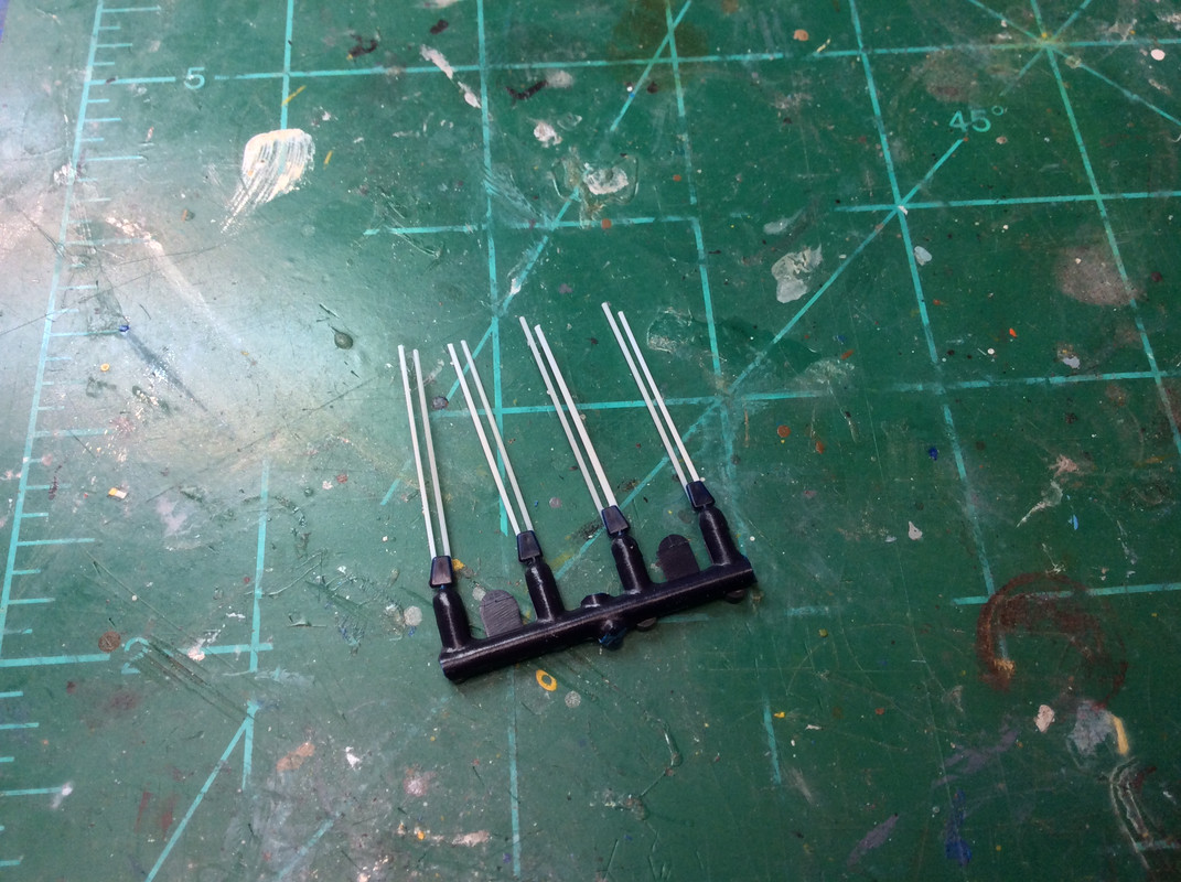

One of PE brace wires snapped as I was gluing the fuselage halves together last night. i knew it was bound to happen. So off they all went. Thankfully, I had CA debonder on hand.
Looking at the sprue tree, there are 4 braces from the original molds and all I had to do is stretch some wires using scrap sprue to desired thickness enough to make it look rigid, not flimsy and too thin. That’s has been done and am happy with the thickness to simulate rigid wire bracing.
Once I cut them to size, they will be glued to the braces at some point over the weekend.
Once that is done, I’ll have to redrill the holes for them to fit into the holes on the fuselage on both sides. I’ll make sure to leave enough length to fish it thru the holes as I reattach the brace to the floats.
I am going to skip on using PE steps since I have the original ones on the tree. The grasp handles, will be the only last piece of PE I will use.

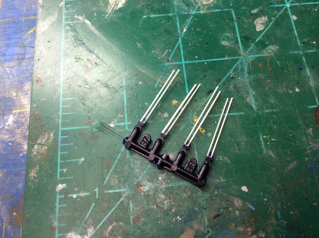

Here are the new float braces...
These will will face the inside towards the main float
These will be facing on the outside...

Nicely done.
