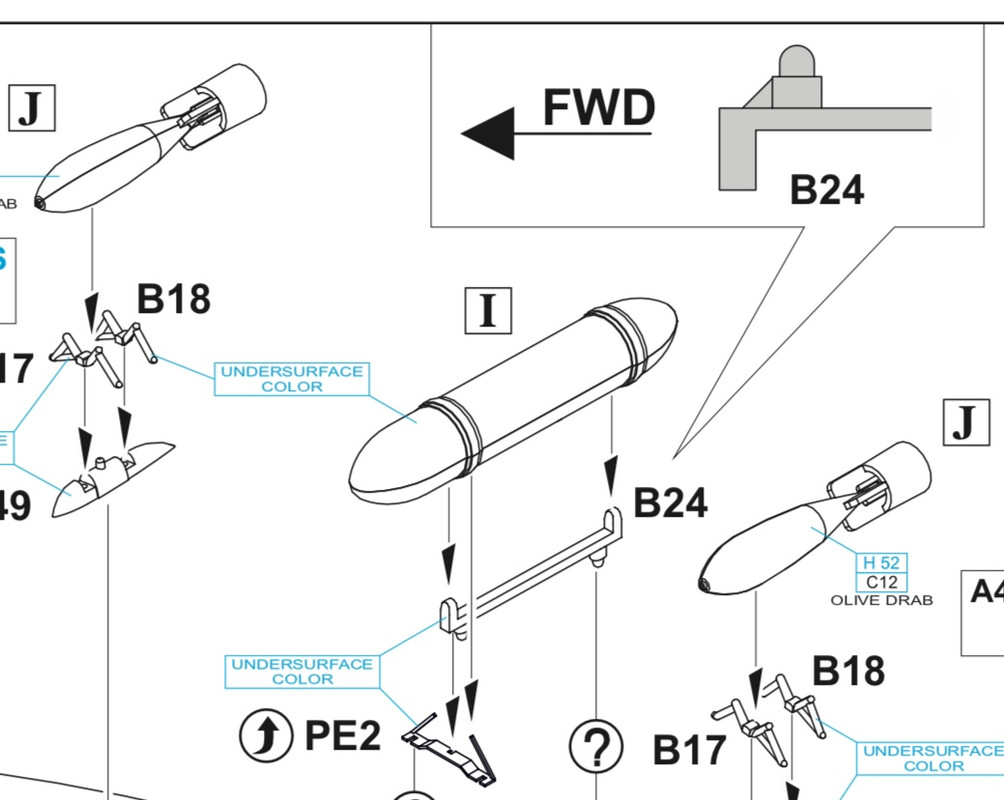

Eduard PE/Plastic Centreline Tank

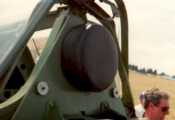

Pilot’s headrest and protective armor plate.

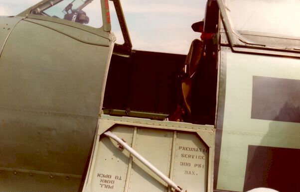

Entry door with prominent escape crowbar.

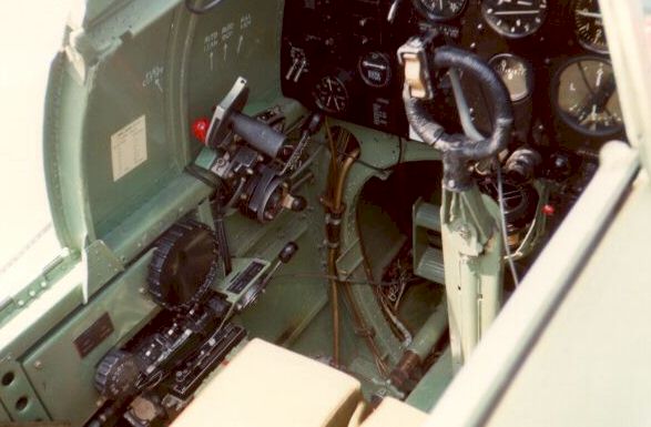

Cockpit almost in original condition except for the modern seat cushion and some radio wiring beside it. Note that there is no solid cockpit floor, but only two moving circular bars connected to the rudder pedals in the front.
Another view showing the spade grip-style stick. The button on top of the grip is the compound gun trigger, serving both cannon and machine gun armament. Mounted to the horizontal fuselage frame on the cockpit sidewall is the throttle control (the item with the red handle).

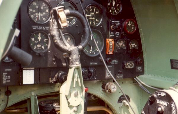

Instrument panel in original condition.
