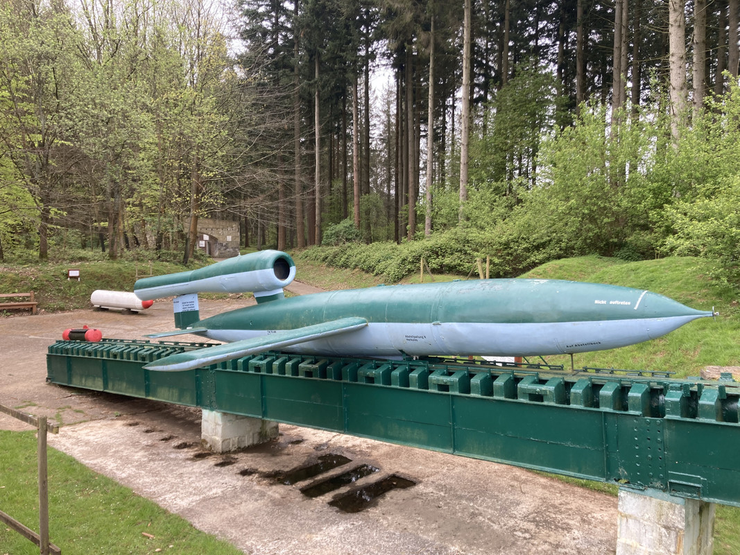

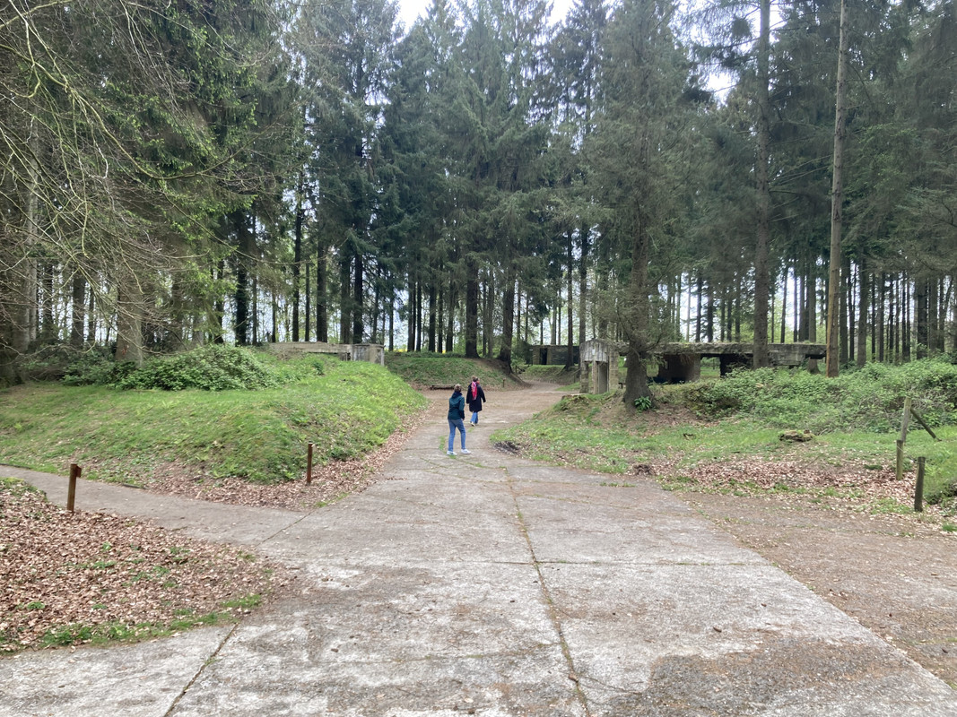

I am currently on holiday in Normandy. And today we visited the V-1 site at Val Ygot. The Tempest was one of the planes used to intercept V-1’s. So that was a nice link with my current build.

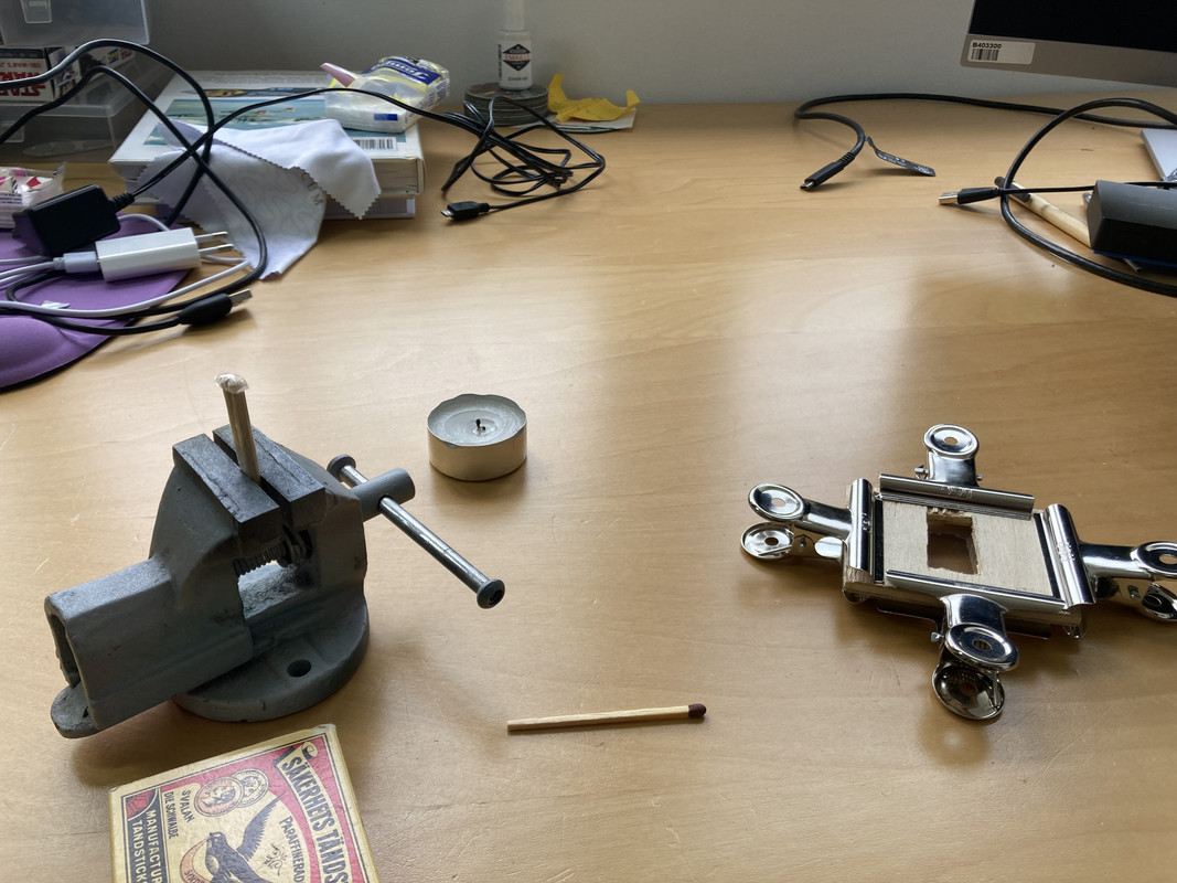

Some more progress, I made replacement canopies. A simple push mould. Success rate was 2 out of 5.

Stikpusher wrote: ↑Wed May 01, 2024 10:45 am Is there a tutorial you could steer me towards for push molding canopies?
Sure.
What I do a very basic, use the old canopy as a mould.
Put some clear plastic on a frame (the smaller/precise the the cut out out is the better the result).
Heat the clear plastic over a flame (like stretching sprue you need to get a feel for it. To cold, it won't form. To warm, it turns white or tears)
Pull the frame over the mould
I some times pinch the warm plastic to get it to fit tightly over the mould (you might burn your fingers but that is the risk over using to large a cut out)
Cooling off is in 10 seconds
Repeat until you have a good part.
A more elaborate tutorial:
https://www.britmodeller.com/forums/ind ... t-so-good/
He uses a bit more sophistication with a very precise cut out.
Next step could be vacuforming which I have also done.
