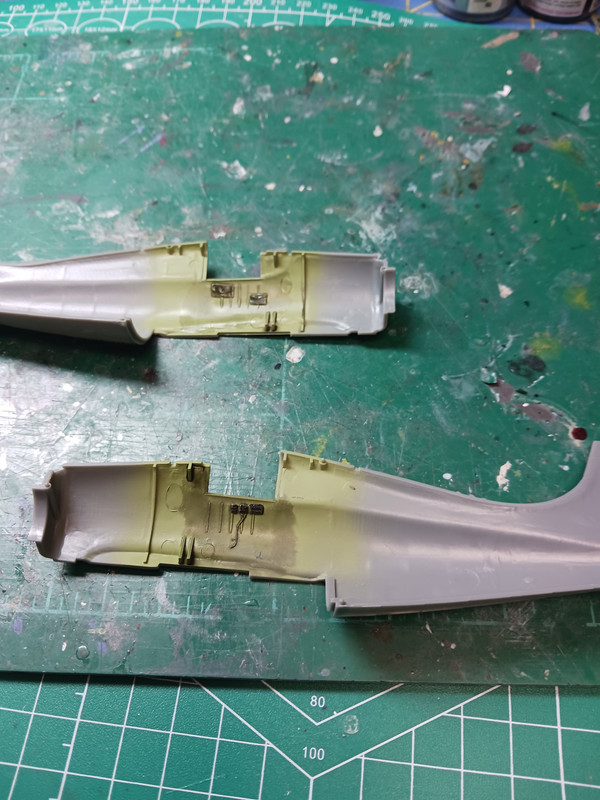

What's been done thus far...

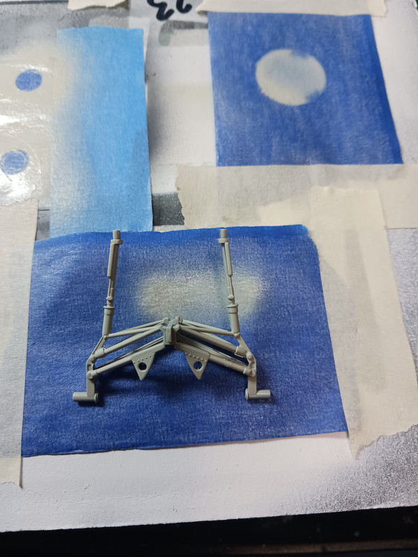

Inner framework for landing gear wheelwell. This assembly was a bit of a challenge. Used Testors tube glue. Super glue on smaller framework in middle attached to V frame.
Main landing gear consists of 3 parts. Not too complicated to do. Super glue was used. I need to paint back side of framework before painting the black of lower areas of landing gear.

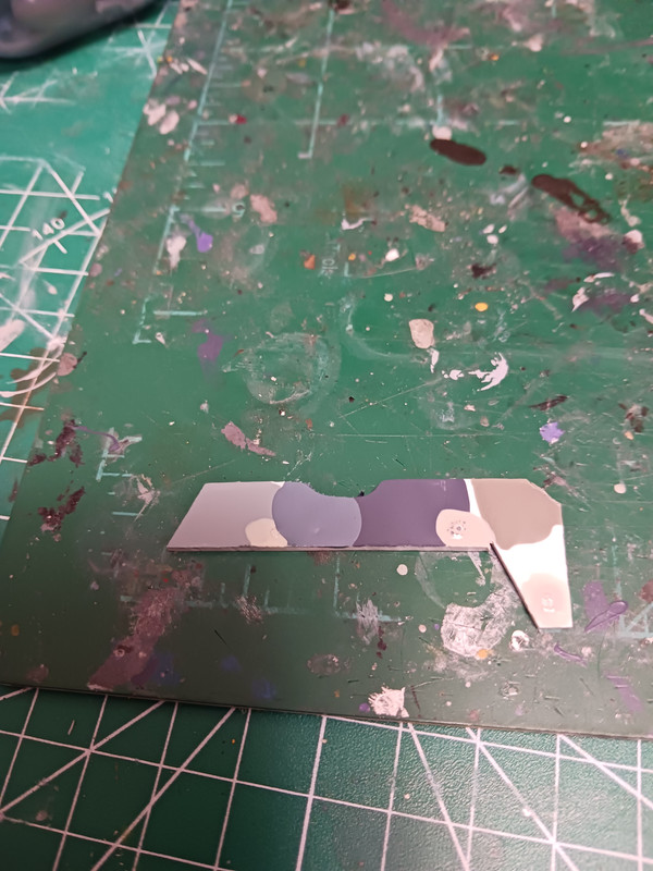

Here's my paint samples on scrap styrene sheet; left to right:
AKInteractive Real Colors M-485 Blue Grey
Model Master Navy Blue Grey - this is the color I've decided to go with
Model Master 5-N Navy Blue

Looks like the AK Blue Grey would be good for fading areas of the Model Master. Just looking at the bottom of the bottles, my Model Master Blue Grey is a bit darker than the Pollyscale.
- Posts: 13596
Re: Tamiya F4F-4 Wildcat
I agree AK Blue Grey would be good for fading areas. I’m thinking of experimenting using both to see if I can do some fading technique. It’s funny how one brand can be darker than another brand. Some brands can be waaaay off in terms of shades. It depends on what look you’re looking for on the subject.
