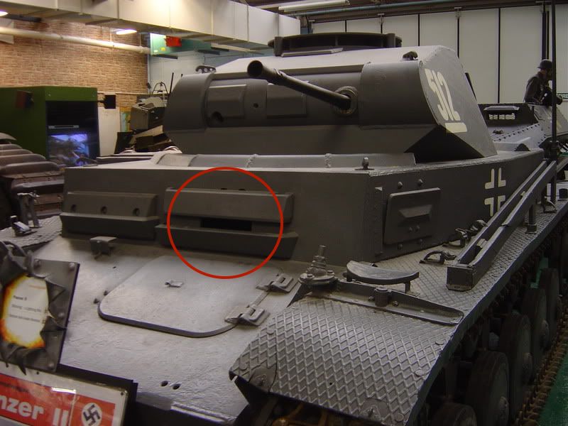

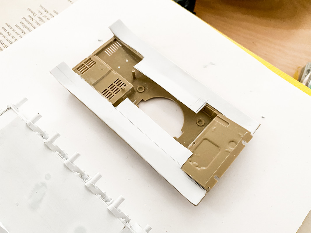

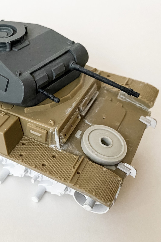

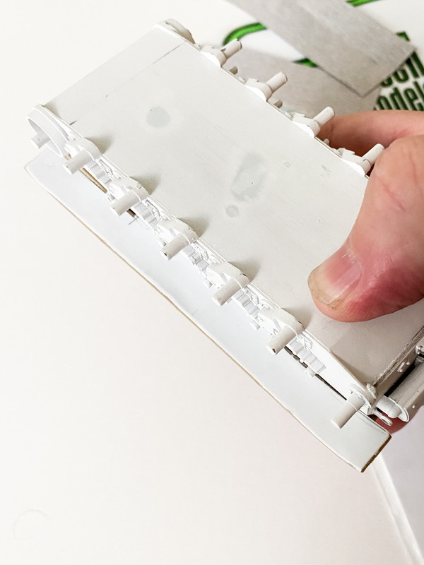

I used thin plasticard to skin over the interior fenders (photos) I also carved out the driver opening (photo of actual tank below). I have some heavy plans for modifications to the spare drive wheel. Tamiya’s version of a spare did not work for me, so I am giving it an upgrade. I am enjoying what I do.
Before - why spend time filling holes? Because it is more realistic.
What it looks like halfway skinned. Much more realistic; even has stress areas like the actual ones.
Driver’s view slot
TGIF
Driver’s view slot

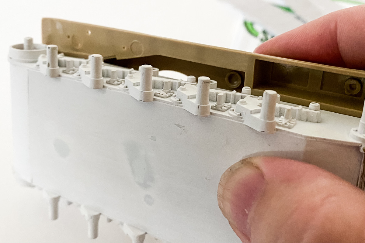

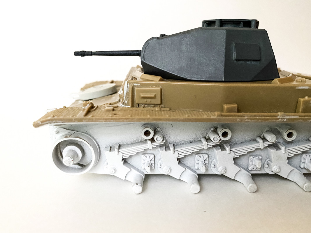

I glued the top deck to the hull last night, good solid connection using thin CA for maximum hold with little to no expansion. I noted that the upper deck rear tab (removed by me) left the upper deck slightly bent or twisted upward. I used my steamer to re-torque the deck to fit the hull better. Now I plan to fill the open seams between my “skin job” and the hull itself with Milliput before I move to the color coat. I usually wait at least a day with any major step of gluing before proceeding. I hope by tonight I will be able to add the putty.
A couple of interesting notes: I never tried sharpening X-Acto blades before, but I did so last night in with an old, well-used, ready to be trashed one and I brought that back from the beyond. Nice to not have to toss it. I also figured out if I roll or twist putty into narrow tubes it is far easier to use.
