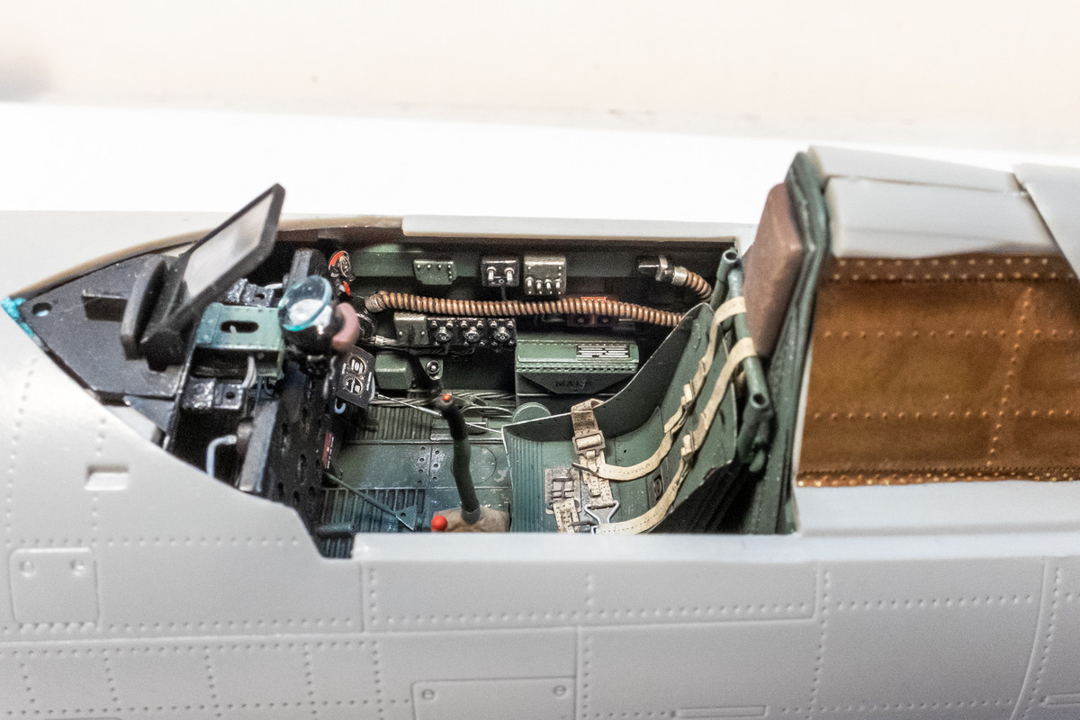

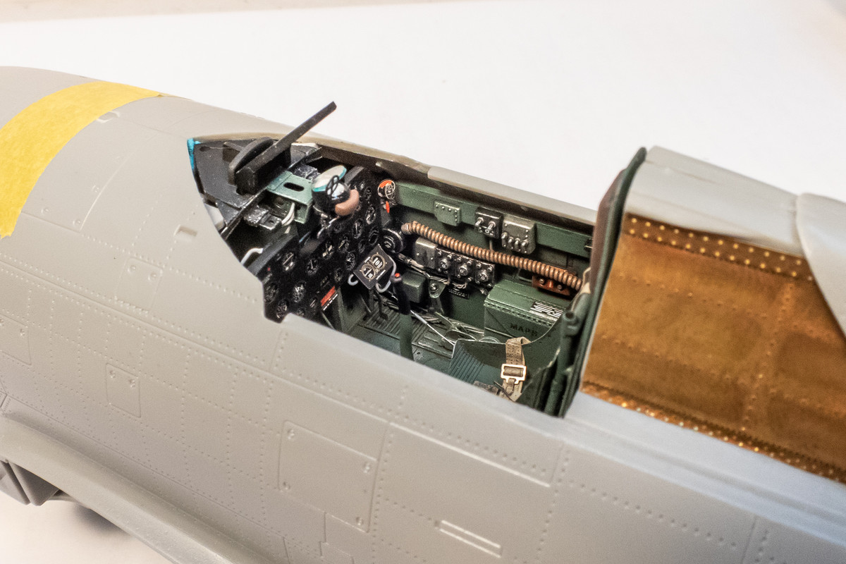

I painted the rudder cables silver to make them stand out more.

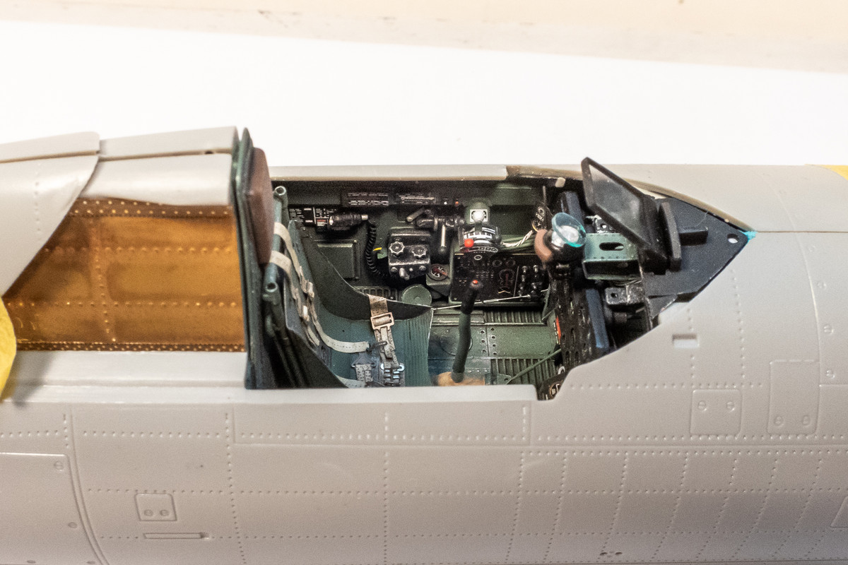

After the rudder cables were situated, I could now add the seat.

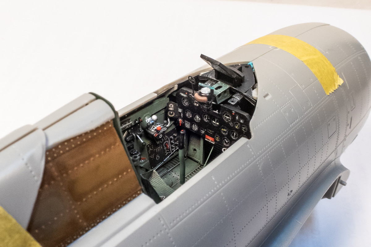

The rear bulkhead is then glued on and the cockpit is complete! Here is what the cockpit looks like in place with the previously completed gun sight.

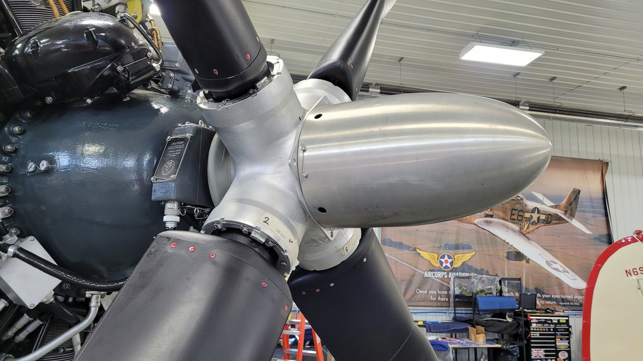

I've decided to add a few more details to the front of the engine. The propeller governor is missing. I have a spare resin governor but this one is for the Hamilton prop and my bird is running a Curtis prop. So I'll have to modify this one or scratch a new one.
Also missing is the brush assembly that is located behind the prop. The brush assembly uses the rotation of the prop to power to electric motor which control the prop blade angle. You can see these components in the photos below.
So I added the brush assembly to the prop shaft.
Here is what it looks like behind the prop.
Also scratched up an electrical junction box. The electrical cables from the prop governor and brush assembly will connect to this.
On the subject of small details, I've added a an emergency shut-off to the oxygen regulator. It's nestled just between the black regulator and the brown oxygen hose.

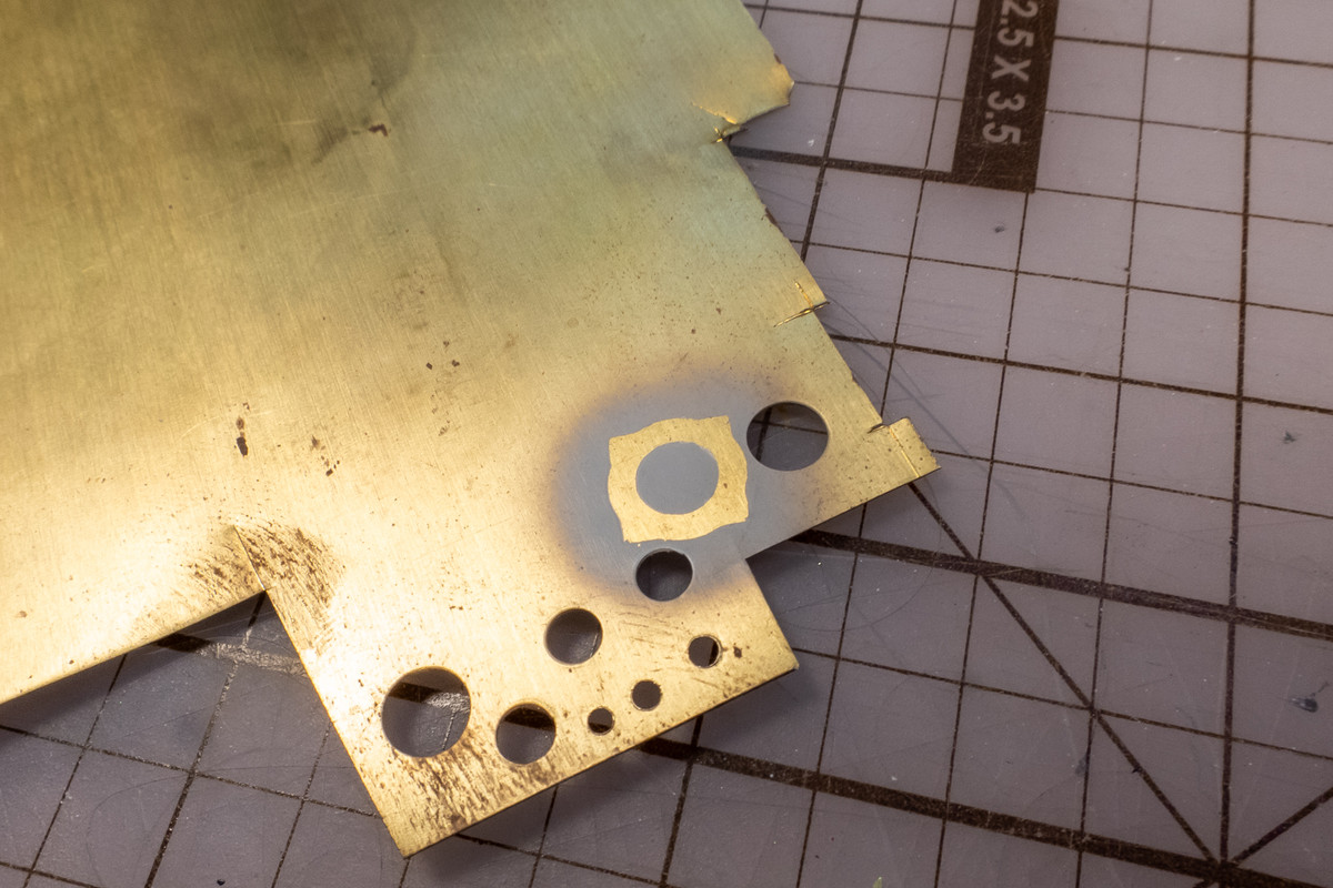

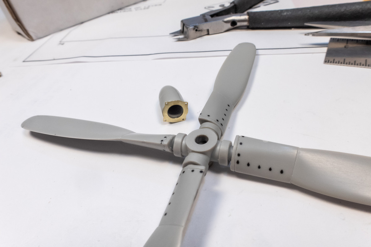

Working out some more details on the prop/engine area. Those photos I posted, in addition to showing the brush housing and prop governor, reveal a backing plate behind the prop nose cone. I drafted up a facsimile in AutoCAD and used a mask on brass sheet to cut out the pattern.
A small detail but it was easy enough to implement.

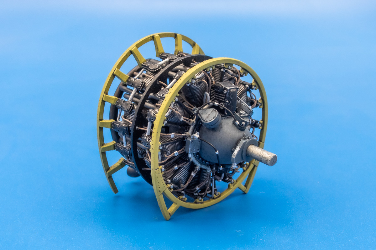

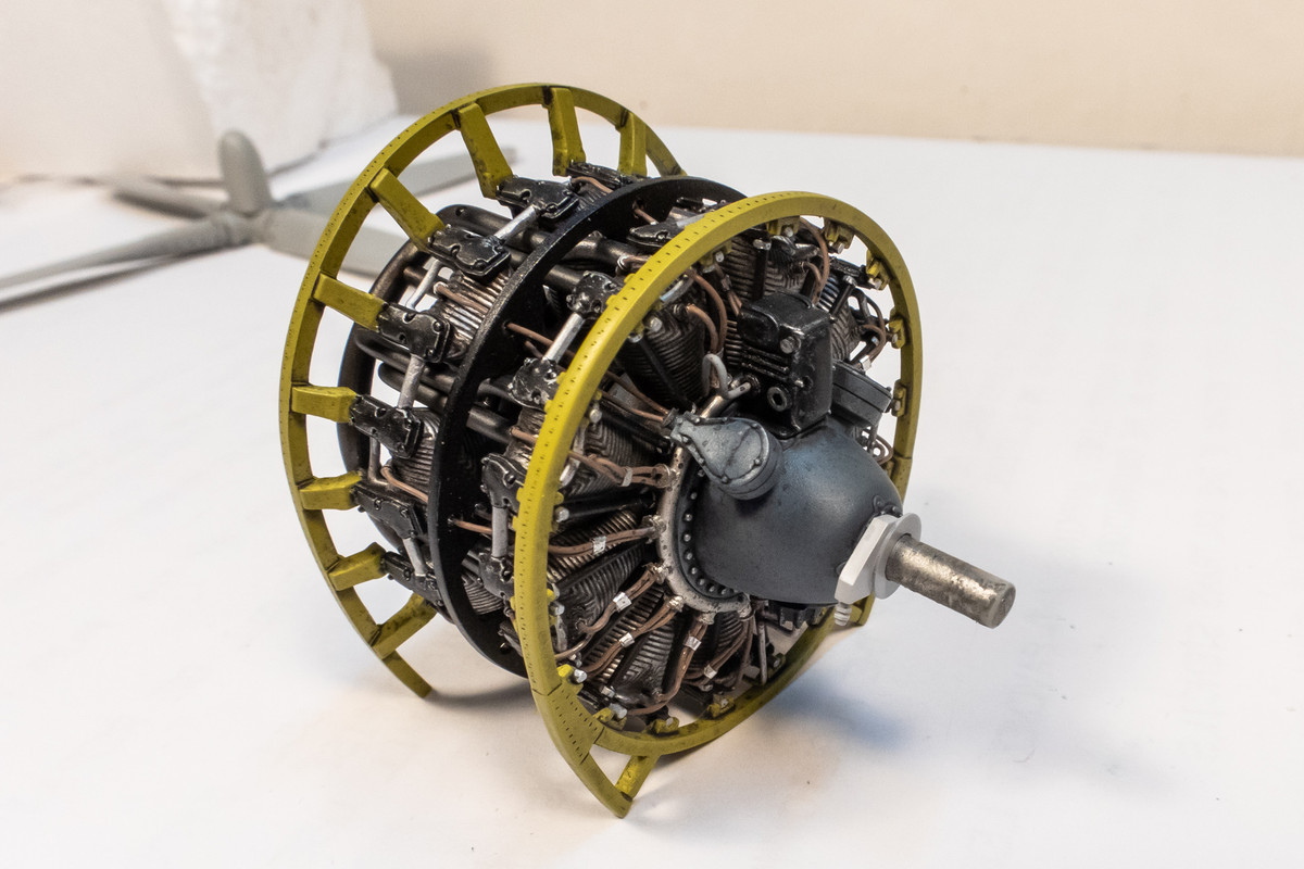

I scratched up a rough approximation of the Curtiss prop governor and connected the added components (governor, brush assembly and junction box) with lead wire. Here is the engine redux...
A side note and something that I didn't document but both the front and rear engine framing have broken during handling. Both have been repaired (the rear multiple times) and hopefully they'll hold up but I'm less confident about the engine being repeatedly removed from the cowling.

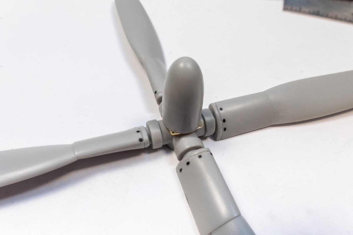

Here's the brush housing occupying what was once the bare space on the prop shaft between the hub and engine.

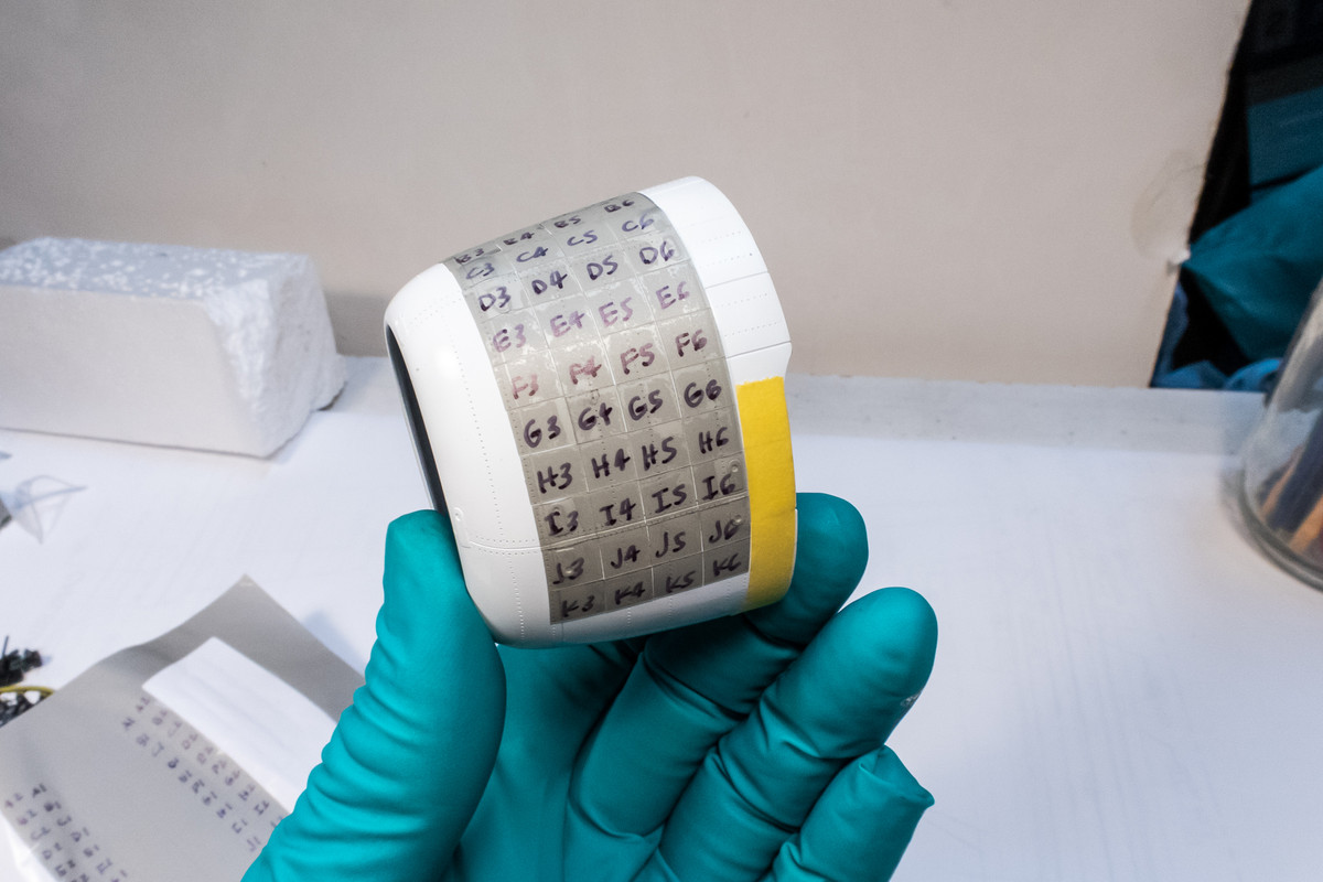

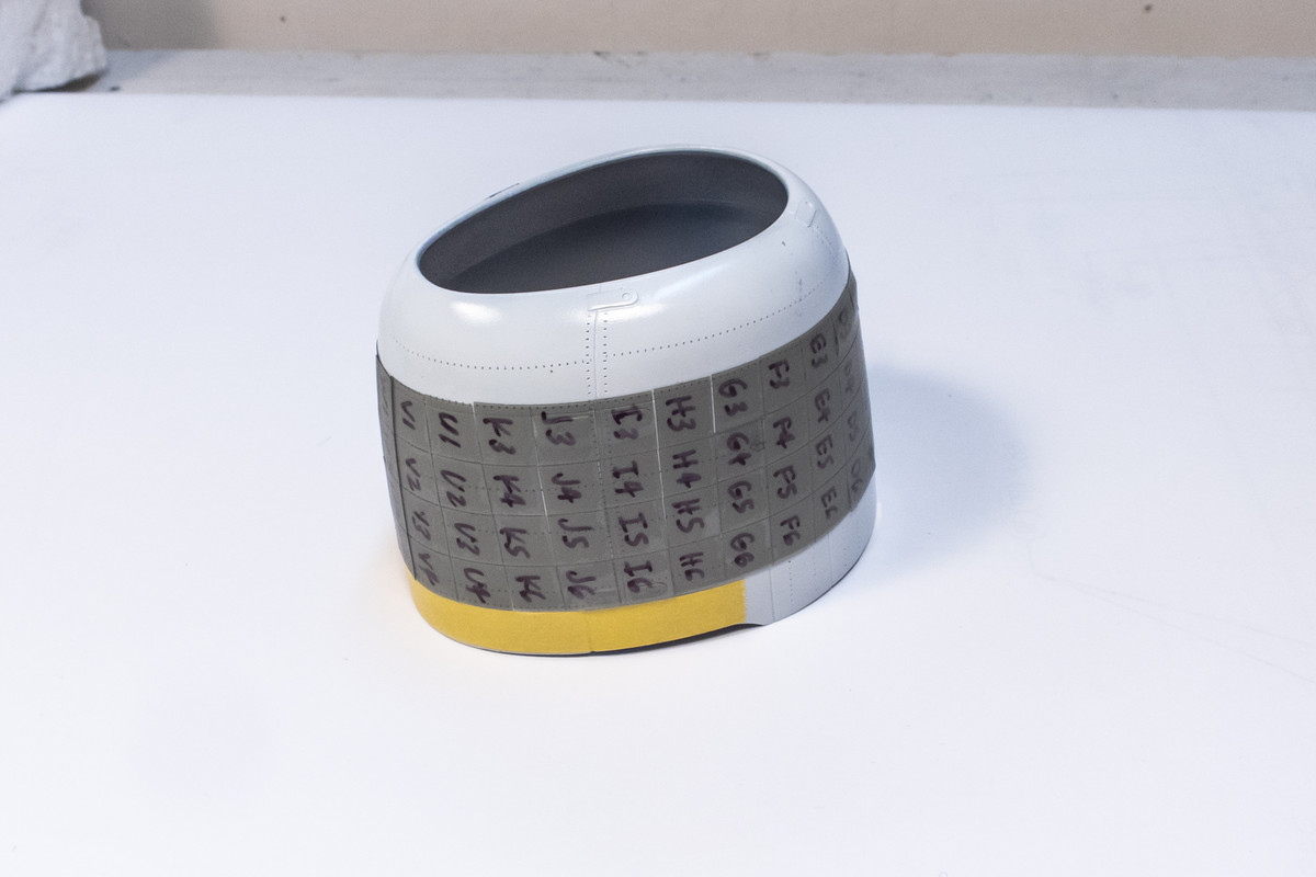

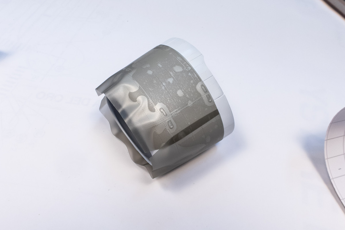

I decided to tackle the nose cowling checkerboard pattern. The cowling has been sitting for a while with a nice coat of gloss white, waiting for the checker painting. There are different ways of establishing a checkerboard pattern but since I had the Montex mask set, I thought I'd give that approach at try. But first, I scanned the Montex checkerboard pattern and created a custom mask so that I could produce more masks if necessary.
It appeared that the Montex checkers were designed in three components: left, right and bottom. To verify this and to check potential fit of the pattern to the cowling, I produced temporary masks of just the outlines of the three components and placed them on the cowling. Obviously, the vinyl mask material is not going to conform perfectly to the complex curvature of the cowling but it fit well enough to confirm the placement of the three components. I found that the bottom piece over-lapped the side pieces, indicating that the bottom pieces would not fit perfectly.

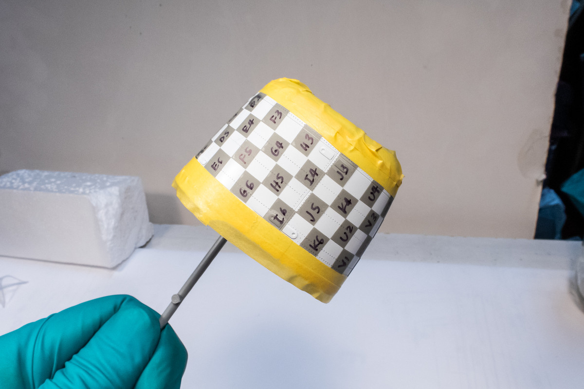

Using the top center of the cowling as the datum, marked by a piece of Tamiya masking tape and the joint at cowling flaps, I started placing the square pieces of the masks one by one. And yes, I labelled each piece of the mask for orientation and re-placement reference.
After a few rows, it became apparent that the square pieces were not fitting well around nose edge of the cowling so I elected to stop short by two columns. After the top row on the port side was established, the datum tape was removed and I used the masks already in place as the new datum for the starboard side.
Once I got to the bottom section, I verified that no, the pieces were not go going to fit as designed. Instead, I measured the remaining space and designed a new set of masks to fit that space. I had to do this twice since my original attempt had five rows and the alternating checkerboard pattern needed an even number of rows to work correctly so I made a new bottom section with six rows.

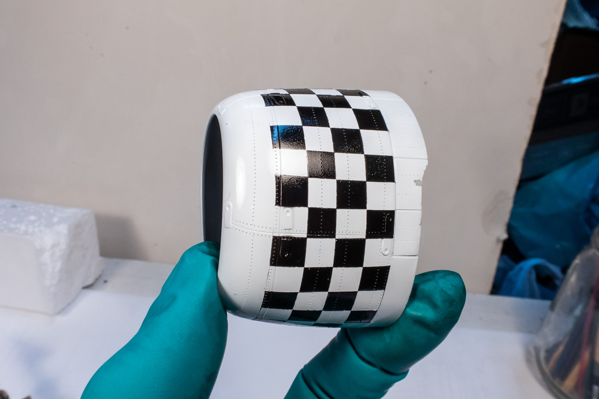

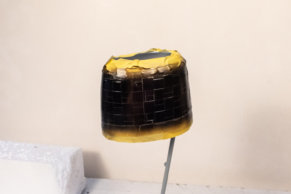

After all of the rows were in place, I started removing alternate squares to form the checkerboard pattern.

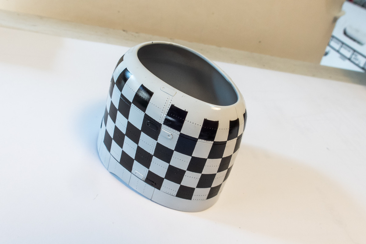

The front and rear borders were masked and Tamiya Black was sprayed onto the cowling.
Here is the result after the first coat of black paint.
The top was the messiest.
The top after some repair work. I think this approach is going to work!

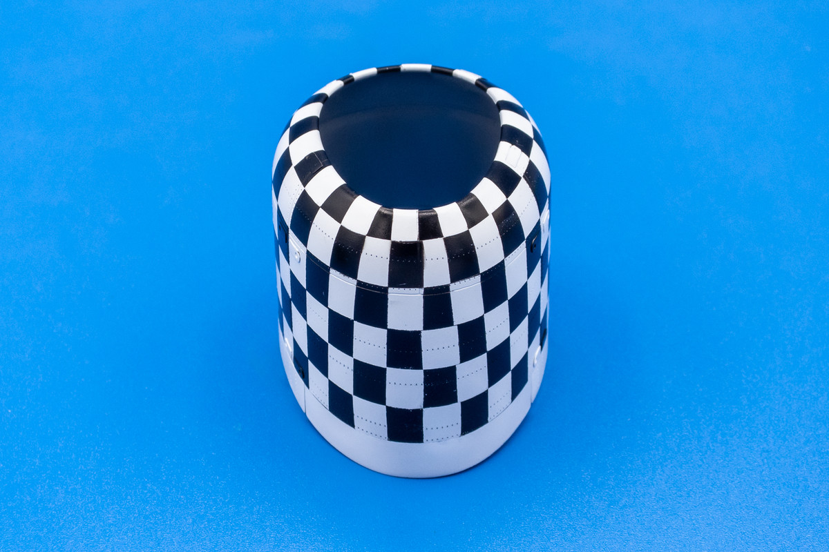

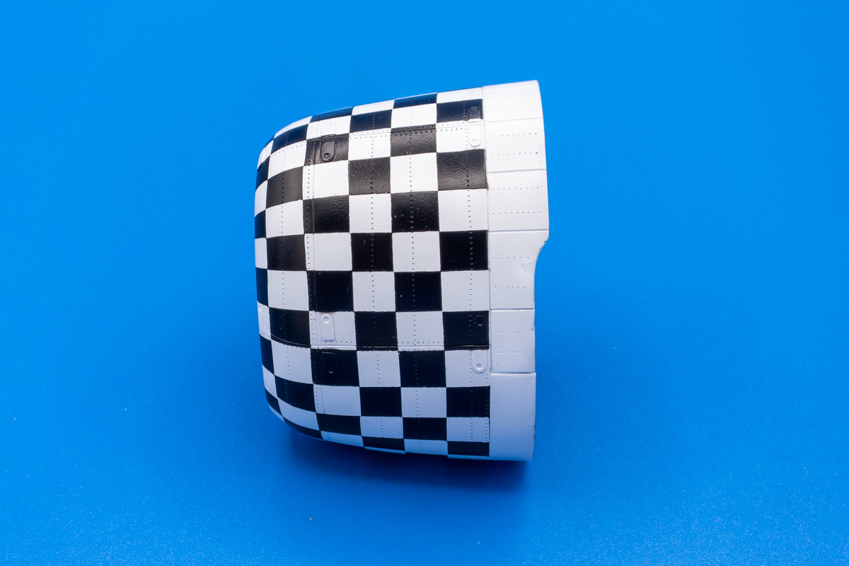

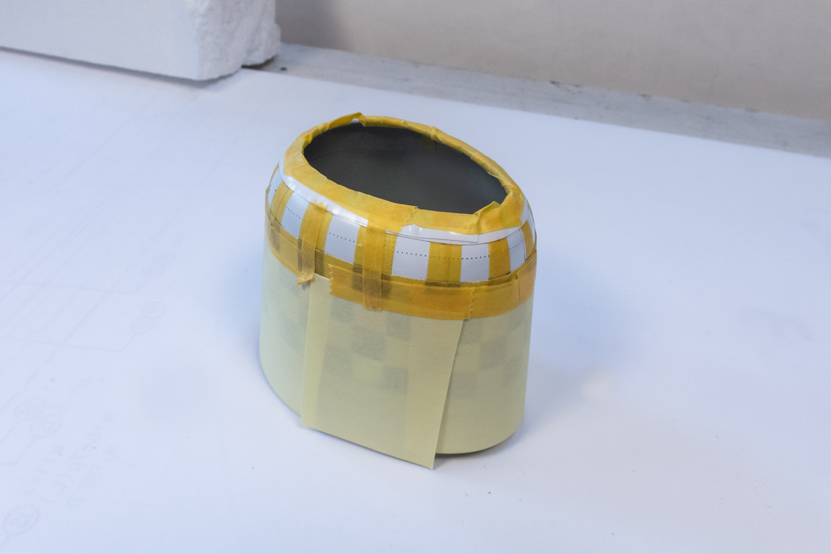

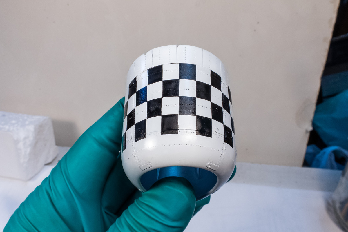

After touching up the checkerboard pattern that I had laid down, I let it all dry completely before moving on to the remaining checkers on the front part of the nose. I did this one row at a time and it was fairly simple to use the lines of the existing checkerboard pattern and extend them forward.
I masked off the interior of the cowling, which was previously painted with Tamiya AS-12 Silver, before finishing the last row of checkers.

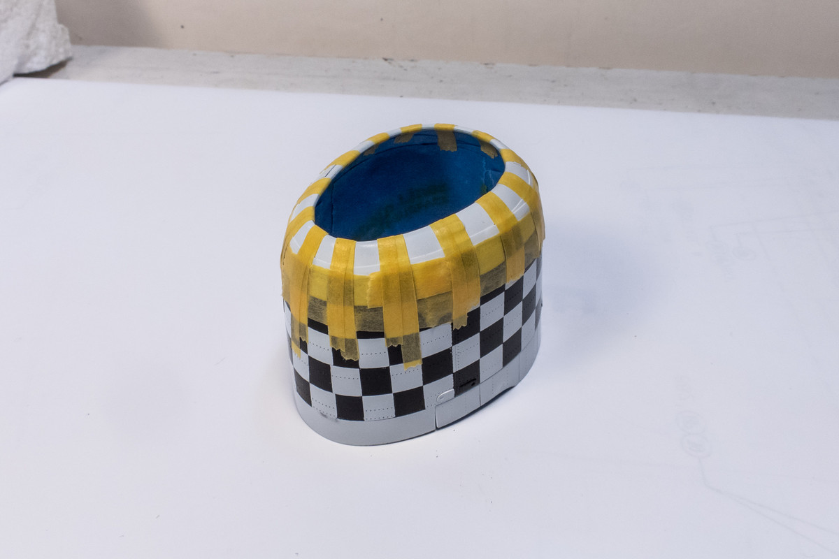

Here is cowling with the checkerboard pattern completed. This close-up photography is unforgiving so I can already see some spots where I need to touch up but overall, I am quite happy with how the checkers turned out. Especially the symmetry of the pattern as it is neatly mirrored from one side to the other. The transition of the pattern from the rear to the front is pretty smooth too and would've been difficult to achieve with the manual thin-strips-of-tape method.
