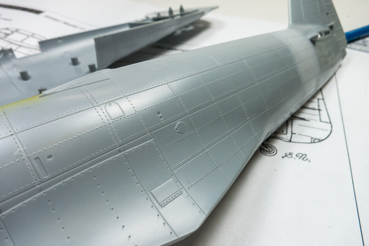

Thanks guys! The cockpit is basically finished but I can't put it into the fuselage until the riveting is done. I've been procrastinating on this for a while now because the Shiden Kai happens to have a ton of rivets. Now that I've received the New Galaxy rivet tool in the preferred 1.00mm spacing, I had no excuses left to fall back on.
The first step is to draw the rivet guide lines onto the model using reference drawings, a flexible ruler and a soft-lead pencil. Because there are so many rivets, the lines started smearing. I decided to hold off on the more tightly spaced "intermediate" rivet lines and get the main grid lines in first.
Once the lines are drawn, I simply roll the rivet tool over the lines. A decent amount of pressure is needed to make holes in the plastic and my rear fuselage joints buckled in a few places.
After riveting, I removed the pencil lines with Windex. At this point, I was thinking about leaving the intermediate rivet lines off. I mean, who is really going to notice?
Of course, I was compelled to complete the job and I put the intermediate rivets on as well.
At this point, the rivets are like little pimples... each hole is surrounded by a mound of raised plastic. I don't like how this looks so I try to sand off the mounds and leave only the holes. It's another step in the process but I think the results is worth the effort.

Man those rivets look great. One of these days I'll learn how to do that.
Rivets are pretty easy to do... just time consuming!
After the starboard side was sanded, I did the same to the port fuselage half.
One thing bothers me about the riveting process. All of the debris from the wet and dry sanding gets stuck into the rivets and by the time the multiple layers of paint go on, some of rivets get filled up and won't hold a wash. Does anyone know a good way to remove sanding debris from holes and crevices? I've tried soaking the parts in water but that doesn't seem to dislodge the stuff very well.
