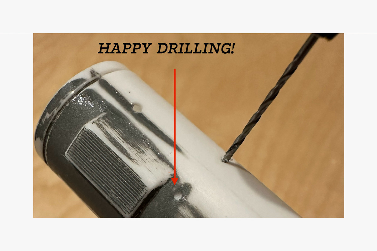

Finessing the two molding sink holes ie “dimples” by partly drilling them out. I’m hoping the additional hole will create a base plug type thingie for the CA fills!
Da brutal close up also reveals dee fill line of the CA. Okay, then. I’ll fix that shortly.
Post Script. I think I did it. I will look again tomorrow. It takes several fills to do this, but I think it’s done. I also smoothed out the rough area near that intercooler or whatever that molded box type thing is.
