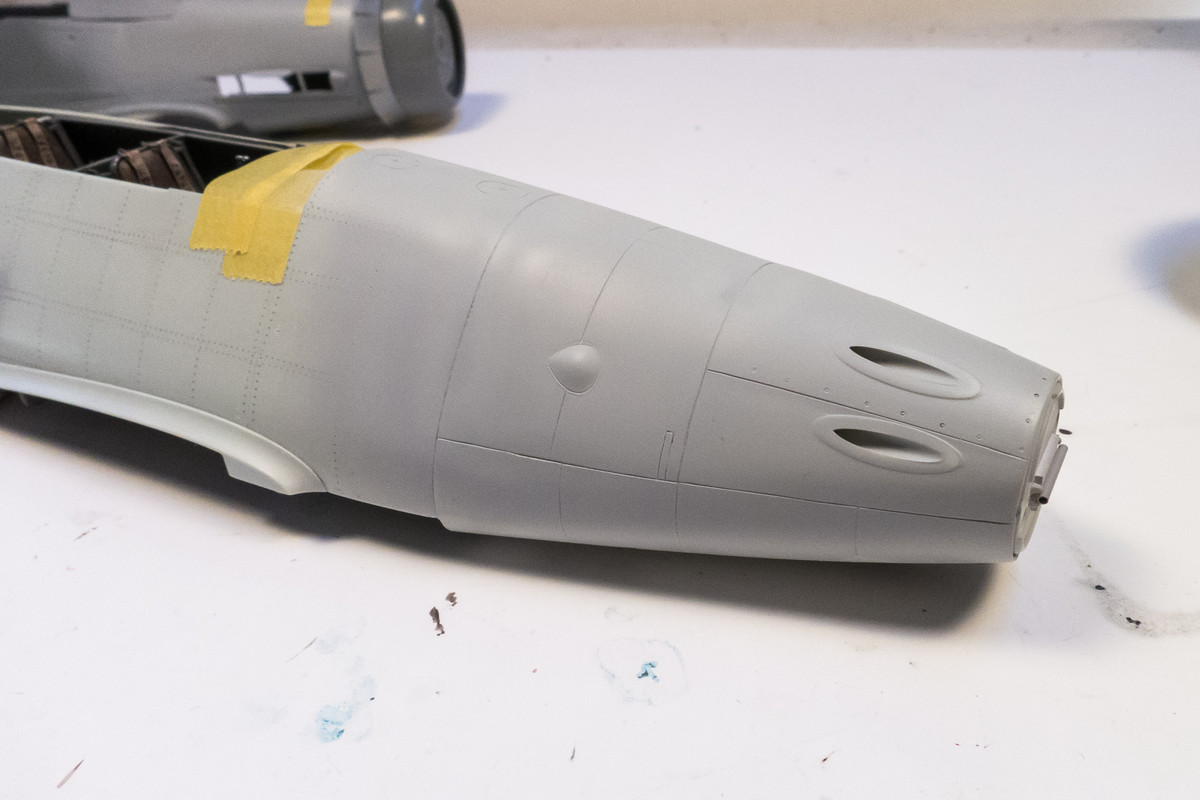

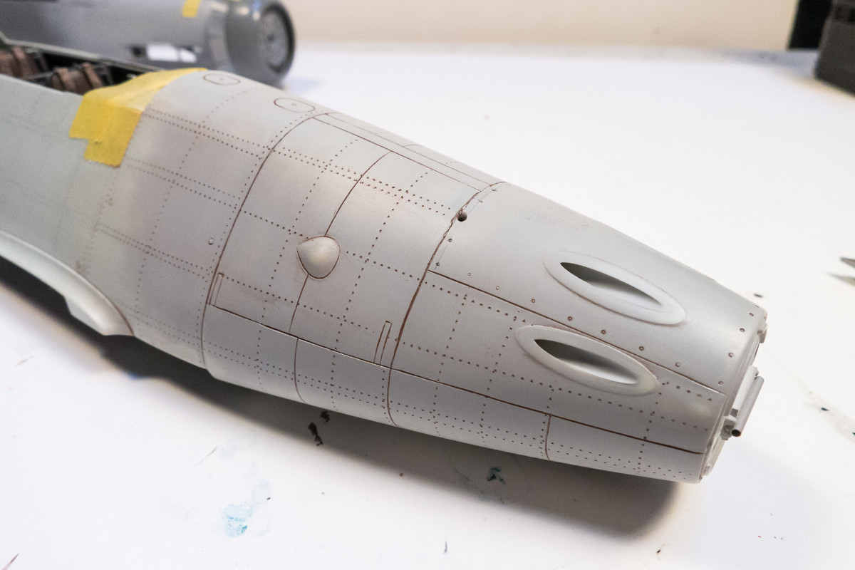

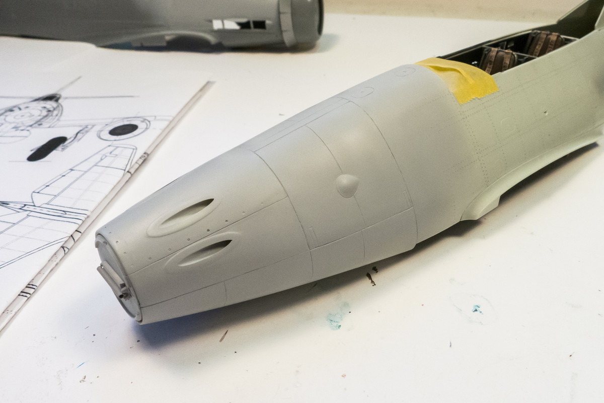

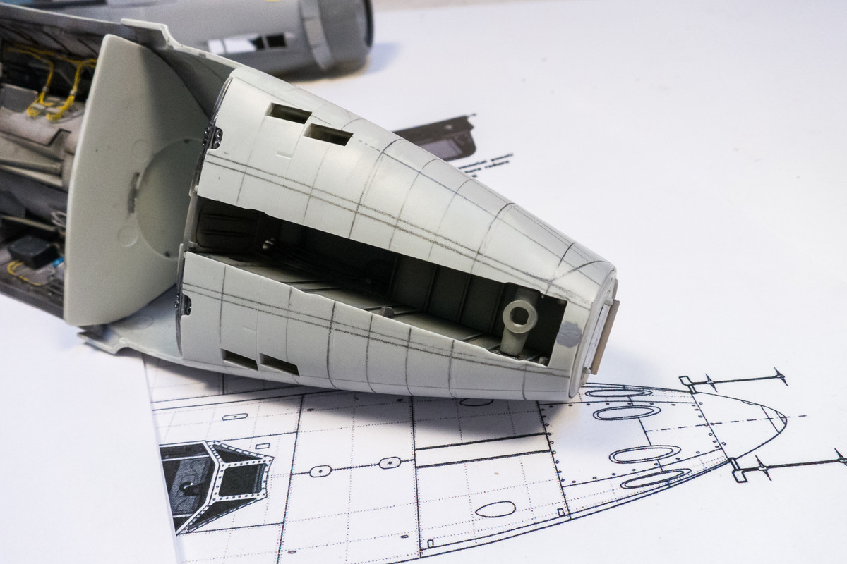

I finally made some progress on the nose of the 262. After the joint pop, I gouged out the seam a little bit and applied plastic sprue goop to (a) establish a better bond and (b) give me a more consistent base for re-scribing. I let that dry for a couple of days before sanding.
After that repaired joint was re-scribed, I was just about ready to call the clean-up work finished.
Far from perfect, the panel lines have some unevenness due to the scriber having trouble going through hard CA glue and soft putty with the same consistency. But I'm ready to apply the rivets.
A plastic straight edge, even a flexible one, is pretty useless when applied to his much curvature. And Dymo tape is too stiff. White Tamiya flexible tape fills the gap between the two very nicely, especially for the concentric rows of rivets around the cross-section.
Cognizant of possible weak joints between the nose cowlings, I riveted very carefully but still heard some joints pop open. In particular, the joint between the gun barrel openings and the removable gun cowling came loose but the results weren't too visible.
The pencil marks were wiped off using Windex and the nose area was sanded down to remove the raised dimples around all of the new rivets. The nose was then given a temporary brown pastel wash to check the scribing and riveting work. I was generally pleased with the result. Lines that didn't hold the wash were lightly re-scribed and some missing fasteners and larger rivets were added.
Things were going smoothly until I started to replace the larger rivets along the newly-popped joint. I knew the edges of this part were very thin and I had originally applied the rivets set back from the edge to avoid the thinner plastic. The sanding to fair this panel into the nose eradicated these rivets and they had to be re-applied. I skirted too close to the edge where the plastic was thin AND where the joint was compromised... and I punched a hole right through!
Other than that hole, I like how the nose looks overall. The stress of riveting is over so I used some Tamiya Extra Thin cement to re-establish the glue join and stuck a piece of sprue into the hole, welded into place with more Tamiya Extra Thin.
