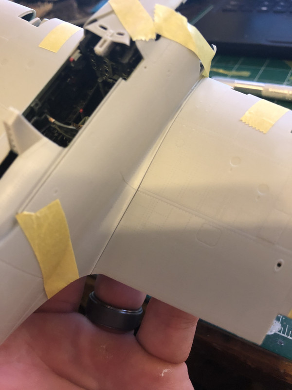

Firstly, the vertical stab and rudder: 50% FAIL, it’ll only go one way
BUT- it sits neutral so it doesn’t ruin the project.
Secondly, the flaps on the horizontal stab: 100% FAIL
as much as I tried to be careful with the glue when assembling that all together, I screwed the pooch somewhere along the line because they ain’t moving! The bright side: they sit at perfect neutral as-is so again, the project isn’t ruined.
I’m really glad I took mishaps into account when assembling the thing, and did it in such a way where if glue got where it didn’t belong, it’d dry with the control surfaces neutral. *WHEW*

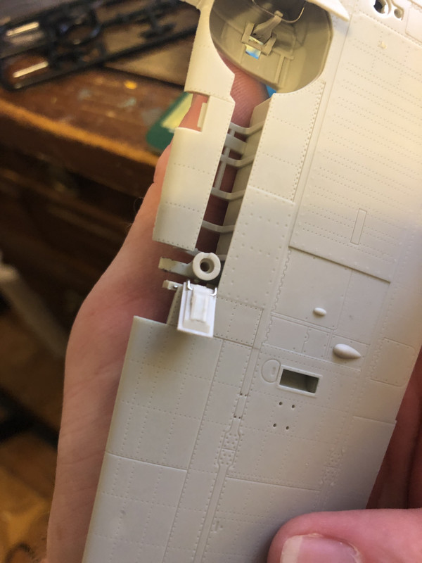

Here’s the gear bay doors open and closed:

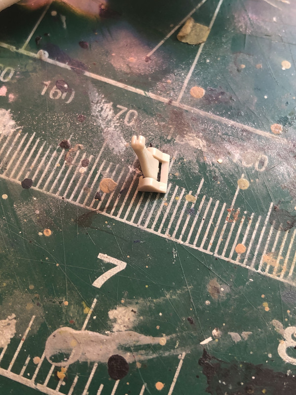

These little guys are held in place by fiddly little metal hinges. Installing them is not easy.
Next comes the little thingunmabobbers inside the gear bays that hold the innermost hinges:
Great care must be taken when installing these as that piece needs to be able to move freely so you can close those covers up. Very fiddly.
And again, I screwed up someplace because post installation, they doors will not close all the way:
Fellas that’s three strikes and I’m out, looks like! Interestingly enough, they still do move! So the good news is, I can leave them open, as was the plan all along. So there’s a bright-side here too! Looks like I’m still in the game!

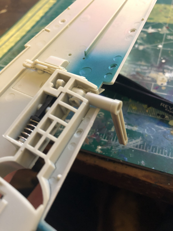

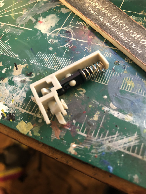

Next, here’s the mechanism that makes the gear retract:
The cylindrical piece on the left there holds the strut. Inserting a special tool over it and turning it allows a nub on the rear of it to push against the black piece and it slides back against the spring, giving a nice smooth action. Here it is, installed and doing its thing:
These WORK! Or at least they did during assembly. I left them in the gear-down position and haven’t checked them again. But I’m happy at least that I was able to assemble those correctly.

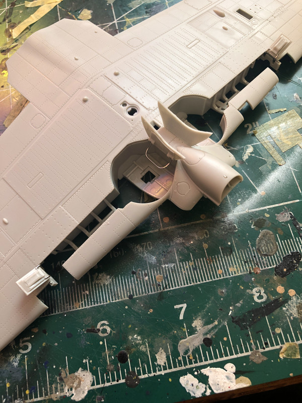

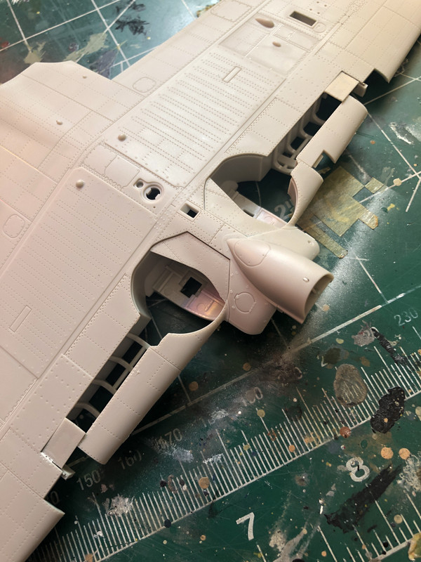

As to the bay doors, I’m disinclined to fix them as I never intended to display this bird in-flight anyway. So yesterday morning I pulled the trigger on gluing them in place in the open position because I didn’t want them wiggling around.

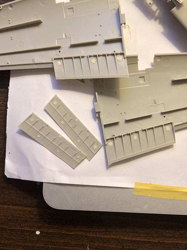

After that, I spent the rest of my time filling in and sanding down these ejector pin marks on the flaps:
I used Mr. White Putty for that job. I spackled a little at a time into each one with a toothpick, let it dry, and I’ve been sanding each one, one by one, ever since
