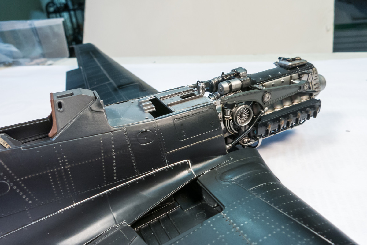

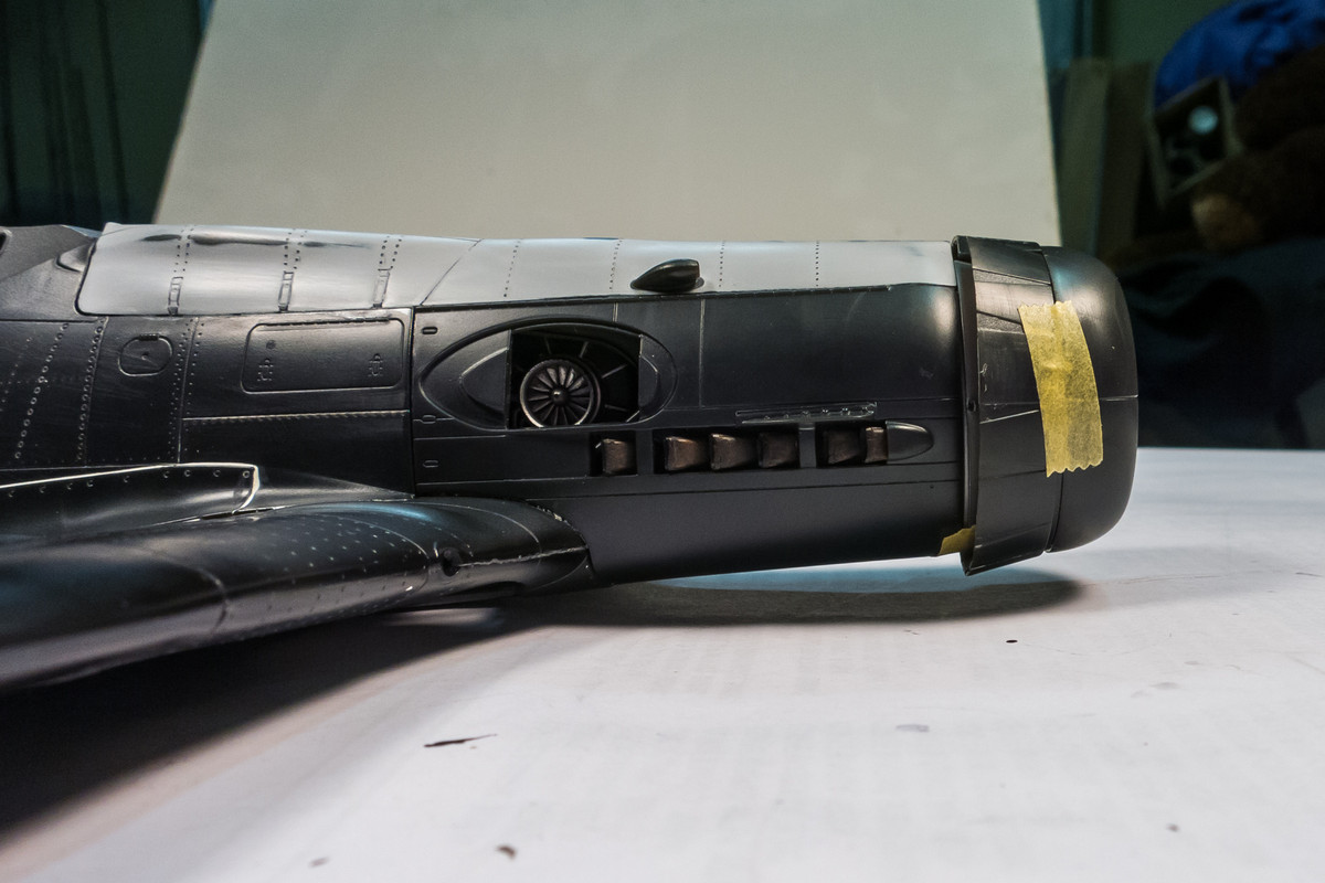

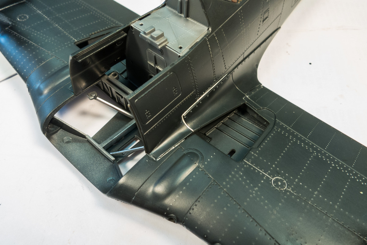

The instructions say the wings are to be attached to the fuselage before the engine, so that's what I've elected to do even though a part of me thinks that attaching the engine first might be the way to go.

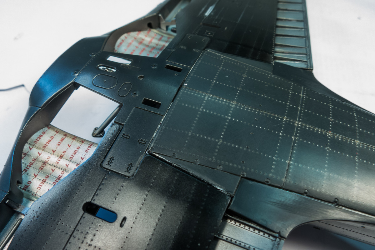

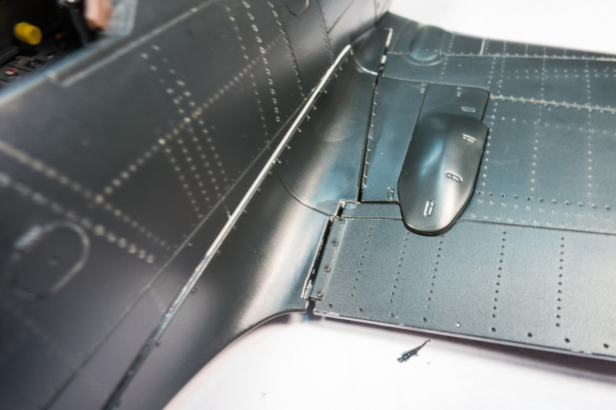

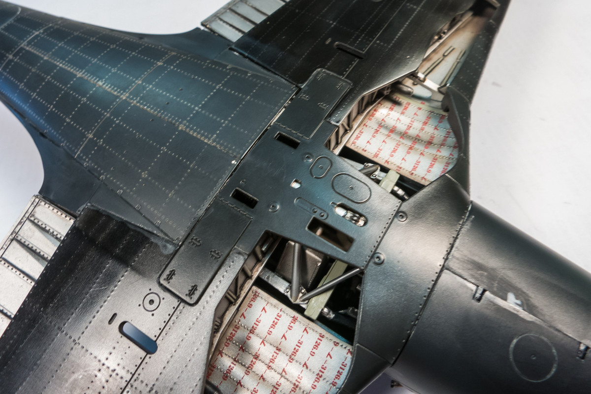

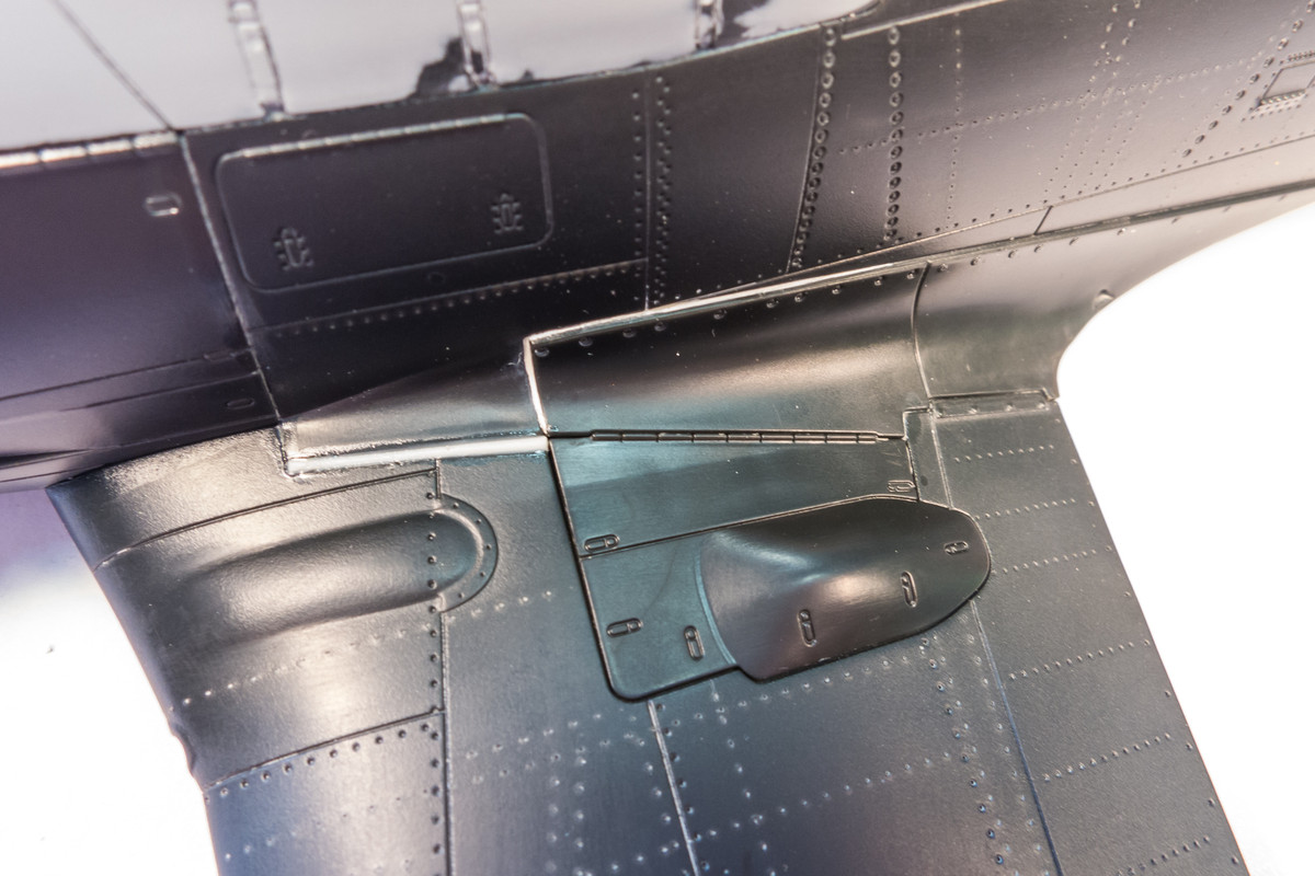

The fit is not the best and there are some significant gaps that will need to be filled with stretched sprue to increase the glue bond between the wings and fuselage. I am avoiding shims and closing gaps using force due to the fear of putting the engine and front fuselage panels out of alignment.

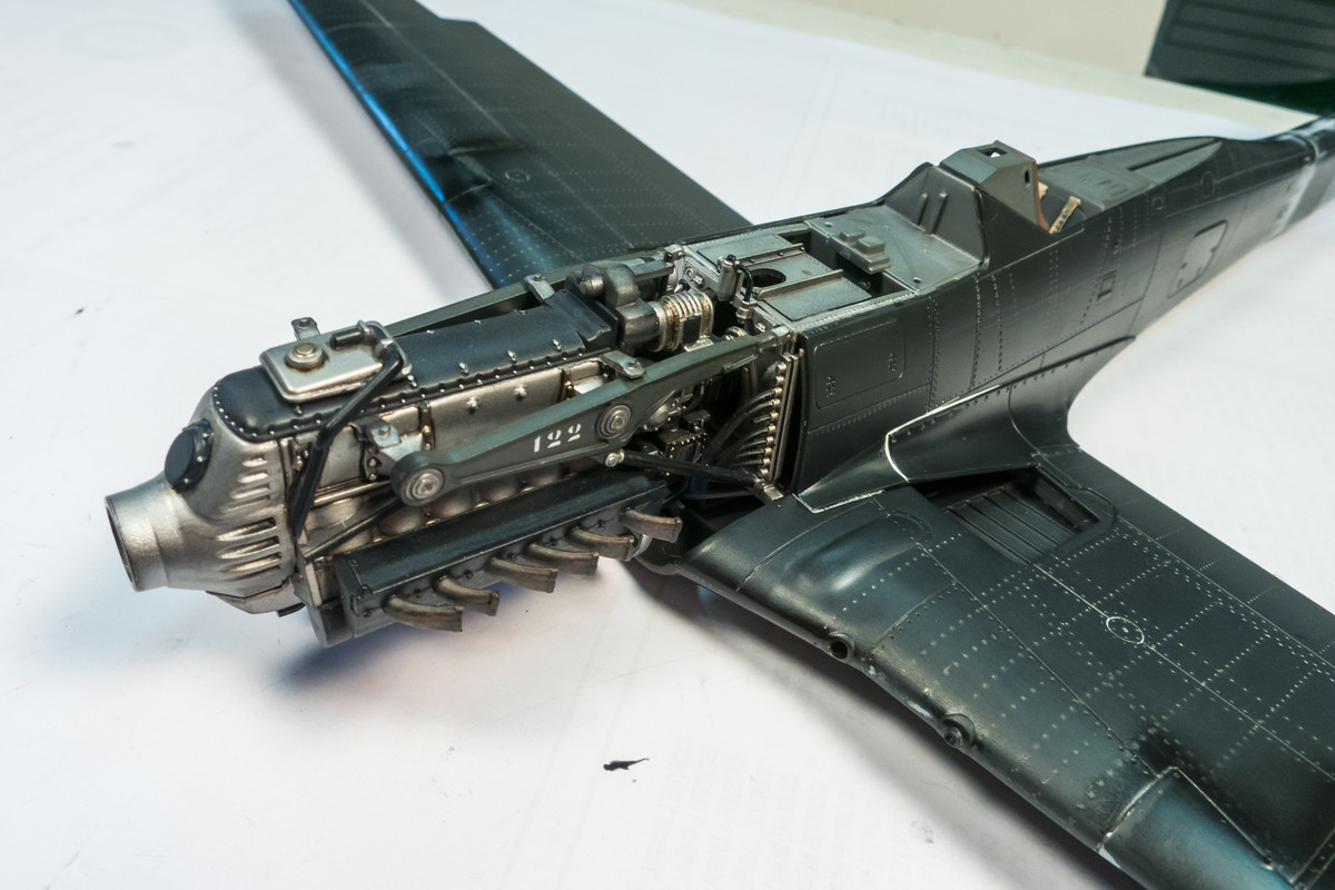

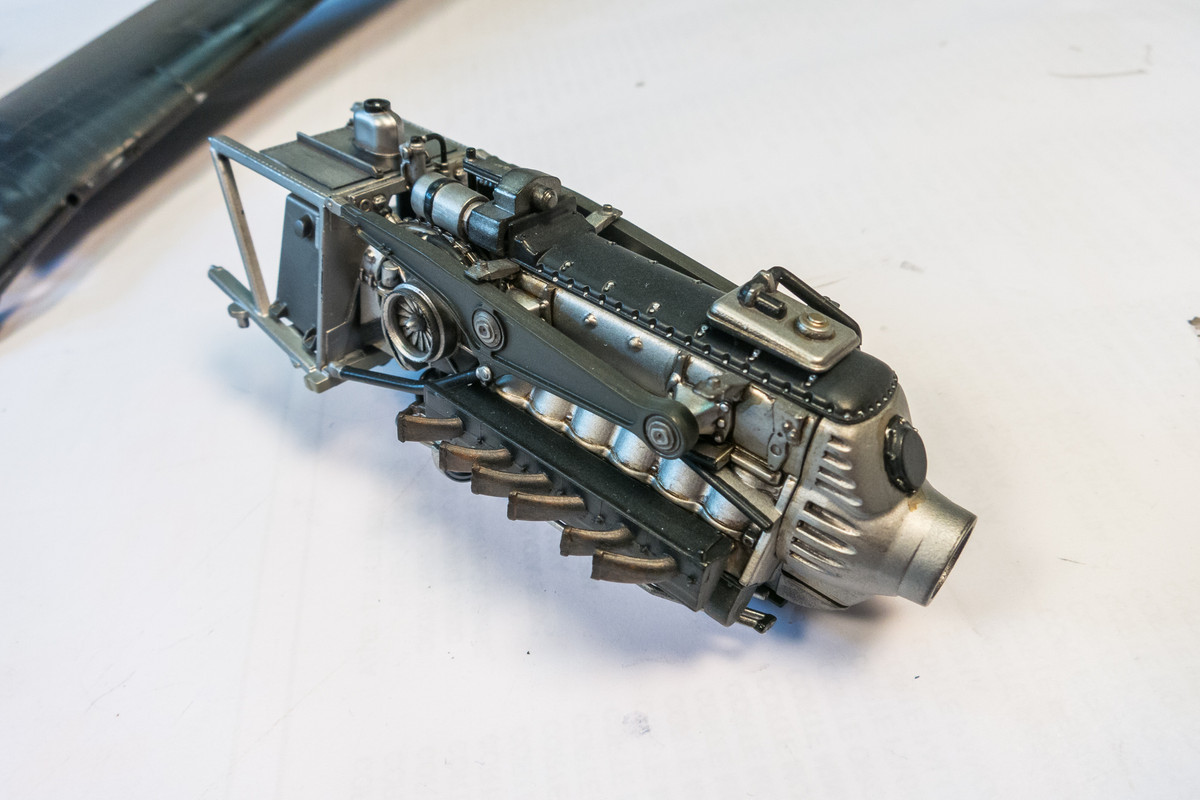

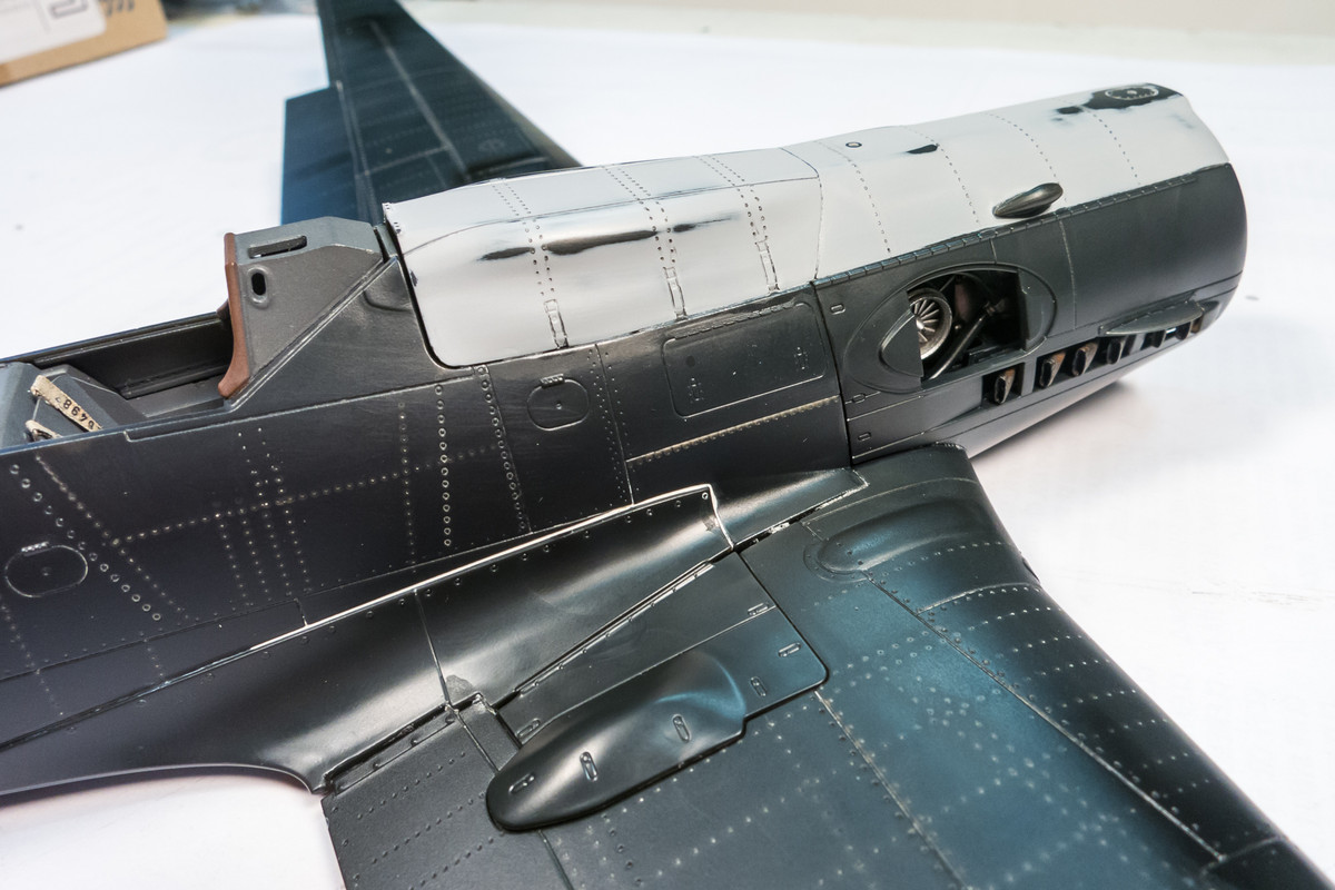

The next step will be to attach the engine assembly to the fuselage. Once that occurs, I can check the fit of the front fuselage panels. I'll probably forgo trying to fill the wing/fuselage seams now because there is a potential that the upcoming fitment of parts will force some seams apart.
