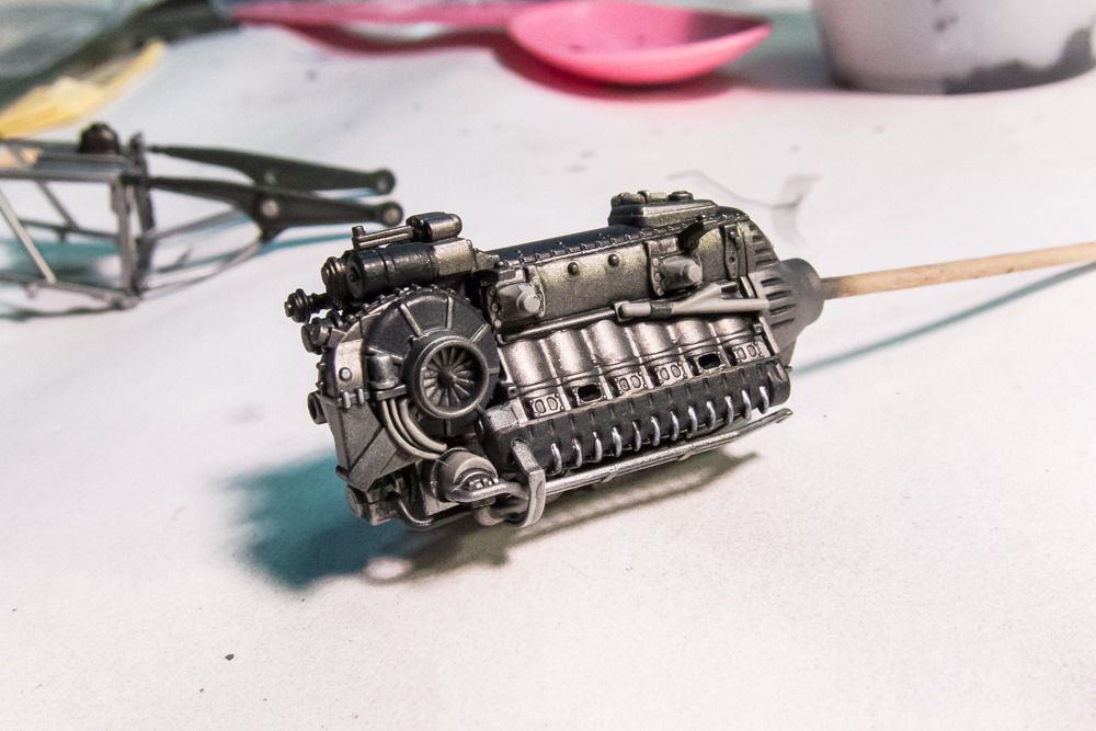

Hah! This photo is from your fabulous ZM 1/48 Ta-152. I was gonna quietly reverse engineer what you did here. Would you mind telling me? (Yes, I read your narrative again, but I still have questions.) if it’s not too much trouble, that is.jkim wrote:Leaving the flaps up would look ok too. That way you don't get delayed with trying to spice up the interior of the flaps with spars. I think you should move to the painting stage. Let's get that cockpit and engine painted up!
John’s ZM Ta 152 build
Maybe a better question is... how do I paint a BMW radial?

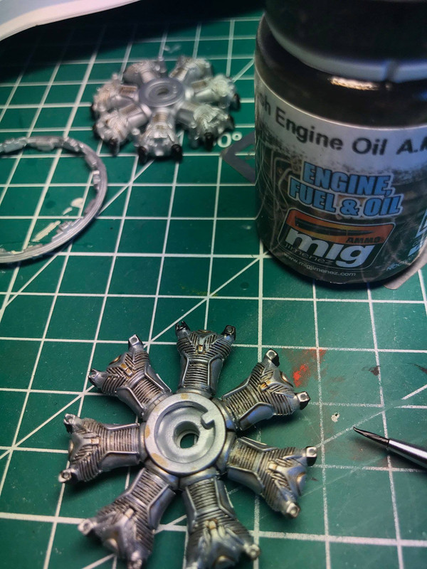

Re: Pacific Coast Models 1/32 Fw 190A-0. Black 13. Belgium,
The BMW engine was, now afterwards, the only part of my "late" Revell Fw-190 build I somehow was satisfied over...
But I also struggled to "find" the colors needed...

Kari’s 1/32 Revell “Butcher Bird” BMW Radial
Kari, Thank you so much! How was this done?
It was pretty straight forward, I painted everything first with Tamiyas X-11 Silver.
Then I washed it with the Ammo Migs "Engine, Fuel & oil", wiped off and re-washed.
The wash took off most of the shiny silver, making it more, sort of "dull".

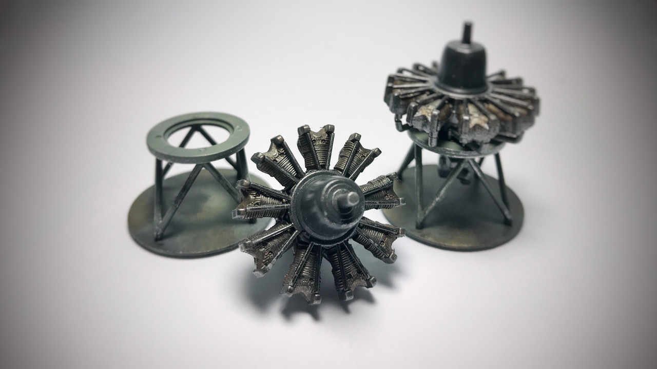

Today I made the Dorniers Bramo engine, where the approach was different. I used Tamiyas Gun Metal X-10 as "base", did some very careful oilwash, and drybrushed some Tamiya X-11 silver.. Might be one round more X-11 drybrushing to highlight some details in the pretty nice Bramo engine ICM has succeeded to do...
