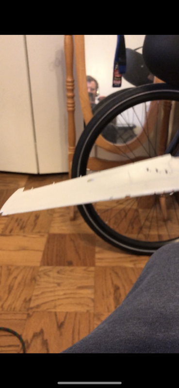

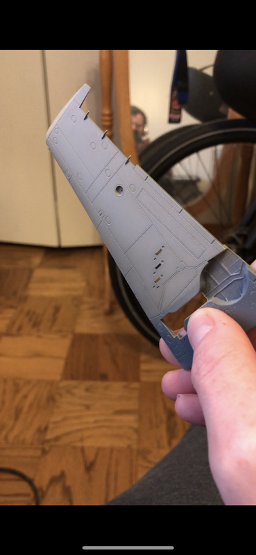

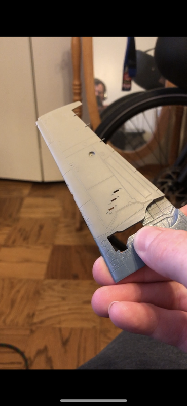

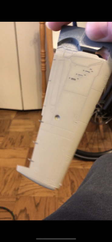

The effect you get looks like this:
Note just a subtle bit of accentuation in the panel lines near the wing root. Also, note the subtle over all shift from dark to light and light to dark again depending on the angle. This gives life to the paint in a different manner than the tonal variation I get with the black basing. Instead of the paint having “character” like it does with black basing, the words “spirit” and “ephemeral” come to mind. So think of it like this, instead of adding “life” to the paint, I’m giving it “spirit” and this nicely coincides, at least in my mind, the otherworldly mystique these aircraft had when first observed by allied pilots.

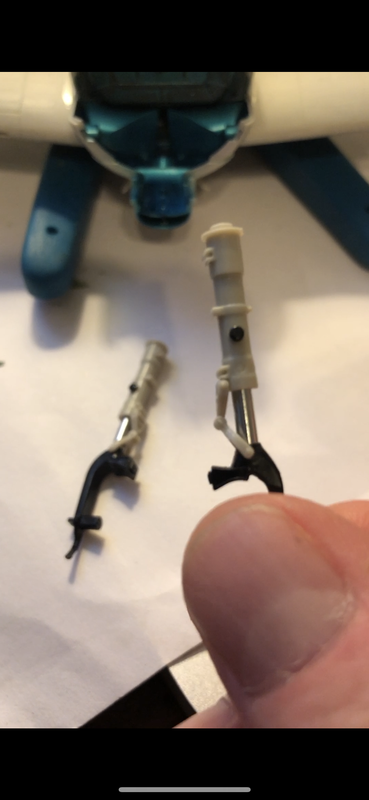

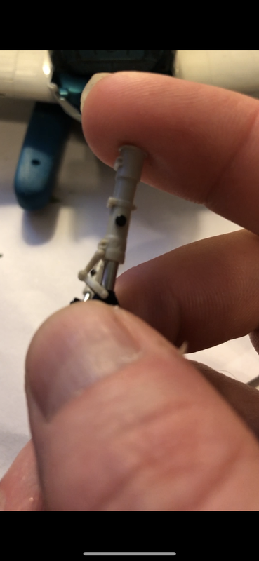

:lol: have a gander at this, lads:
What the Hell? Why’s the strut look like that?
Because IT WORKS:
Damndest thing I ever saw.
Hopefully this Zeke will be heavy enough to sit properly on those and compress them a bit!
I’ll disassemble those, mask the metal (yeah, that’s metal) and paint those components this weekend. Probably the covers too. And decal them, talk sweet to them, etc.
