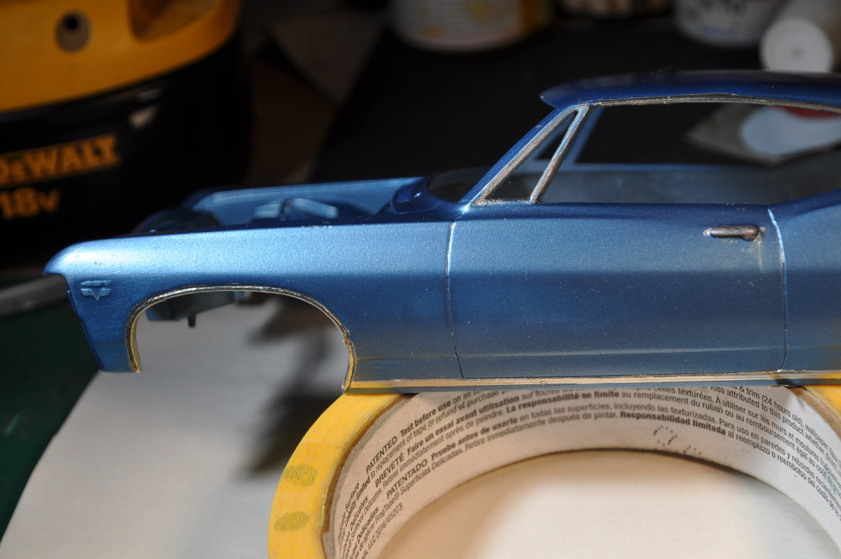

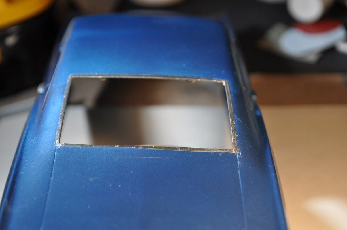

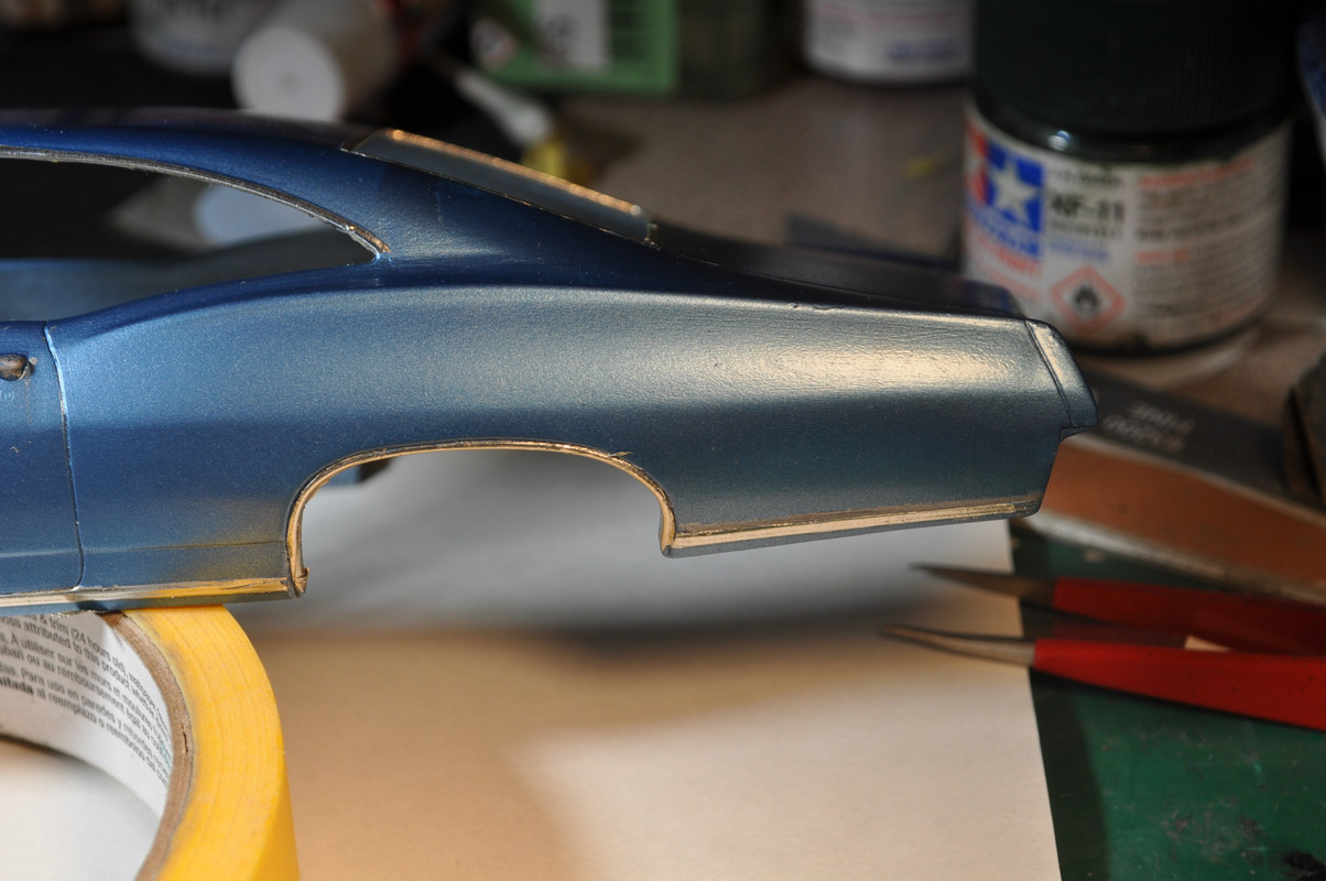

Well, been a while, huh? Shelved this for a bit. . . for a couple of fun, easy and quick builds. Wah, Wah, Wah...Anyway, after almost screwing the thing way up the tailpipe trying to use the Molotow pens, I realized I needed to use BMF (Thanks, Joe). Still a few places to do, but overall, I am happy with the results.
- Posts: 13418
Re: AMT 1967 Chevrolet Impala SS
Looks good. Just work at it a little section at a time with BMF.
Looks decent Lyle. ALWAYS and I mean ALWAYS use a brand new blade for BMF. That is first. Second is to really get it down smooth with a Qtip. Buff it till it is down tight.
Go easy when you cut it. It cuts very easily with a brand new blade and the pressure of just the knife is enough. Slow and steady wins the race here.
And lastly. it takes patience. I have a few photos I may put up for you with some helping guidelines.
Overall your effort is excellent.
Thanks guys. Pictures always show the flaws. I see some places I need to re-do. Bob, I start with a new blade and changed it two or three times.

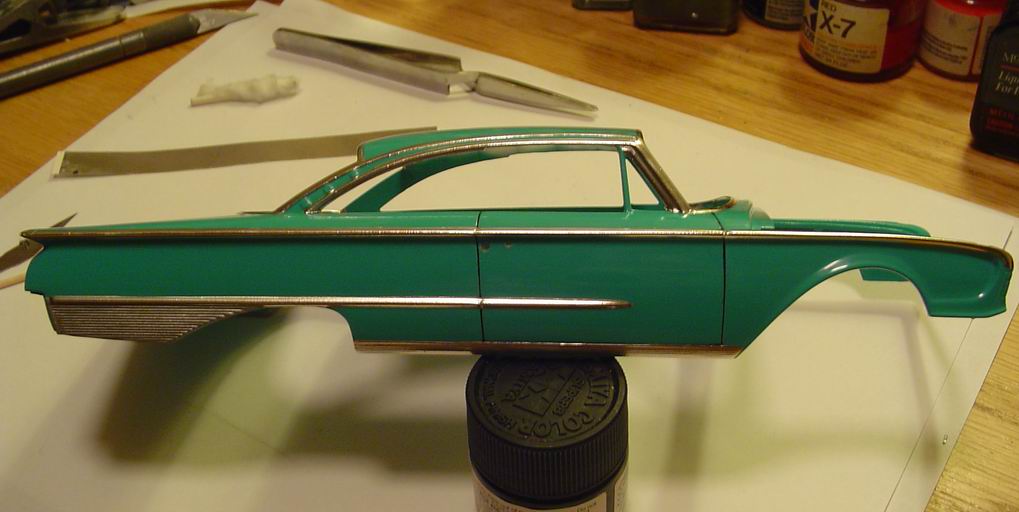

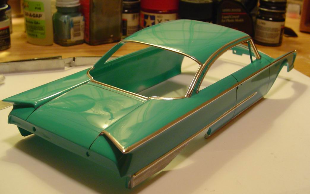

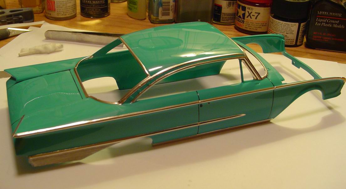

It took a few years working with foil to get this result. 50's and 60's cars are loaded with chrome. I've done 59 Impala's and 55,56 and 57 Chevy's. They all have their tough spots.
This 1960 Starliner has a lot of trim on it. I approached it top down so I could see what I was doing and not mar what I had done. The long side spears are one continuous stroke of the knife. Holding it comfortably is as important as anything. Being relaxed allows you to flow with the trim you are cutting. If you mess up no biggie right? Just take it off and start again. With a relaxed arm and posture you are not cutting into the paint and wild excursions of the knife are minimum.
I do window trim like on the 1:1 version. Is there a seam at the top? I put one there. As a starting/ending point and it helps in looking correct to boot.
Multiple pieces are your friend. It buffs down so it really becomes invisible to the naked eye. Find the seams on this car. They are there but they are hardly noticable.
Once again, it take patience and practice.
