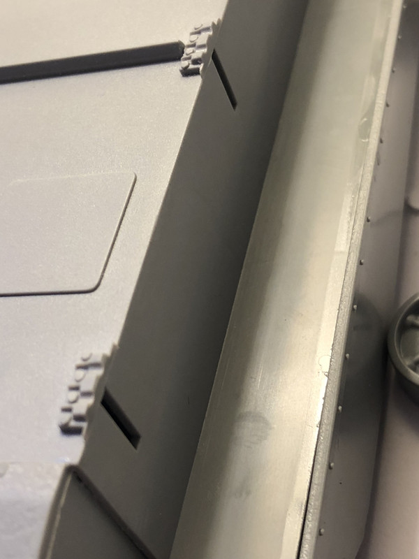

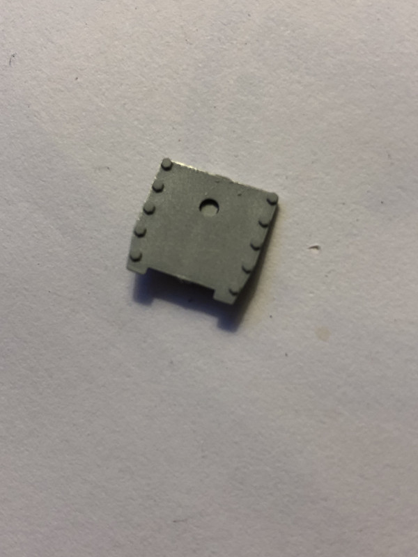

Here we go. First, under the hull, take note of “V3” and the lines I’ve made in pencil on the outward edges:
I made those lines to denote the fact that when installed these parts to not fit flush with the outer edge below them. They stick out a bit. And there is no way they’ll naturally fit flush.

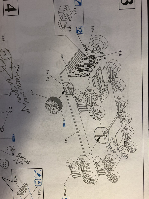

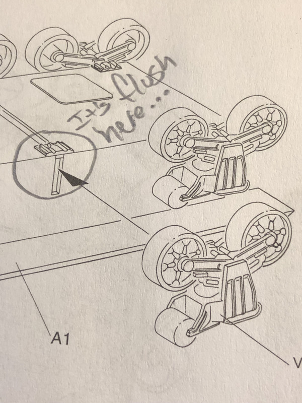

Now, look at the next diagram. It shows them fitting flush, and it describes how the wheels attach, ostensibly by way of slots:

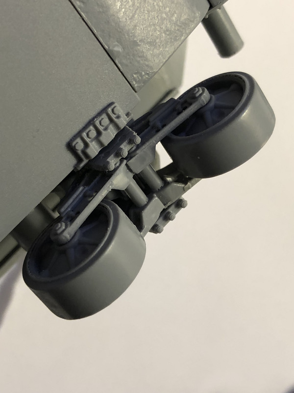

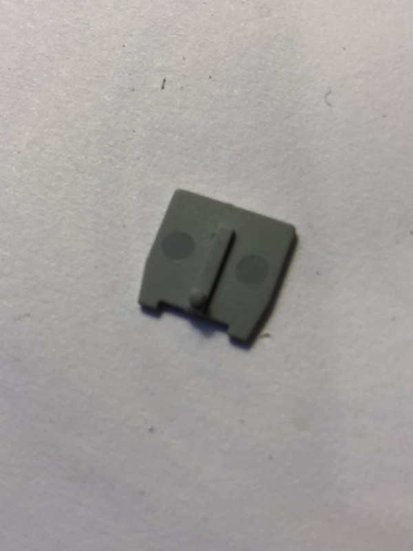

Okay, groovy! But take a gander at this part here, the back of the thingunmabobber that holds the wheels:
It does indeed have a circular nub which fits into the slot, but it doesn’t protrude far enough to mate with the slot with that “V3” part sticking out. And to compound the problem, that bar below the nub prevents it from mating too.
Now I must’ve looked at this and meditated on it for a solid half hour last night, and I’ll be damned if I could suss how to make that work. So here’s what I opted to do.

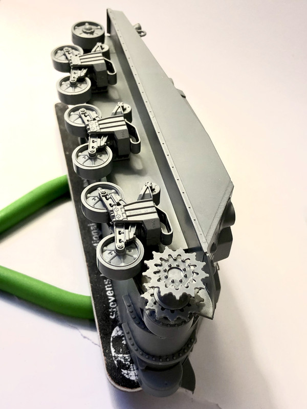

1. I sanded the outward edge of the “V3” parts so they’d be flush with the lower hull (the instructions show them flush after all):
2. I sanded the bar off the wheelie thingunmabobber:
This at least allows the nub to mate with the slot -barely but that’s better than before because it didn’t mate at all before. Also, appropriate care must be taken at glue time to make sure they all go on there true. I’m preparing for that, now.

Hey, I think Dragon’s illustrations are very tricky here. Dragon redesigned these kits several times, improving them along the way. Perhaps the “nipple and bar” are supposed to be there and the bogie sits away from the hull. That is how I think. However, I agree with every move you made so far to correct this. I believe the issue rests on whether or not the bogies are flush to the hull—in reality. In the land of the Dragon, that arrow is very misleading, and if indeed the nipple and bar are meant to be glued without any helper tabs or slots, the instructions ought to spell that out. Hey, it’s the land of the Dragon. The details look great and your construction is fantastic.
Re: KENNY X HAS A TANK
Ah! Thanks for weighing-in on this.
If the bogey does indeed not fit flush, I wonder why there’d be a slot there at all? That’s so bloody weird. And I haven’t found any parts which fit that nipple and bar and plug-in to those slots. So what I’m planning for here is finding out later on that these don’t fit flush. If that happens, I’ll cut plastic, and what I’ll to is make “T’s”. The top of the T will fit against the side of the hull and I’ll affix the bogeybto it. and the leg will plug into the slot. That’s Option 1 anyway. But hopefully it doesn’t come to that LOL

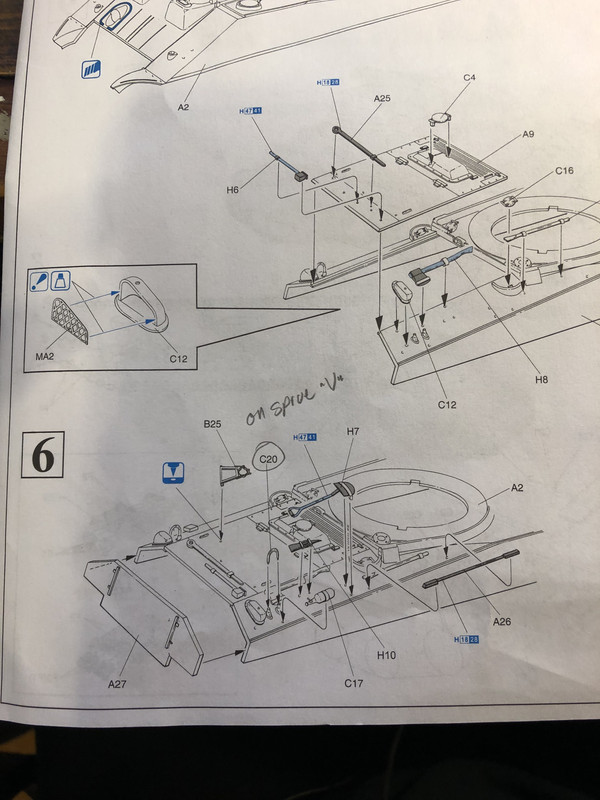

Piece “V5”!!! There is no mention of this piece in the instructions, see below:
Anyway, it looks like this. Here’s where the nipple goes:
And here’s how it plugs into the slot:

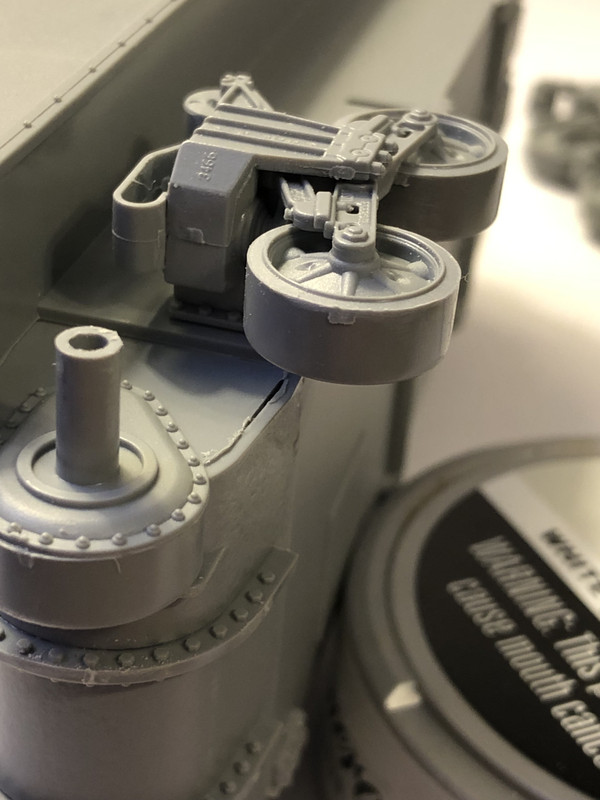

Though I removed the bar on the bottom, getting it mounted to the bogie straight and true wasn’t a problem. Here she is dry-fitted to the hull:
There is a gap now LOL, from my sanding. But Milliput can fix that-
Bogies on both sides outfitted with the “V5” part and dry-fitted into the slots:
I am really glad I looked around the sprues again for anything that might’ve looked like it would do the job. Baffled by why there’s no mention of those parts in the instructions, but it is okay. I’m glad it’s fixed.

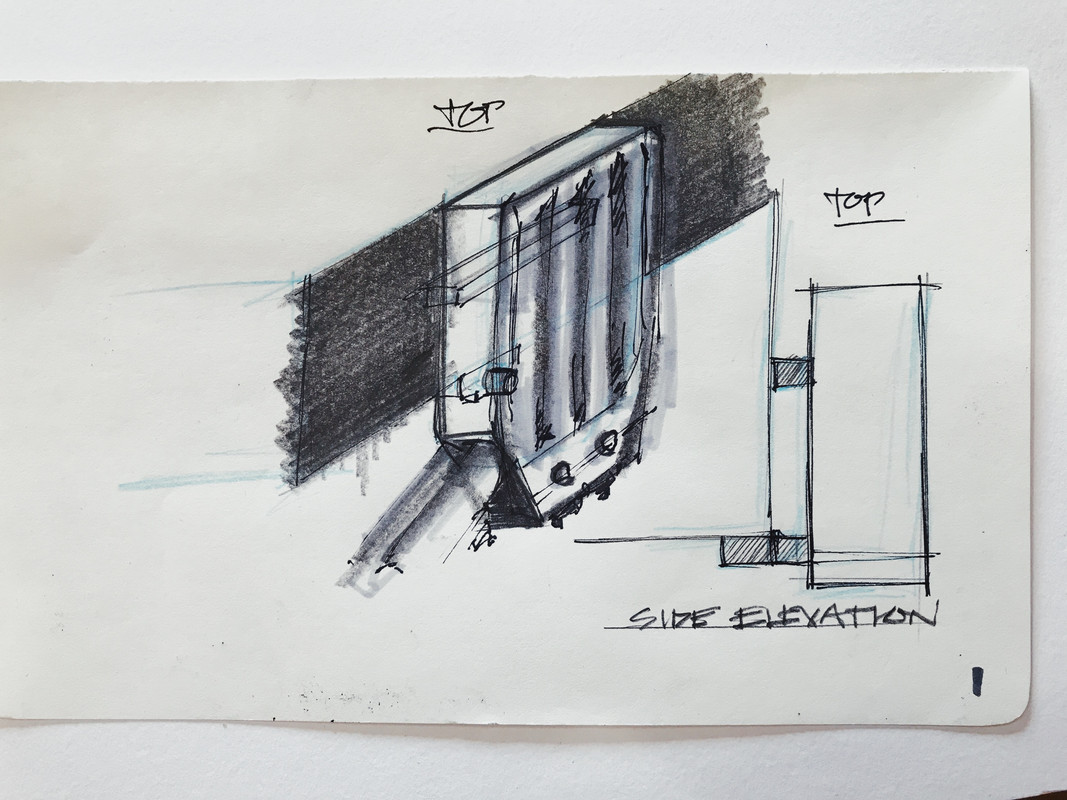

There ya go, buddy. Looks killer. Here’s a totally worthless now sketch I made whilst thinking about your situation.
