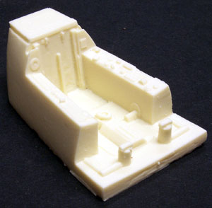

The Ultracast seat looks good too.

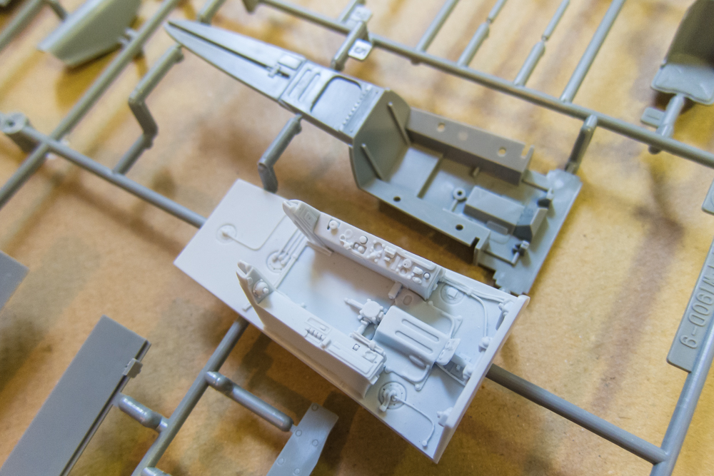

Both cockpit tubs, but especially the Verlinden look very long and narrow. Compare with the 1/32 D-9 version from Hasegawa and Eagle Editions.

John: I'll be using the ultracast on the Dragon kit, the verlinden cockpit is the same exact size and is pretty much a drop in replacement, something I'm not use to seeing from verlinden. But both do look to be out compared to other fw190 kits.

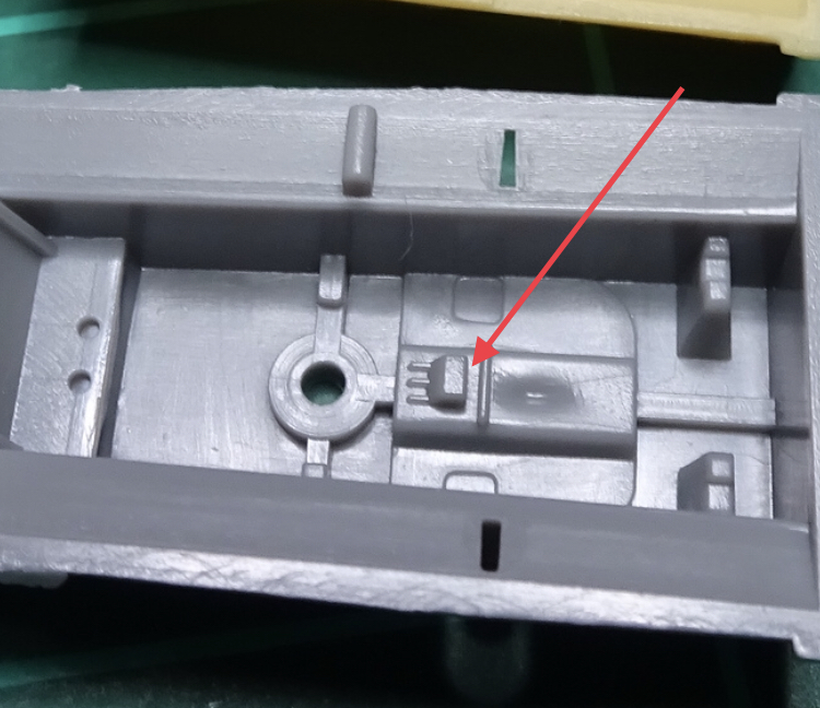

There is also a control box added on the gas cover hatch that is specific to the series and it looks to me like Trimaster reproduced a version of this in styrene. Verkinden probably included that as a separate widget.

Thanks for that info Bruce, No Verlinden didn't add that bit but a bit of styrene and some copper wire should replicate that just fine.
