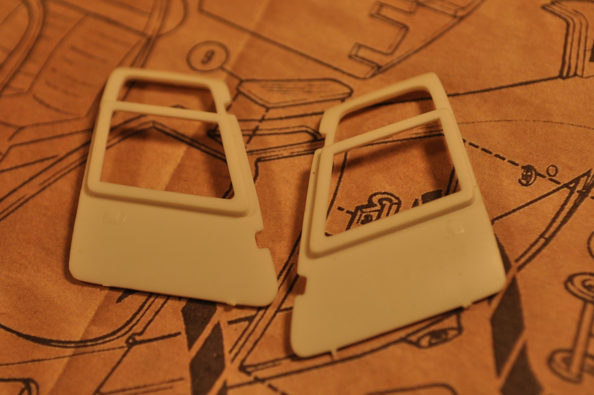

Now, take any picture of the 206 and you will see frames around the widows on the doors. Not like the way, too big frames on the kit parts. Goodness.....I think the saw is coming out!

This is your baby, but before you saw her frames, perhaps try a sanding block and see how these look by reducing their depth, or save the sandpaper and try a flat needle file.

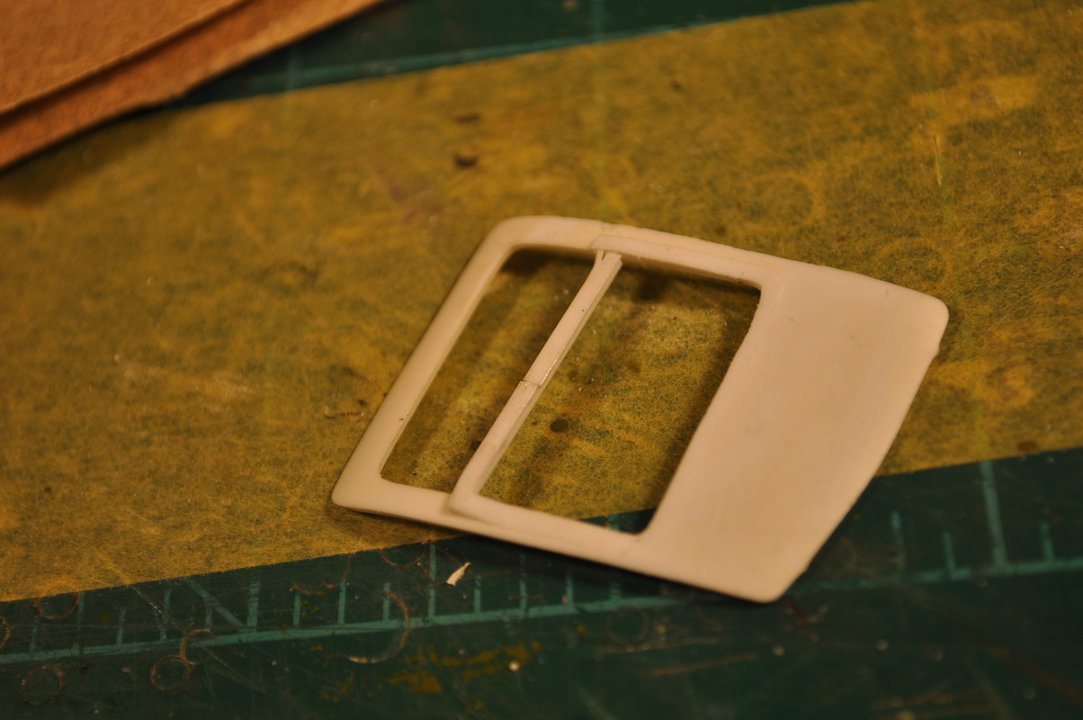

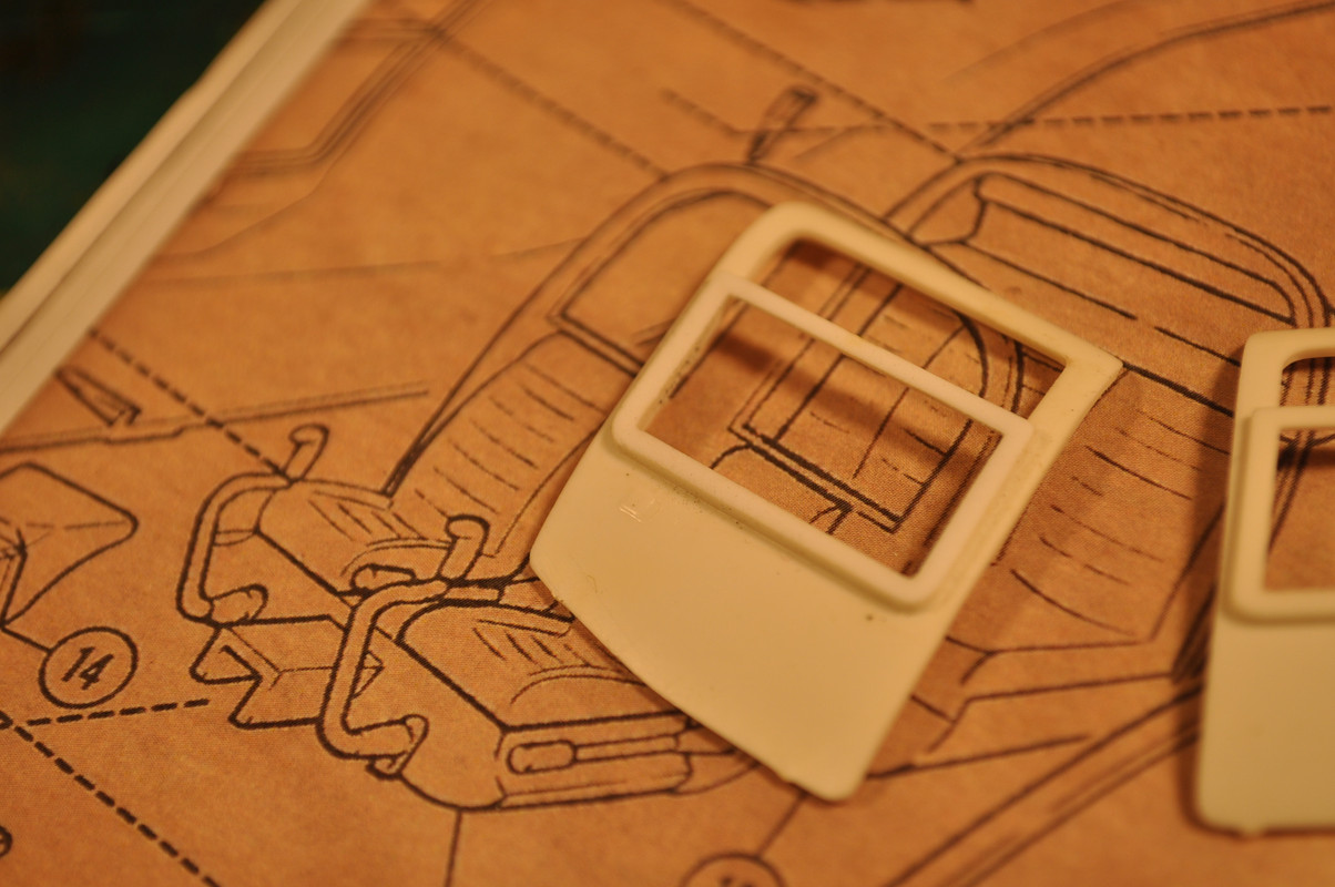

Those little cross braces were too fragile. Every one cracked, broke or came apart. Just too much stress and material to remove for them to remain in place. I added a doubler on the back side of some round styrene stock. Seems to have helped. the saw works fairly well to remove the material where thee is support. Then a sharp x-acto blace to shave/scrape and then sandpaper and sticks. Who knew you could entertain yourself for hours this way! Oddly enough, I am having a good time...mostly.

Nice work! Is the clear plastic that fits within molded as one piece? You could remove the center divider entirely then add a fresh piece of styrene to the clear parts! And yes it is fun! Enjoy!!!
Re: IMC 1/32 Bell 206 Jet Ranger
Yes, it fits in behind the cross brace. That thought has crossed my mind. Unfortunately, it came right out the other side. (drumbeat, rimshot)……
Sea Ranger!
You could bend a piece of wire to make the actual window fascia.
