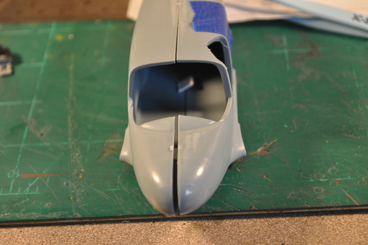

I have never build a Czech Model kit, nor anything from Squadron Products. I was/am surprised that there are no locating pins on the fuselage halves. The pieces are also quite warped. That was mentioned on a couple of reviews read.

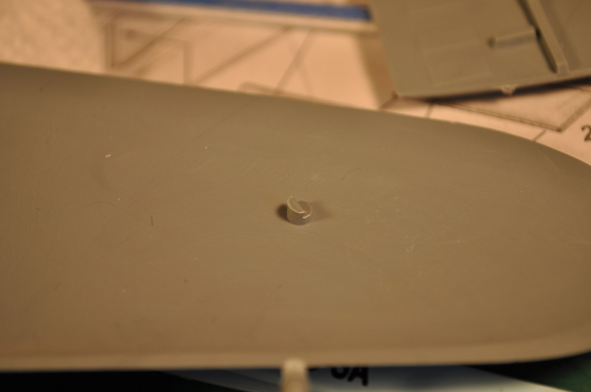

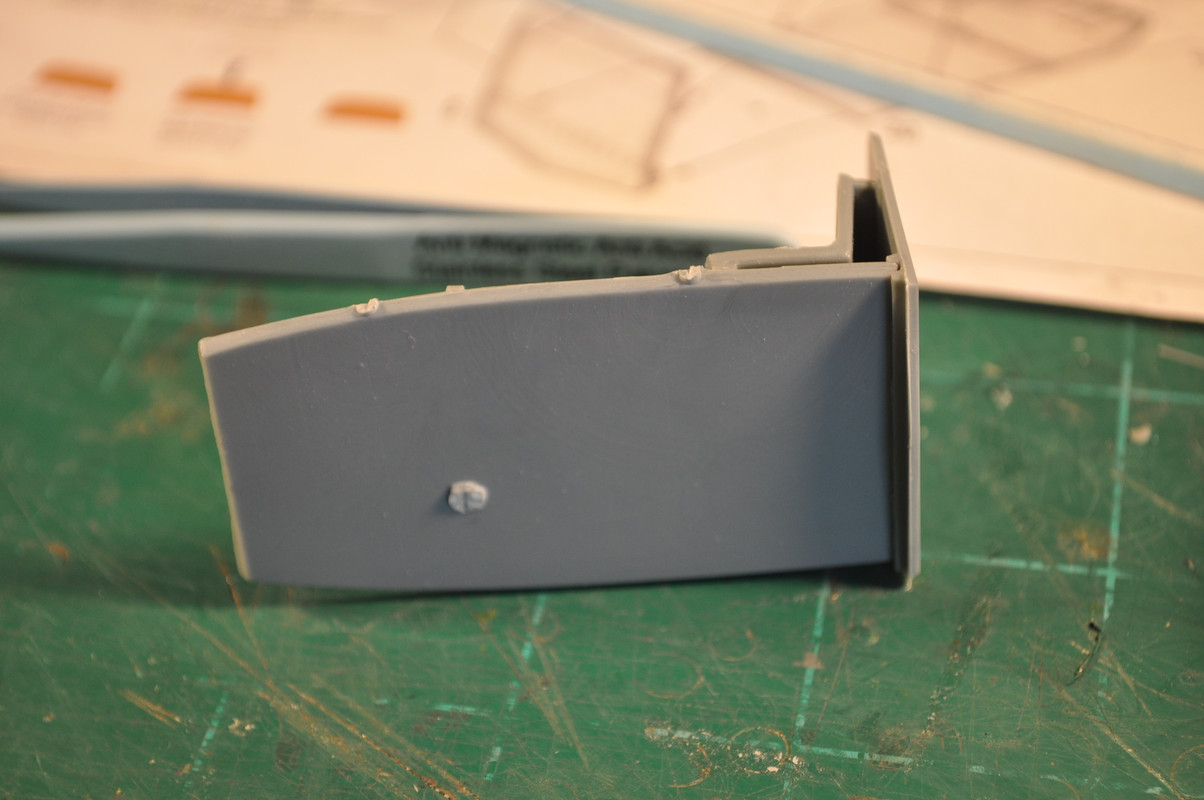

A number of HUGE ejector pins. They look as if they were even bigger and someone actually clipped them back with nippers. The first picture is the inside of a wing. All four pieces have them and they will interfere with assembly. The cabin floor and bulkhead (2nd pic) had the same on the bottom and back of the bulkhead. I had clipped them a bit, and they should be fine.

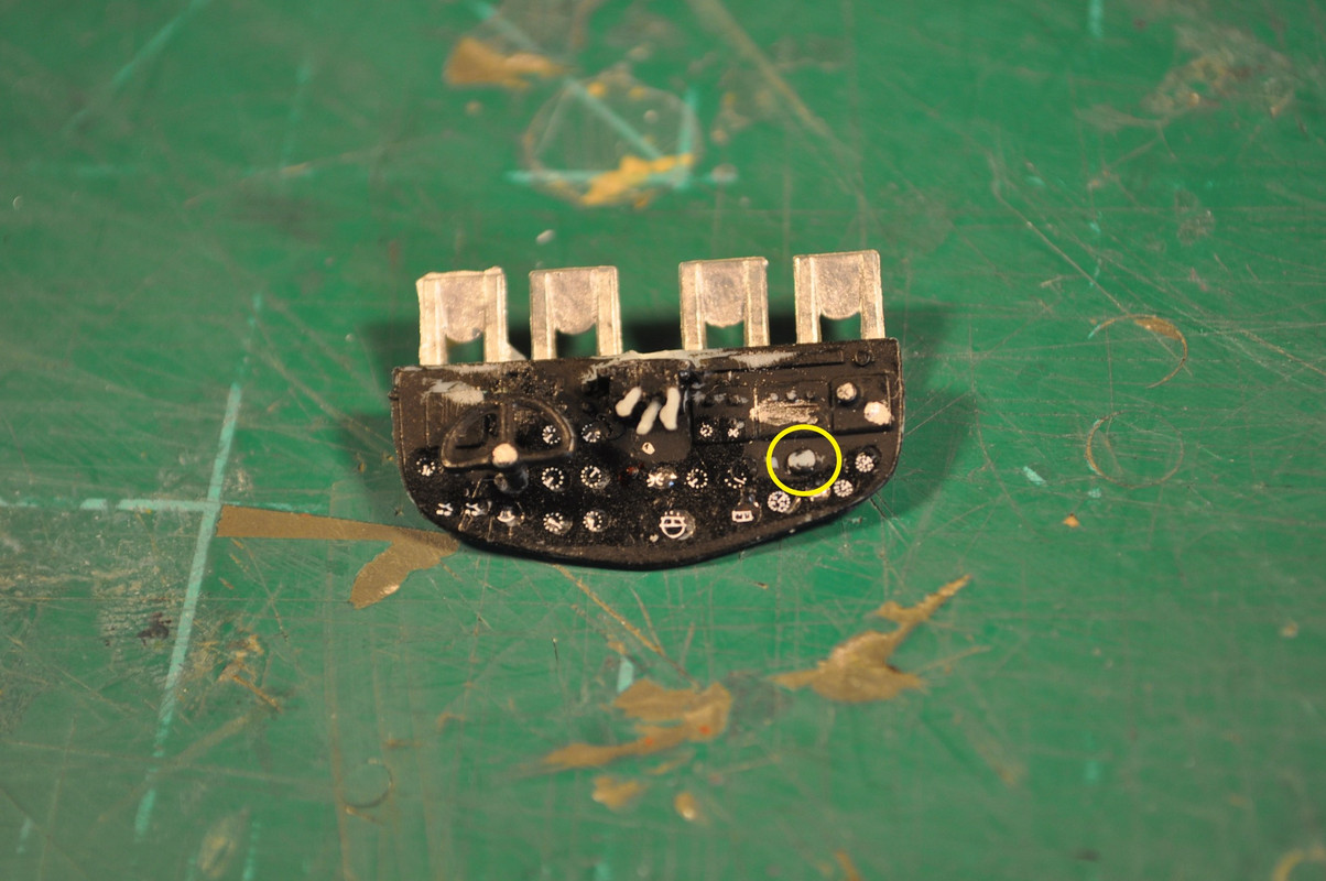

My old nemesis, no help positioning parts is back. The control wheels simply area a butt-joint on a quite small shaft end. The yellow circle is what you have to work with. We are moving ever so slowly and test fitting everything multiple times. So far no disasters. I even managed to glue some levers to the throttle quadrant.

Why they gotta do that???? I'd just drill a small hole to add them to the instrument panel.
Re: Cessna T50 1/48 Squadron "Encore"
That was an option, but me and sharp objects were not playing well together this morning!

Short run—no locating pins.
I would “train the plastic” of the fuse to come together with hot water or steam....
