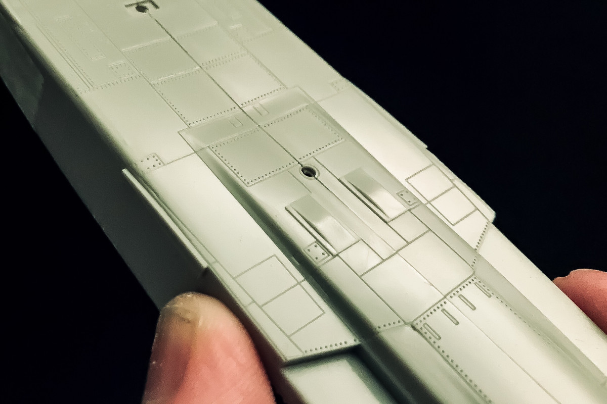

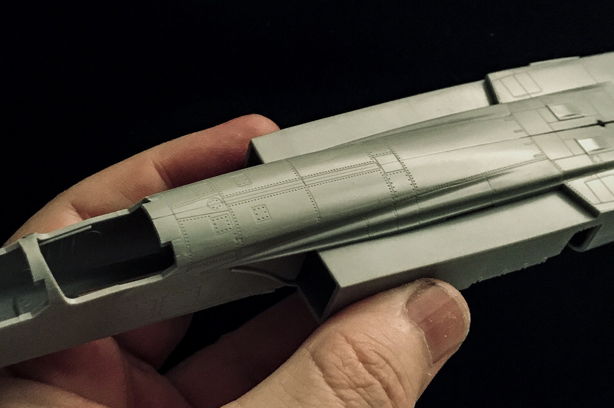

Trumpeter kit :
As a cost-cutting move and in the hope that a modern tooling job will be a less painful entry into jet building, I chose the Trumpeter kit.
However Trumpeter chose to mold the fuselage pieces in left and right halves, a serious mistake in terms of structural integrity.
With the Vigilante being such a wide and flat airplane, there is nothing to prevent flexing of the top and bottom of the fuselage.
Instead, they should have made a top and bottom rear fuselage section and a separate left-right front nose section...

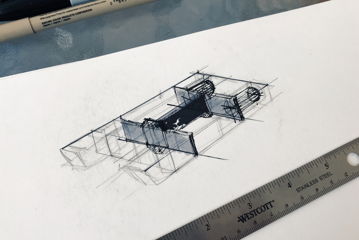

Thanks for those ideas, bud! I read a review of the 1/48 version that made me want to chuck this kit due to inaccuracies and idiotic assemblies such as the very basic fuselage to wings one that is now fast becoming problem one. I believe Trumpeter shrank their 1/48 version to 1/72 and brought all of the issues along with the scale change. In the review I read there was an aftermarket kit to fix the fuselage weaknesses made in wood by Nautilus Models. I can only imagine that the owner of Nautilus bought the kit and had to make a brace for the interior himself then decided to include one for sale. Here is my simplified idea:
