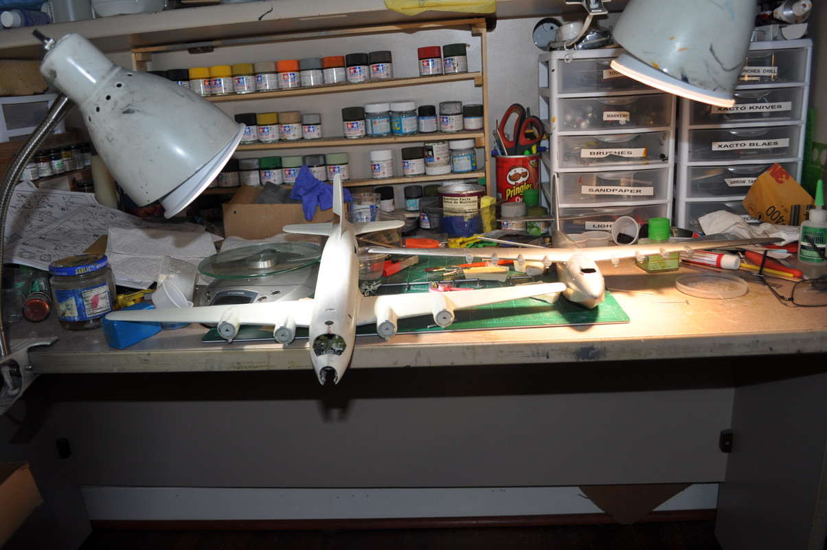

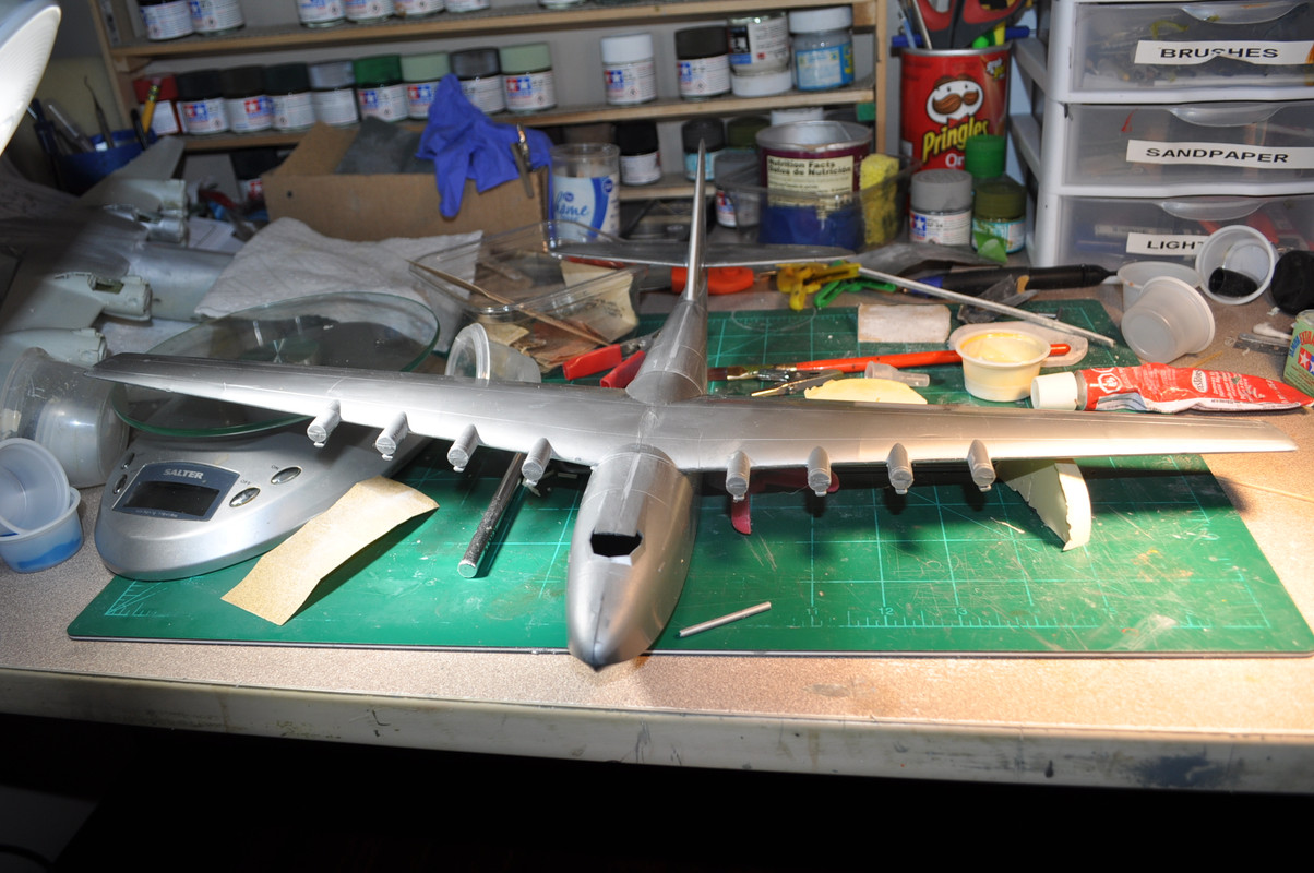

Just about ready for paint.
size comparison (Goose is 1/144) with the 1/72 C-54. The Goose's wingspan is a bit larger, but the fuselage is a tad smaller.
As for the props. I plan on taking the broken blades and gluing them on a piece of sprue and molding the blades separately. Cannot get the prop to mold in one piece and have managed to break a couple of the remaining complete props. The blades are just too thin. Now I know why aftermarket props are sold the way they are.
