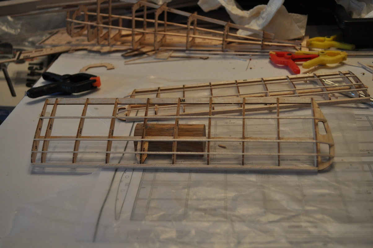

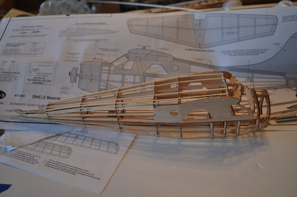

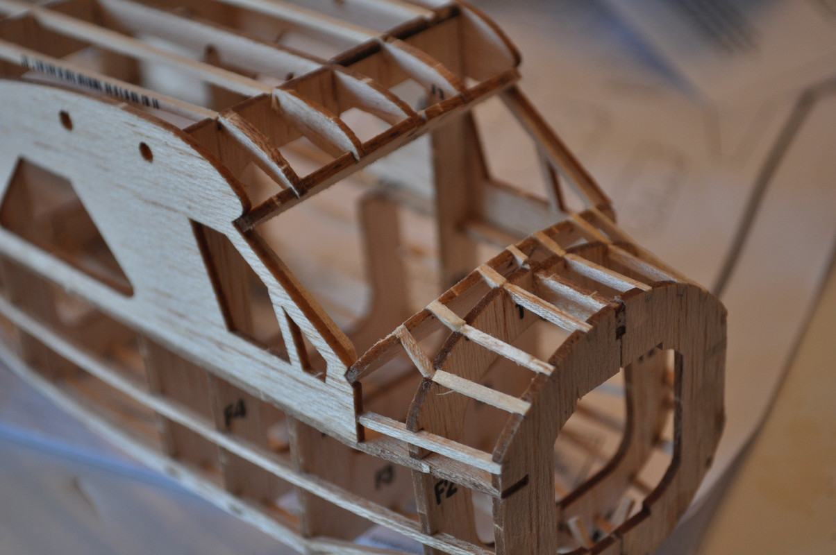

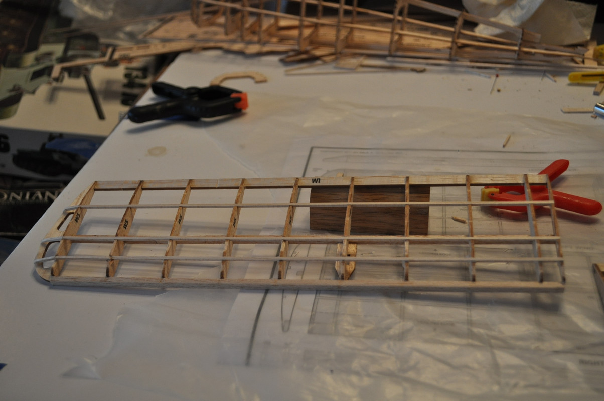

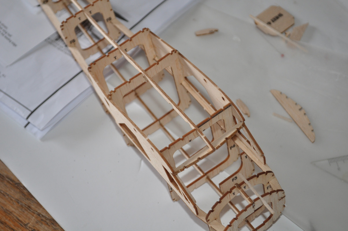

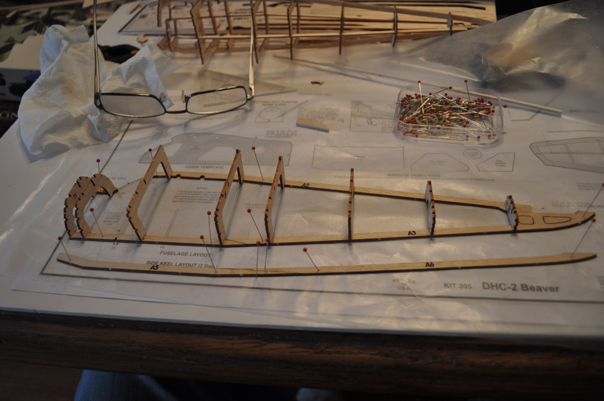

The replacement parts showed up a couple of days ago. As a bonus, got a set of wing ribs because of how they were arranged. Not much neat on the ribs, but they came in handy to fix a mistake.
Got a lot done on the fuselage today. I just started over. Also, wings are done.

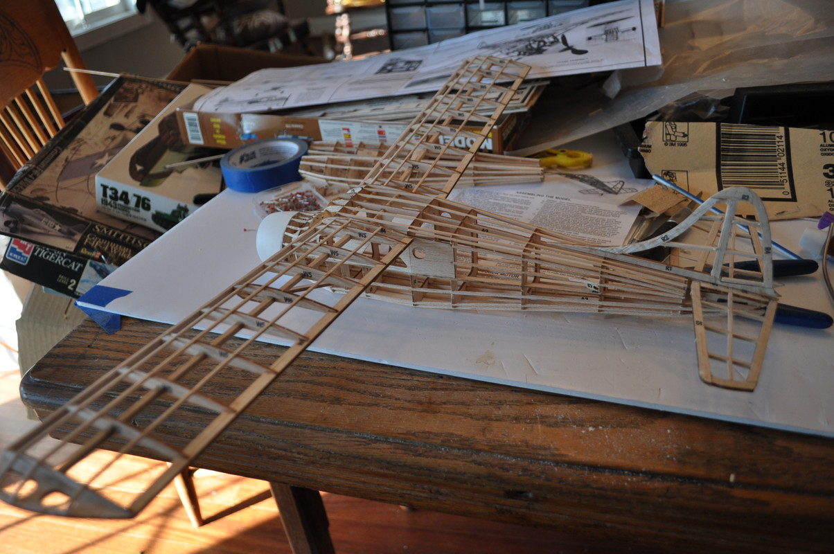

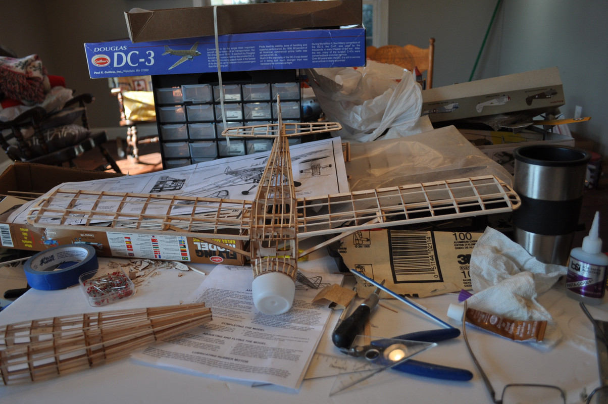

Hey guys! Making progress, well sort of.
Fuselage is done.
Wings are on, incorrect dihedral for static, but they are on. When I caught it, it was too late. CA dries fast on balsa.
Still have a bit of "blocking" to add to firmly secure the tail surfaces and I need to finish up the floats. Those have to have a hand-carved nose piece. Certainly not a strong skill that I posses.

Looks like an airplane now!
Re: Guillows 1/24 DHC-2 Beaver
Thanks. That was the plan. Not happy with the wings, but I'm not sure I want to try the release them to lessen the dihedral. The rib that butts up to the fuselage is CA'd in place....Thanks for looking.

I did a quick internet peek to see if this was a known issue (dihedral) with the kit and it is. Usually what happens to modelers is one wing is higher than the other which Is not the case here. My instinct based on watching your prior builds is to advise you not to monkey around with this on the airframe but do a test with a good CA debonder on scraps of balsa to see if it is possible to release the areas affecting dihedral. If the debonder releases the CA hold easily you may have a solution. Still I advise caution here. Show the parts you have to carve for the float tips. I am curious to see those. Did you try Tower Hobbies for spare parts? Thanks in advance.

I do have debonder. As usual, I did not think of that. I believe that I put the wing struts too high on the fuselage. If I can lower them, that should fix it. Maybe....speedgraflex wrote:I did a quick internet peek to see if this was a known issue (dihedral) with the kit and it is. Usually what happens to modelers is one wing is higher than the other which Is not the case here. My instinct based on watching your prior builds is to advise you not to monkey around with this on the airframe but do a test with a good CA debonder on scraps of balsa to see if it is possible to release the areas affecting dihedral. If the debonder releases the CA hold easily you may have a solution. Still I advise caution here. Show the parts you have to carve for the float tips. I am curious to see those. Did you try Tower Hobbies for spare parts? Thanks in advance.
