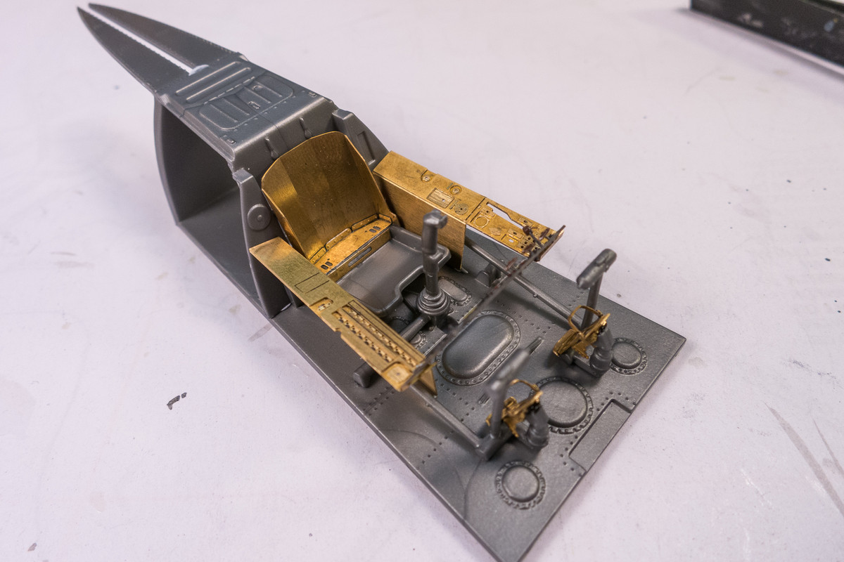

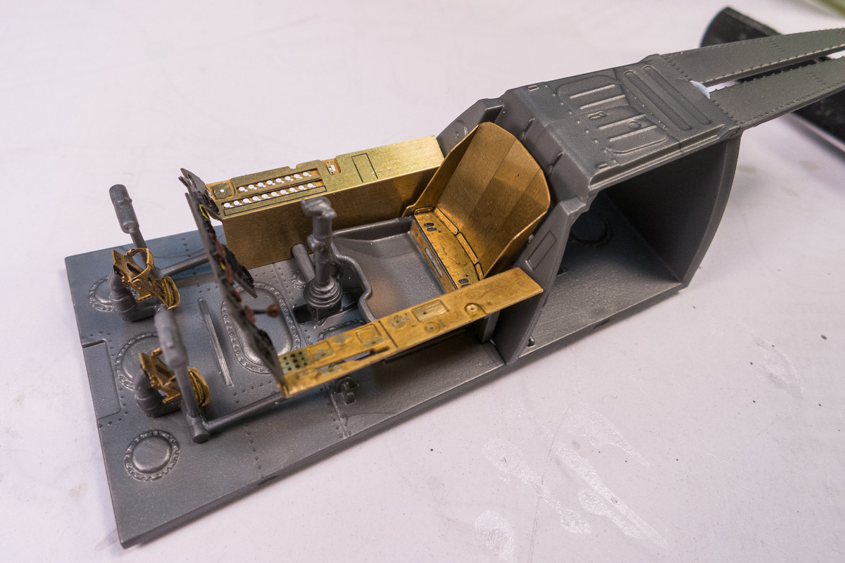

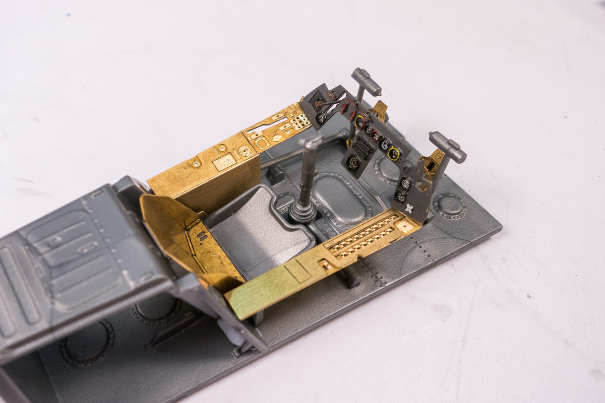

Playing around with the PE side consoles to see how they fit. I'm keeping the option of using the kit side consoles if I can't get the PE to work. So far, so good!

Lovely work Thus far John - Most impressive as always :shoutout:
Just caught up with this build - Great looking kit, I am surprised by the coloured frets though. :hmm:

I like the photoetch. Looks good.

Impressive photo-etch work! It's like you're building a 1:1 scale aircraft!
