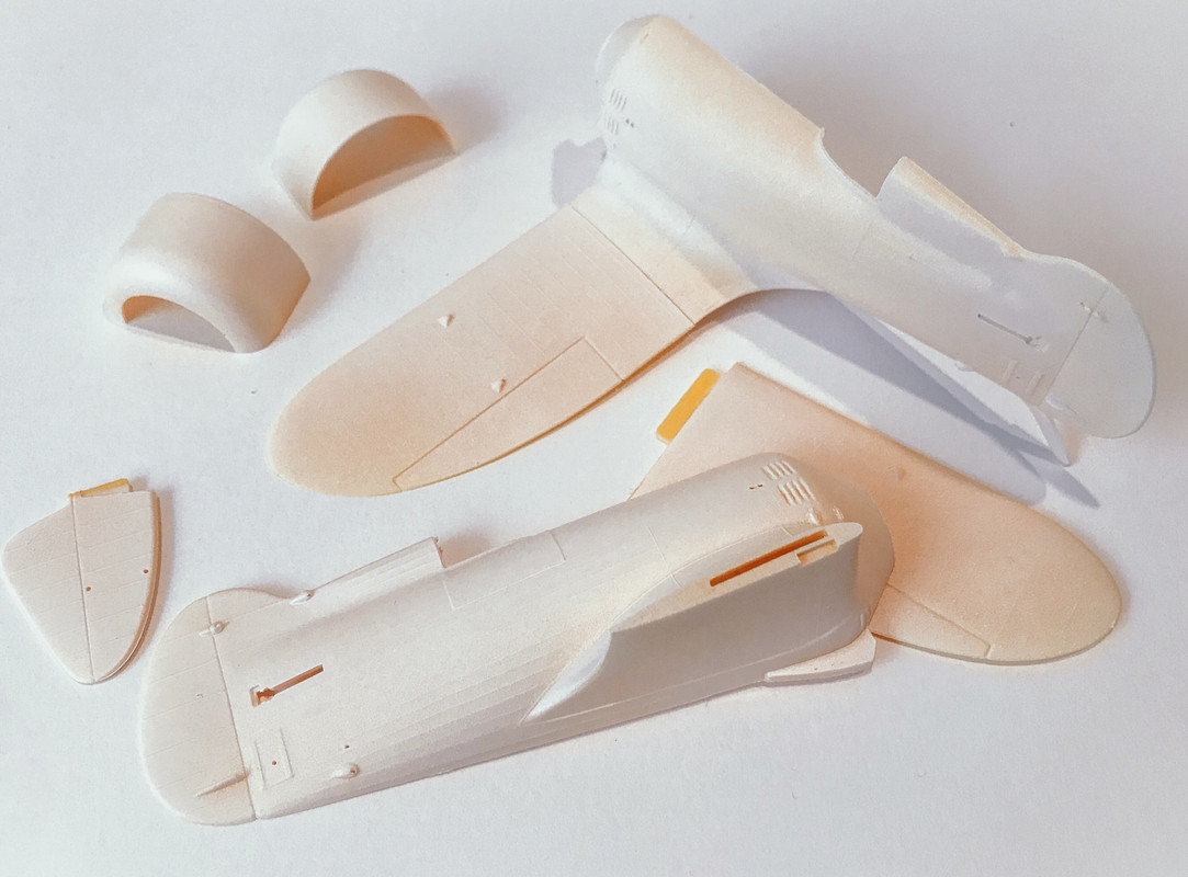

Two quick passes of Tamiya Fine White Primer
Much better Bruce - that yellow is BRIGHT! :cool:

I’ll post more photos. I have primer on the wings, tail fins, fuselage and cowling. Tonight I was thinking I would assemble the cockpit, and I need to review Lyle’s project to see what he did. Even though the plastic is a terrible color, it has a beautiful hard smooth finish which is a zillion times better than soft textures for painting.

Thanks to Kari, Duke and Lyle for your comments. I mean this most sincerely. I have not written in awhile about process, so I wanted to correct that. First I do prep plastic and clean the surfaces. I don’t get hung up on clearing flash away just yet. Also I love the instructions.
“PAINTING: Some modelers prefer to assemble the aircraft in advance of painting, but in view of the complex color scheme it may be preferable to paint sub assemblies and to assemble them afterward.”
Yes, my modeling brothers, that is what I’m gonna do. So first I needed to establish two coats of white primer. Note I also primed the interior of the fuselage as well (not shown).

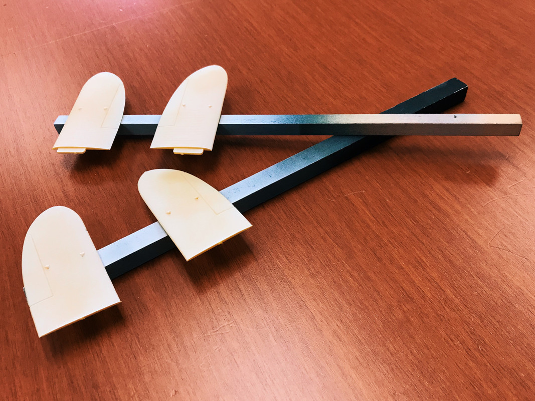

Next I started working on the tabs for the wing panels. Again I love the instructions.
“Check for proper fit and adjust as necessary.”
So out came the flat file, and a vigorous grinding on both top and bottom surfaces of the wing tabs. This was a little tricky because I could easily over do it, losing both alignment as well as stability.
I was spot on with one and “close enough for now” with the other. The gap is from missing pressure fit; a little glue will hold ‘em both true!
