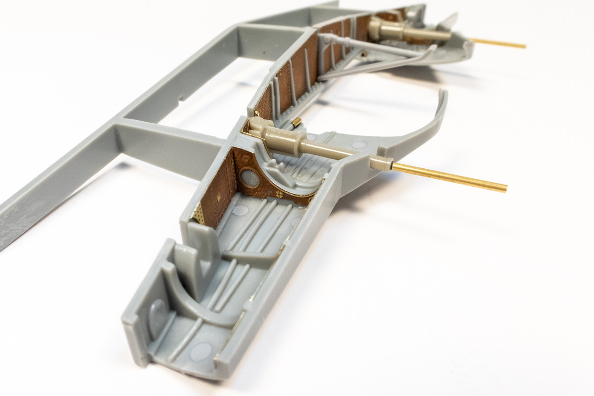

The wing-mounted MG151 cannons are fairly well represented. They are molded straight and with a fairly uniform round cross-section. When the ends are hollowed out, they look pretty good.
My major issue is with the leather boot at the base of the cannon barrel. Hasegawa incorrectly based this on a restoration condition and is not reflective of Fw190's in service. Luckily, Quickboost makes a nice set of resin gun barrel replacements, of which I will only be using the wing-mounted MG151's. For whatever reason, Quickboost does not list a gun barrel set for the 190D so you'll have to use one marked for the 190A.
The locating tab on the rear will need to be adjusted to match the Hasegawa part. Don't worry about the portion extending past the base but make sure the tab ends in the middle of the base like the Hasegawa part.
A quick verification that the guns fit into the wheel well without issue. Since the gun barrel gets sandwiched between the upper and lower wing parts, you would need to install the guns before that stage.
I don't want the barrels in the way when I'm cleaning the leading edge joint and I don't want them to snap off either. So I make one more modification. The resin barrels are cut off from blast tubes. Locating posts made from 0.70mm brass tubing are glued into place at the end of the blast tubes. And new gun barrels are cut from 1.00mm brass tubing.
Now the barrels can be attached at the end without getting in the way or getting knocked off.

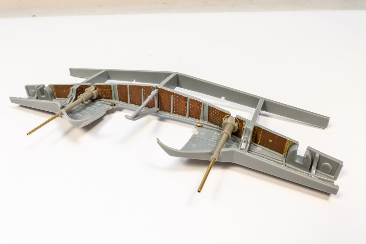

A little more work on the wheel wells. This time I am adding the Eduard Exterior set details. For the best detail, I would recommend the Aires resin wheel wells but this set has some PE panels that dress up the kit wheel wells decently enough.
This was about as straightforward as PE gets. All flat panels... no folding and they all fit with only one issue. I had to trim one the panels to allow the center spar piece to fit properly.

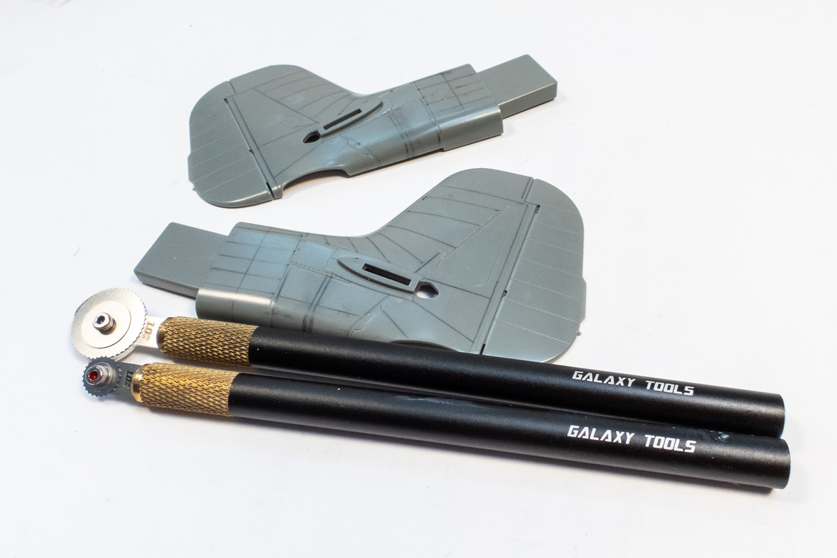

Time for some riveting work. I like to start off on the smaller pieces first to get the hang of it. It's something that you get better at the more you do and if you haven't done it in a while, practicing on the small parts first is a good practice to shake off the rust.
First, I draw the rivet lines using a set of detailed drawings. I'm doing the tail first so the plans are for a Ta-152H-1. I use a soft lead pencil and a flexible clear ruler. I'm not an exact rivet applicator and I usually just eyeball the lines instead of measuring.
Once the lines are drawn, I trace over the lines with a rotary rivet tool. It's like a ponce wheel for sewing but there are several out there manufactured specifically for modeling. For this model, I am using the Galaxy Tools 1.00mm dot pitch tool. One good thing about the Galaxy Tools is that the dot pattern for the large 1.00mm dot pitch tool matches the small 1.00mm tool exactly. If you are using the RB Rivet-R, be aware that the dot pitch of 1.00mm wheel may not match the Mini Rivet-R 1.00 wheel. I use the larger wheel mostly but in tight spaces or around curves, the smaller wheel is handy.
Using constant pressure, the rivet tool is run over each drawn line, producing a row of small holes.
The process leaves a raised mound of plastic around each hole. You can leave this as is but I like to lightly sand away those mounds, leaving just the hole. The effect is cleaner. The part is then treated with a dark pastel wash (in this case black) to highlight the work.
I use this stage to check the panel lines and clean those up as appropriate.
After this process is finished and I'm satisfied with the rivets and panel lines, I'll scrub off as much of the pastel wash as possible. The rivet holes are quite small and may fill up with the multiple layers of paint that are to come.
