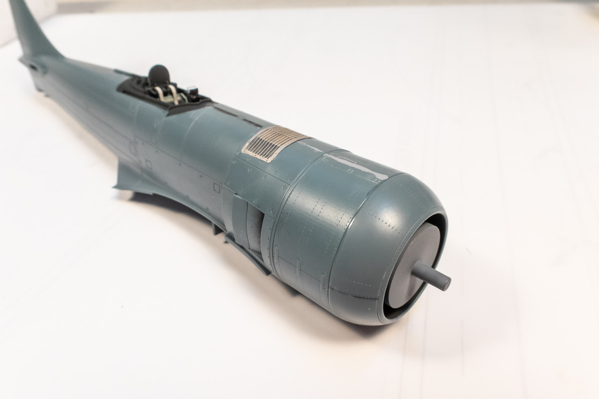

The fuselage halves have been fused together with the engine, cockpit, and tail wheel well sandwiched in between. As always, I use Tamiya Extra Thin.

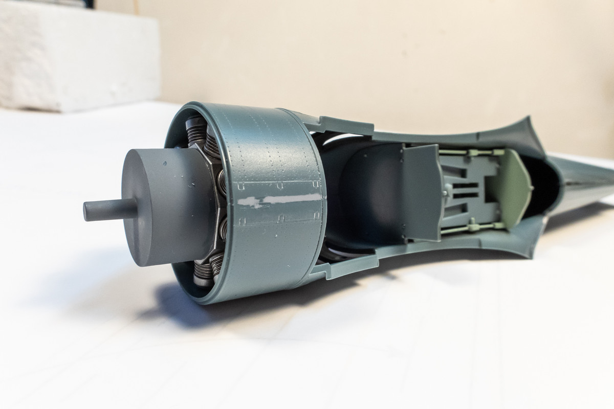

Checking the nose cowling ring and seems to be an excellent fit. View into the engine from the front is minimal even without the prop.

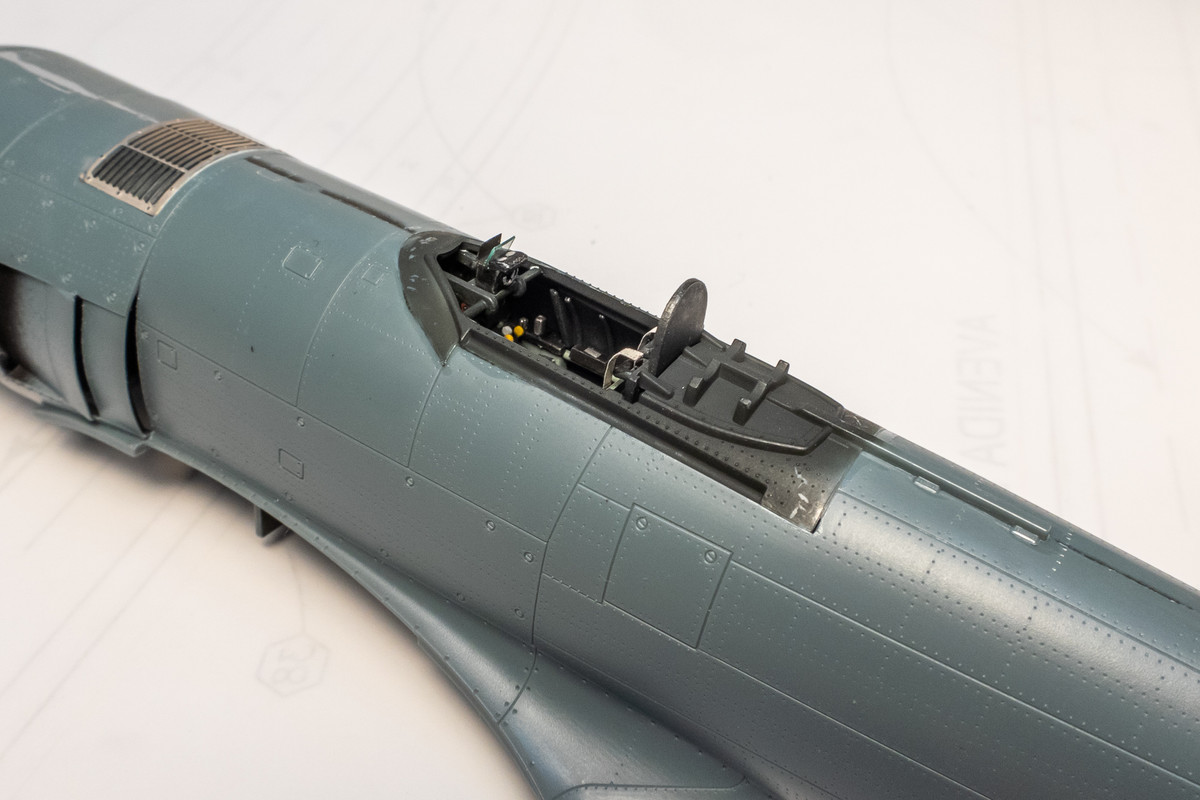

I still need to paint and install the top deck onto the fuselage. The gun sight is attached to the front part of this deck. I added a reflector glass and sun shade. Not completely accurate but adds a little complexity to the overly simplistic kit part.

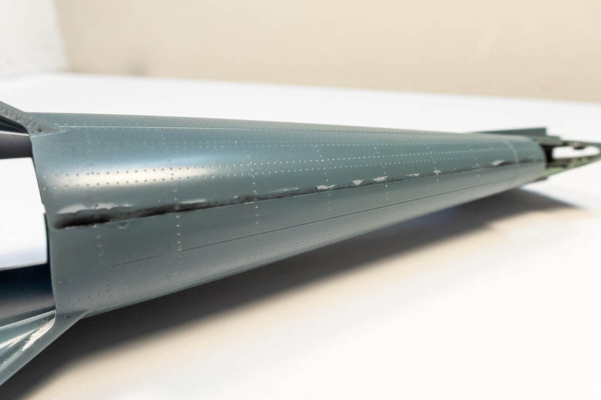

The fuselage joint is pretty good but still need some minor filling. I used black CA glue for the initial leveling and then topped it off with Mr Surfacer 1000 to feather everything down. Still working on re-establishing the panel lines and rivets across the joints.
The small square fuel in front of the windscreen was eradicated by the fill work so I had to re-scribe it.

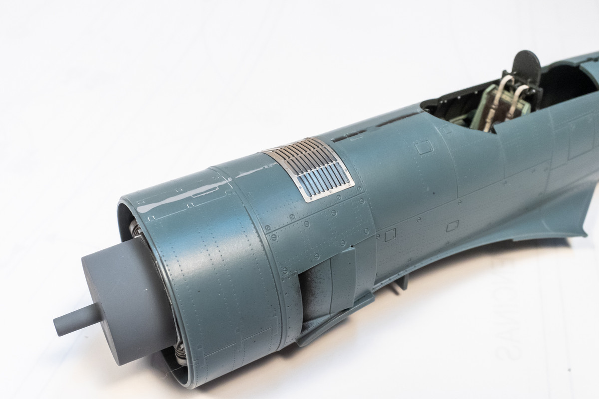

The vent grill on top of the fuselage has a PE option.
After test-fitting both, I elected to glue the PE grill on top of the kit part using thin CA glue and then gluing the kit part into the recess.

Excellent work John - loving how this is coming together.
Gluing the PE grill onto the kit part was a good idea - that worked really well.

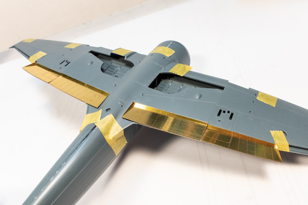

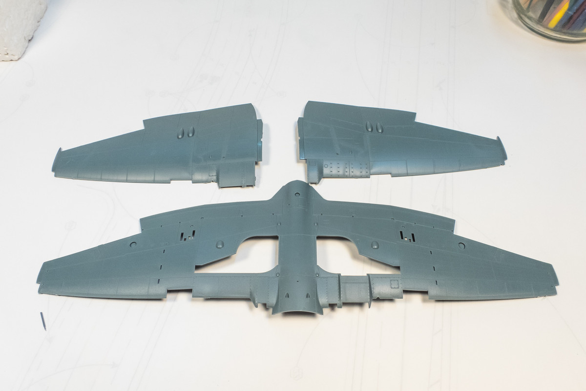

Here is the bottom wing after surgery.
The flaps were removed with a razor saw. A thin raised portion along the trailing edge of the wing tops also needed to be shaved down to accept the PE flap enclosures.
Here are the PE flap enclosure parts. Two versions are given for the outer flaps: gun cover on and off.
The reverse side of the outer parts have a recessed portion. The instructions don't mention this but I think this is meant to be burnished to create an extruded shape on the other side. Since I had a spare (gun cover off), I tried but it distorted the part. Instead, I am going to added these raised portions using sheet styrene.

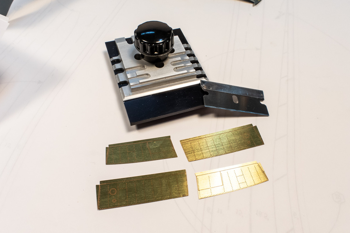

A photoetch folding tool is essential for getting uniform bends. I like The Bug from The Small Shop.
The folded bits are test fit onto the aircraft

The front engine cowling has been attached using Tamiya Extra Thin.

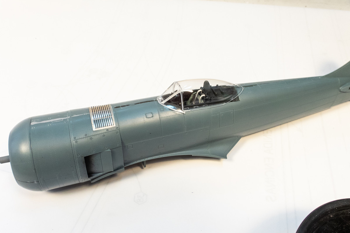

Re: Eduard 1/48 Hawker Tempest II
Here's a test fit of the clear parts. Looks A-Ok except the sliding canopy doesn't always want to sit flush on the fuselage. May have to resort to glue in either the open or closed position... we'll see!

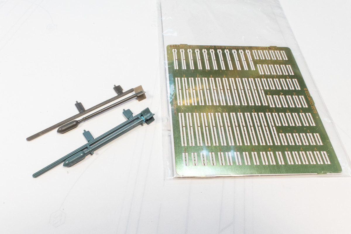

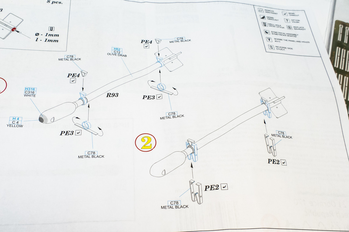

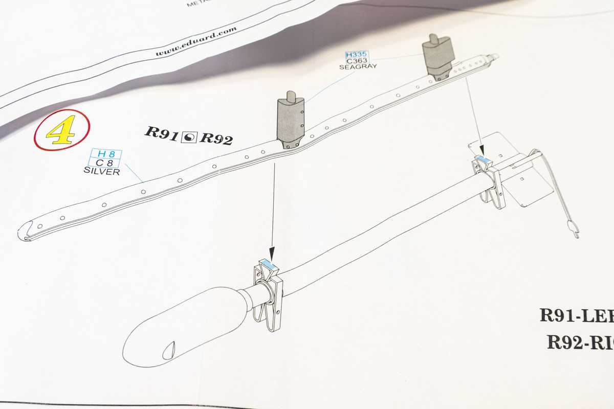

Jumping over to the underwing rockets. I picked up a set of the Eduard Brassin rocket replacements because the fins on the kit rockets were thick and I didn't want to shave down four fins for each of the eight rockets (4x8=32!). I thought it would be savings in labor but boy was I wrong! The Brassin rockets need assembly and assembly involves a bunch of tiny photoetch parts.
Each rocket needs SIX tiny brass parts that need to be individually folded and glued into place without any clear key marks or holes to align things.
After you've negotiated that set of hurdles eight times, you have to glue the rockets onto each rail with a butt join. A small flat area on the little PE part butts up against the sharp edge of the rail, again without any key marks or cutouts for alignment. Like this... >I
If I was really motivated, I would dive in and try to get this done but I'm going to wave the white flag this time. An added complication is that the resin parts, both the rails and rockets, are not dead straight. Being skinny and long resin pieces, they are bit wobbly and that's just going to make a hard task even harder. I folded up a couple of the little parts during my assessment and stumbled onto an idea. Instead of putting the entire Brassin set to waste, I may be able to incorporate the brass parts onto the kit parts. Maybe even saw off the resin fins and glue them onto the kit rockets?

I like the idea of combining the two.
God life's waaaayy too short for that - your combination of the AM and kit parts seems the best solution.
