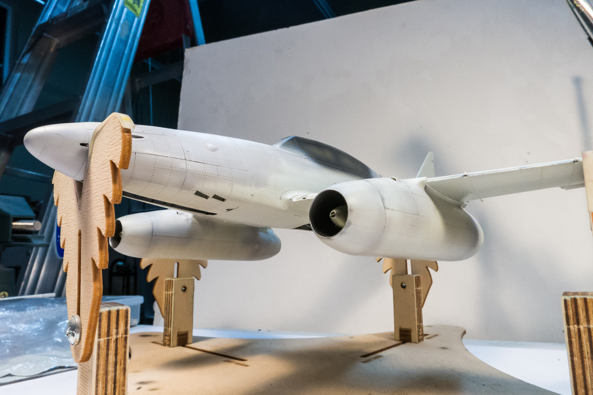

I've since glued the engine nacelles into place. The only trouble spot was on rear top edge where you'll see my application of Mr Surfacer to address.

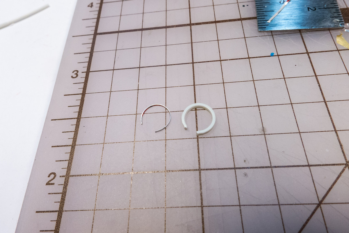

At this point, I've decided to address a few of the small details. First up is the loop antenna that goes on top of the fuselage behind the cockpit. The molded loop is just too thick and needs to be replaced so it is cut off.

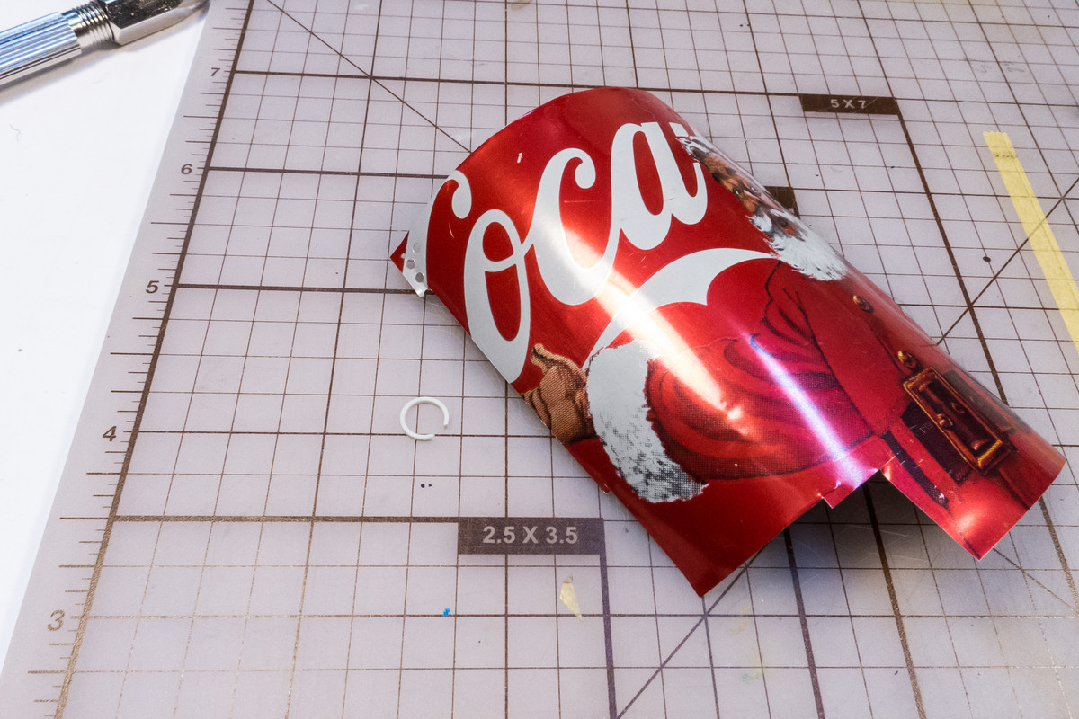

My go-to material for replacement is a modern soda can. It is thin but stiff enough to hold a shape and is easily cut. Original Coke is the preferred flavor.
After a thin strip is cut, it needs to be formed around a cylindrical shaft. I use the plastic loop to find the right form. For this instance, a wooden paint brush handle is chosen.

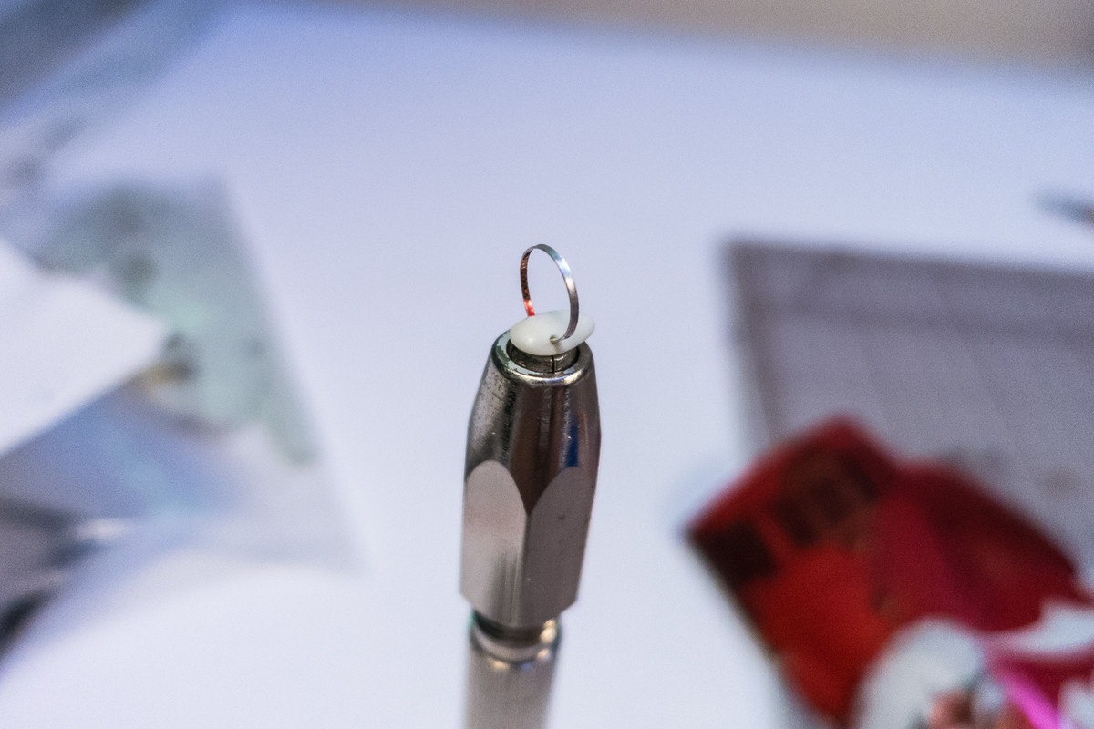

A small pin vise comes in handy for holding small parts securely. It's now much easier to sand the rough edges off and drill small accepting holes for the new loop antenna.
The metal loop is simply glued into the accepting holes with CA glue and the new loop antenna is finished.

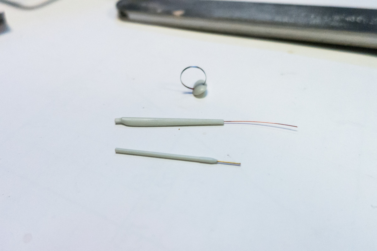

Similar refinements can be made to the whip antenna that is mounted to the bottom of the wings and the pitot tube.
Copper wire is used for the antenna and a piece of brass tubing for the end of the pitot tube.

In all seriousness ....aluminum cans are my go-to as well for difficult to replicate stuff. As you indicated ....cuts up easily and forms just as easy.
Excellent work John! Also great idea for the loop antenna the PE loop for the Gustav blew off into who knows where so I'm going to borrow your idea instead of putting the plastic one on.

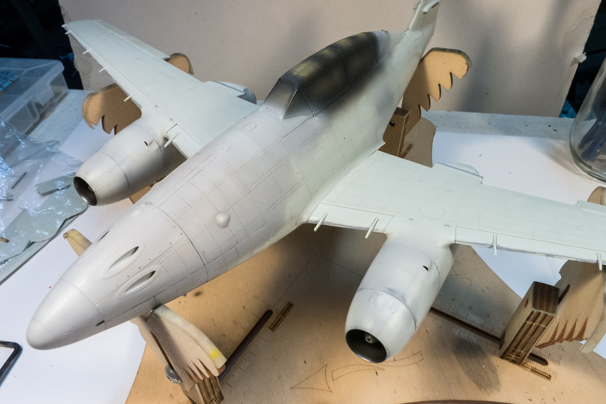

The rudder and the horizontal tail surfaces have been glued in.
The small gaps have been filled in with White Milliput.
