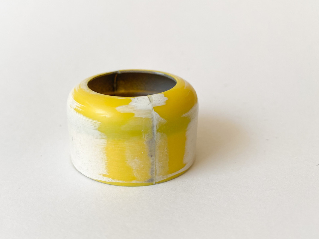

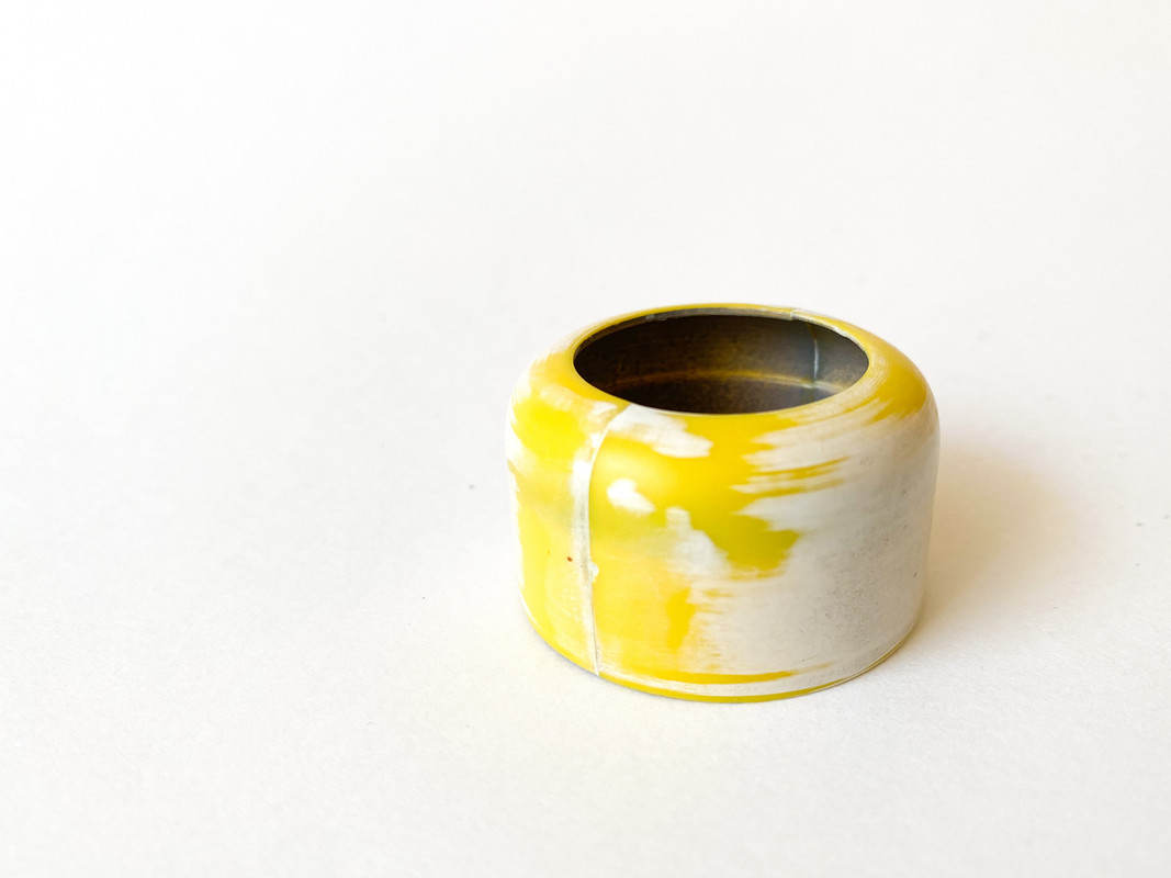

Smaller [first cowling]
So, the designers of the kit split this part in half, and the seam was not very tight. I back-filled with Milliput Fine White Putty, scraped that down to barely filling the seams, then let that cure. I have an old - maybe a year old - bottle of Gorilla Glue CA which is quite viscous. Using the end of a flat twist tie as a spatula, I filled in the surface imperfections on both sides. This was followed by 400 grit to 2,000 grit sanding.
Voila

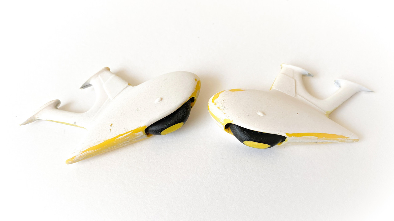

Same sort of seam preparation for the spats

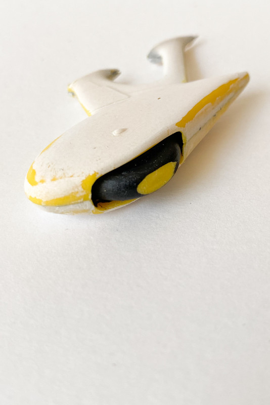

Posts: 11534
T’other side
Spat detail
Looking good! You know in thinking about the cowling. Wouldn’t a seam be appropriate to facilitate the removal?
