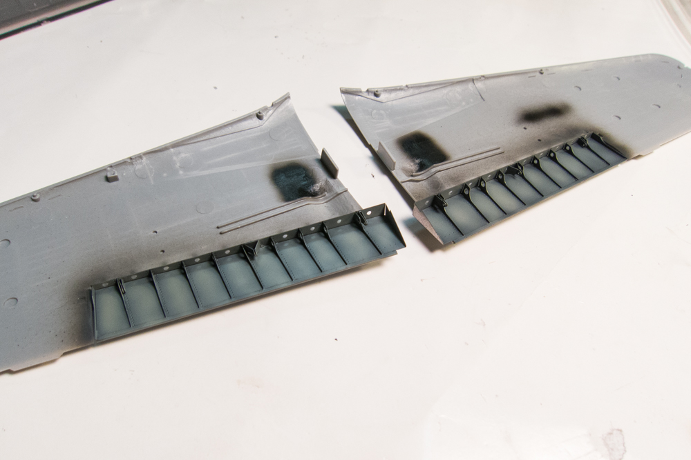

The interior of the upper flaps were painted RLM02 over a base coat of black.
The interior of the flaps were painted RLM02 over a base of Aclad Aluminum. I decided to have a two-tone finish on the flap interiors... metal background and RLM02 foreground. Since the RLM02 were sprayed over different colored bases, the upper and lower colors don't match and that's something that I'll have to adjust.

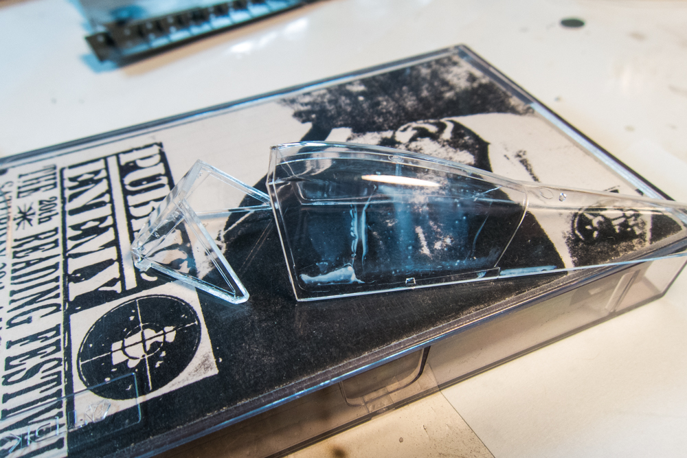

My first attempt at dipping the clear parts in Future weren't successful. I'm not sure what happened here but Future can be easily removed with Windex with no ill effects.
So I wiped the clear parts clean and did the dip again. Dipping in Future makes clear parts clearer and has the added advantage of protecting the clear parts from the frosting of CA glue.
