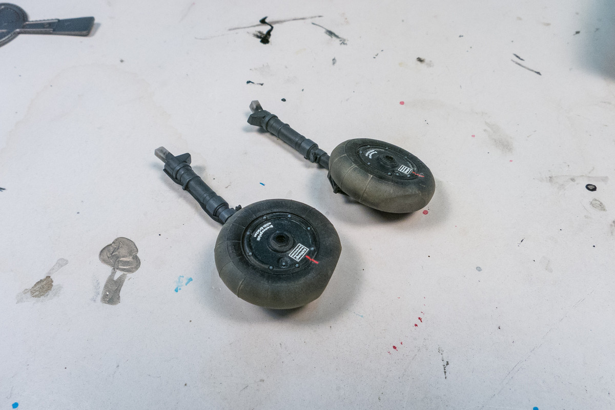

I thought it might be easier to orient the tire flat spots without the wings in the way. I might as well take advantage of the benefits of having the landing gear mounts on the fuselage and not the wings. And the aftermarket legs have a good, positive fit without too much wiggle. I used JB Kwik Weld, which starts to cure in a matter of minutes, to attach the wheels to the landing gear legs, allowing me some time to make sure the flat spots on the tires hit the ground correctly.

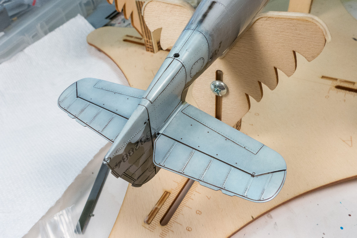

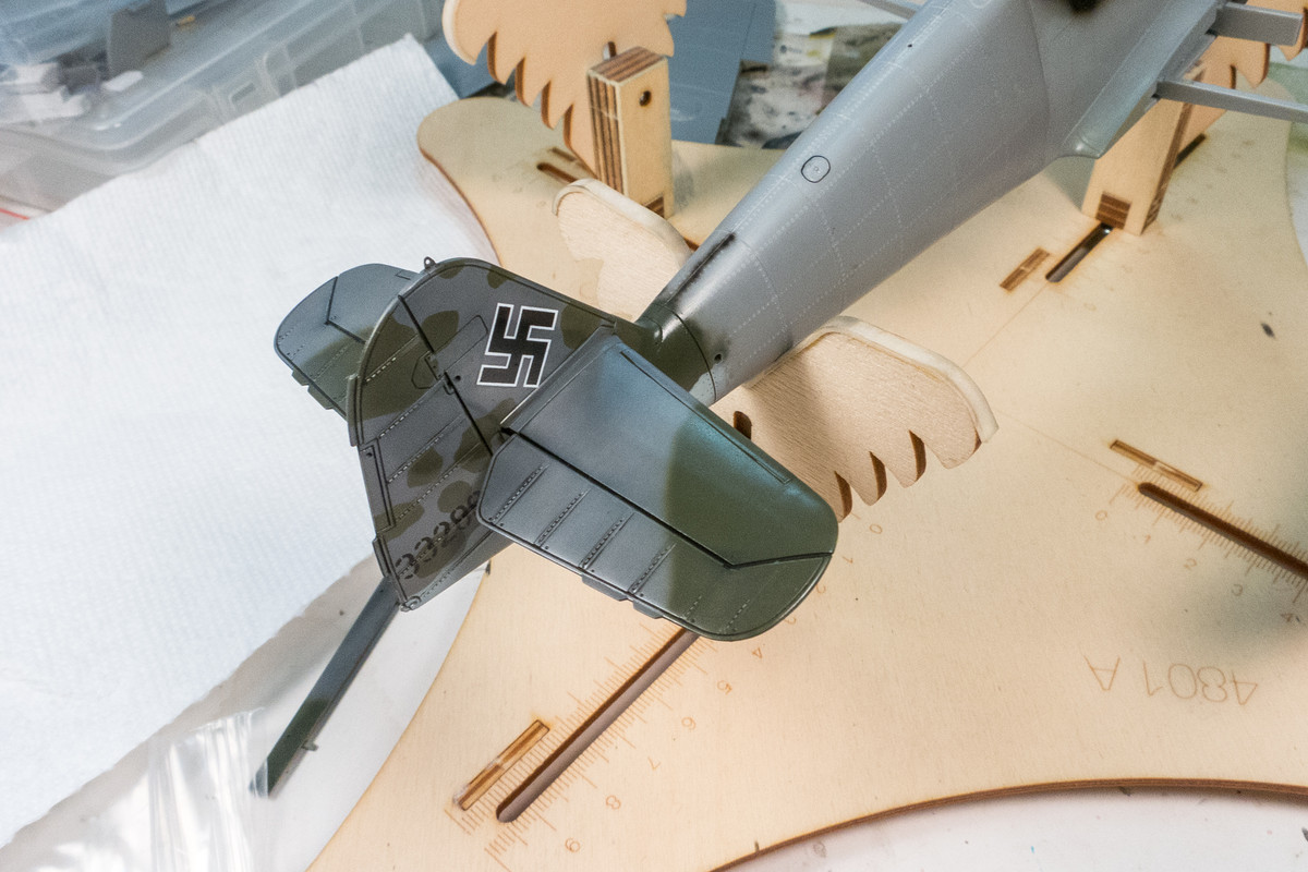

I've painted the elevators but have not glued them in place yet. I went ahead and applied a pastel wash to the tail unit but haven't sealed it with a flat coat yet.

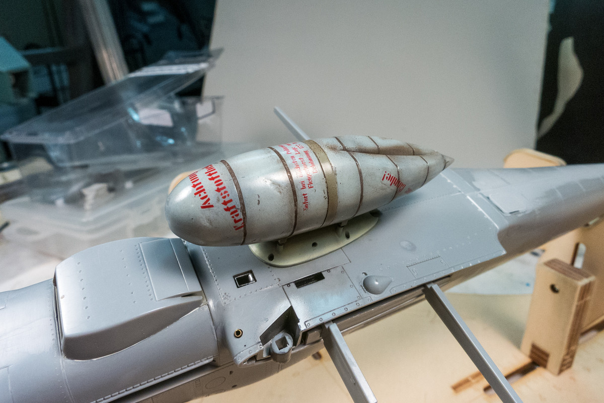

The drop tank has been painted and stenciled. Still some weathering left to do.

I really like the way your pastel washes turn out, I'm sorry if I missed how you mix them but I would like to give it a try myself if you wouldn't mind sharing your knowledge.
Re: 1/32 Hasegawa Bf109K-4 Weisse 8
Of course, Clint! If I may, I'll cut an paste the process that I documented on a previous build...
With the post-shading done, I will go to the next weathering step: pastel wash. This will be done using two colors given the color differences between the lower and upper surfaces. The bottom surfaces will be given a dark brown wash to highlight the recessed panel lines and rivets. Here is the bottom prior to the wash.
My thinned paint finishes are on the delicate side so I prefer using a wash that is benign to the paint finish. So I make my own water-based wash. It's very easy... all you need are some pastel chalks (not oil), water and some dishwashing soap.
I put a very small amount of water into a small container. For the bottom surfaces, I select a dark brown and a black piece of chalk. Using a knife blade, I scrape fine amounts of both chalks into the water.
Here are the ingredients prior to mixing. To help reduce the surface tension of the water and allow easier mixing, I add a small dap of dishwashing soap. Note the small amount of water that I am using.
Mix it well and you should get a nice, solidly-colored fluid. This small amount is enough to cover the entire model and then some.
Using a small paint brush, the wash is applied over the bottom surfaces, making sure that it gets into every recessed line, raised detail and rivet. Let this dry COMPLETELY.
I like to give my washes about 10-15 minutes to dry completely so that it holds in the places that I want it to hold. Wiping off a still wet wash will result in too much removal and you'll have to repeat the application. Once the wash application is dry, I begin to wipe it off using a piece of damp (not wet) paper towel. The dark pastel pigments will remain in any recess, serving to highlight that feature. Always end your wipes in the direction of the airflow.
The wash is systematically removed. Depending on the effect that you want to achieve, you can leave residual streaks of the dirty wash on the model to simulate wear.
Remember that crazy mottling pattern that I applied to the model before the camo painting? That was the first layer of effects that have been applied to the model. The pre-shading, post-shading and now the pastel wash, all work together to create an illusion of depth on the otherwise flat surface.

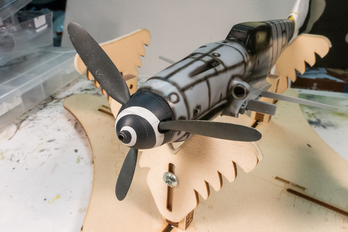

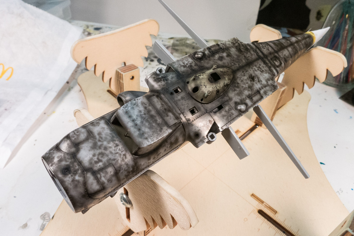

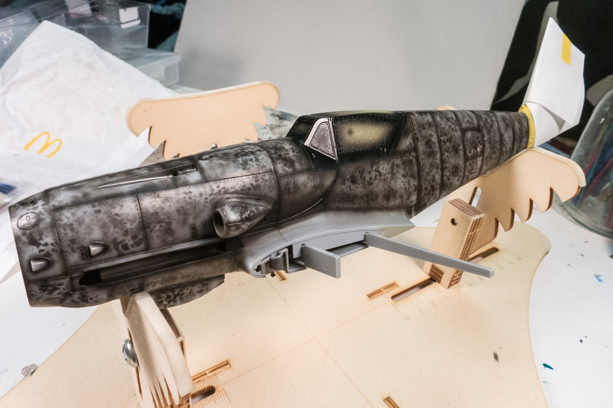

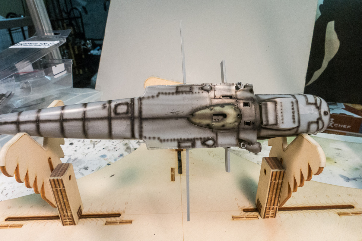

Now that I've decided to paint the fuselage before attaching the wings, I can lay down my pre-shading. First, I do all of the panel lines.
I've also did some darkening around various "waste"' areas such as the exhaust and behind the oil cooler.

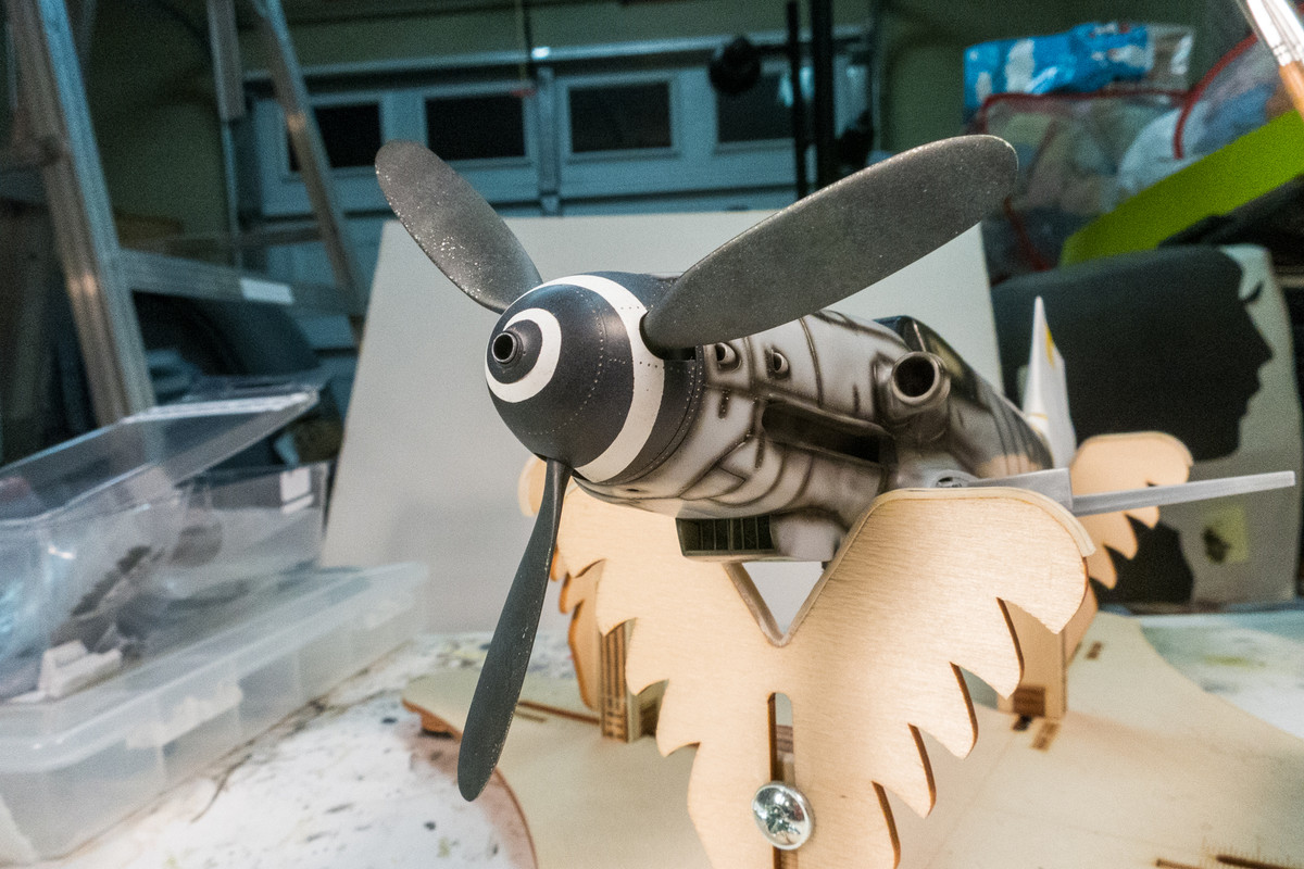

Next, I'll use my brillo pad and splatter templates to add some texture. In the meantime, I've attached the blades to the prop assembly.

After the panel lines have been blackened, I go to town on the rest of the airframe, shooting black through pieces of brillo pad and also through a splatter template. It looks crazy now but there is no such thing as overdone since the camo colors can cover all of this completely, if one wishes.
