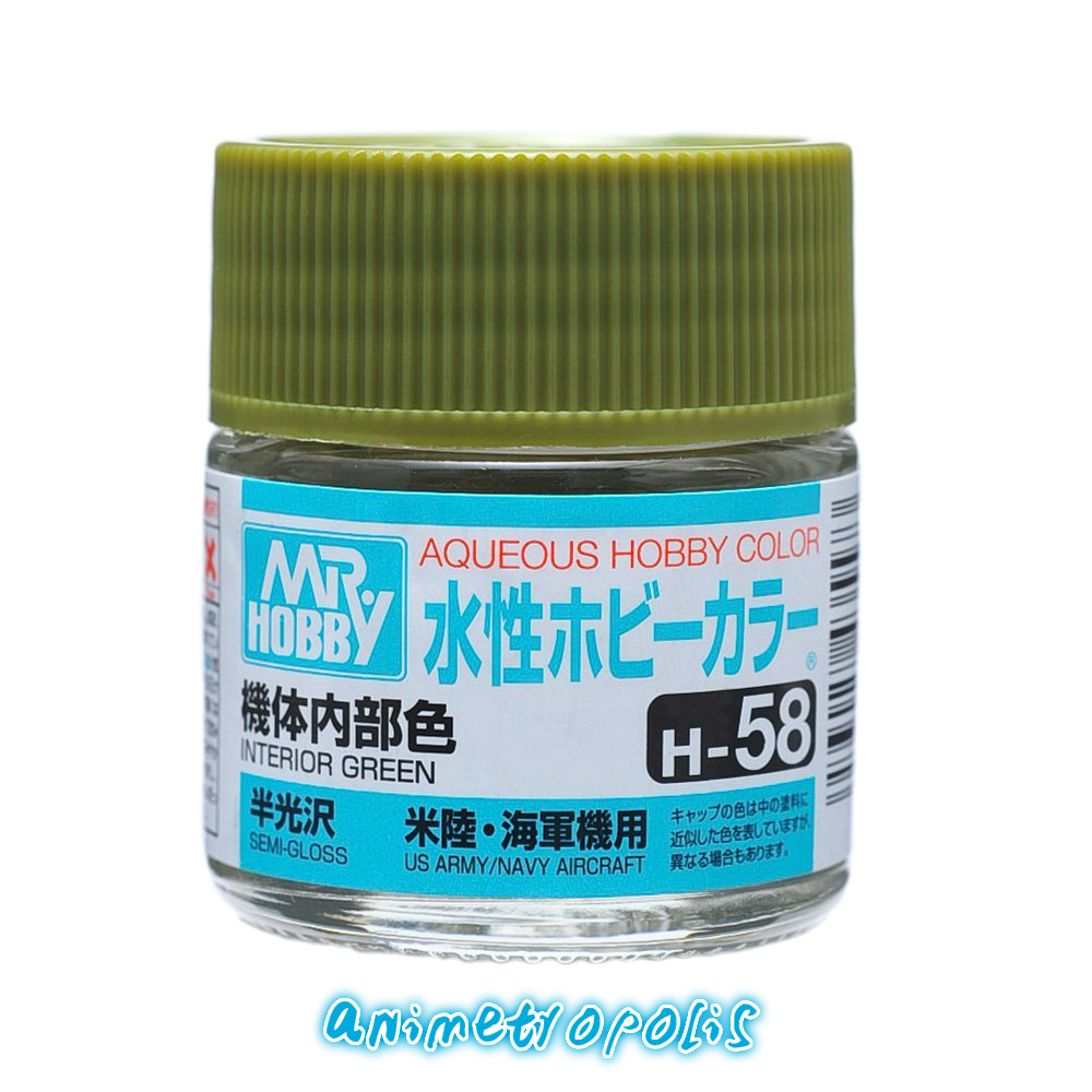

Now I need to find a decent interior green. Ah, the USAAF evolving chromatic color schemes! A real challenge... any advice, gents?

I don't know much about US interior greens. For the future Corsair build (which has been pushed behind Red 1 in the queue), I picked up some Gunze-Sangyo (Mr Hobby Aqueous) colors including Interior Green H-58 but that seems to be more of the zinc chromate type yellow-green specific to certain aircraft.
