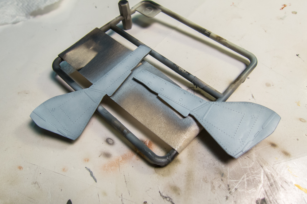

I wanted to give the red and white underside pattern a try so I used the landing gear covers as a test mule. For this test, I'm using my normal mottle pre-shading routine.
Tamiya X-1 White goes over the pre-shade.
Tamiya X-7 Red goes over the white.
It's workable but I'm not 100% happy with the tone of the red. It's a little bit too orangeish. I'll have to play around with base color or maybe try to find another shade of red to use.

Is there a way to shift the tone of the red by changing from a white base? I was thinking Neutral Gray but maybe that wouldn't do anything. But yes, a deeper red is what I am after. I might pick up Tamiya XF-7 (Flat Red) and XF-9 (Hull Red) at the local hobby shop. If the Flat Red doesn't work, maybe I could mix the two to get a deeper red.

The colors are actually a little more washed out in person than the photograph shows. This test bed is preliminary stab at doing the red/white undersurfaces and I'll probably have to make some adjustments to my normal painting process to get the colors right. I may have to forgo trying to establish any pre-shade effects in order to get a more opaque white. I think this is fine since the contrasting stripes tend to crush the subtle pre-shade anyway. I have the color photo in Crandall's Dora book that I can refer as well as the red color on the EagleCal decal sheet.
