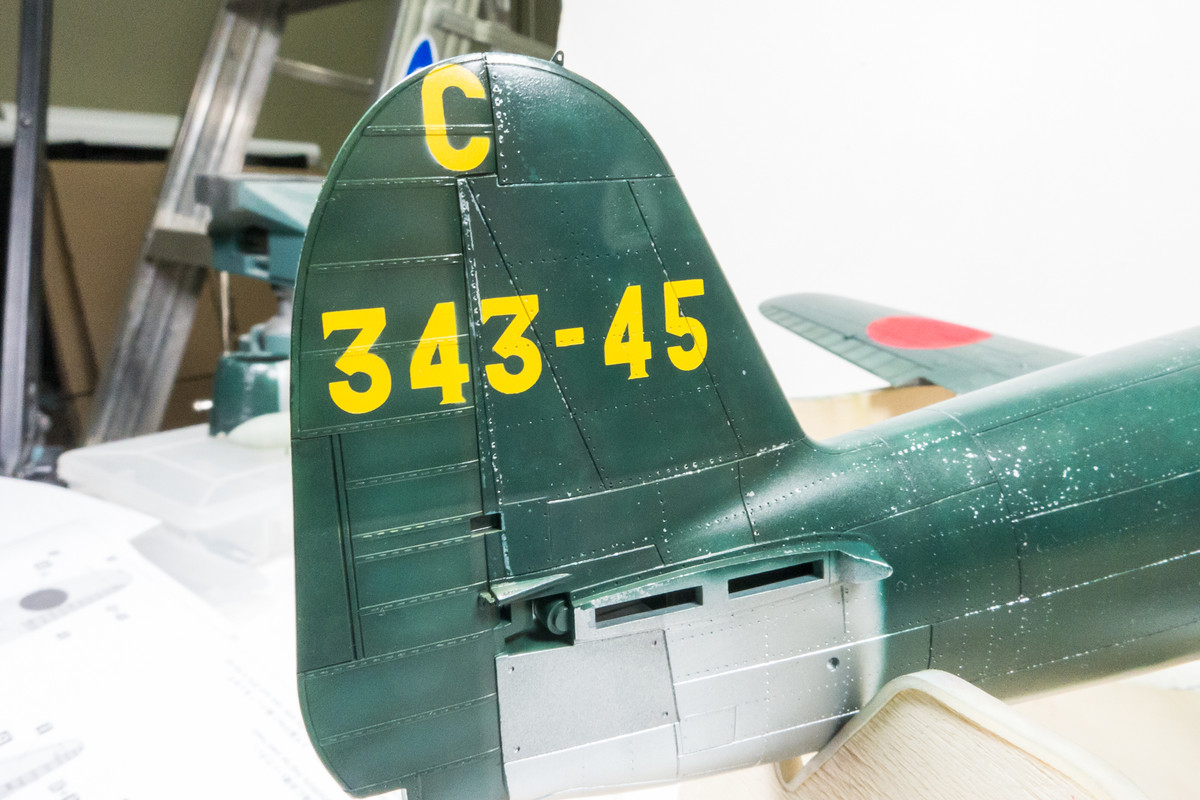

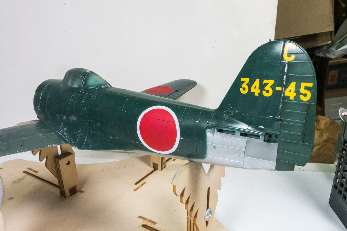

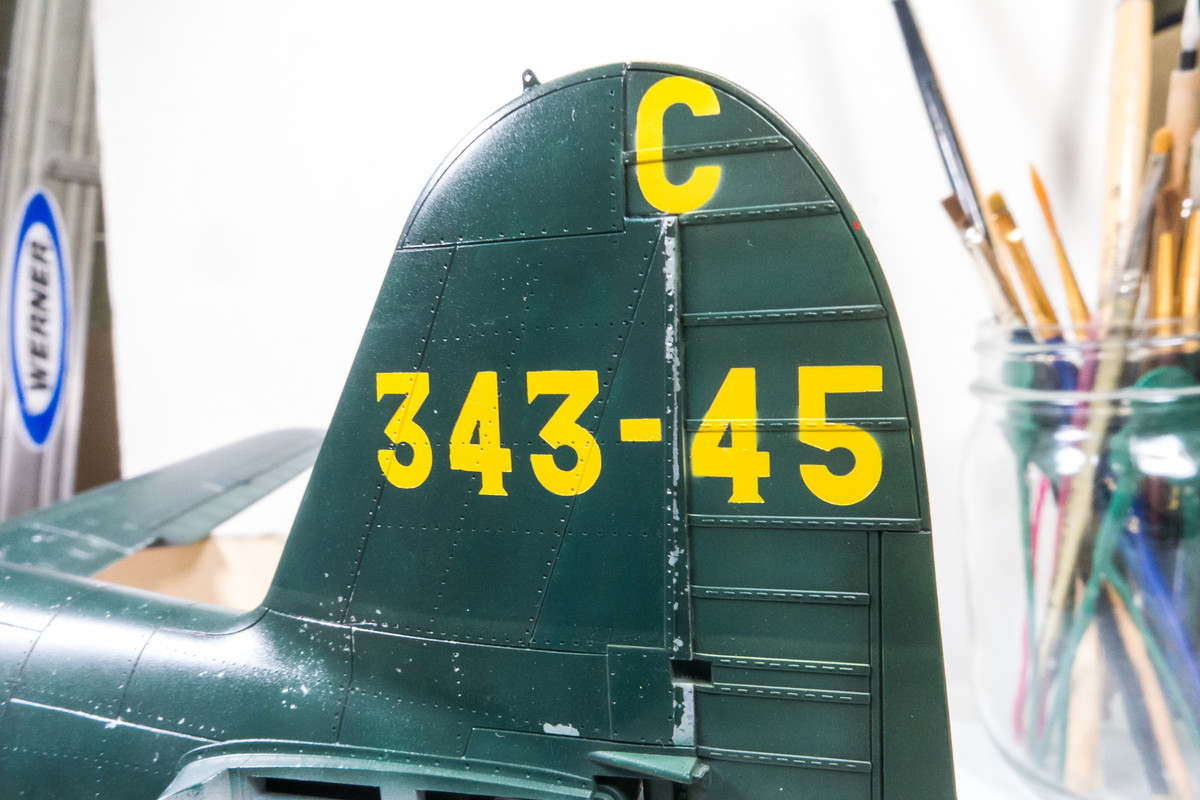

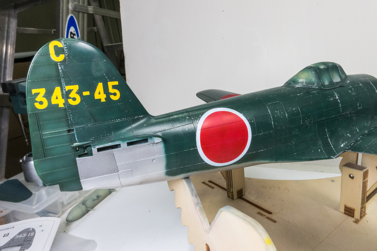

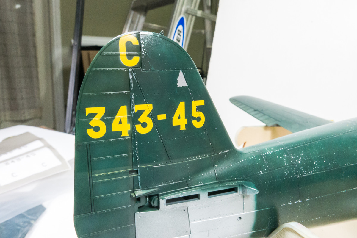

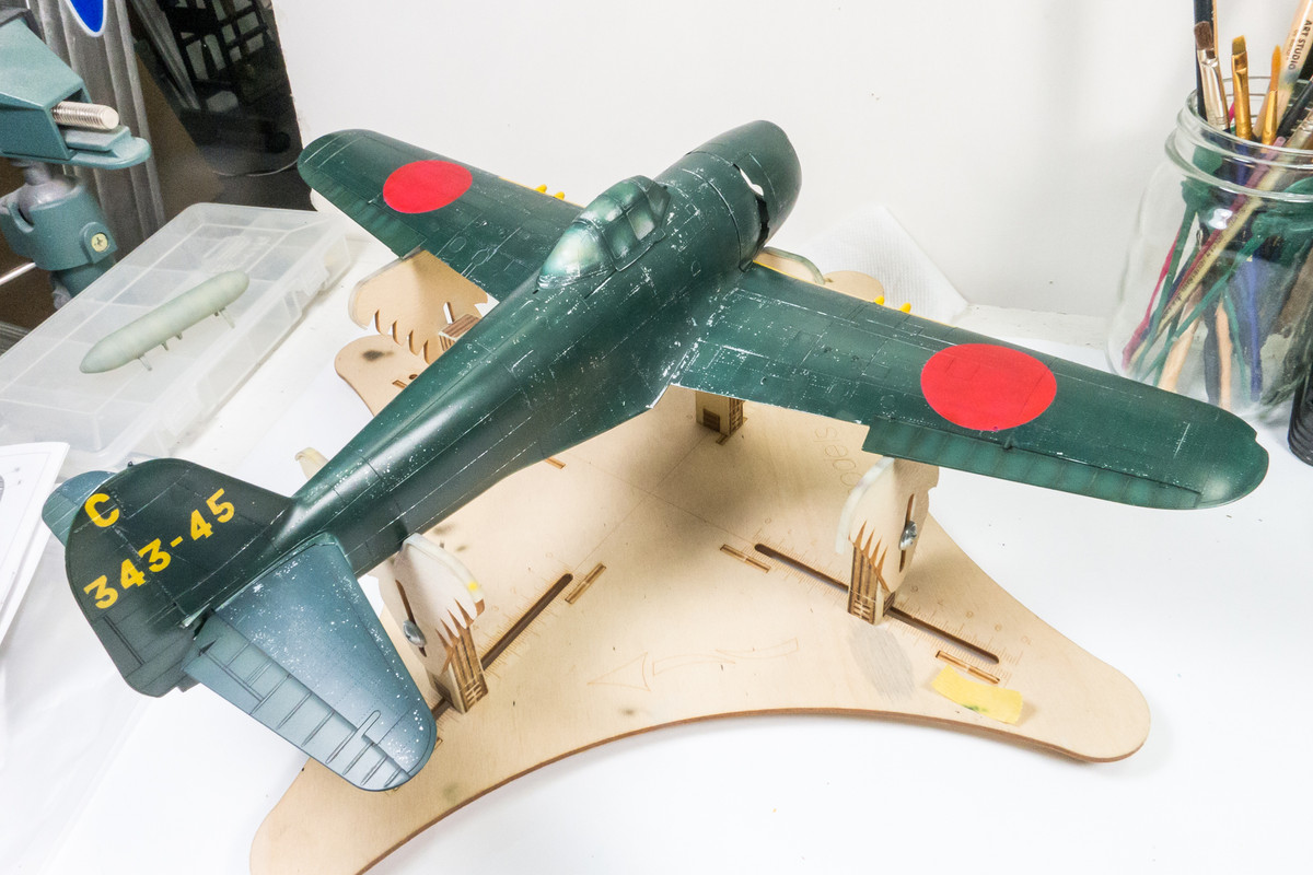

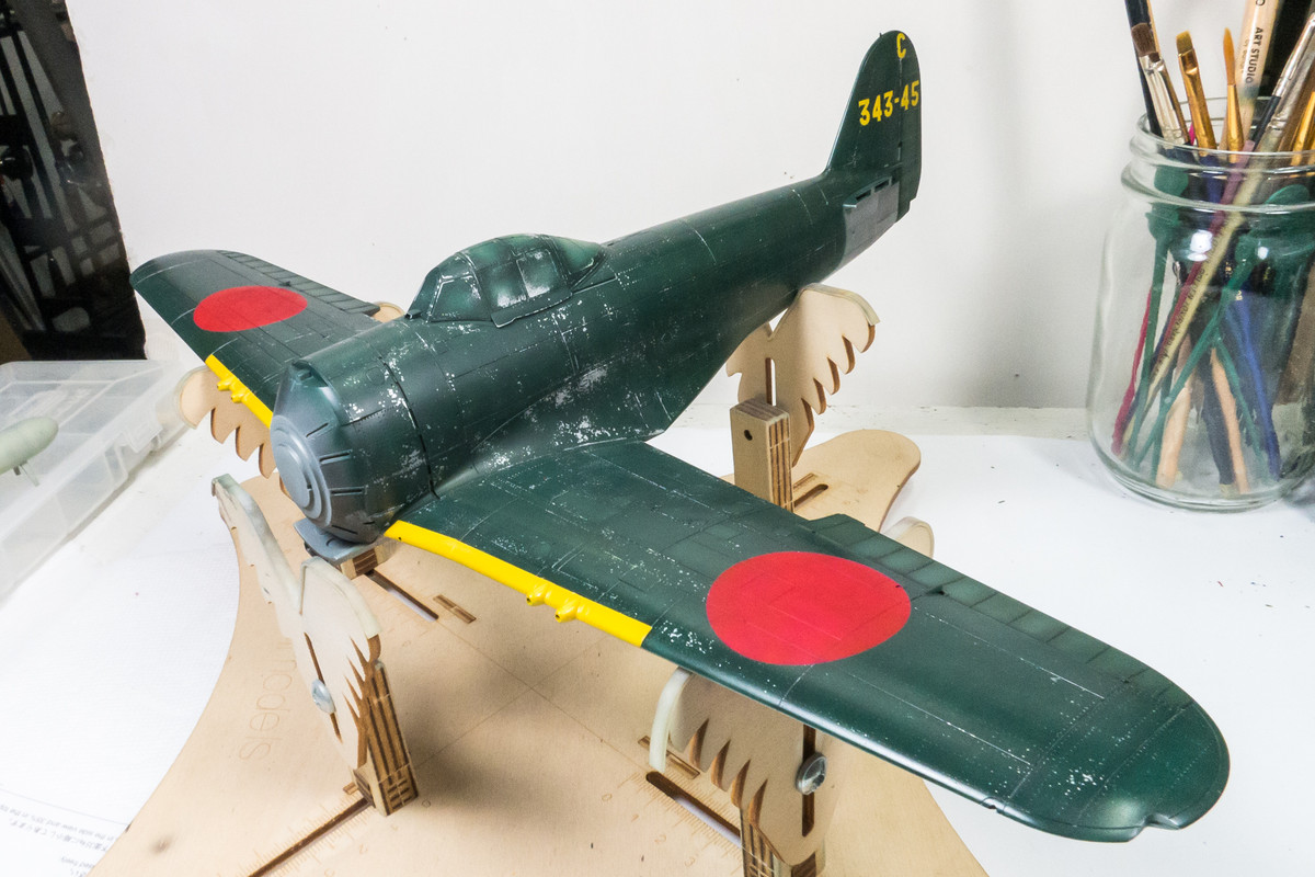

Thanks guys! After letting the green paint sit a full day after the chipping exercise AND with a clear coat over it as an insurance policy, it is time to do rest of the mask markings. First I tackled the yellow tail codes. I used a coat of white to serve as a base for the yellow which was Tamiya Yellow plus a dab of Tamiya Red.
I got a little bit of paint lifting on the starboard side but nothing too alarming.
No lifting on the port side!
There was a bit of overspray since the raised details on the rudder prevented the masks from sitting flush in certain areas. The starboard side "4" was the worst offender and since I had to fix the paint lift, I used the positive "4" mask to fix both areas. The chip fix area stands out right now because it is flat but should disappear once a clear coat is applied.

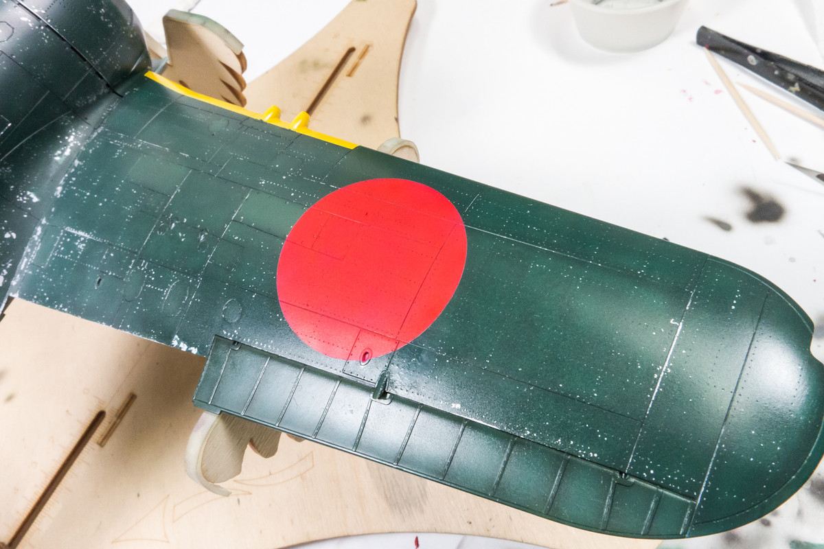

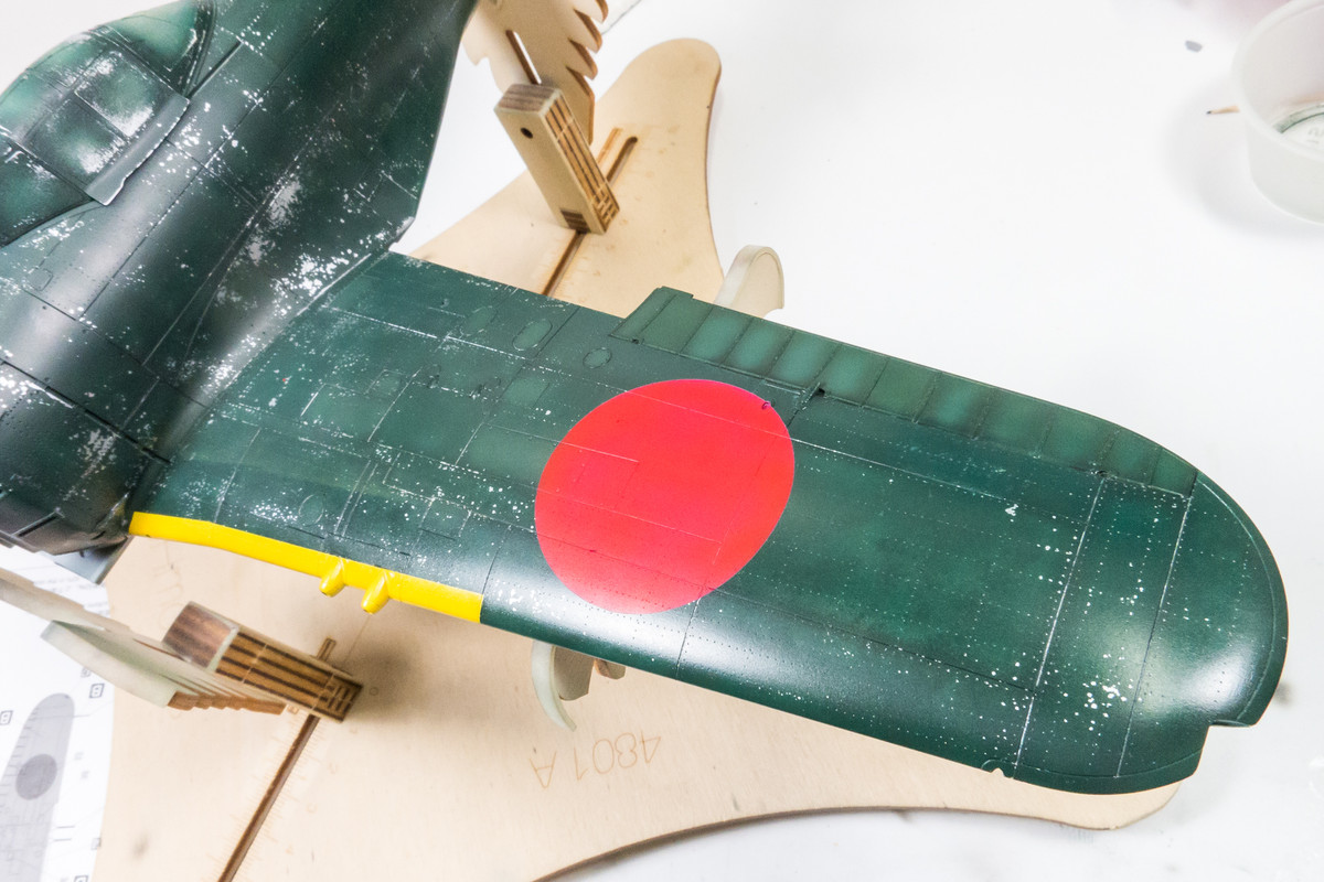

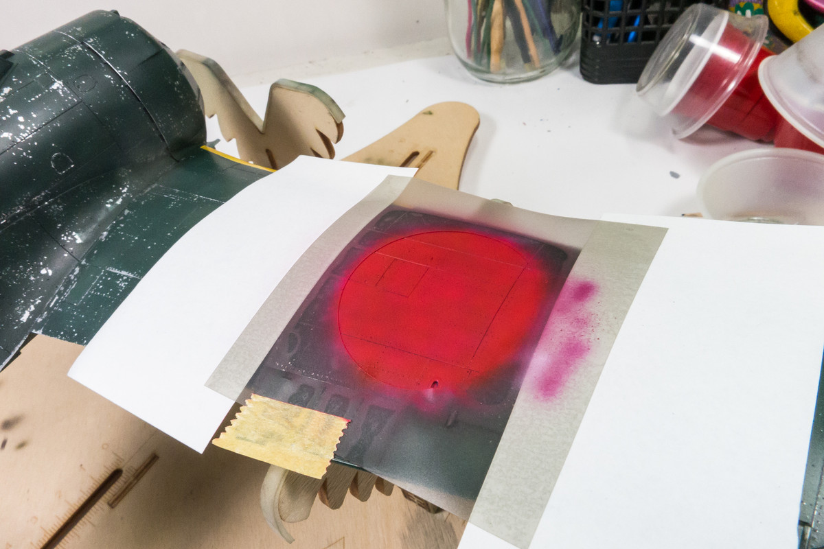

The upper wing hinomarus are next. They are done just like the bottom.
No paint lifting on either side... what a relief!

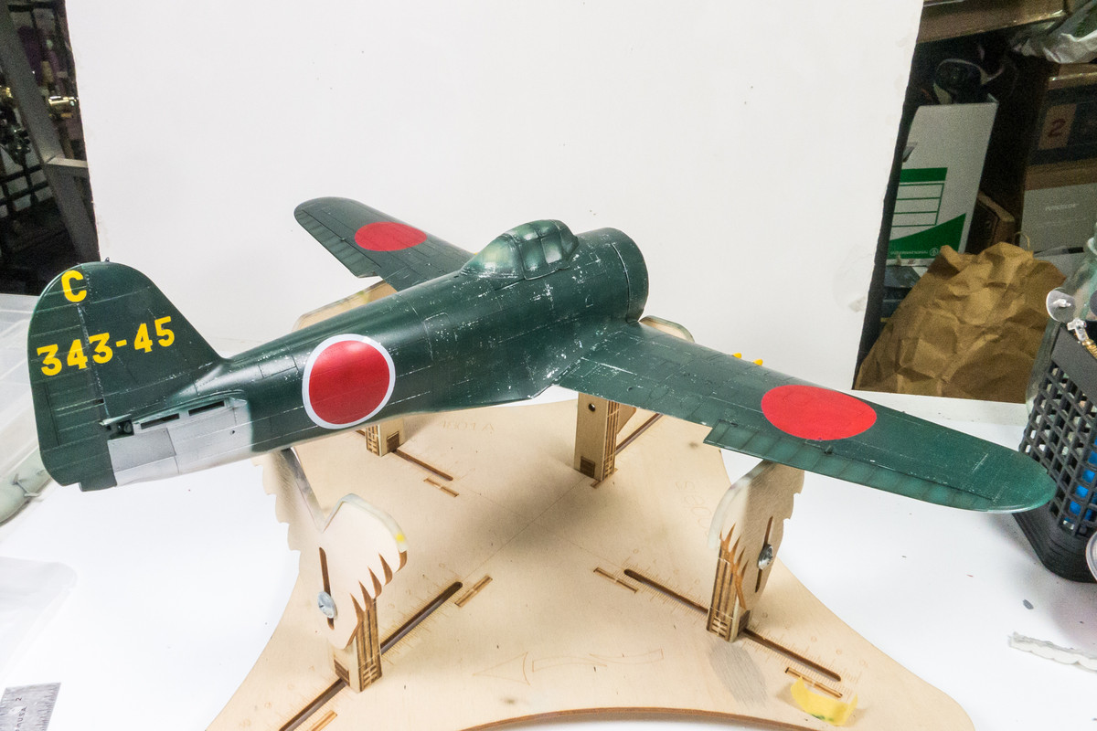

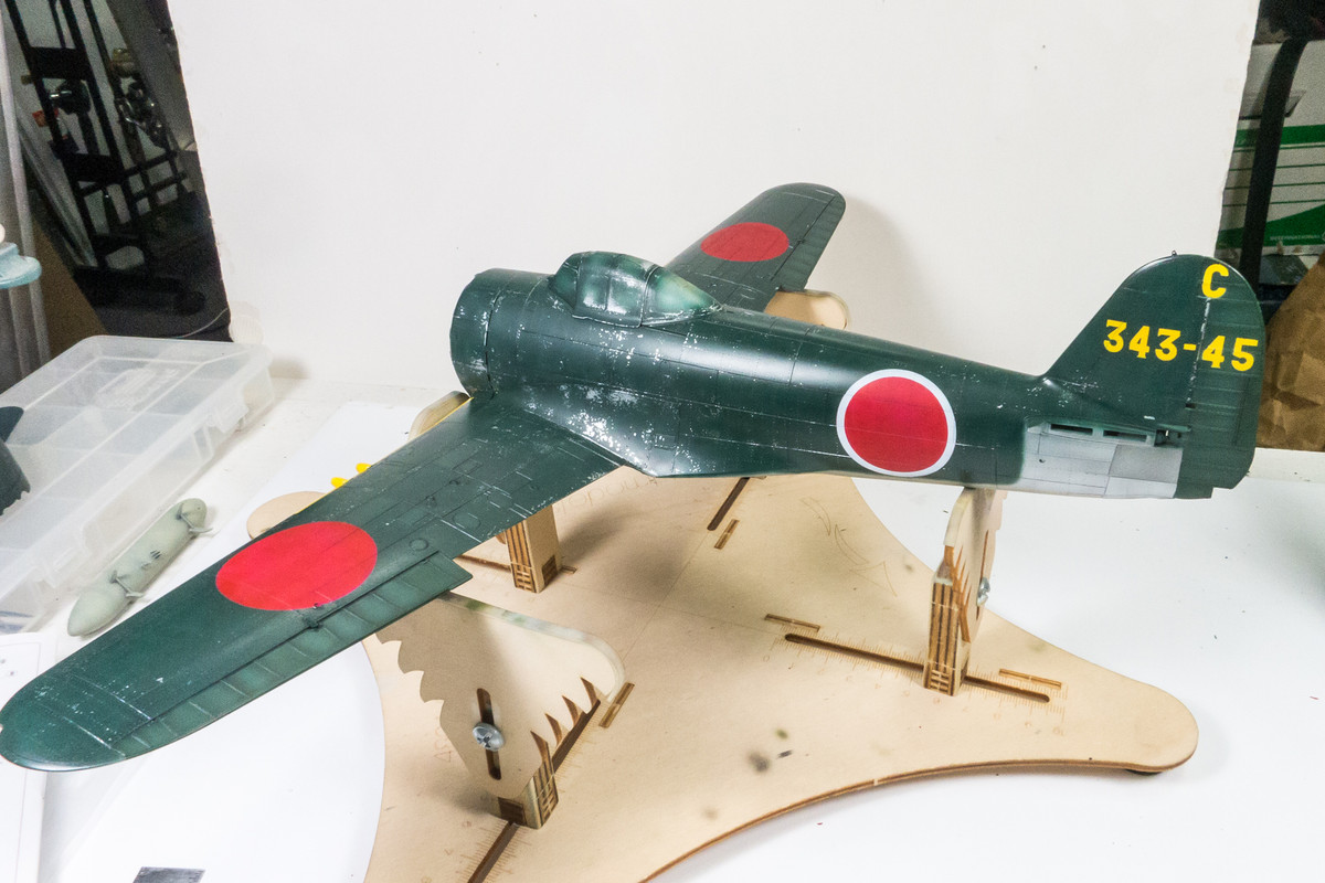

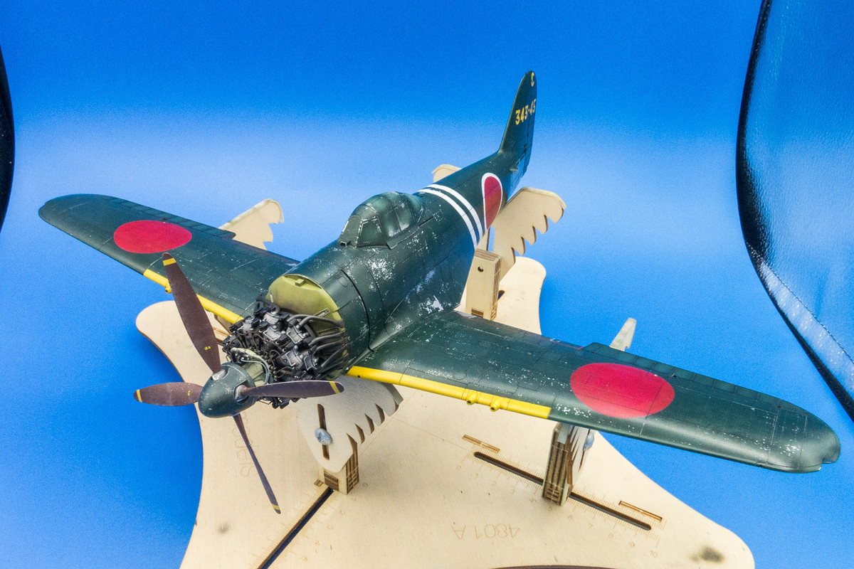

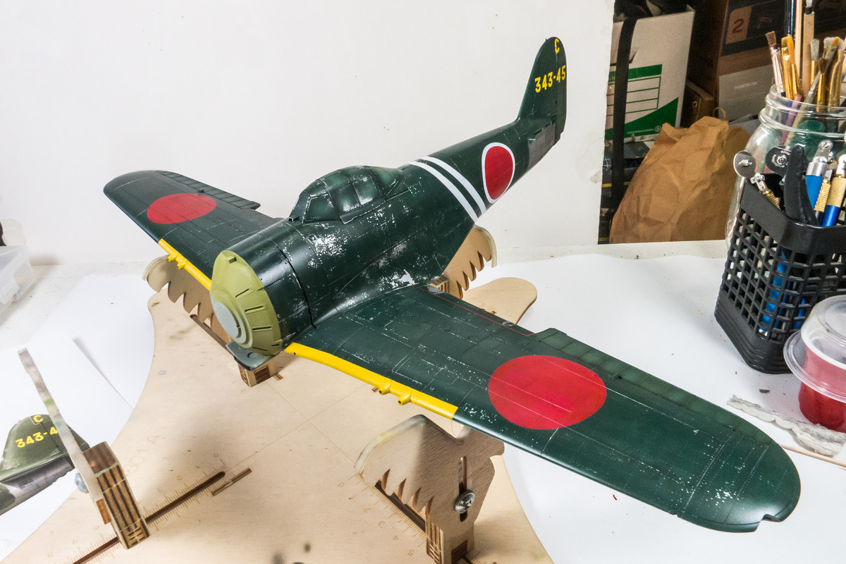

With the cowling and stabilizers attached, it is starting to look like a Shiden Kai.

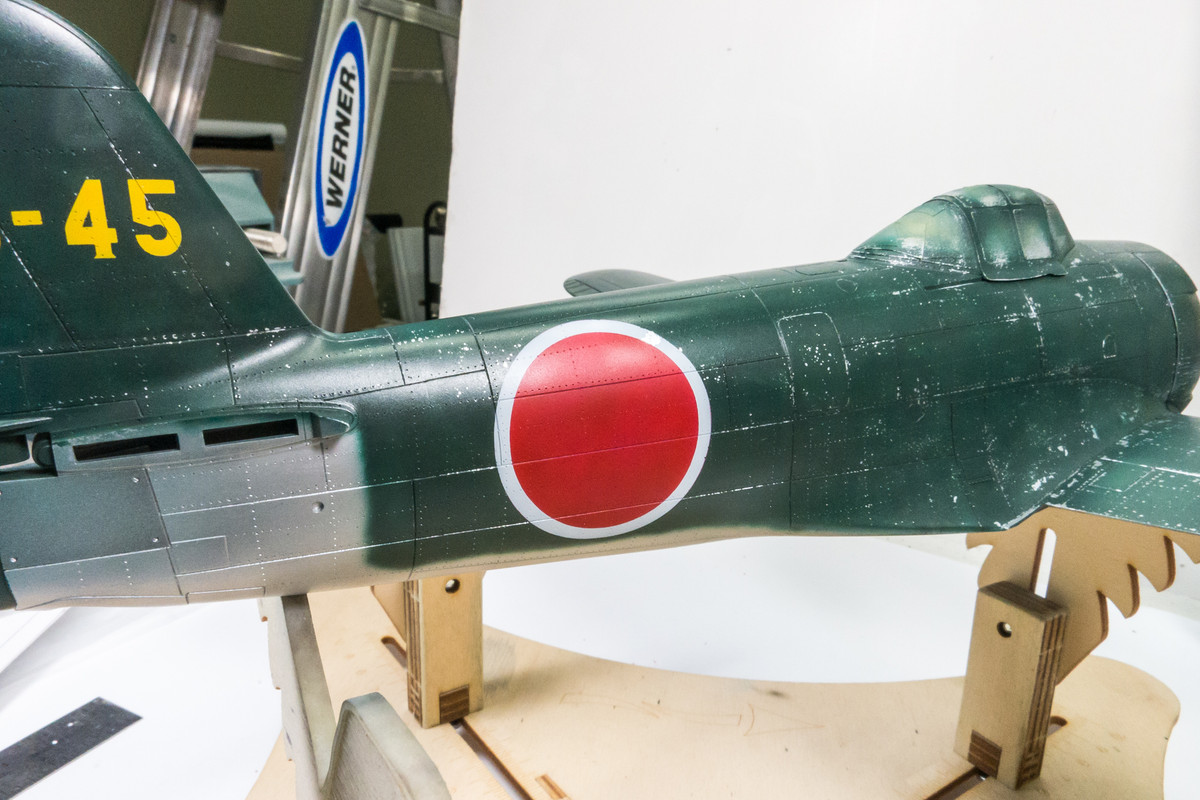

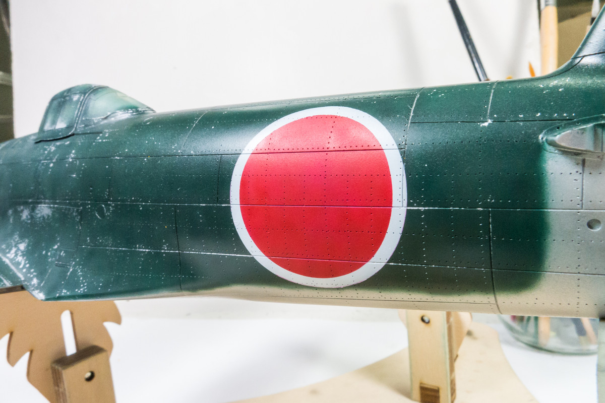

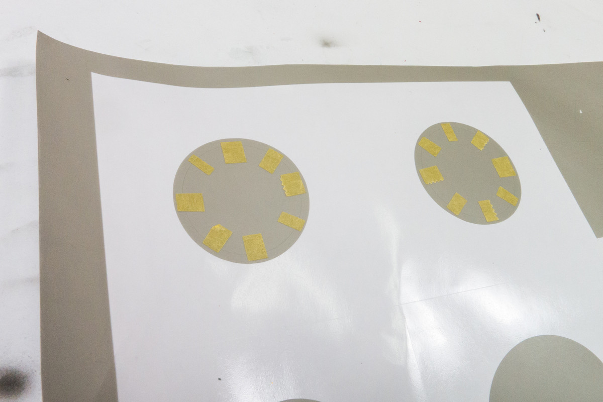

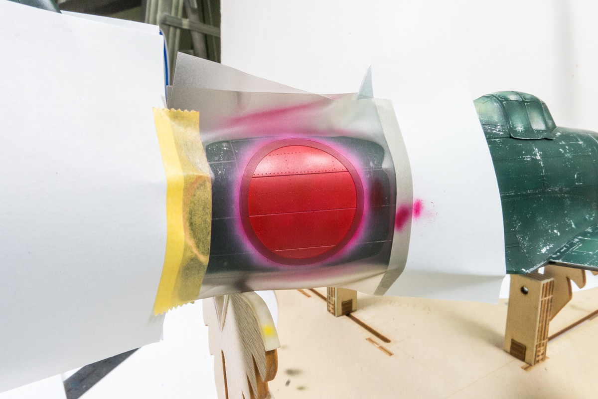

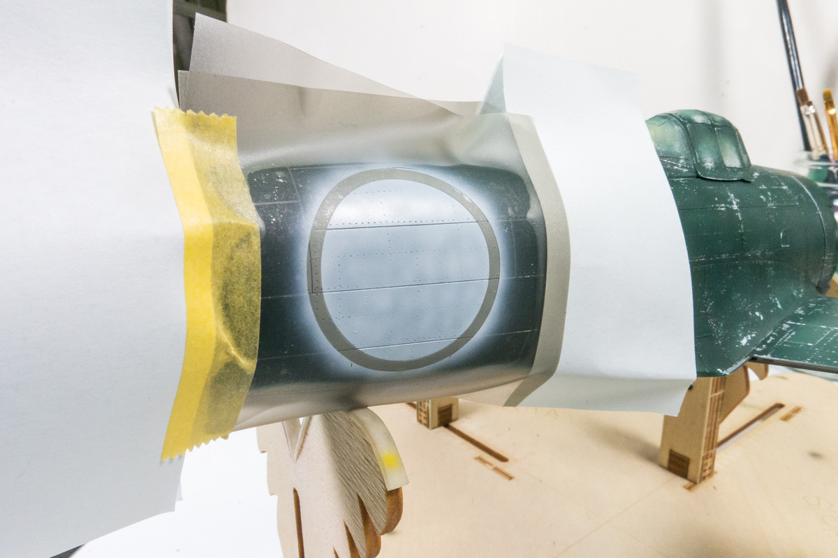

Next come the fuselage hinomarus, which have white borders. First the outline mask is applied and white is sprayed on similar to the other hinomarus but with more white around the circumference of the circle. That is allowed to dry for a couple of hours.
I thought a circle would be much easier to manipulate than a flimsy ring so I used bits of Tamiya tape to affix the ring to the inner circle temporarily.
Once the composite circle mask was placed in position, the tape and center circle are removed, leaving only the outer ring. To prevent any paint leakage between the two mask components, I sprayed the joint with clear. Liquid mask would be another alternative.
The red is then applied.

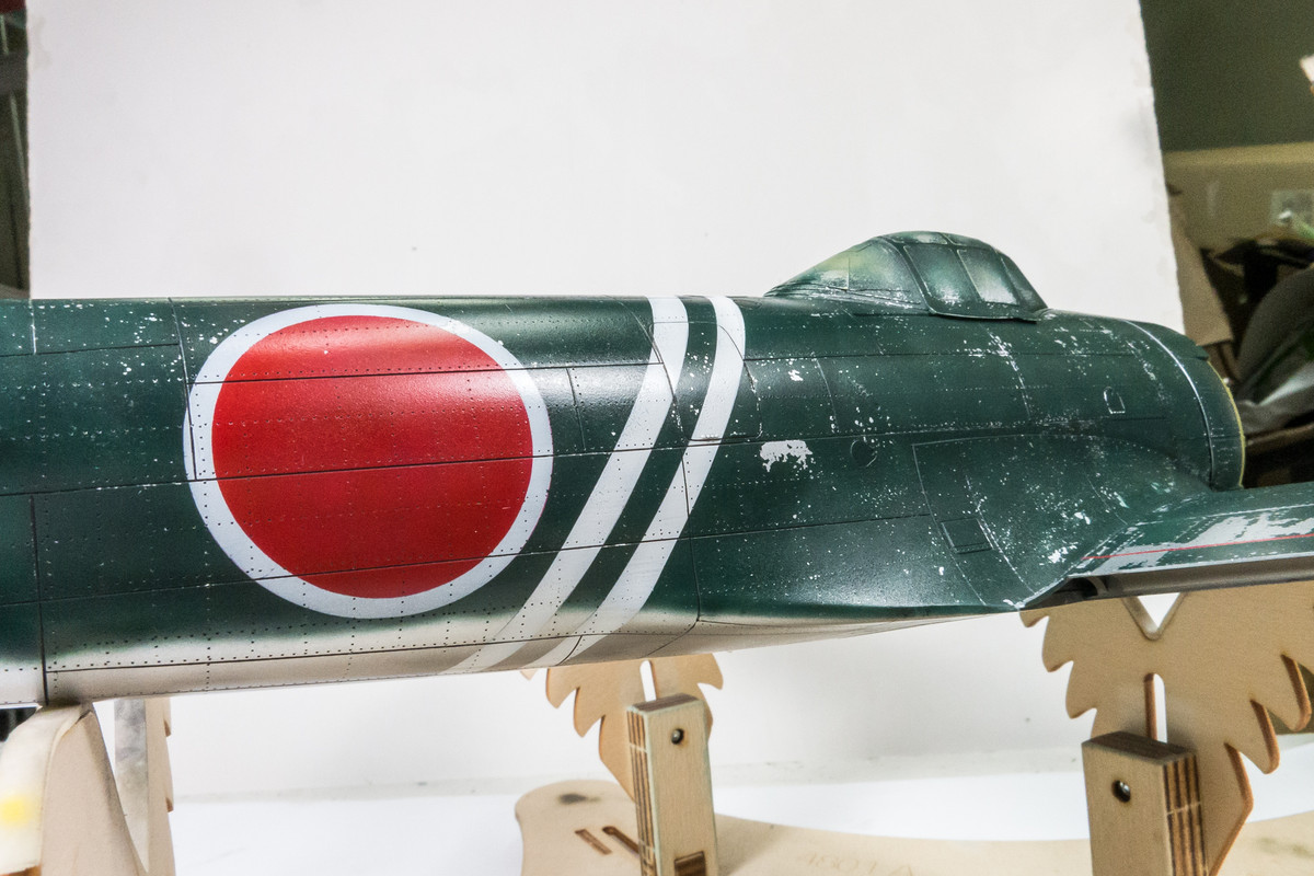

The finished two-color hinomaru. There was only a small paint lift on the white ring of the starboard hinomaru. I might just leave it alone.
No paint lifting on the port hinomaru.
It's a big relief to get these major markings on without too much paint lift trauma. Still to come are the white fuselage stripes. I haven't quite decided how those will be done... masks or tape?

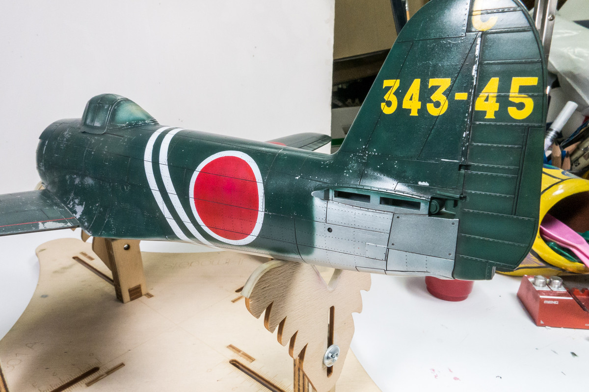

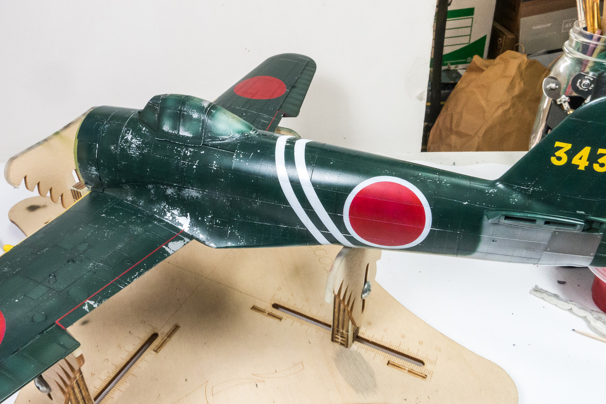

Thanks guys! Painting continues on the Shiden Kai. More bumps in the road but I'm used to them by now and have learned to roll with these punches.

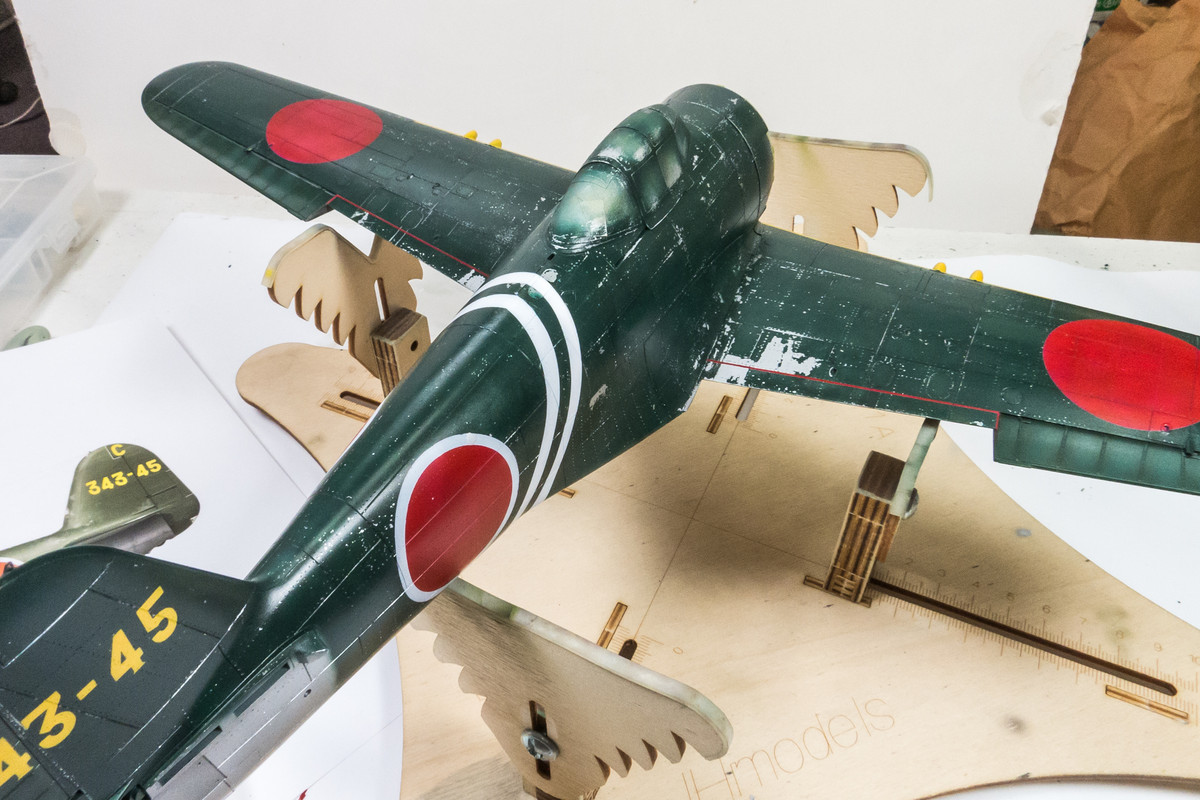

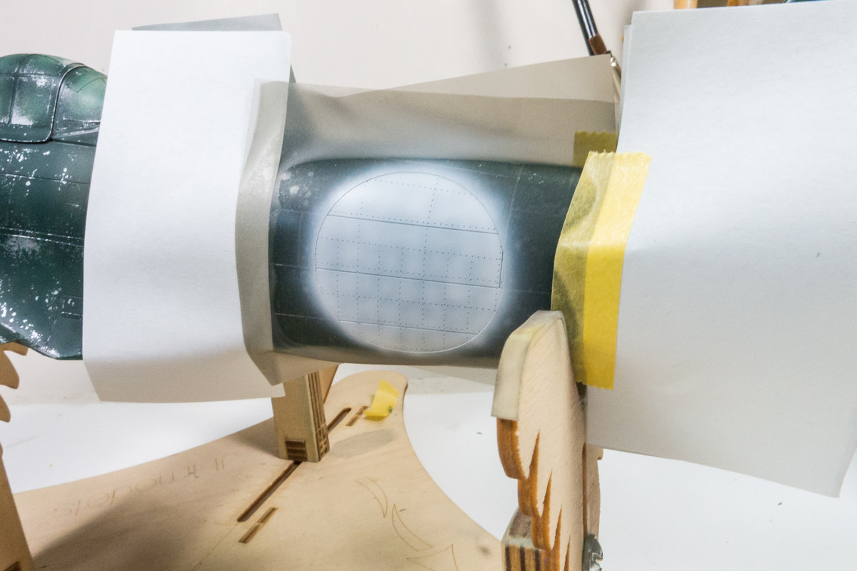

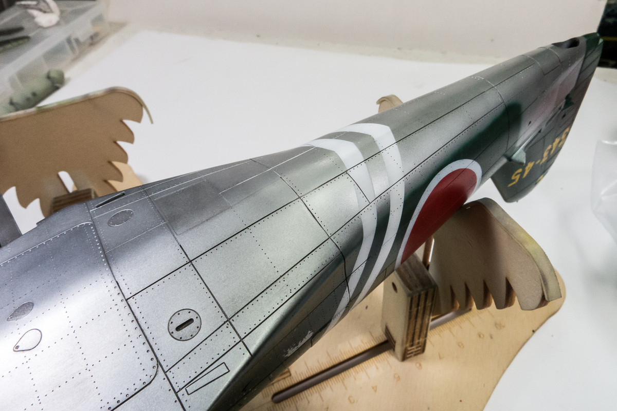

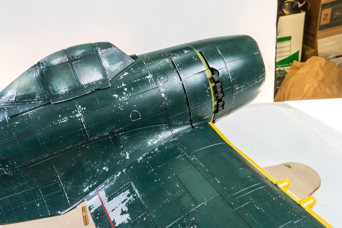

I used flexible white Tamiya tape to mask off the fuselage stripes. Lots more paint lifting occurred. Again, the lift patterns are pretty interesting and almost usable. If I was going to do a really heavily chipped Japanese scheme, I would've incorporated these mishaps into the build... maybe even purposefully caused them. But for my bird, I've decided that they are just too much.

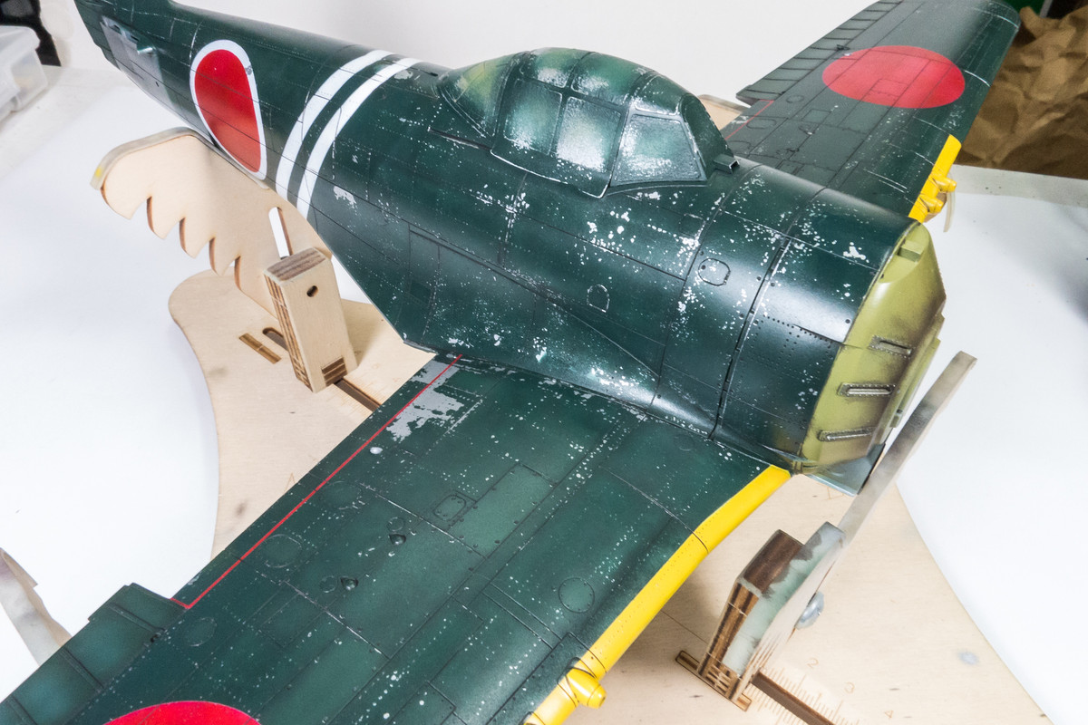

I've not found a good way to preserve any of the paint lift areas so it is all or nothing. I carefully masked the white stripe areas and repaired the paint lift sections. You will note some paint lift on the wings which resulted from the masking and painting of the red NO WALK line. They are quite heavy but since they are constrained to what I consider to be the highest wear area, I've decided to keep them.

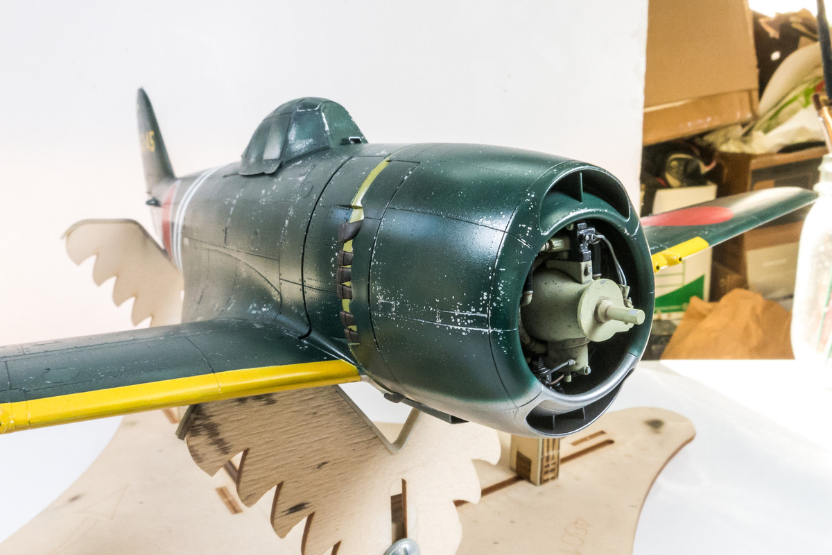

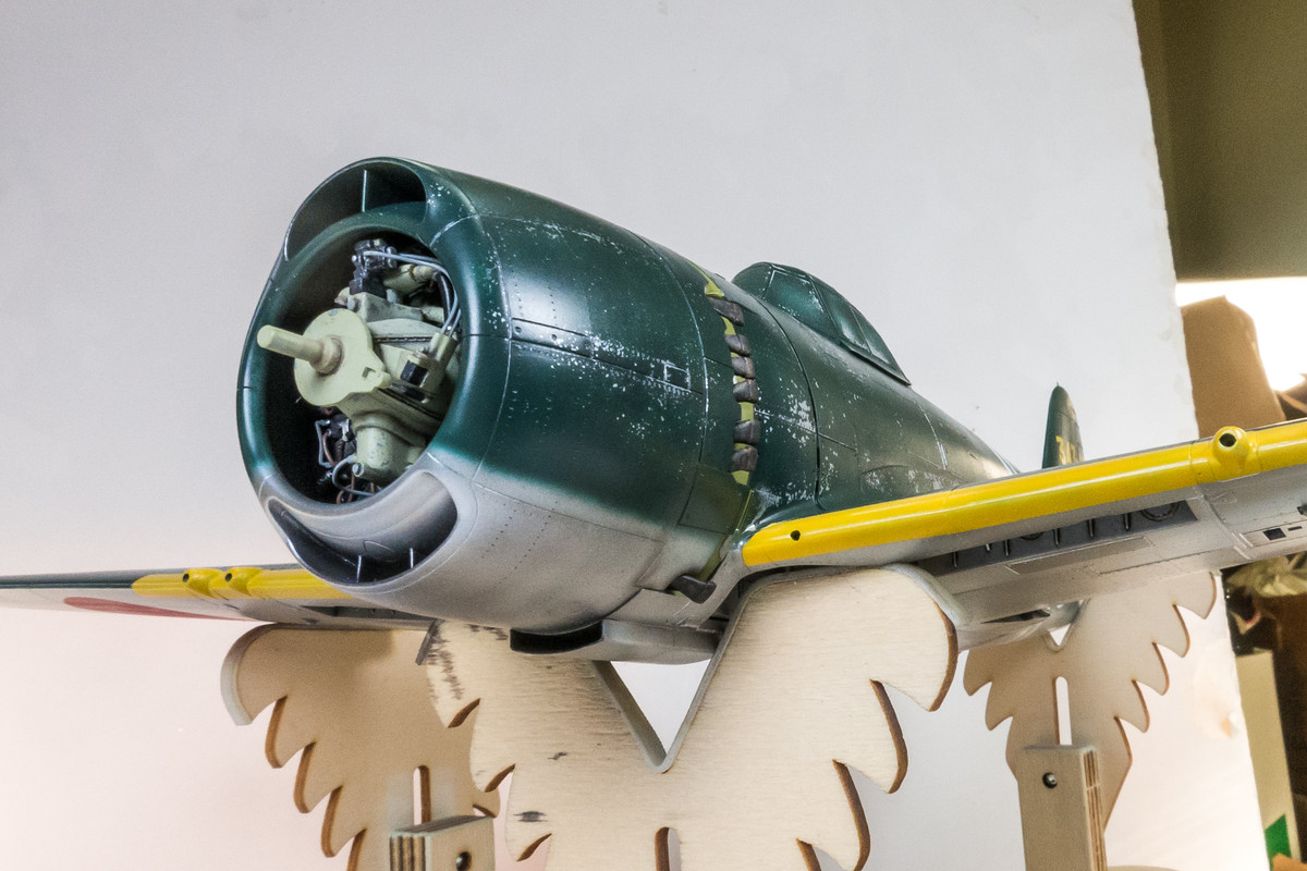

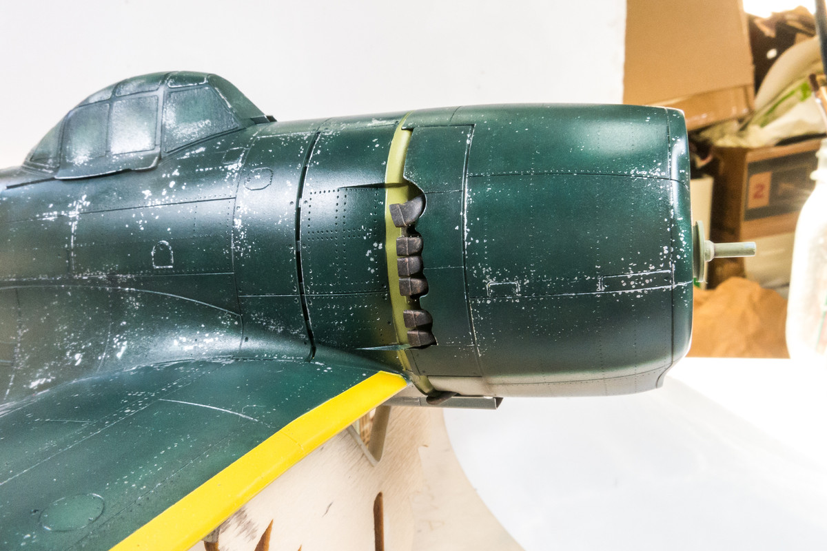

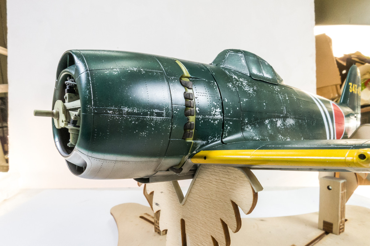

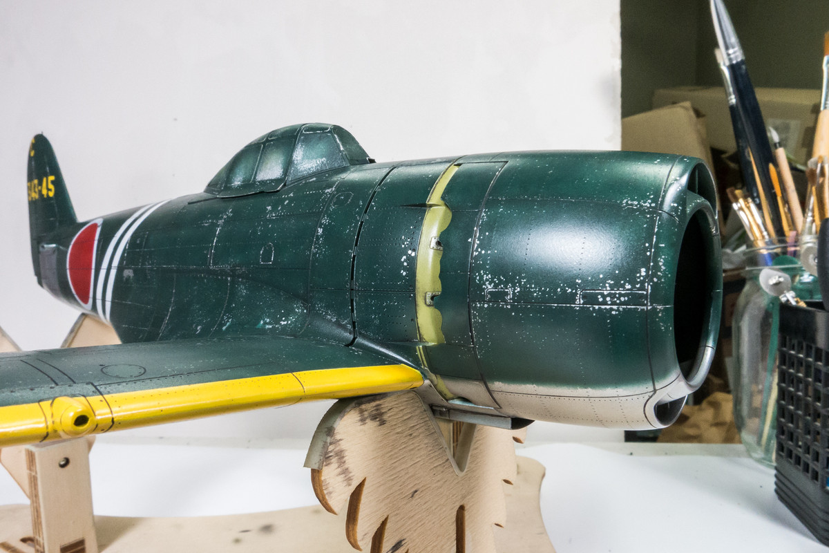

I elected to paint the engine mount area in the interior green color as offered in the kit instructions. I still need to do a pastel wash and post-shading so this area will get more dirty as we go on.
This is what it will look like with the engine mounted. I am leaning towards leaving the engine cowling unglued. The prop is removable via polycap so there will be an option to pose the aircraft with the cowling off.
Some shots with the cowling in place...

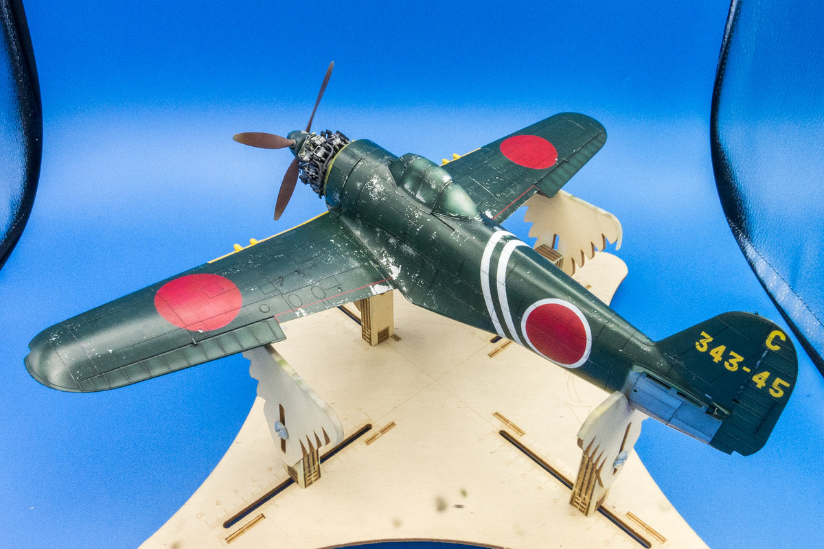

Thanks gents! I'm glad you guys think she looks beautiful even though that chipping is making my eyes sore right now. And that gloss coat is making photography difficult with my lighting setup. Although I'm not completely happy at this stage, I gotta trust in the plan and that subsequent steps will eventually tie the different elements together.

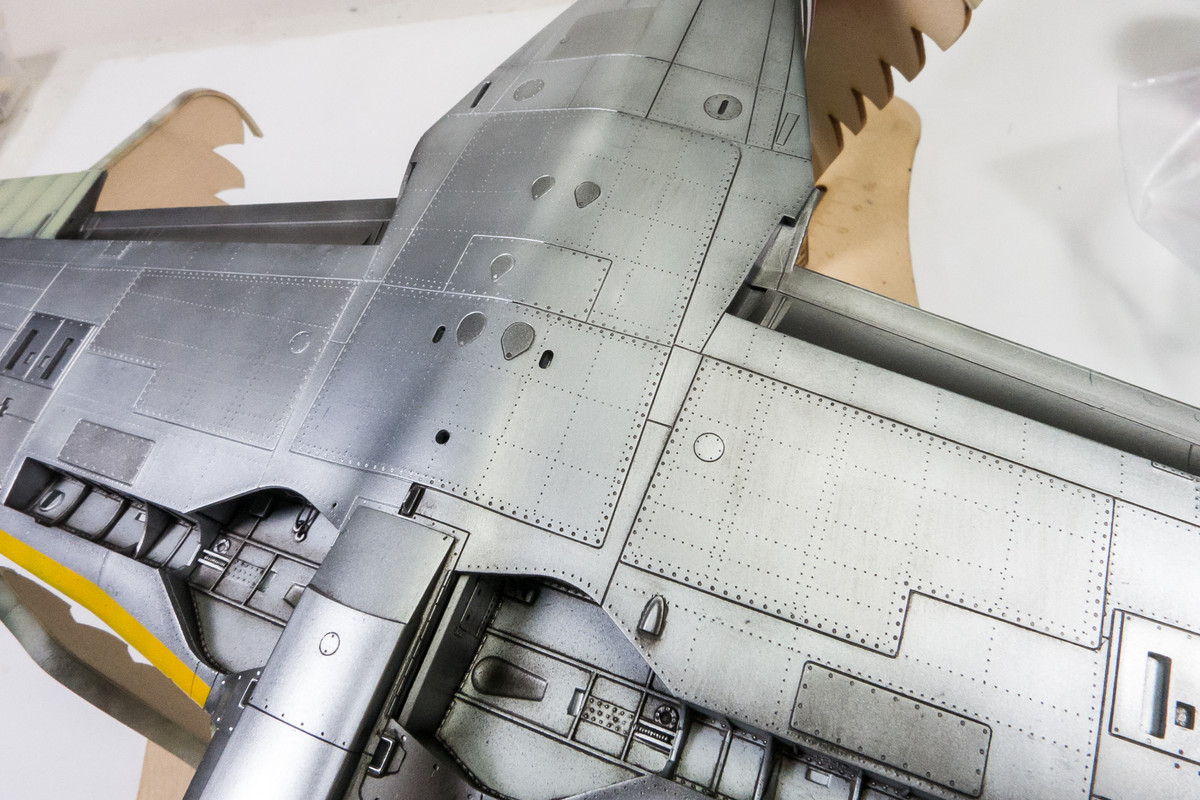

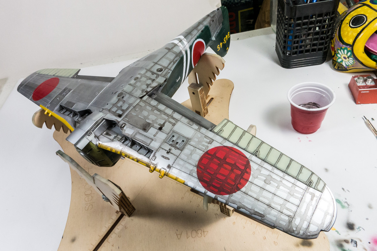

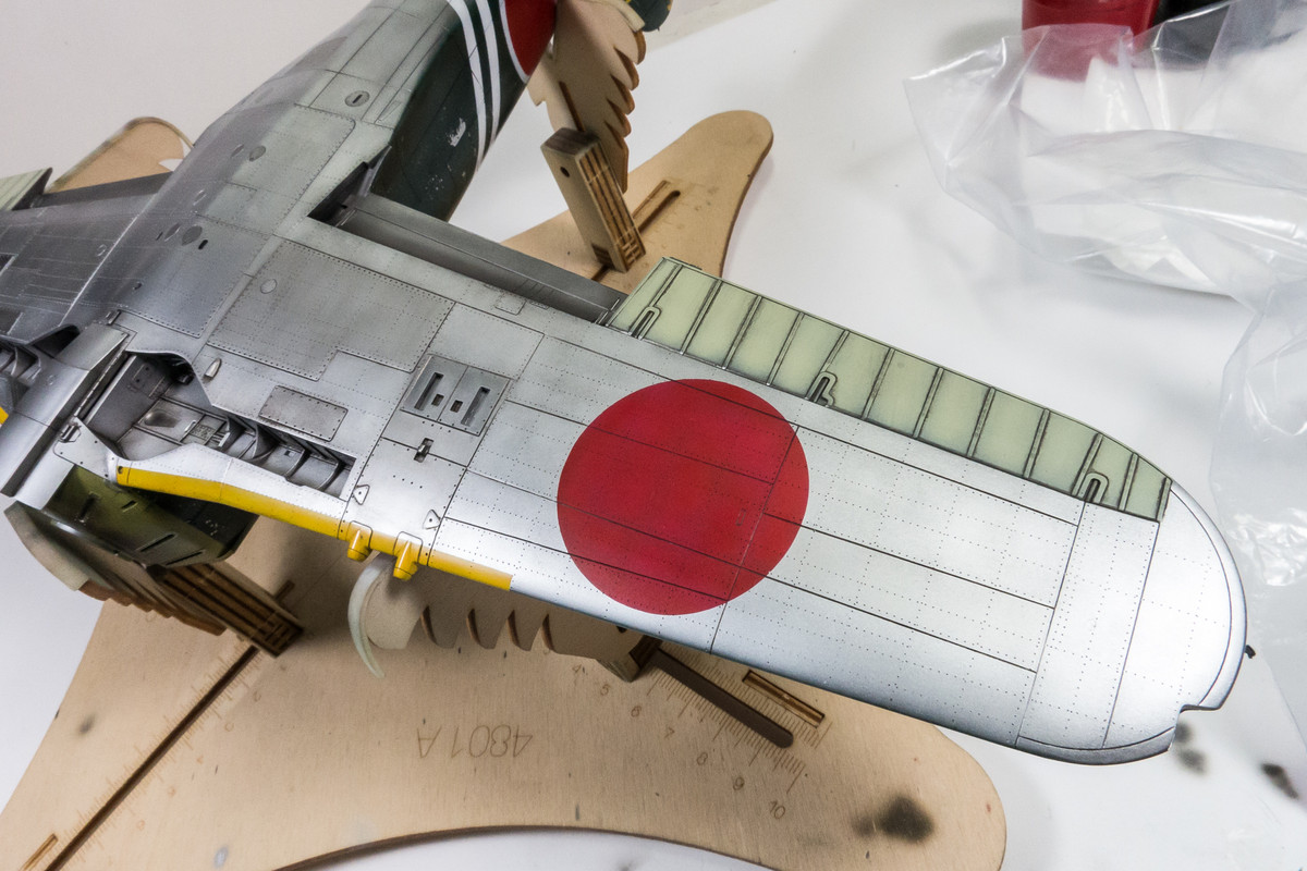

The next step is to apply a pastel wash to the model. I mix my own washes using pastel chalks, water and a dab of dishwashing soap to help suspend the chalk in the liquid. Very simple and can be used on any type of paint finish. I'm using a dark brown overall. The wash will have the greatest impact on lighter colors so I start on the bottom.
You can see the effect as I've stopped halfway to show the difference between wash and no wash. The main purpose, besides highlighting details, is to turn holes (rivets) and grooves (panel lines) into dots and lines. I believe that the "flattening" of these 3-D features help make the model look less like a model.
Since the topside green is so dark, the panel wash will have less effect. So I've concentrated on the lighter areas (stripes, hinomaru and tail codes) and major panel lines and have gone through the trouble of getting every rivet.
I'm going to seal the panel wash with another clear coat and then do the decals, which are primarily small stencils.

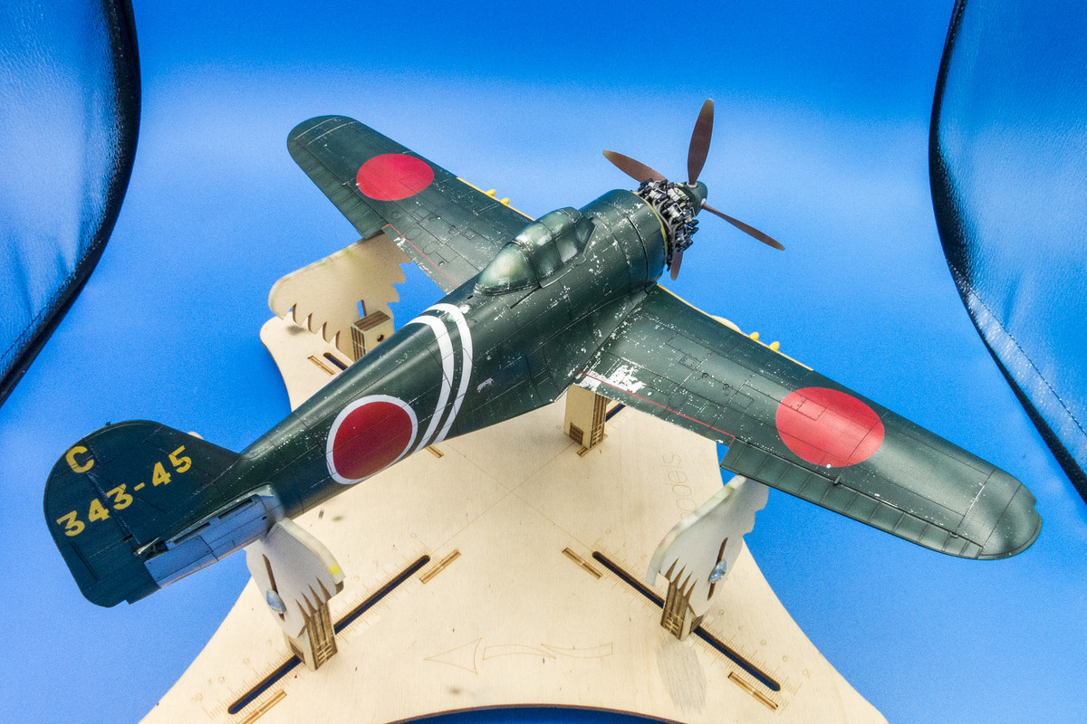

A sneak peak at the prop mounted. I'll have option of posing the model like this.
Some more shots in the light box prior to decal application...
