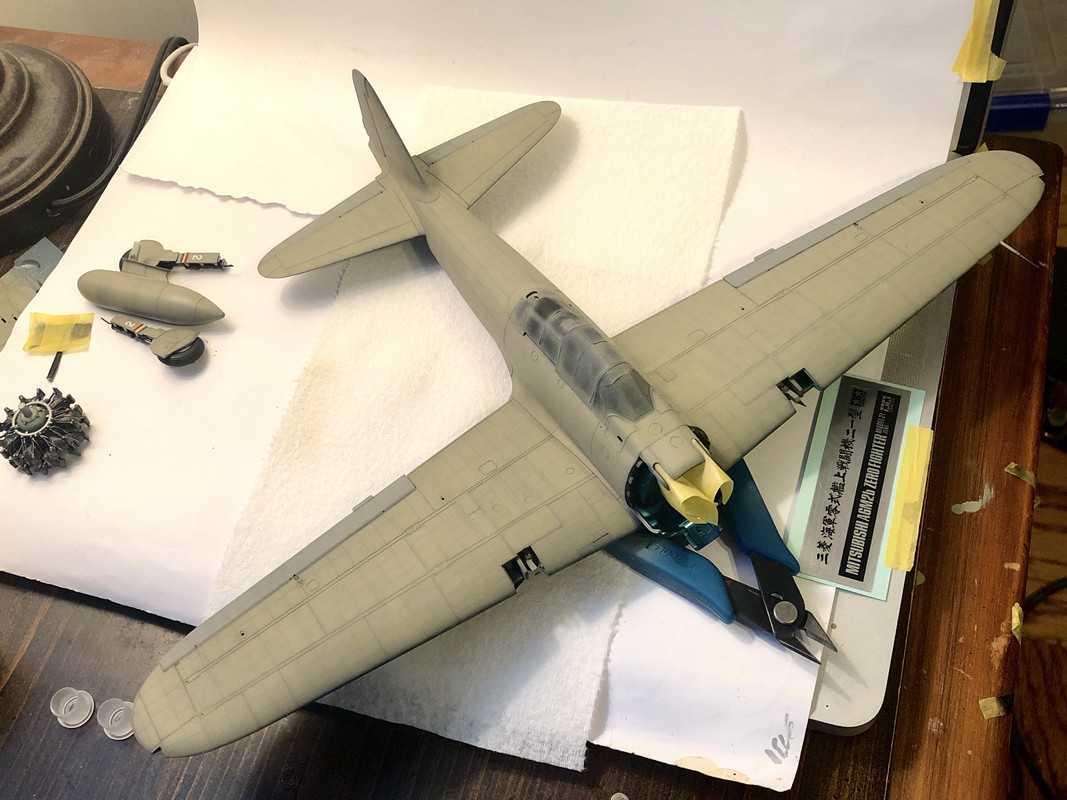

I decided at the last minute not to spray Alclad Duraluminum as a metallic base for my Ameiro paint, and nave opted instead to stick with the Devil I know: black-basing. This is going to take a very, VERY long time. These are just the first layers of marble coats. The panel and rivet lines will gradually become less stark and should end up just barely visible. In then end I’m shooting for a “noticed but not SEEN” effect with the lines, as opposed to the checkerboard look we see sometimes. This will take many sessions, a little bit of paint at a time, building it up gradually.

That’s two marble coats right there. And I estimate all total, it’ll be four or five marble coats and three or four blend coats. I hope not more than that but if that’s what it takes, it’s okay, this aircraft wasn’t badly weathered at all. So while I’m shooting for a compelling paint job, it’s going to look as close to almost new as I can get it.

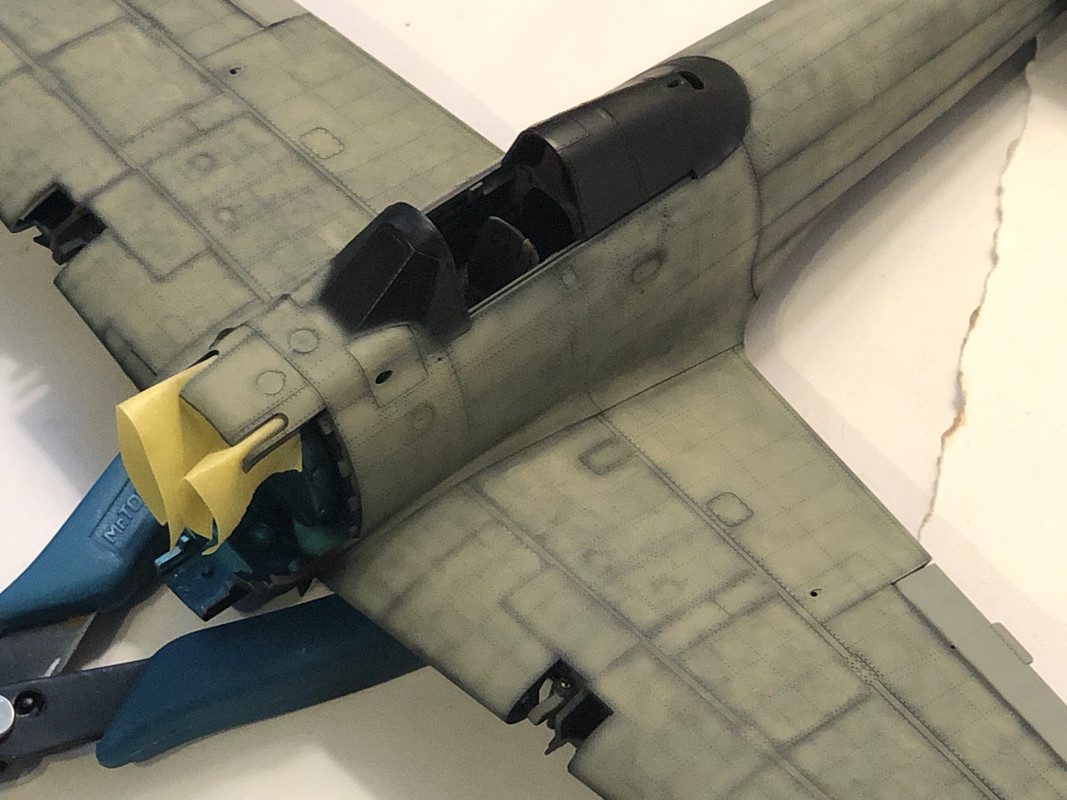

I started and completed the blend coats on the starboard wing. Here’s how it turned out in comparison to the port wing which hasn’t been blended at all yet:
The panel and rivet lines faded down to exactly where I wanted them. “Noticeable but not seen” and the subsequent clear coats will ramp them down a bit more. Later on a wash on the panel lines and rivets with neutral brown will tie it all together and bring it home.

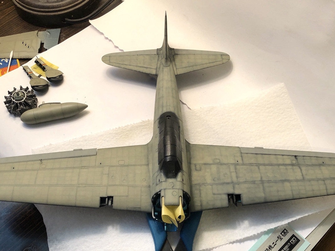

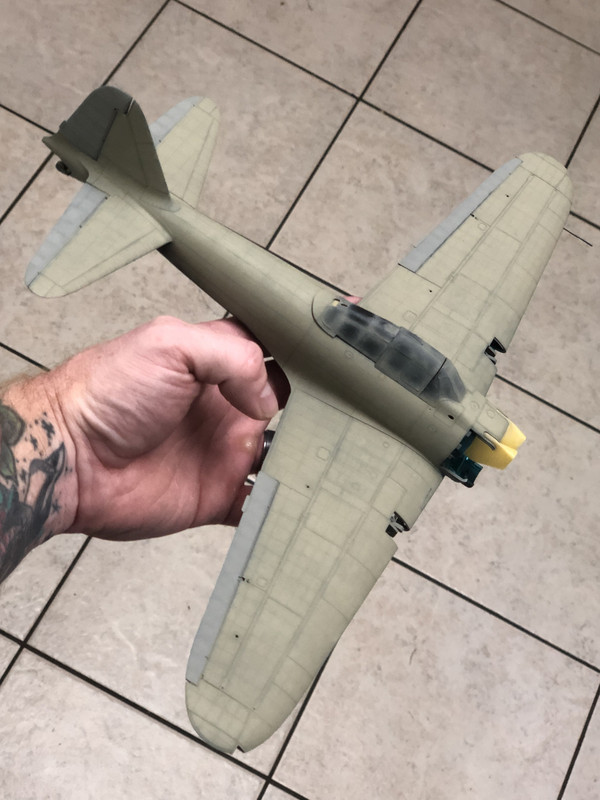

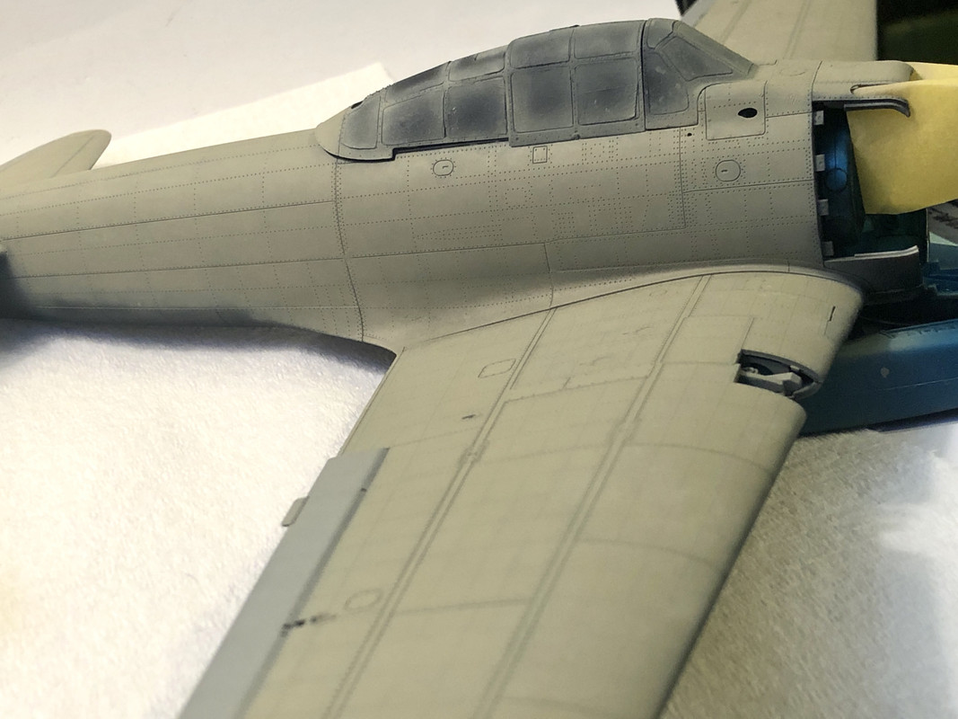

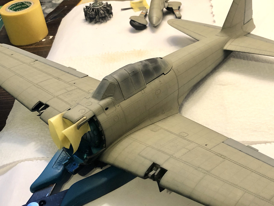

Here’s some more shots:
Topside complete!
