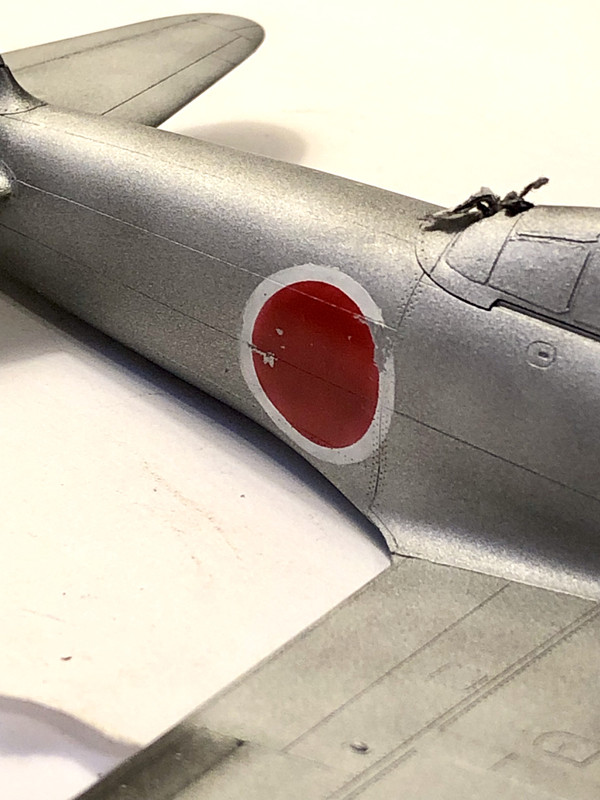

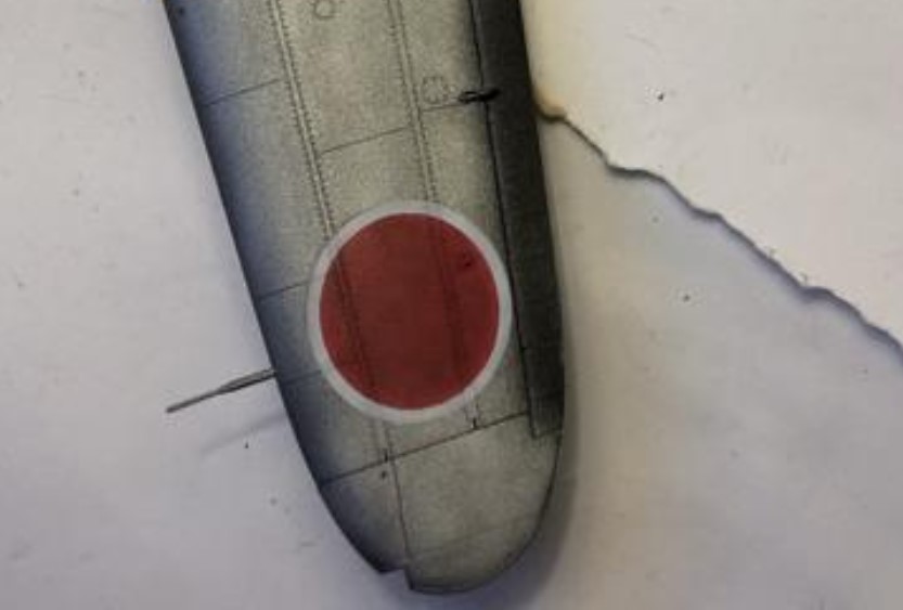

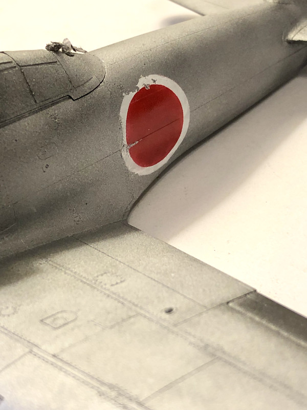

It’s been a fun few days! We’re potty training the twins! That’s been, uh, interesting. I have managed to do some painting though. First up, the fuselage Hinomaru. I got those painted, using the same method as the others, and I’ve also chipped them. I don’t know what kind of time window we’re looking at with leaving the hairspray to sit under that paint. So I’m opting to chip as I go. Here’s a few pics:
The red is bright, it has depth, but it also has some battle scars. I like how they turned out.

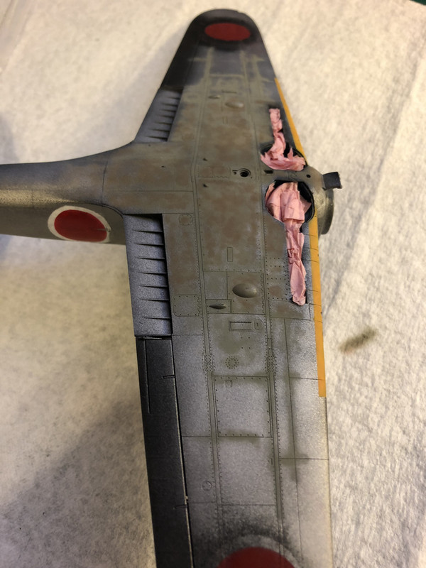

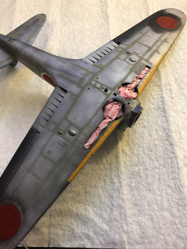

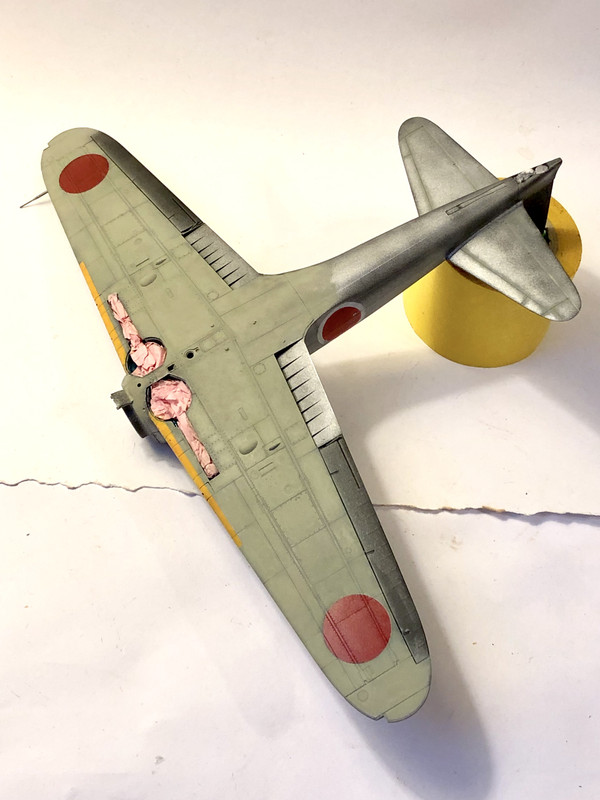

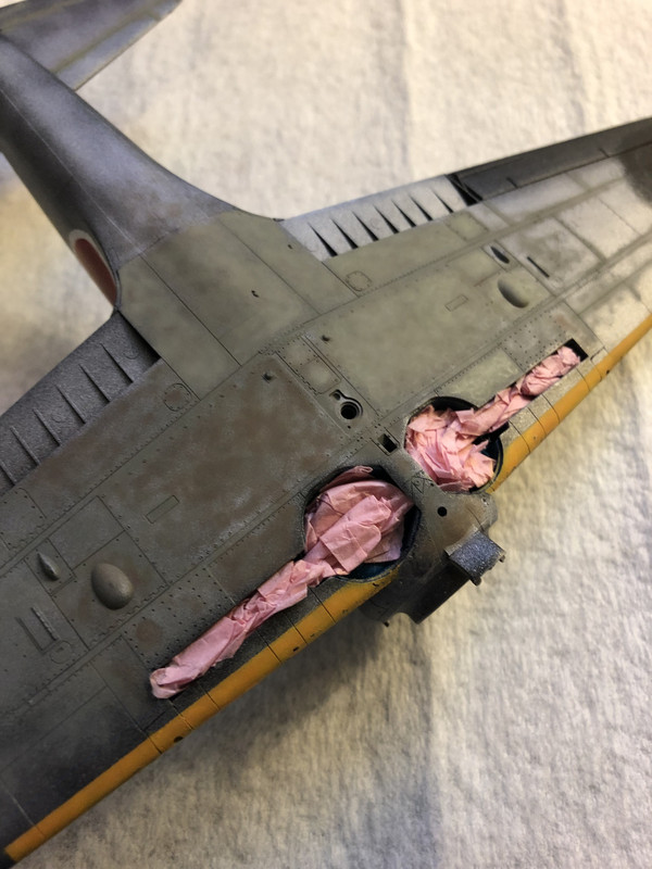

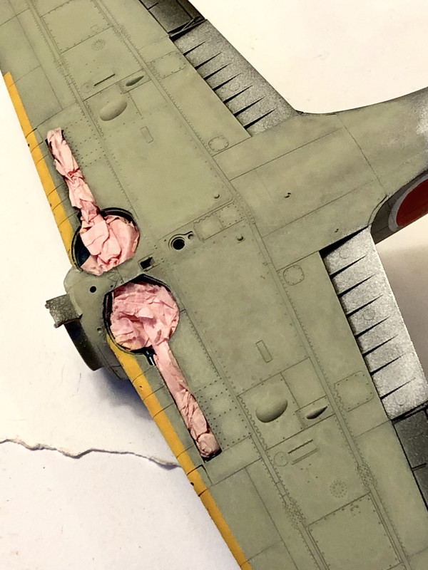

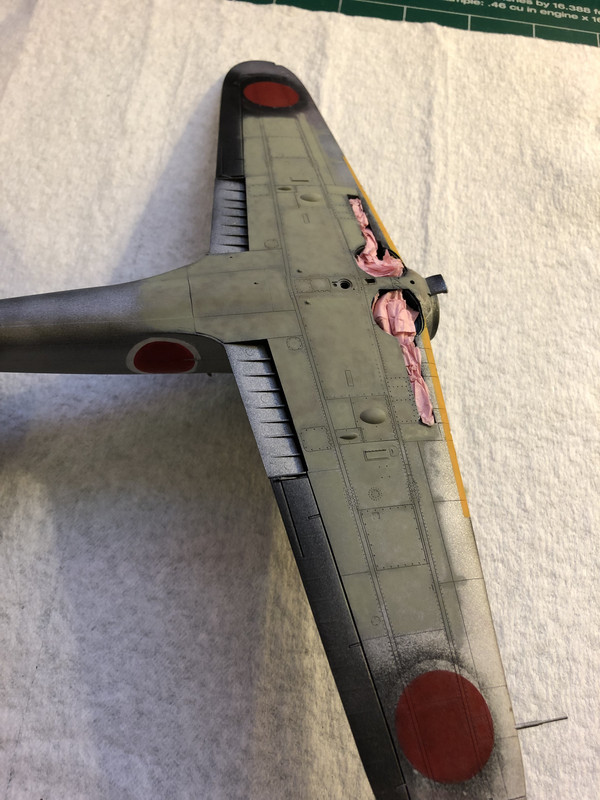

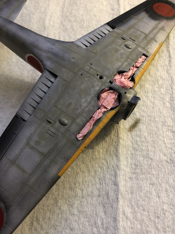

I also got the Hinomaru on the underside of the wings done, as well as starting the major painting down there. Here’s what I did:
1. I stared by pre-shading some panel lines. I didn’t want it stark and I didn’t want a ton of contrast. Just a slightly darker frame in certain places. I used RLM Gray mixed with Gray Green (IJN), mixed 1:2, and thinned 3:1 thinner to paint:
2. After that I mottled that same mix into select panels, in my diffused pattern:
3. Next I mixed Flat Earth with RML Gray 1:1, thinned it 4:1 thinner to paint, and mottled that inside the panels:
4. Next came the Gray Green. I thinned the absolute crap out of it and then I mottled and blended this coat into and on top of the existing work, mottling, then blending, then mottling and blending in other areas, slowly and carefully:
Here’s what I ended up with:
That’s all I could do on my lunch break today. This seemed like just as good a stopping point as any. And note- when I do my 1:32 Zeke, this same scheme will be applied to the entire aircraft. I can’t wait to see how that looks, all Green Gray.
