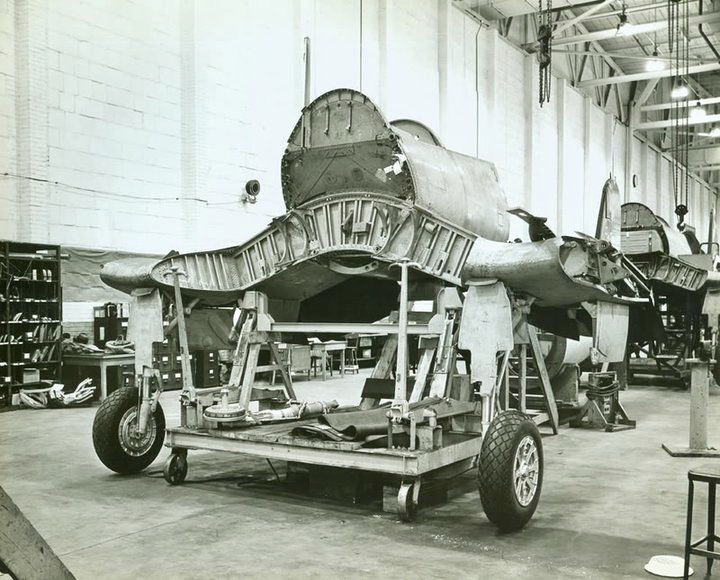

You’d probably see both, depending on when it was during the war. And Bruce, that photo is great- it puts it in perspective how big this aircraft really was, y’know?

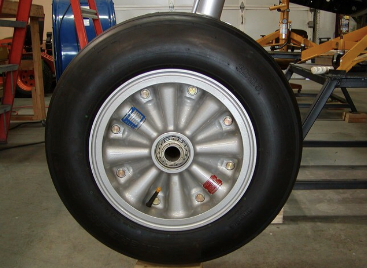

Not to worry—your painting did not go unnoticed. Those tires looked great, John. I hunted around for a good color view for you, and found this. It’s definitely a great shot of the exact type of 32x8 tire used, on the hub. Notice also the red and blue plates on the hub. I almost wanna dare ya to go for broke and get those in there, but I imagine Tamiya maybe included those as decals. Did they?
I wanted to add hopefully this matters (and I think it does) we are dealing with a pilot whose attitude was to take the roughest, crankiest airframes almost as a point of pride and use their personality to his advantage, so I think you are doing an absolutely brilliant job of laying the foundation to create either a cleaned up for the cameras version or something much scruffier.
Edit—your wheel is this type! Apologies. No red and blue plates.
Magnesium alloy. I have seen examples painted blue.
