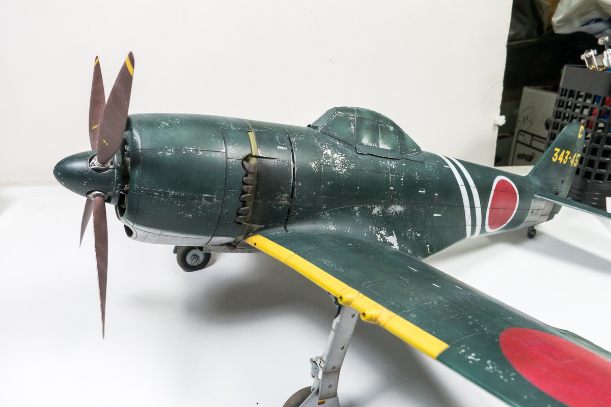

BlackSheep214 wrote:Now she’s starting to look like a beater airplane. Well done, John! :shoutout: :shoutout: :shoutout:
Yes, it is becoming a bit of a beater, which was my intention going into this build. And I'm not quite finished with the beating yet. I'm going to let this stage sit for a while, evaluate the salt fading and make some minor adjustments, maybe add some stencil-based stains up top and also do more chipping with the sponge and pencil. And since all of the major spray work is done, I can start adding the external bits like landing gear, etc.

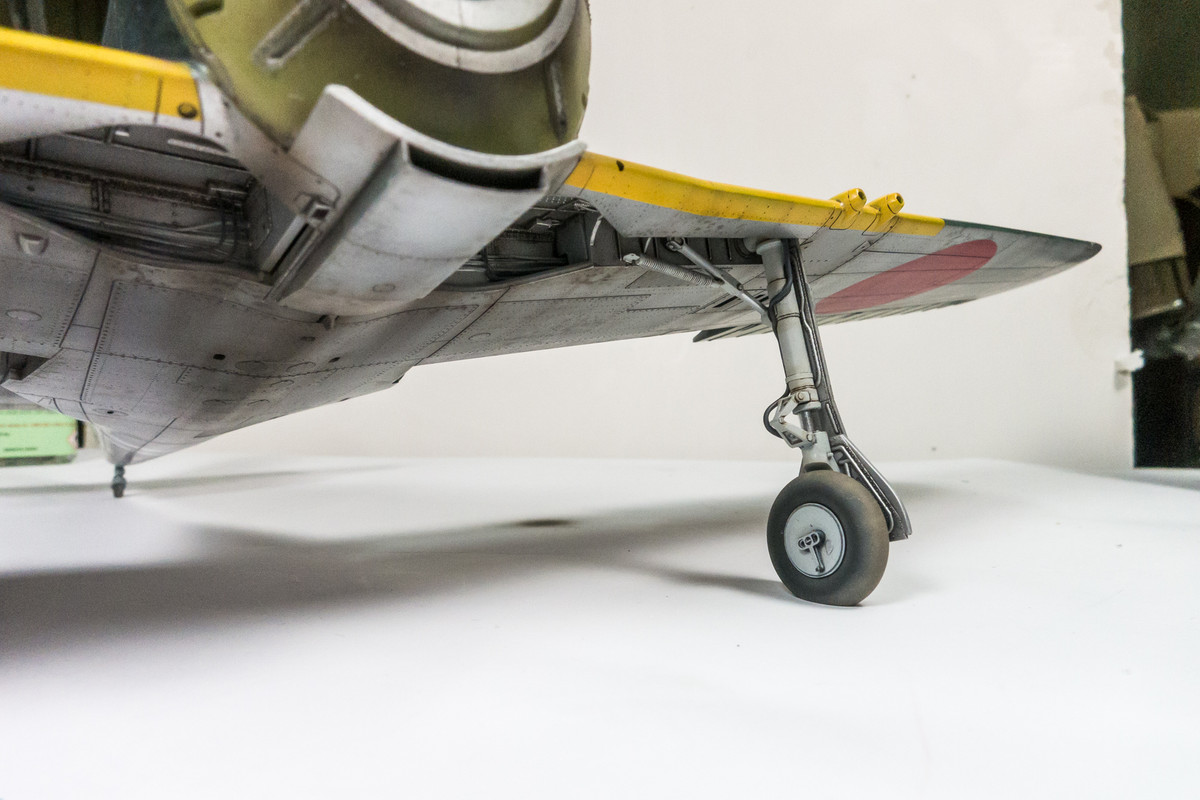

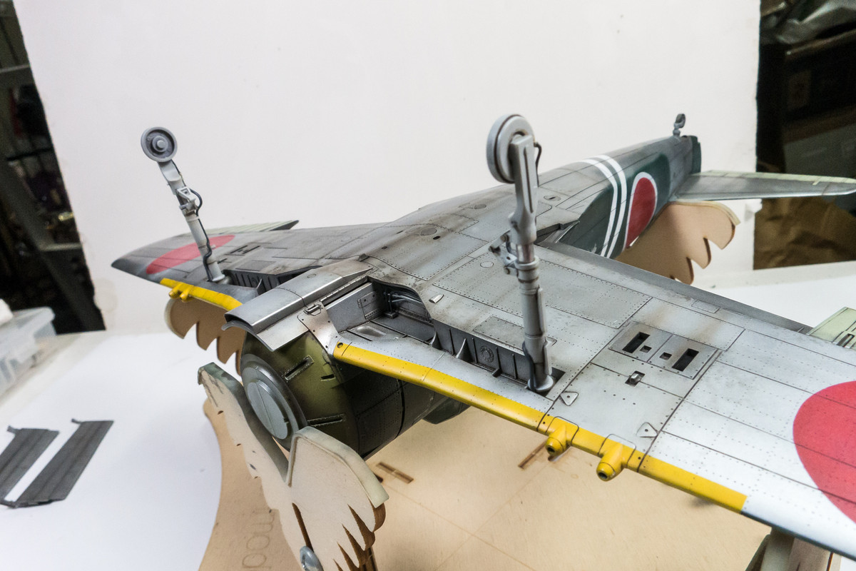

Onward we fly... now it's time to start adding all of the external bits and pieces that were painted and weathered previously. The tail wheel slots in positively via two slot/tab connections on an interior bulkhead within the fuselage. Since I can't access the glue joint from the outside, this is a good time to bust out the old school Testors tube glue.

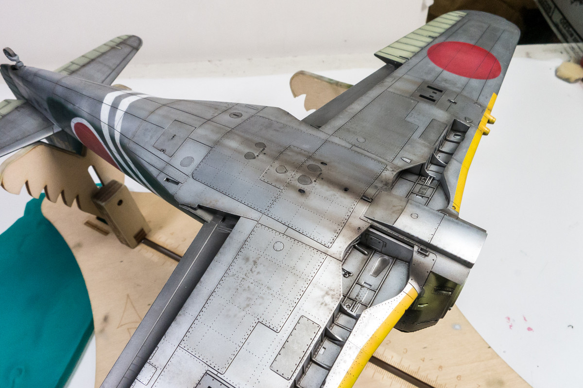

A look at the bottom before fitting the main landing gear. I may do some minor on the bottom staining and wear.

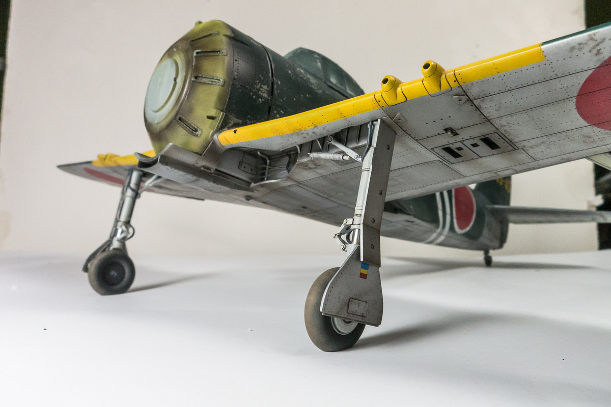

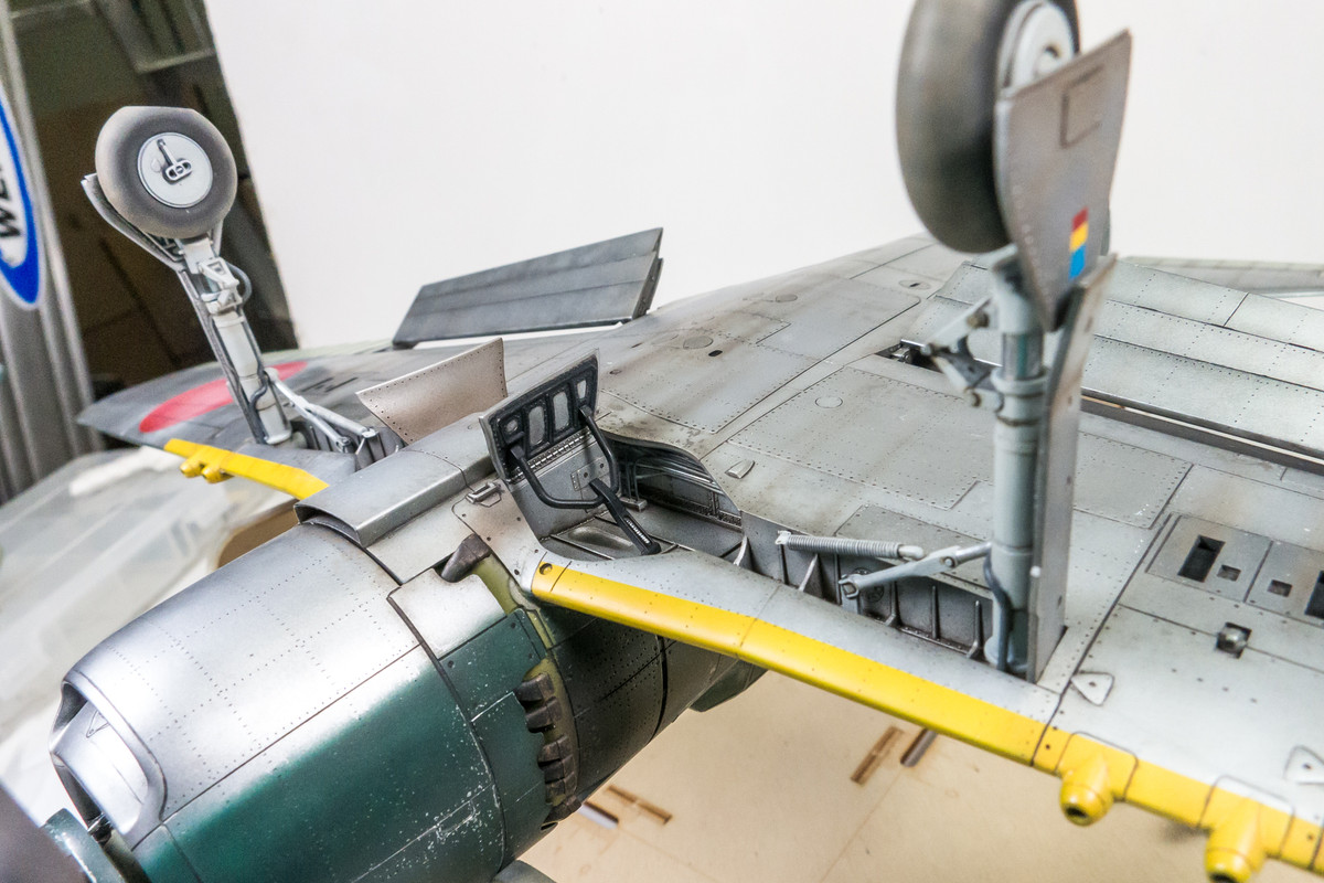

The main landing gear legs are glued into their slots, again using tube glue. I have to make sure that the flat spot on the tires are in the correct orientation so I have to tackle this one component at a time.
The landing gear actuators are glued into place at this time as they help to ensure that the landing gear legs are at the correct angle. After I let the glue securing the tail wheel and landing gear legs dry, I glue on the tires minus the wheel hubs. While the glue has not yet hardened, the tire flat spot is aligned with the ground surface.
The landing gear covers are glued into place. We can verify that the wheel flat spots are flat on the ground.
The wheel hubs are then glued into the correct orientation.

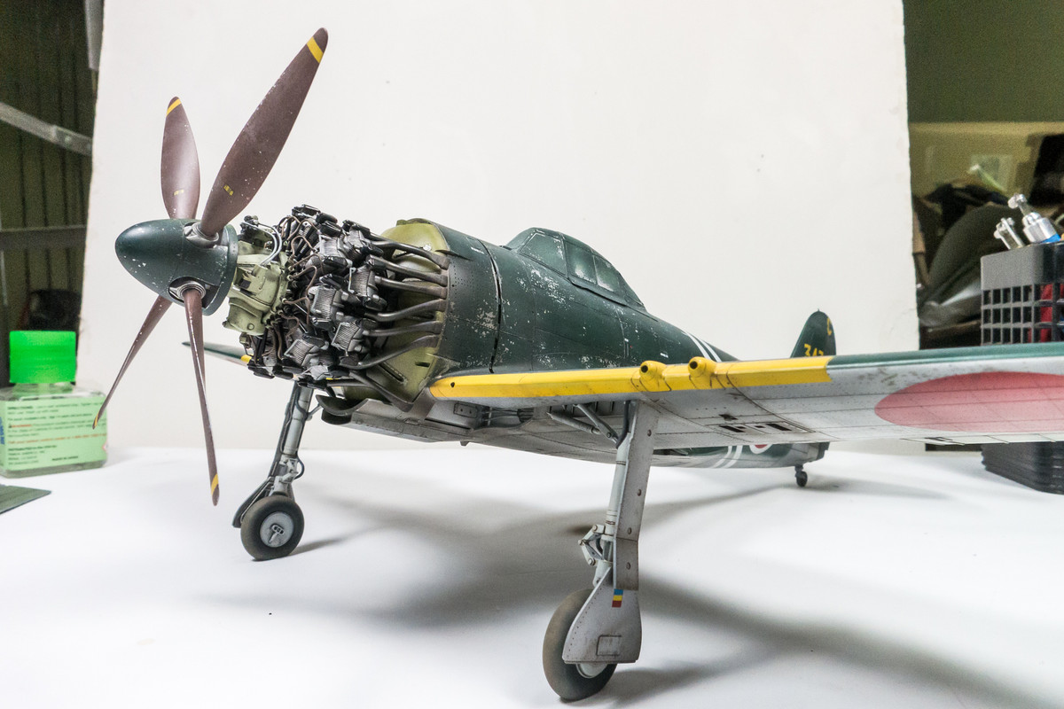

Next I glued the engine assembly into place using, once again, a big blob of tube glue to ensure a good bond.
The engine cowling fits more snugly with the engine glued into place, which is a good thing. I've left it unglued, therefore removable.

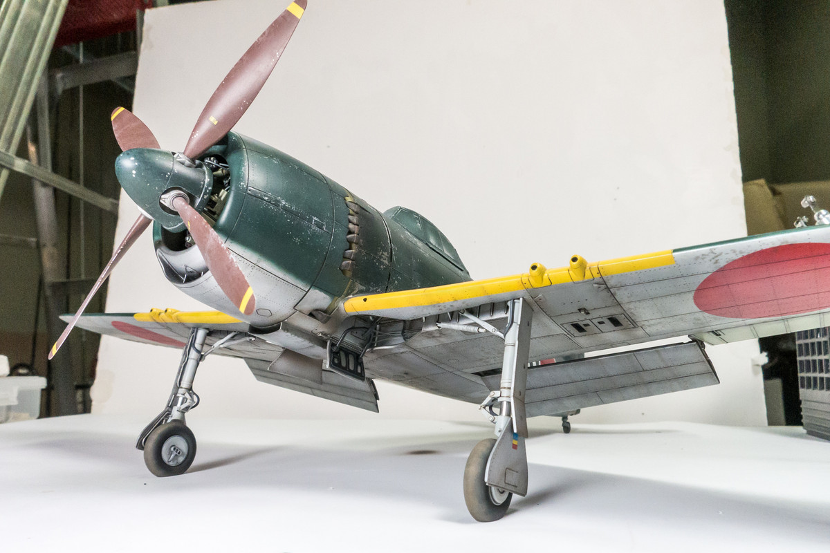

The combat flaps are also a tight friction fit so I'll leave them removable as well. This will simply the packing procedure as this model gets shipped. The inner landing gear doors and actuators are glued in as well.
On its own legs for the first time, the Shiden Kai is fast approaching the finish line.
Seeing her off the jig and standing on her own legs it's really something. It's got to be so hard to part with these builds when finished after pouring so much time and work into them. I know I couldn't do it.
Good goin' on a strong bond with that engine. It'd be ashamed to do all that work only to have the engine fall from the aircraft during handling. Did the same trick with my D-9.
