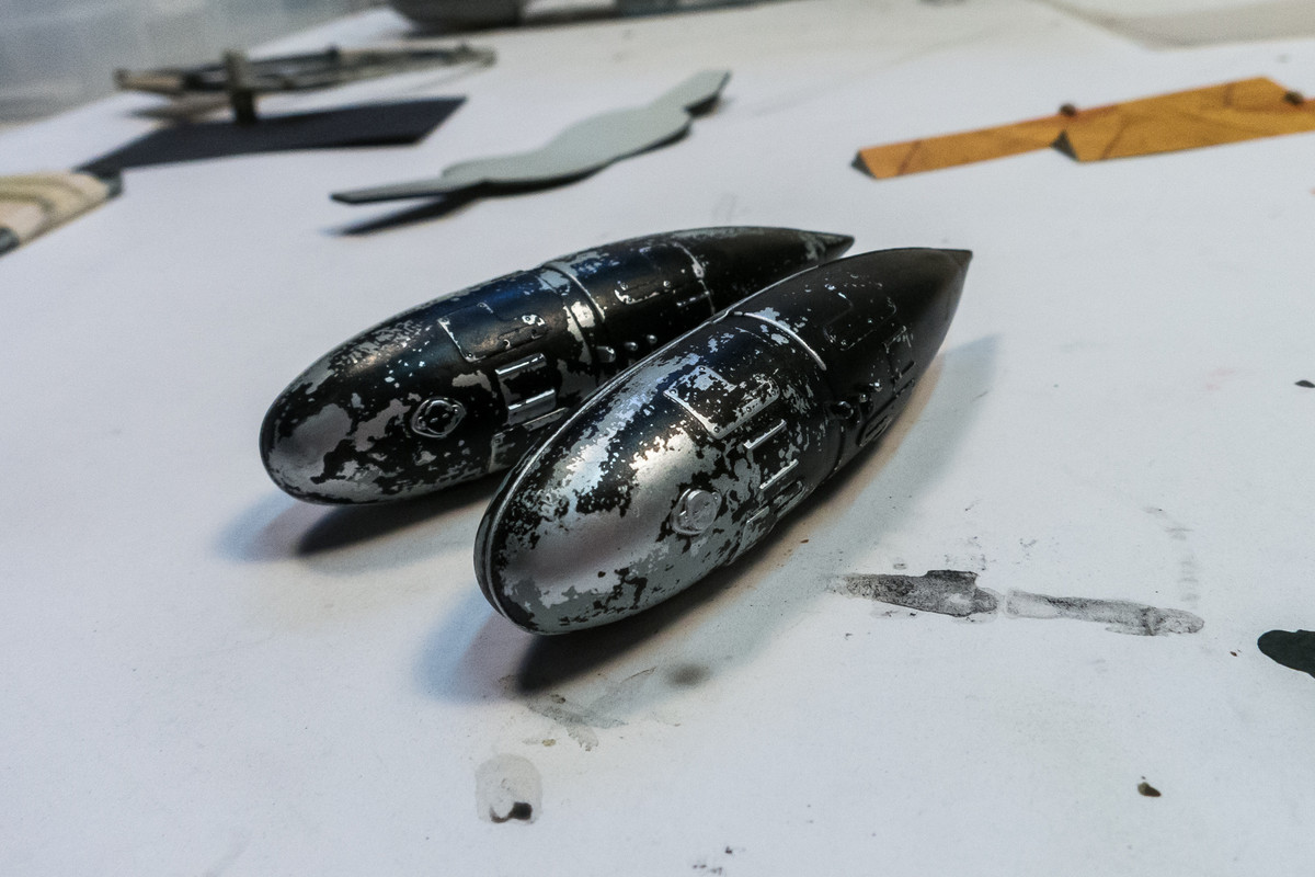

My first attempt at weathering the drop tanks using two-layer chipping. RLM 76 Light Blue over Silver was chipped first and then the black overall chipped again. Not very happy with the results but I'll leave it alone for now and revisit later.
Looks weathered to me! My only question would be this...did drop tanks have enough reuse to get really beat up? I have no clue.

Realistically, in the service life of a Luftwaffe night fighter 262, probably not. The actual service life was weeks to months at most. Add in the fuel shortages that plagued the Luftwaffe at the end of the war... Lastly there is the consideration of what drop tanks are... DROP tanks. They are jettisoned if any maneuvering combat is to be performed, and new tanks replaces those expended. But they do look good.
Great question, Lyle! Not an expert but from what I've seen in my references, the wear on Luftwaffe drop tanks varied greatly. Some exhibited heavy wear and some did not. If possible, I try to match what is known about that particular aircraft. For example on Bf109's, it was common for the drop tank to catch a lot of oil/fuel from the engine and many drop tanks on Bf109's have that characteristic staining on the top front. Drop tank wear is not unusual since these things were designed to be re-used and based on the type of war that the Luftwaffe was fighting in 44/45, the air battles were happening over German territory and the drop tanks COULD be recovered and re-used.
Luckily, there are multiple photos of Red 10 and one can discern the wear patterns on the drop tanks. As you can see, the black paint is almost completely worn off the top fronts of the tanks. The amount of wear exhibited Red 10's drop tanks had me questioning the quality of the black paint applied to the drop tanks versus the airframes. Was it perhaps a lower quality, distemper type of black, prone to wear? This led to my technique of using two-layer chipping. Perhaps the black was wearing off to reveal not just bare metal but the preceding camo color, which might be Light Blue RLM 76.
My first attempt did not quite capture the look of the wear that I see in the photos. I'm not going to be exact but I think I can get it closer.
