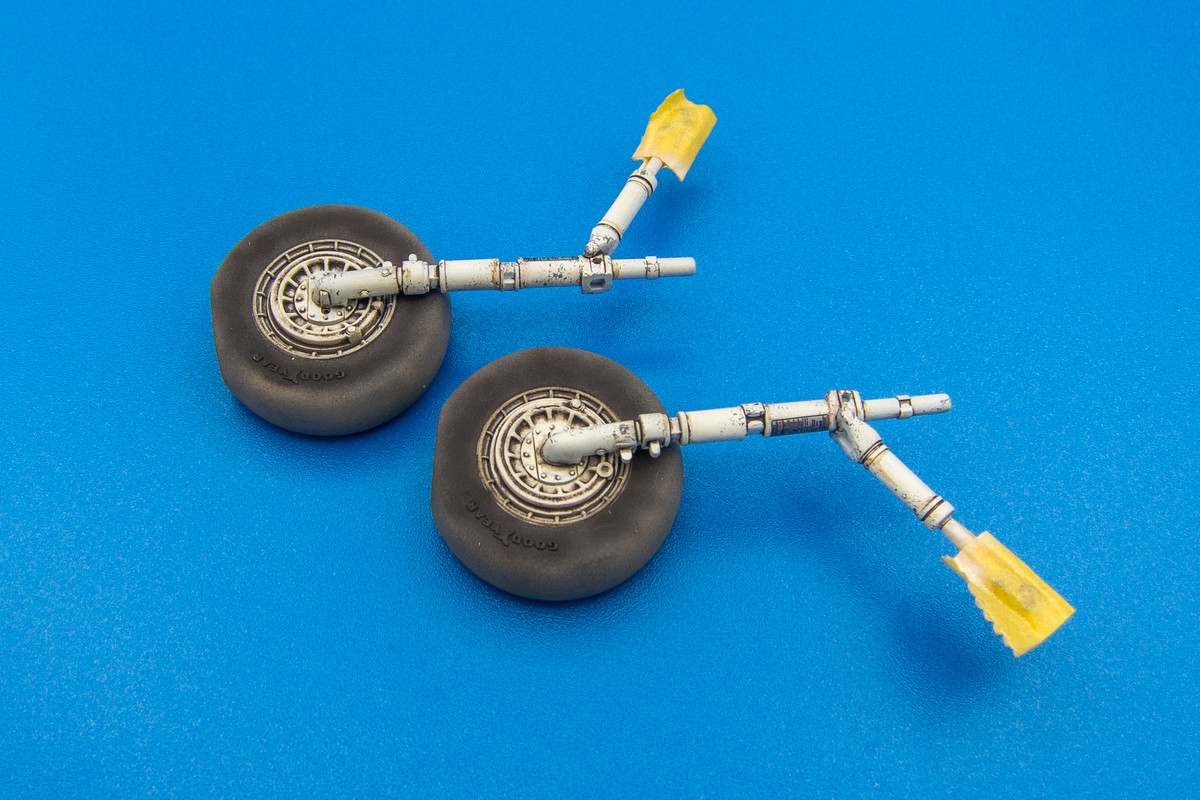

The main gear struts have been painted. Still figuring out how to weather these white legs. The tail leg was kind of test of different things to see how they would look and I've started to consolidate some ideas on the main legs. Primarily, after painting and a dark wash, I've added some grey chipping using a sponge. Some areas were then dabbed with AK Fresh Engine Oil, which is a new one for me. It is a translucent enamel wash, I believe.

The AK oil wash is fantastic! What a beautiful addition! Congratulations, sir!
Thank you Lyle and thank you Bruce, for your comments!
I've attached the inner wheel hubs to the main landing gear legs.
The legs are far from being done though. The parts in grey need to be painted. It's a testament to Tamiya that the bits and pieces, which include the hydraulic brake lines, can hold together like this without glue.
