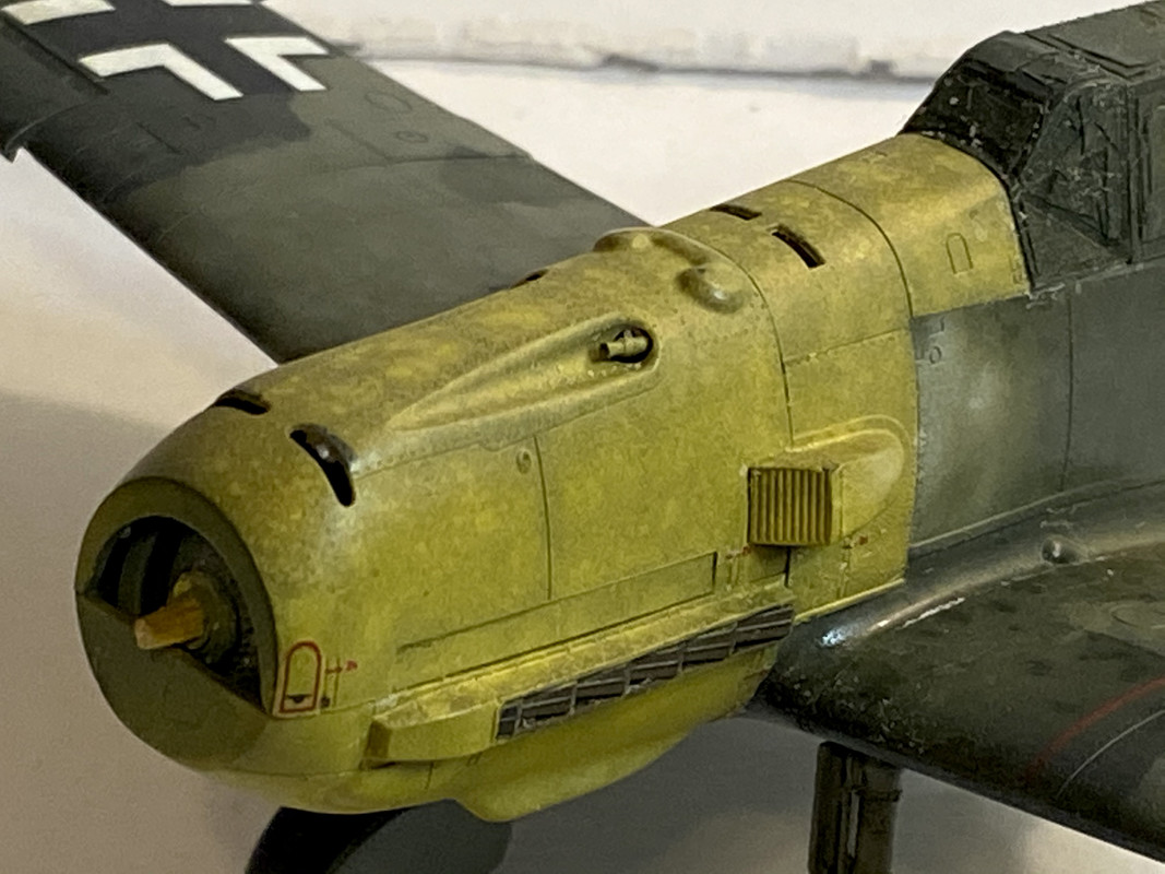

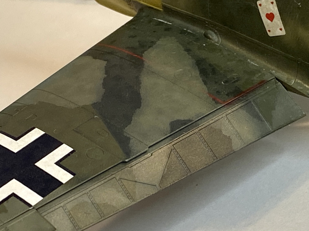

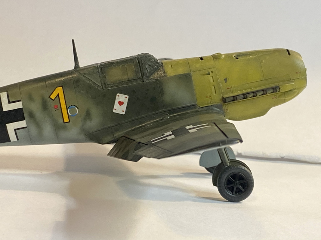

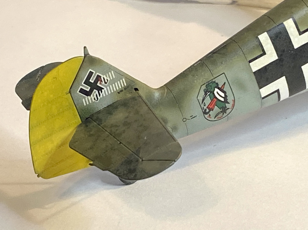

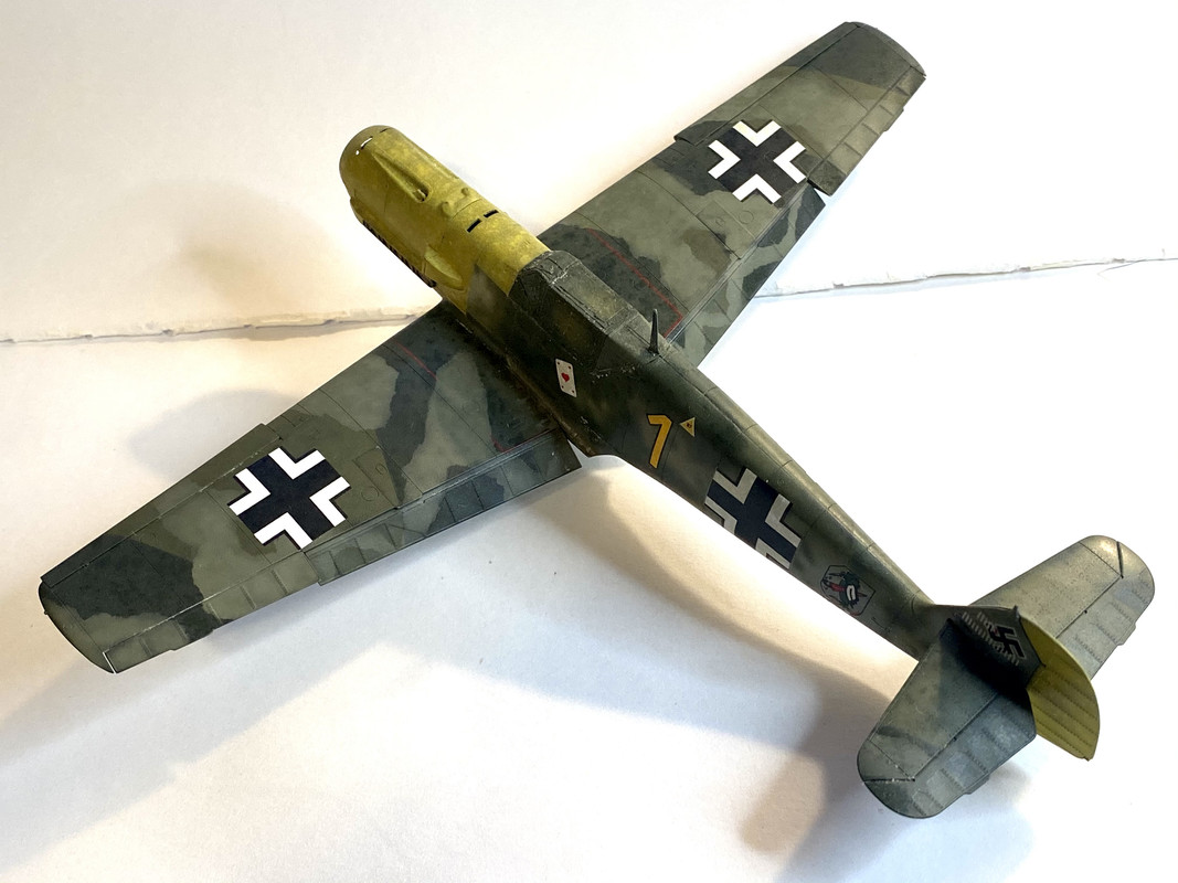

Here’s the results:

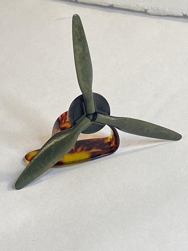

I also played around with the salt for making the Stuka’s prop before the final blend coats. I wanted to make it look beat-up like it might’ve been from being out there in the desert. Check it out:
Very, very cool technique and effect. It gave a very nice fade to the Franken-Emil, as well as some nice modulation on the wings, and grime on the cowling. I’m very happy with the results. The only tweak I’ll be giving this procedure in the future is one coat each color instead of two.

Looks great, Kenny. I know the feeling. Not only it scares the hell out of fear me, I’m very intimidated by it. I guess my fear isn’t ruining a perfectly good kit and screwing it up badly enough to smash it to pieces on the floor.
I’m more of a hands on visual - meaning someone actually here showing me how it’s done physically not by pictures or videos.
It's always a good idea to do experiments on a test kit like this. It really did give the yellow area a grime dirty look to it. The prop looks fantastic and I'll give the spray bottle idea a try with the next build. Going to be starting on a 109 soon.
